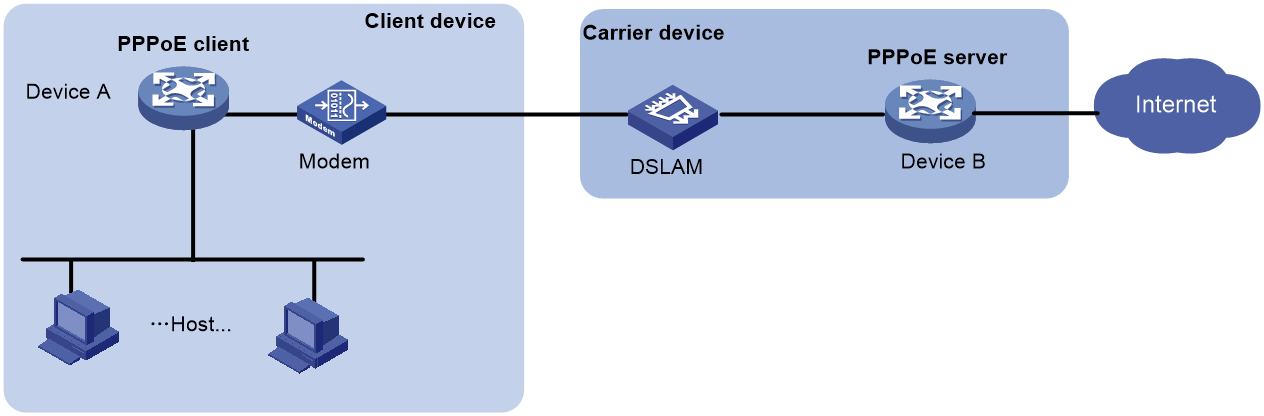

PPPoE network structures are classified into router-initiated and host-initiated network structures depending on the starting point of the PPPoE session.
Router-initiated network structure
As shown in Figure 1, in the router-initiated network structure, a PPPoE session is established between two devices, and all user endpoints transmit data through this PPPoE session. In this network structure, the PPPoE client is located in the intranet, and the PPPoE server is provided by the carrier. A user endpoint does not require the installation of PPPoE client dialup software. Typically, an enterprise uses a shared account to access the network.
Figure 1 Router-initiated network structure

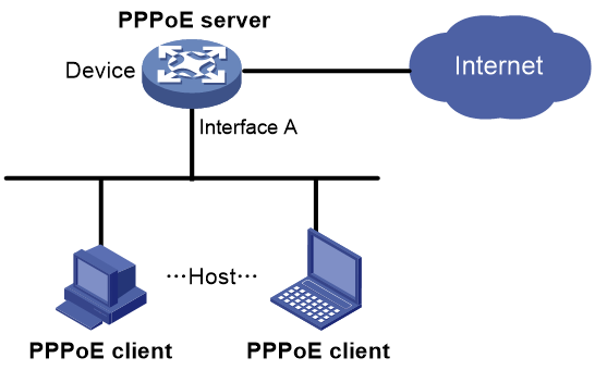

Host-initiated network structure
As shown in Figure 2, each user endpoint must have PPPoE client dialup software installed in the host-initiated network structure. These endpoints act as PPPoE clients, and establish individual PPPoE sessions with the PPPoE server of the carrier. This approach benefits carriers by enabling effective accounting and management control of users.
Figure 2 Host-initiated network structure

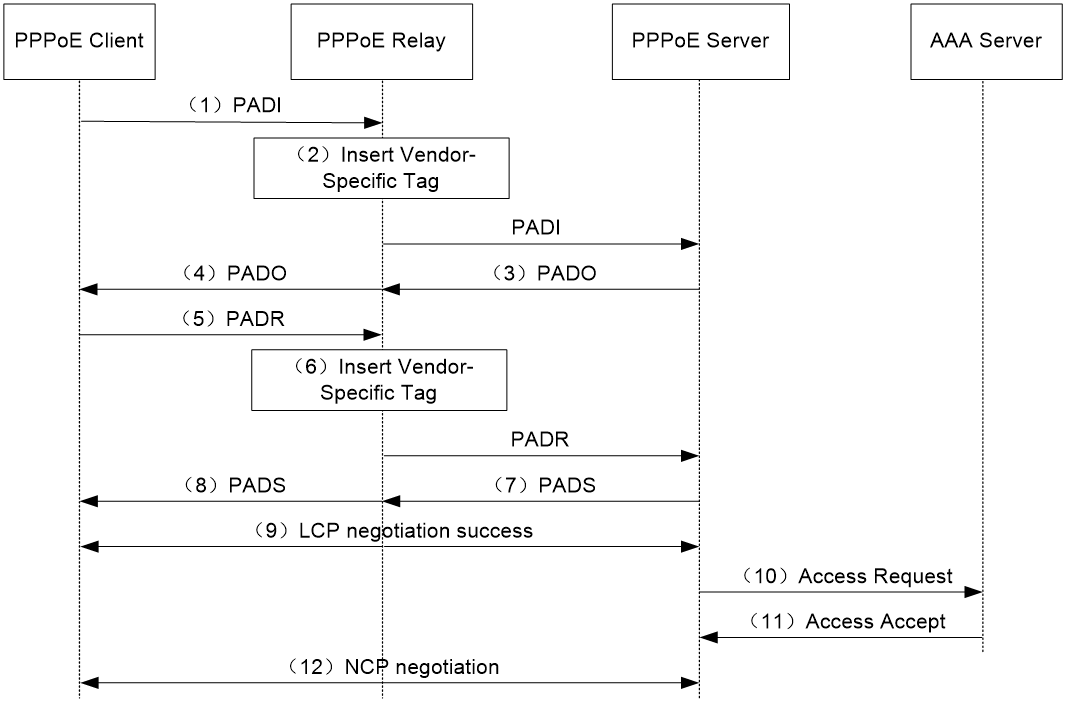

PPPoE relay fundamentals
When a PPPoE client account is stolen, the account can be used elsewhere to access the network. The PPPoE relay feature is introduced to resolve this issue and enhance the PPPoE network security.
PPPoE relay is also called PPPoE+ and is deployed on a PPPoE relay device (typically, a switch) between PPPoE client and PPPoE server).
The PPPoE relay device sends the PPPoE client's access interface information (for example, slot number/interface number, VLAN, and MAC address) to the PPPoE server through PPPoE protocol packets. Based on information in these packets, the PPPoE server binds the PPPoE client's user account to the access interface to enhance the PPPoE network security.
The PPPoE relay controls protocol packet forwarding through monitoring the protocol packet exchange between the PPPoE client and the PPPoE server. Figure 3 shows the detailed process.
Figure 3 PPPoE client access procedure in a PPPoE relay network
1.     The PPPoE client broadcasts a PADI packet.
2.     When receiving the PADI packet, the PPPoE relay adds the vendor-specific tag field to the PADI packet and broadcasts the packet out of all trusted ports.
The vendor-specific tag in a PPPoE packet identifies the location information (for example, the access port and VLANs) of a PPPoE client.
3.     When receiving the PADI packets, the PPPoE server responds with a PADO packet to the PPPoE client.
4.     When receiving the PADO packet, the PPPoE relay forwards the packet to the PPPoE client.
5.     When receiving the PADO packet, the PPPoE client unicasts a PADR packet to the PPPoE server to apply for the PPPoE service.
6.     When receiving the PADR packet, the PPPoE relay adds the vendor-specific tag to the packet and searches for an outgoing interface based on the destination MAC address of the PADR packet.
¡     If the outgoing interface is a trusted port, the PPPoE relay forwards the packet out of the port.
¡     If the outgoing interface is an untrusted port, the PPPoE relay drops the PADR packet.
7.     When receiving the PADR packet, the PPPoE server assigns a session ID to the PPPoE client and binds the session ID to the vendor-specific tag. Then, the PPPoE server responds with a PADS packet to the PPPoE client.
8.     When receiving the PADS packet, the PPPoE relay forwards the packet to the PPPoE client.
9.     When receiving the PADS packet, the PPPoE client starts the LCP negotiation and authentication with the PPPoE server.
10.     During the authentication phase, the PPPoE server will send the location information, username, and password of the PPPoE client to the RADIUS server for authentication.
11.     The RADIUS server compares the location information, username, and password saved in the database with those of the PPPoE client. If they match, the PPPoE client passes the authentication.
12.     After the PPPoE client passes authentication, the PPPoE client starts NCP negotiation with the PPPoE server. After the NCP negotiation succeeds, the PPPoE client successfully comes online.

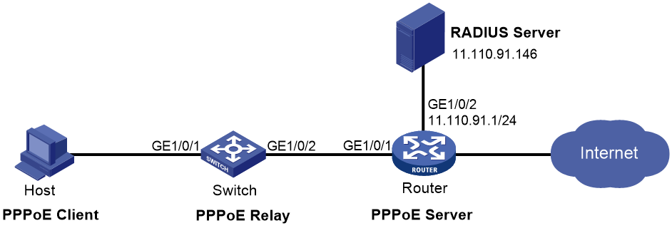

Example: Configuring PPPoE relay
The host uses the PPPoE access method to connect to the router through the switch. The switch acts as the PPPoE relay. The router acts as the PPPoE server and assigns IPv4 addresses to the PPPoE client through a PPP address pool.
Figure 4 Network diagram
1.     Configure the switch as the PPPoE relay:
# Enable the PPPoE relay function.
<Switch> system-view
[Switch] pppoe-relay enable
# Configure the server-facing interface GigabitEthernet 1/0/2 as a PPPoE relay trusted port.
[Switch] interface GigabitEthernet 1/0/2
[Switch-GigabitEthernet1/0/2] pppoe-relay trust
2.     Configure the router as a PPPoE server:
# Create a PPPoE user.
<Router> system-view
[Router] local-user user1 class network
[Router-luser-network-user1] password simple 123456TESTplat&!
[Router-luser-network-user1] service-type ppp
[Router-luser-network-user1] quit
# Configure Virtual-Template 1 to use CHAP for authentication and use a PPP address pool for IP address assignment. Set the DNS server IP address for the peer.
[Router] interface virtual-template 1
[Router-Virtual-Template1] ppp authentication-mode chap domain system
[Router-Virtual-Template1] ppp chap user user1
[Router-Virtual-Template1] remote address pool 1
[Router-Virtual-Template1] ppp ipcp dns 8.8.8.8
[Router-Virtual-Template1] quit
# Configure a PPP address pool that contains nine assignable IP addresses, and configure a gateway address for the PPP address pool.
[Router] ip pool 1 1.1.1.2 1.1.1.10
[Router] ip pool 1 gateway 1.1.1.1
# Enable the PPPoE server on GigabitEthernet 1/0/1, and bind the interface to Virtual-Template 1.
[Router] interface gigabitethernet 1/0/1
[Router-GigabitEthernet1/0/1] pppoe-server bind virtual-template 1
[Router-GigabitEthernet1/0/1] quit
# Configure the default ISP domain (system) to use the RADIUS scheme for authentication, authorization, and accounting.
[Router] domain system
[Router-isp-system] authentication ppp radius-scheme rs1
[Router-isp-system] authorization ppp radius-scheme rs1
[Router-isp-system] accounting ppp radius-scheme rs1
[Router-isp-system] quit
# Configure a RADIUS scheme, and specify the primary authentication server and the primary accounting server.
[Router] radius scheme rs1
[Router-radius-rs1] primary authentication 11.110.91.146
[Router-radius-rs1] primary accounting 11.110.91.146
# Set the shared key for secure communication with the authentication and accounting servers to expert in plain text.
[Router-radius-rs1] key authentication simple expert
[Router-radius-rs1] key accounting simple expert
[Router-radius-rs1] quit
3.     Configure the RADIUS server:
a.     Configure the authentication and accounting passwords as expert.
b.     Add a PPPoE user with username user1 and password 123456TESTplat&!.
For more information, see the user manual for the RADIUS server.
Install the PPPoE client software and configure the username and password (user1 and 123456TESTplat&! in this example) on the hosts. Then, the hosts can use PPPoE to access the Internet through the router.
