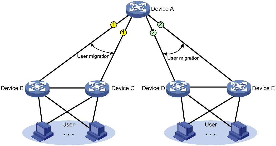

About MSTP
MSTP features
Developed based on IEEE 802.1s, MSTP overcomes the limitations of STP, RSTP, and PVST. In addition to supporting rapid network convergence, it allows data flows of different VLANs to be forwarded along separate paths. This provides a better load sharing mechanism for redundant links.
MSTP provides the following features:
·     MSTP divides a switched network into multiple regions, each of which contains multiple spanning trees that are independent of one another.
·     MSTP supports mapping VLANs to spanning tree instances by means of a VLAN-to-instance mapping table. MSTP can reduce communication overheads and resource usage by mapping multiple VLANs to one instance.
·     MSTP prunes a loop network into a loop-free tree, which avoids proliferation and endless cycling of frames in a loop network. In addition, it supports load balancing of VLAN data by providing multiple redundant paths for data forwarding.
·     MSTP is compatible with STP and RSTP, and partially compatible with PVST.

Basic concepts in MSTP
Figure 9 shows a switched network that contains four MST regions, each MST region containing four MSTP devices. Figure 10 shows the networking topology of MST region 3.
Figure 9 Basic concepts in MSTP
Figure 10 Network diagram and topology of MST region 3

Configuring TC Snooping
As shown in Figure 18, an IRF fabric connects to two user networks through double links.
·     Device A and Device B form the IRF fabric.
·     The spanning tree feature is disabled on Device A and Device B and enabled on all devices in user network 1 and user network 2.
·     The IRF fabric transparently transmits BPDUs for both user networks and is not involved in the calculation of spanning trees.
When the network topology changes, it takes time for the IRF fabric to update its MAC address table and ARP table. During this period, traffic in the network might be interrupted.
Figure 18 TC Snooping application scenario
image14.emf
To avoid traffic interruption, you can enable TC Snooping on the IRF fabric. After receiving a TC-BPDU through a port, the IRF fabric updates MAC address table and ARP table entries associated with the port's VLAN. In this way, TC Snooping prevents topology change from interrupting traffic forwarding in the network. For more information about the MAC address table and the ARP table, see "Configuring the MAC address table" and Layer 3—IP Services Configuration Guide.
·     TC Snooping and the spanning tree feature are mutually exclusive. You must globally disable the spanning tree feature before enabling TC Snooping.
·     The priority of BPDU tunneling is higher than that of TC Snooping. When BPDU tunneling is enabled on a port, the TC Snooping feature does not take effect on the port.
·     TC Snooping does not support the PVST mode.

Configuring TC groups
As shown in Figure 22, Device A is connected to two loops (Device A — Device B — Device C and Device A — Device D — Device E), and STP runs on all devices. By default, any topology change by a device causes TC-BPDUs to be sent to both loops and create excessive TC-BPDUs in the network, which impacts system stability. If the topology changes, the interfaces for the user onboarding service on the core devices might change. In this case, users must be re-authenticated on other interfaces of the core devices to come online. During the re-authentication process, service traffic might be lost.
Figure 22 Network diagram
To address this issue, you can configure topology change (TC) groups. A TC group is a logical combination of multiple interfaces on a device, and supports a maximum of two interfaces. As shown in Figure 23, the two M-LAG interfaces connecting to Device B and Device C are added to TC group 1, and the two M-LAG interfaces connecting to Device D and Device E are added to TC group 2.
Figure 23 Network diagram

Based on the output, you can draw each MSTI mapped to each VLAN, as shown in Figure 24.
Figure 24 MSTIs mapped to different VLANs
