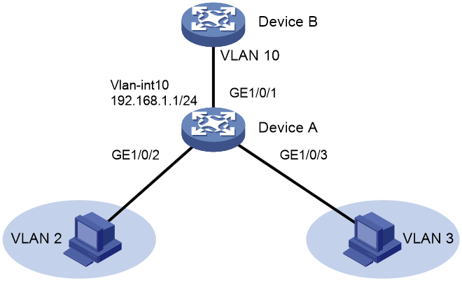

IP subnet-based VLANs
The IP subnet-based VLAN feature assigns untagged packets to VLANs based on their source IP addresses and subnet masks.
Use this feature when untagged packets from an IP subnet or IP address must be transmitted in a VLAN.

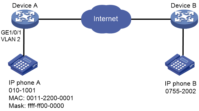

Protocol-based VLANs
The protocol-based VLAN feature assigns inbound packets to different VLANs based on their protocol types and encapsulation formats. The protocols available for VLAN assignment include IP, IPX, and AT. The encapsulation formats include Ethernet II, 802.3 raw, 802.2 LLC, and 802.2 SNAP.
This feature associates the available network service types with VLANs and facilitates network management and maintenance.
Layer 3 communication between VLANs
Hosts of different VLANs use VLAN interfaces to communicate at Layer 3. VLAN interfaces are virtual interfaces that do not exist as physical entities on devices. For each VLAN, you can create one VLAN interface and assign an IP address to it. The VLAN interface acts as the gateway of the VLAN to forward packets at Layer 3. When the IP addresses of multiple VLAN interfaces are on different subnets, you must configure IP routing protocols to enable Layer 3 communication between these IP addresses. Then, the devices can forward packets at Layer 3 across subnets between different VLANs. For more information about IP routing protocols, see Layer 3—IP Routing Configuration Guide.

VLAN configuration examples
Example: Configuring port-based VLANs
As shown in Figure 3:
·     Host A and Host C belong to Department A. VLAN 100 is assigned to Department A.
·     Host B and Host D belong to Department B. VLAN 200 is assigned to Department B.
Configure port-based VLANs so that only hosts in the same department can communicate with each other.
Figure 3 Network diagram
1.     Configure Device A:
# Create VLAN 100, and assign GigabitEthernet 1/0/1 to VLAN 100.
<DeviceA> system-view
[DeviceA] vlan 100
[DeviceA-vlan100] port gigabitethernet 1/0/1
[DeviceA-vlan100] quit
# Create VLAN 200, and assign GigabitEthernet 1/0/2 to VLAN 200.
[DeviceA] vlan 200
[DeviceA-vlan200] port gigabitethernet 1/0/2
[DeviceA-vlan200] quit
# Configure GigabitEthernet 1/0/3 as a trunk port, and assign the port to VLANs 100 and 200.
[DeviceA] interface gigabitethernet 1/0/3
[DeviceA-GigabitEthernet1/0/3] port link-type trunk
[DeviceA-GigabitEthernet1/0/3] port trunk permit vlan 100 200
Please wait... Done.
2.     Configure Device B in the same way Device A is configured. (Details not shown.)
3.     Configure hosts:
d.     Configure Host A and Host C to be on the same IP subnet. For example, 192.168.100.0/24.
e.     Configure Host B and Host D to be on the same IP subnet. For example, 192.168.200.0/24.
# Verify that Host A and Host C can ping each other, but they both fail to ping Host B and Host D. (Details not shown.)
# Verify that Host B and Host D can ping each other, but they both fail to ping Host A and Host C. (Details not shown.)
# Verify that VLANs 100 and 200 are correctly configured on Device A.
[DeviceA-GigabitEthernet1/0/3] display vlan 100
 VLAN ID: 100
 VLAN type: Static
 Route interface: Not configured
 Description: VLAN 0100
 Tagged ports:
    GigabitEthernet1/0/3(U)
 Untagged ports:
    GigabitEthernet1/0/1(U)
[DeviceA-GigabitEthernet1/0/3] display vlan 200
 VLAN ID: 200
 VLAN type: Static
 Description: VLAN 0200
 Tagged ports:
 Untagged ports:
    GigabitEthernet1/0/2(U)

As shown in Figure 7, the private VLAN feature is enabled on L2 Device B. VLAN 10 is the primary VLAN. VLANs 2, 5, and 8 are secondary VLANs that are associated with VLAN 10. L3 Device A is only aware of VLAN 10.
Figure 7 Private VLAN example

Example: Configuring Layer 3 communication for secondary VLANs
As shown in Figure 11, configure the private VLAN feature to meet the following requirements:
·     Primary VLAN 10 on Device A is associated with secondary VLANs 2 and 3. The IP address of VLAN-interface 10 is 192.168.1.1/24.
·     GigabitEthernet 1/0/1 belongs to VLAN 10. GigabitEthernet 1/0/2 and GigabitEthernet 1/0/3 belong to VLAN 2 and VLAN 3, respectively.
·     Secondary VLANs are isolated at Layer 2 but interoperable at Layer 3.
Figure 11 Network diagram
# Create VLAN 10 and configure it as a primary VLAN.
[DeviceA] vlan 10
[DeviceA-vlan10] private-vlan primary
[DeviceA-vlan10] quit
# Create VLANs 2 and 3.
[DeviceA] vlan 2 to 3
# Associate primary VLAN 10 with secondary VLANs 2 and 3.
[DeviceA] vlan 10
[DeviceA-vlan10] private-vlan secondary 2 3
# Configure the uplink port (GigabitEthernet 1/0/1) as a promiscuous port of VLAN 10.
[DeviceA-GigabitEthernet1/0/1] port private-vlan 10 promiscuous
[DeviceA-GigabitEthernet1/0/1] quit
# Assign downlink port GigabitEthernet 1/0/2 to VLAN 2, and configure the port as a host port.
[DeviceA] interface gigabitethernet 1/0/2
[DeviceA-GigabitEthernet1/0/2] port access vlan 2
[DeviceA-GigabitEthernet1/0/2] port private-vlan host
[DeviceA-GigabitEthernet1/0/2] quit
# Assign downlink port GigabitEthernet 1/0/3 to VLAN 3, and configure the port as a host port.
[DeviceA-GigabitEthernet1/0/3] port access vlan 3
[DeviceA-GigabitEthernet1/0/3] port private-vlan host
[DeviceA-GigabitEthernet1/0/3] quit
# Enable Layer 3 communication between secondary VLANs 2 and 3 that are associated with primary VLAN 10.
[DeviceA] interface vlan-interface 10
[DeviceA-Vlan-interface10] private-vlan secondary 2 3
# Assign IP address 192.168.1.1/24 to VLAN-interface 10.
[DeviceA-Vlan-interface10] ip address 192.168.1.1 255.255.255.0
# Enable local proxy ARP on VLAN-interface 10.
[DeviceA-Vlan-interface10] local-proxy-arp enable
[DeviceA-Vlan-interface10] quit
# Display the configuration of primary VLAN 10.
[DeviceA] display private-vlan 10
 Primary VLAN ID: 10
 Secondary VLAN ID: 2-3
 VLAN ID: 10
 VLAN type: Static
 Private VLAN type: Primary
 Route interface: Configured
 IPv4 address: 192.168.1.1
 IPv4 subnet mask: 255.255.255.0
 Description: VLAN 0010
 Tagged ports:   None
 Untagged ports:
 VLAN ID: 2
 VLAN type: Static
 Private VLAN type: Secondary
 Description: VLAN 0002
 Tagged ports:   None
 Untagged ports:
 VLAN ID: 3
 VLAN type: Static
 Description: VLAN 0003
 Tagged ports:   None
 Untagged ports:
The Route interface field in the output is Configured, indicating that secondary VLANs 2 and 3 are interoperable at Layer 3.

Advertising the voice VLAN information to IP phones
Figure 12 shows the workflow of advertising the voice VLAN information to IP phones.
Figure 12 Workflow of advertising the voice VLAN information to IP phones
IP phone access methods
Connecting the host and the IP phone in series
As shown in Figure 13, the host is connected to the IP phone, and the IP phone is connected to the device. In this scenario, the following requirements must be met:
·     The host and the IP phone use different VLANs.

Figure 13 Connecting the host and IP phone in series
Connecting the IP phone to the device
As shown in Figure 14, IP phones are connected to the device without the presence of the host. Use this connection method when IP phones sends out untagged voice packets. In this scenario, you must configure the voice VLAN as the PVID of the access port of the IP phone, and configure the port to forward the packets from the PVID.
Figure 14 Connecting the IP phone to the device

As shown in Figure 15, Device A transmits traffic from IP phones and hosts.
For correct voice traffic transmission, perform the following tasks on Device A:
·     Configure voice VLANs 2 and 3 to transmit voice packets from IP phone A and IP phone B, respectively.
·     Configure GigabitEthernet 1/0/1 and GigabitEthernet 1/0/2 to operate in automatic voice VLAN assignment mode.
·     Add MAC addresses of IP phones A and B to the device for voice packet identification. The mask of the two MAC addresses is FFFF-FF00-0000.
·     Set an aging timer for voice VLANs.
Figure 15 Network diagram
1.     Configure voice VLANs:
# Set the voice VLAN aging timer to 30 minutes.
[DeviceA] voice-vlan aging 30
# Enable security mode for voice VLANs.
[DeviceA] voice-vlan security enable
# Add MAC addresses of IP phones A and B to the device with mask FFFF-FF00-0000.
[DeviceA] voice-vlan mac-address 0011-1100-0001 mask ffff-ff00-0000 description IP phone A
[DeviceA] voice-vlan mac-address 0011-2200-0001 mask ffff-ff00-0000 description IP phone B
2.     Configure GigabitEthernet 1/0/1:
# Configure GigabitEthernet 1/0/1 as a hybrid port.
[DeviceA-GigabitEthernet1/0/1] port link-type hybrid
# Configure GigabitEthernet 1/0/1 to operate in automatic voice VLAN assignment mode.
[DeviceA-GigabitEthernet1/0/1] voice-vlan mode auto
# Enable voice VLAN on GigabitEthernet 1/0/1 and configure VLAN 2 as the voice VLAN for it.
[DeviceA-GigabitEthernet1/0/1] voice-vlan 2 enable

Example: Configuring manual voice VLAN assignment mode
As shown in Figure 16, IP phone A send untagged voice traffic.
To enable GigabitEthernet 1/0/1 to transmit only voice packets, perform the following tasks on Device A:
·     Create VLAN 2. This VLAN will be used as a voice VLAN.
·     Configure GigabitEthernet 1/0/1 to operate in manual voice VLAN assignment mode and add it to VLAN 2.
·     Add the OUI address of IP phone A to the OUI list of Device A.
Figure 16 Network diagram
