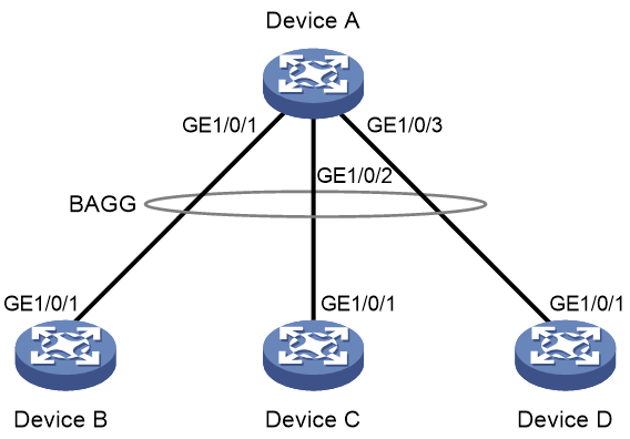

Ethernet link aggregation application scenario
As shown in Figure 1, Device A and Device B are connected by three physical Ethernet links. These physical Ethernet links are combined into an aggregate link called link aggregation 1. The bandwidth of this aggregate link can reach up to the total bandwidth of the three physical Ethernet links. At the same time, the three Ethernet links back up one another. When a physical Ethernet link fails, the traffic transmitted on the failed link is switched to the other two links.
Figure 1 Ethernet link aggregation diagram

S-MLAG
Simple multichassis link aggregation (S-MLAG) enhances dynamic link aggregation to establish an aggregation that spans multiple standalone devices to a remote device.
An S-MLAG multichassis aggregation connects one dynamic Layer 2 aggregate interface on each S-MLAG device to the remote device, as shown in Figure 5.
S-MLAG uses an S-MLAG group to manage the aggregate interfaces for each aggregation, and it runs LACP to maintain each aggregation as does dynamic link aggregation. To the remote device, the S-MLAG devices appear as one peer aggregation system.
Use S-MLAG only to establish aggregate links with servers.
Figure 5 S-MLAG application scenario

Example: Configuring S-MLAG
Device B, Device C, and Device D are standalone devices. As shown in Figure 9, configure Device B, Device C, and Device D as S-MLAG devices to establish a multidevice aggregate link with Device A.
Figure 9 Network diagram
1.     Configure Device A:
# Create Layer 2 aggregate interface Bridge-Aggregation 10, and set the link aggregation mode to dynamic.
<DeviceA> system-view
[DeviceA] interface bridge-aggregation 10
[DeviceA-Bridge-Aggregation10] link-aggregation mode dynamic
[DeviceA-Bridge-Aggregation10] quit
# Assign GigabitEthernet 1/0/1 through GigabitEthernet 1/0/3 to aggregation group 10.
[DeviceA-GigabitEthernet1/0/1] port link-aggregation group 10
[DeviceA-GigabitEthernet1/0/1] quit
[DeviceA] interface gigabitethernet 1/0/2
[DeviceA-GigabitEthernet1/0/2] port link-aggregation group 10
[DeviceA-GigabitEthernet1/0/2] quit
[DeviceA] interface gigabitethernet 1/0/3
[DeviceA-GigabitEthernet1/0/3] port link-aggregation group 10
[DeviceA-GigabitEthernet1/0/3] quit
2.     Configure Device B:
# Set the LACP system MAC address to 0001-0001-0001.
<DeviceB> system-view
[DeviceB] lacp system-mac 1-1-1
# Set the LACP system priority to 123.
[DeviceB] lacp system-priority 123
# Set the LACP system number to 1.
[DeviceB] lacp system-number 1
# Create Layer 2 aggregate interface Bridge-Aggregation 2, and set the link aggregation mode to dynamic.
[DeviceB] interface bridge-aggregation 2
[DeviceB-Bridge-Aggregation2] link-aggregation mode dynamic
# Assign Bridge-Aggregation 2 to S-MLAG group 100.
[DeviceB-Bridge-Aggregation2] port s-mlag group 100
# Assign GigabitEthernet 1/0/1 to aggregation group 2.
[DeviceB-GigabitEthernet1/0/1] port link-aggregation group 2
[DeviceB-GigabitEthernet1/0/1] quit
3.     Configure Device C:
<DeviceC> system-view
[DeviceC] lacp system-mac 1-1-1
[DeviceC] lacp system-priority 123
# Set the LACP system number to 2.
[DeviceC] lacp system-number 2
# Create Layer 2 aggregate interface Bridge-Aggregation 3, and set the link aggregation mode to dynamic.
[DeviceC] interface bridge-aggregation 3
[DeviceC-Bridge-Aggregation3] link-aggregation mode dynamic
# Assign Bridge-Aggregation 3 to S-MLAG group 100.
[DeviceC-Bridge-Aggregation3] port s-mlag group 100
# Assign GigabitEthernet 1/0/1 to aggregation group 3.
[DeviceC] interface gigabitethernet 1/0/1
[DeviceC-GigabitEthernet1/0/1] port link-aggregation group 3
[DeviceC-GigabitEthernet1/0/1] quit
4.     Configure Device D:
<DeviceD> system-view
[DeviceD] lacp system-mac 1-1-1
[DeviceD] lacp system-priority 123
# Set the LACP system number to 3.
[DeviceD] lacp system-number 3
# Create Layer 2 aggregate interface Bridge-Aggregation 4, and set the link aggregation mode to dynamic.
[DeviceD] interface bridge-aggregation 4
[DeviceD-Bridge-Aggregation4] link-aggregation mode dynamic
# Assign Bridge-Aggregation 4 to S-MLAG group 100.
[DeviceD-Bridge-Aggregation4] port s-mlag group 100
# Assign GigabitEthernet 1/0/1 to aggregation group 4.
[DeviceD] interface gigabitethernet 1/0/1
[DeviceD-GigabitEthernet1/0/1] port link-aggregation group 4
[DeviceD-GigabitEthernet1/0/1] quit
# Verify that GigabitEthernet 1/0/1 through GigabitEthernet 1/0/3 on Device A are Selected ports.
[DeviceA] display link-aggregation verbose
Loadsharing Type: Shar -- Loadsharing, NonS -- Non-Loadsharing
Port Status: S -- Selected, U -- Unselected, I -- Individual
Port: A -- Auto port, M -- Management port, R -- Reference port
Flags:  A -- LACP_Activity, B -- LACP_Timeout, C -- Aggregation,
        G -- Defaulted, H -- Expired
Aggregate Interface: Bridge-Aggregation10
Creation Mode: Manual
Aggregation Mode: Dynamic
Management VLANs: None
System ID: 0x8000, 40fa-264f-0100
Local:
  Port                Status   Priority Index    Oper-Key               Flag
  GE1/0/1(R)          S        32768    1        1                      {ACDEF}
  GE1/0/2             S        32768    2        1                      {ACDEF}
  GE1/0/3             S        32768    3        1                      {ACDEF}
Remote:
  Actor               Priority Index    Oper-Key SystemID               Flag
  GE1/0/1             32768    16385    50100    0x7b  , 0001-0001-0001 {ACDEF}
  GE1/0/2             32768    32769    50100    0x7b  , 0001-0001-0001 {ACDEF}
  GE1/0/3             32768    49153    50100    0x7b  , 0001-0001-0001 {ACDEF}
