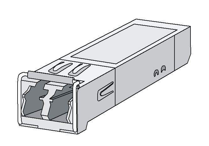

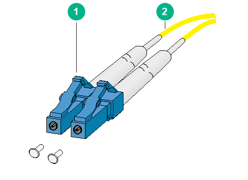

You must use an SFP transceiver module and optical fiber with an LC connector to connect the fiber port on the AP.
Figure5-1 SFP transceiver module
Figure5-2 Optical fibers with LC connectors
(1) LC connector |
(2) Optical fiber |

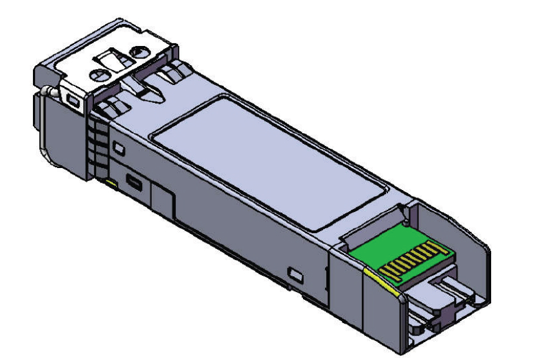

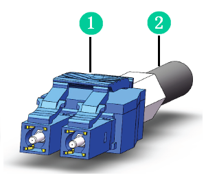

Insert PoE optical transceiver modules only into the photoelectric hybrid ports (PSFP or PSFP+ ports). To connect the photoelectric hybrid ports, use hybrid copper-fiber cables with fiber PoE patch cords.
Figure5-3 PoE optical transceiver module
Figure5-4 Hybrid copper-fiber cable with fiber PoE patch cord
(1) Fiber PoE patch cord |
(2) Hybrid copper-fiber cable |
