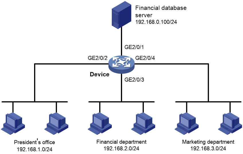

Example: Configuring interface-based packet filter
A company interconnects its departments through the device. Configure a packet filter to:
· Permit access from the President's office at any time to the financial database server.
· Permit access from the Finance department to the database server only during working hours (from 8:00 to 18:00) on working days.
· Deny access from any other department to the database server.
Figure 1 Network diagram

# Apply IPv4 advanced ACL 3000 to filter outgoing packets on interface GigabitEthernet 2/0/1.
[Device] interface gigabitethernet 2/0/1
[Device-GigabitEthernet2/0/1] packet-filter 3000 outbound

# Display configuration and match statistics for IPv4 advanced ACL 3000 on the device during working hours.
[Device] display acl 3000
Advanced IPv4 ACL 3000, 3 rules,
ACL's step is 5
rule 0 permit ip source 192.168.1.0 0.0.0.255 destination 192.168.0.100 0
rule 5 permit ip source 192.168.2.0 0.0.0.255 destination 192.168.0.100 0 time-range work (Active)
rule 10 deny ip destination 192.168.0.100 0
The output shows that rule 5 is active. Rule 5 and rule 10 have been matched four times as the result of the ping operations.
