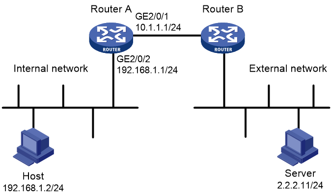

Figure 2 FTP inspection
As shown in Figure 2, FTP connections are established and removed as follows:
1.     The FTP client initiates an FTP control connection from port 1333 to port 21 of the FTP server.
2.     As a result of negotiation, the server initiates a data connection from port 20 to port 1600 of the client.
3.     When data transmission times out or ends, the data connection is removed.
ASPF implements FTP inspection during the FTP connection lifetime as follows:
1.     ASPF checks the IP packets the FTP client sends to the FTP server to identify TCP-based FTP packets. Based on the port number, ASPF identifies the control connection between the FTP client and server and creates a control connection session entry.
2.     ASPF checks each FTP control connection packet, and examines their TCP status based on the control connection session entry. ASPF analyzes the FTP instructions in the control connection packet. If the packet contains a data channel setup instruction, ASPF creates an associated entry for the data connection.
3.     For return FTP control connection packets, ASPF examines their TCP status based on the control connection session entry to make packet forwarding decisions.
4.     When the FTP data passes through the device, ASPF is triggered to create a session entry for the data connection and remove the associated entry.
5.     For returned FTP data packets, ASPF examines their TCP status based on the data connection session entry to make packet forwarding decisions.
6.     When the data transmission ends, ASPF removes the data connection session entry. When the FTP connection is removed, ASPF removes the control connection session entry.

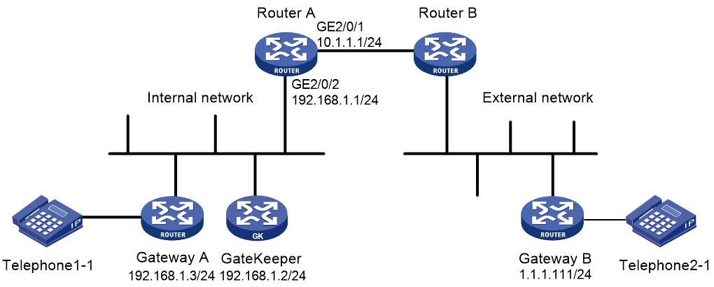

Example: Configuring ASPF H.323 application inspection
Figure 5 displays a typical H.323 application network. Gateway B on the external network needs to access the H.323 Gatekeeper, and with the assistance of Gatekeeper, to establish a connection with the H.323 Gateway A. Other protocol packets from the external network are dropped.
Configure a packet filter on Router A to permit only packets destined to the Gatekeeper. Configure an ASPF policy on Router A to detect H.323 protocol packets so that return packets to the external network can be passed through GigabitEthernet 2/0/1.
Figure 5 Network diagram
# Create ACL 3200 and configure two rules in the ACL: one to permit packets destined to Gatekeeper to pass, and one to deny all IP packets.

  Source      IP/port: 1.1.1.111/3521
  Destination IP/port: 192.168.1.2/20155
  VPN instance/VLAN ID/Inline ID: -/-/-
  Protocol: TCP(6)
  Inbound interface: GigabitEthernet2/0/1
Initiator:
  Source      IP/port: 1.1.1.111/33185
  Destination IP/port: 192.168.1.3/32829
  Protocol: UDP(17)
Initiator:
  Source      IP/port: 1.1.1.111/3688
  Destination IP/port: 192.168.1.2/1720
  Protocol: TCP(6)
Total sessions found: 5
# Verify that only return packets that match the entries can pass through GigabitEthernet 2/0/1. (Details not shown.)
