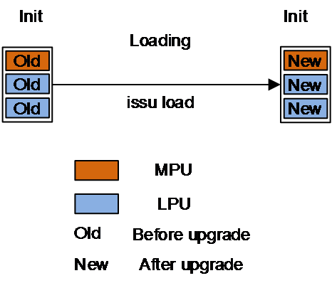

Performing an incremental upgrade on a single-MPU device
As shown in Figure 1, the upgrade operates as follows:
1.     The device is in Init state before the upgrade and enters Loading state when the issu load command is executed to upgrade the MPU. When the MPU upgrade completes, the device enters Loaded state.
2.     The device enters Accepted state when the issu accept command is executed successfully to accept the upgrade to a compatible version and delete the automatic rollback timer.
3.     The device enters Committing state when the issu commit command is executed to upgrade the LPUs, and it enters Init state when the LPU upgrade completes.
IMPORTANT
IMPORTANT:
If a rollback is performed during the upgrade process, the system will roll back to the version before the upgrade.
Figure 1 Performing an incremental upgrade on a single-MPU device or a single-MPU single-chassis IRF fabric

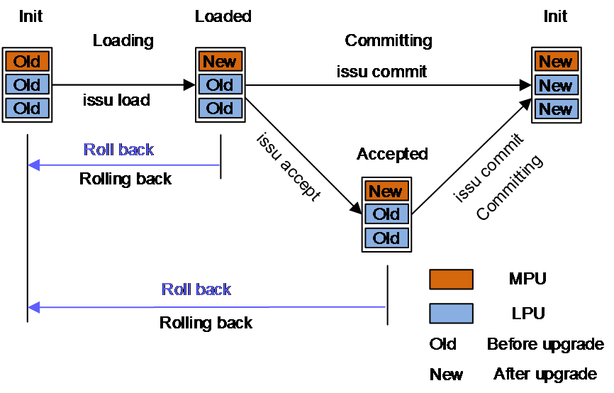

Performing an upgrade on a dual-MPU device (distributed devices in standalone mode) or a dual-MPU single-chassis IRF fabric (distributed devices in IRF mode)
As shown in Figure 3, the upgrade operates as follows:
1.     The device is in Init state before the upgrade and enters Loading state when the issu load command is executed to upgrade the standby MPU. When the upgrade completes, the device enters Loaded state.
2.     The device enters Switching state when the issu run switchover command is executed to perform an ISSU switchover. When the switchover completes, the device enters Switchover state.
3.     The device enters Accepted state when the issu accept command is executed successfully to accept the upgrade to a compatible version and delete the automatic rollback timer.
4.     The device enters Committing state when the issu commit command is executed to upgrade the original active MPU, and it enters Init state when the upgrade completes.
IMPORTANT
IMPORTANT:
Figure 3 Performing an upgrade on a dual-MPU device or a dual-MPU single-chassis IRF fabric

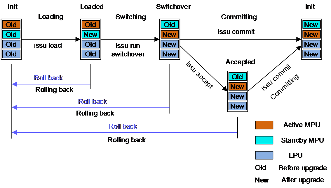

Performing an incompatible upgrade on a dual-MPU device (distributed devices in standalone mode) or a dual-MPU single-chassis IRF fabric (distributed devices in IRF mode)
As shown in Figure 4, the upgrade operates as follows:
2.     The device enters Switching state when the issu run switchover command is executed to perform an ISSU switchover. All the other cards will be upgraded. When the switchover completes, the device enters Init state.
IMPORTANT
IMPORTANT:
Figure 4 Performing an incompatible upgrade on a dual-MPU device or a dual-MPU single-chassis IRF fabric
