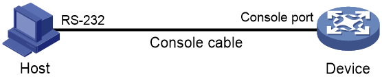

You can connect a terminal to the console port of the device to log in and manage the device, as shown in Figure 2. For information about the login procedure, see "Using the console port for the first device access."
Figure 2 Logging in through the console port
By default, console login is enabled and does not require authentication. The default user role is network-admin for a console user. To improve device security, configure password or scheme authentication for console login immediately after you log in to the device for the first time.
A console login configuration change takes effect only on users who log in after the change is made. It does not affect users who are already online when the change is made.

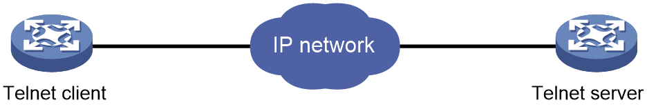

Using the device to log in to a Telnet server
You can use the device as a Telnet client to log in to a Telnet server.
Figure 3 Telnetting from the device to a Telnet server
Assign an IP address to the device and obtain the IP address of the Telnet server. If the device resides on a different subnet than the Telnet server, make sure the device and the Telnet server can reach each other.
2.     (Optional.) Specify the source IPv4 address or source interface for outgoing Telnet packets.
telnet client source { interface interface-type interface-number | ip ip-address }
By default, no source IPv4 address or source interface is specified. The device uses the primary IPv4 address of the output interface as the source address for outgoing Telnet packets.
3.     Return to user view.
4.     Use the device to log in to a Telnet server.
IPv4:
telnet remote-host [ service-port ] [ vpn-instance vpn-instance-name ] [ source { interface interface-type interface-number | ip ip-address } | dscp dscp-value ] * [ escape character ]
IPv6:
telnet ipv6 remote-host [ -i interface-type interface-number ] [ port-number ] [ vpn-instance vpn-instance-name ] [ source { interface interface-type interface-number | ipv6 ipv6-address } | dscp dscp-value ] * [ escape character ]

Using the device to log in to an SSH server
You can use the device as an SSH client to log in to an SSH server.
Figure 4 Logging in to an SSH server from the device
Assign an IP address to the device and obtain the IP address of the SSH server. If the device resides on a different subnet than the SSH server, make sure the device and the SSH server can reach each other.
To use the device to log in to an SSH server, execute one of the following commands in user view:
IPv4:
ssh2 server
IPv6:
ssh2 ipv6 server
To work with the SSH server, you might need to specify a set of parameters. For more information, see Security Configuration Guide.

Example: Controlling Telnet login
As shown in Figure 5, the device is a Telnet server.
Configure the device to permit only Telnet packets sourced from Host A and Host B.
Figure 5 Network diagram
# Configure an ACL to permit packets sourced from Host A and Host B.
<Sysname> system-view
[Sysname] acl basic 2000 match-order config
[Sysname-acl-ipv4-basic-2000] rule 1 permit source 10.110.100.52 0
[Sysname-acl-ipv4-basic-2000] rule 2 permit source 10.110.100.46 0
[Sysname-acl-ipv4-basic-2000] quit
# Apply the ACL to filter Telnet logins.
[Sysname] telnet server acl 2000
