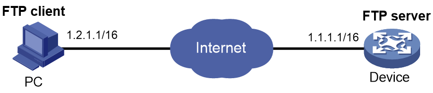

Example: Using the device as an FTP server
·           Configure the device as an FTP server.
·           Create a local user account named abc on the FTP server. Set the password to hello12345.
·           Use the user account to log in to the FTP server from the FTP client.
·           Upload the temp.bin file from the FTP client to the FTP server.
·           Download configuration file startup.cfg from the FTP server to the FTP client for backup.
Figure 1 Network diagram
Configure IP addresses as shown in Figure 1. Make sure the device and PC can reach other.
1.      Configure the device (FTP server):
# Create a local user named abc. Set the password to hello12345.
<Sysname> system-view
[Sysname] local-user abc class manage
[Sysname-luser-manage-abc] password simple hello12345
# Assign the network-admin user role to the user. Set the working directory to the root directory of the flash memory on the active MPU. ()
[Sysname-luser-manage-abc] authorization-attribute user-role network-admin work-directory flash:/
To set the working directory to the root directory of the flash memory on the standby MPU, you must include the slot number in the directory path.
# Assign the service type FTP to the user.
[Sysname-luser-manage-abc] service-type ftp
[Sysname-luser-manage-abc] quit
# Enable the FTP server.
[Sysname] ftp server enable
[Sysname] quit
# Examine the storage space for space insufficiency and delete unused files for more free space.
<Sysname> dir
Directory of flash:
     0      drw-           -  Jan 29 2020 18:30:38     logfile
     1      drw-           -  Jan 21 2020 14:51:38     diagfile
     2      drw-           -  Jan 21 2020 14:51:38     seclog
     3      -rw-        2943  Jan 02 2020 08:03:08     startup.cfg
     4      -rw-       63901  Jan 02 2020 08:03:08     startup.mdb
     5      -rw-         716  Jan 21 2020 14:58:02     hostkey
     6      -rw-         572  Jan 21 2020 14:58:02     serverkey
     7      -rw-     6541264  Jan 04 2020 20:40:49     backup.bin
473664 KB total (467080 KB free)
<Sysname> delete /unreserved flash:/backup.bin
2.      Perform FTP operations from the PC (FTP client):
# Log in to the FTP server at 1.1.1.1 using username abc and password hello12345.
c:\> ftp 1.1.1.1
Connected to 1.1.1.1.
220 FTP service ready.
User(1.1.1.1:(none)):abc
331 Password required for abc.
Password:
230 User logged in.
# Use the ASCII mode to download configuration file startup.cfg from the device to the PC for backup.
ftp> ascii
200 TYPE is now ASCII
ftp> get startup.cfg back-startup.cfg
# Use the binary mode to upload the file temp.bin from the PC to the root directory of the flash memory on the active MPU.
ftp> binary
200 TYPE is now 8-bit binary
ftp> put temp.bin
# Exit FTP.
ftp> bye
Using the device as an FTP client

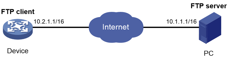

Example: Using the device as an FTP client
As shown in Figure 2, the PC is acting as an FTP server. A user account with username abc and password hello12345 has been created on the PC.
·           Use the device as an FTP client to log in to the FTP server.
·           Download the temp.bin file from the PC to the device.
·           Upload configuration file startup.cfg from the device to the PC for backup.
Figure 2 Network diagram
Configure IP addresses as shown in Figure 2. Make sure the device and PC can reach each other.
# Examine the storage space of the device. If the free space is insufficient, use the delete /unreserved file command to delete unused files. (Details not shown.)
# Log in to the FTP server at 10.1.1.1 using username abc and password hello12345.
<Sysname> ftp 10.1.1.1
Press CTRL+C to abort.
Connected to 10.1.1.1 (10.1.1.1).
220 WFTPD 2.0 service (by Texas Imperial Software) ready for new user
User (10.1.1.1:(none)): abc
331 Give me your password, please
Password:
230 Logged in successfully
Remote system type is MSDOS.
ftp>
# Set the file transfer mode to binary.
ftp> binary
# Download the temp.bin file from the PC to the root directory of the flash memory on the active MPU.
ftp> get temp.bin
local: temp.bin remote: temp.bin
150 Connecting to port 47457
226 File successfully transferred
23951480 bytes received in 95.399 seconds (251.0 kbyte/s)
# Download the temp.bin file from the PC to the root directory of the flash memory on the standby MPU (in slot 1).
ftp> get temp.bin slot1#flash:/temp.bin
# Use the ASCII mode to upload configuration file startup.cfg from the device to the PC for backup.
ftp> ascii
ftp> put startup.cfg back-startup.cfg
local: startup.cfg remote: back-startup.cfg
150 Connecting to port 47461
3494 bytes sent in 5.646 seconds (618.00 kbyte/s)
ftp> bye
221-Goodbye. You uploaded 2 and downloaded 2 kbytes.
221 Logout.
<Sysname>
