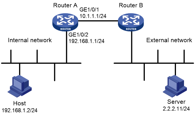

Example: Configuring ASPF FTP application inspection
Configure an ASPF policy on Router A to inspect the FTP traffic flows passing through Router A. Only return packets for FTP connections initiated by users on the internal network are permitted to pass through Router A and get into the internal network. All other types of packets from the external network to the internal network are blocked.
Figure 3 Network diagram
# Configure ACL 3111 to deny all IP packets.
<RouterA> system-view
[RouterA] acl advanced 3111
[RouterA-acl-ipv4-adv-3111] rule deny ip
[RouterA-acl-ipv4-adv-3111] quit
# Create ASPF policy 1 for FTP inspection.
[RouterA] aspf-policy 1
[RouterA-aspf-policy-1] detect ftp
[RouterA-aspf-policy-1] quit
# Apply ACL 3111 to deny all incoming IP packets on GigabitEthernet 1/0/1.
[RouterA] interface gigabitethernet 1/0/1
[RouterA-GigabitEthernet1/0/1] packet-filter 3111 inbound
# Apply ASPF policy 1 to the outgoing traffic on GigabitEthernet 1/0/1.
[RouterA-GigabitEthernet1/0/1] aspf apply policy 1 outbound
[RouterA-GigabitEthernet1/0/1] quit
# Verify that an ASPF session has been established for the FTP connection between the host and the FTP server.
[RouterA] display aspf session ipv4
Slot 0:
Initiator:
  Source      IP/port: 192.168.1.2/1877
  Destination IP/port: 2.2.2.11/21
  VPN instance/VLAN ID/Inline ID: -/-/-
  Protocol: TCP(6)
  Inbound interface: GigabitEthernet1/0/1
Total sessions found: 1
# Verify that only the return packets of FTP connections can enter the internal network. (Details not shown.)

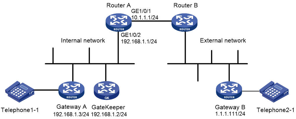

Example: Configuring ASPF H.323 application inspection
Figure 5 displays a typical H.323 application network. Gateway B on the external network needs to access the H.323 Gatekeeper, and with the assistance of Gatekeeper, to establish a connection with the H.323 Gateway A. Other protocol packets from the external network are dropped.
Configure a packet filter on Router A to permit only packets destined to the Gatekeeper. Configure an ASPF policy on Router A to detect H.323 protocol packets so that return packets to the external network can be passed through GigabitEthernet 1/0/1.
Figure 5 Network diagram
# Create ACL 3200 and configure two rules in the ACL: one to permit packets destined to Gatekeeper to pass, and one to deny all IP packets.
[RouterA] acl advanced 3200
[RouterA-acl-ipv4-adv-3200] rule 0 permit ip destination 192.168.1.2 0
[RouterA-acl-ipv4-adv-3200] rule 5 deny ip
[RouterA-acl-ipv4-adv-3200] quit
# Create ASPF policy 1 for H.323 inspection.
[RouterA] aspf policy 1
[RouterA-aspf-policy-1] detect h323
# Apply ACL 3200 to filter incoming packets on GigabitEthernet 1/0/1.
[RouterA-GigabitEthernet1/0/1] packet-filter 3200 inbound
# Apply ASPF policy 1 to incoming traffic on GigabitEthernet 1/0/1.
[RouterA-GigabitEthernet1/0/1] aspf apply policy 1 inbound
# Verify that ASPF sessions have been created between Gateway B and Gatekeeper/Gateway A.
Slot 0:
Initiator:
  Source      IP/port: 1.1.1.111/33184
  Destination IP/port: 192.168.1.3/32828
  Protocol: UDP(17)
Initiator:
  Source      IP/port: 1.1.1.111/1719
  Destination IP/port: 192.168.1.2/1719
  Protocol: UDP(17)
