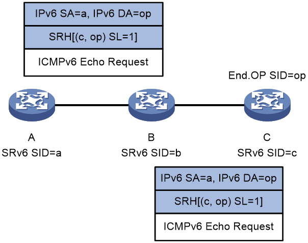

End.OP SID
An End.OP SID is an SRv6 SID of OAM type used in SRv6 SID/SRv6 TE policy-based ping/tracert operations.
·     When you perform an end-to-end SRv6 SID-based ping operation or hop-by-hop SRv6 SID-based tracert operation, the last hop is typically not an End.OP SID. When a device receives a request packet destined for an End.OP SID, it further checks the next SRv6 SID in the packet. If the SRv6 SID is the local SRv6 SID of the destination node, the device sends a reply. If the SRv6 SID is not the local SRv6 SID of the destination node, the device discards the packet.
·     When you perform a segment-by-segment SRv6 SID ping, overlay SRv6 SID tracert, or SRv6 TE policy-based ping or tracert operation, the last hop is typically an End.OP SID. After you specify an End.OP SID, make sure the SIDs following the End.OP SID in the SID list do not include the local SID of any other destination node. If this requirement is not met, the device might not respond to the SIDs following the End.OP SID in the SID list.
Take end-to-end SRv6 SID-based ping as an example. As shown in Figure 2, in order to ping Device C, Device A constructs an ICMPv6 echo request by adding the End.OP SID of Device C to the SRH header in the request. Upon receiving the request and finding that request is destined for the local End.OP SID, Device C further checks whether SRv6 SID c is the local SRv6 SID. If it is the local SRv6 SID, Device C sends an ICMPv6 echo reply; if not, Device C discards the ICMPv6 echo request.
Figure 2 End.OP SID used in an SRv6 SID-based ping

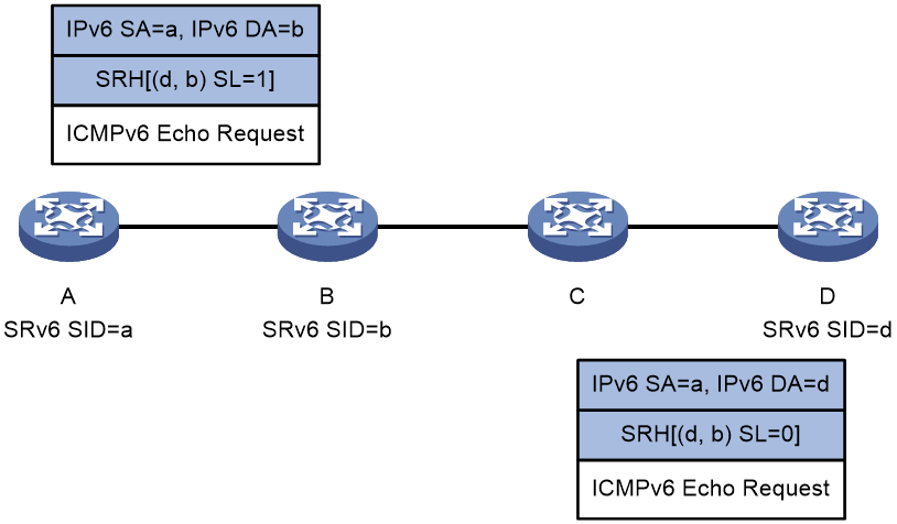

Segment-by-segment ping
Use segment-by-segment ping to detect connectivity of all SRv6 nodes in the SRv6 path. All SRv6 nodes will send an ICMPv6 echo reply to the source node.
The End.OP SID specified for a segment-by-segment ping operation must be the SID of the last hop. If other SIDs are following the End.OP SID, make sure those following SIDs are not the local SRv6 SID of the destination node. If this requirement is not met, the ping operation might fail.
Figure 3 Segment-by-segment ping
Figure 3 shows the segment-by-segment ping process as follows:
1.     Device A initiates a ping to Device D, with the SRv6 SIDs of Device B and Device D specified. It constructs an ICMPv6 echo request encapsulated with an SRH and then sends the request.
2.     Upon receiving the ICMPv6 echo request, the intermediate node performs relevant operations depending on whether it is SRv6 capable:
¡     On an SRv6 capable node (such as Device B):
The node sends an ICMPv6 echo reply to Device A, and forwards the ICMPv6 echo request based on the SRH if the following conditions exist:
-     The packet destination IPv6 address is the local SRv6 SID.
-     The O-flag is set in the packet SRH Flags field.
¡     On an SRv6 incapable node (such as Device C):
The node forwards the ICMPv6 echo request according to routing table lookup without returning an ICMPv6 echo reply to Device A.
3.     Upon receiving the ICMPv6 echo request with O-flag set and SL=0 in the SRH, Device D verifies the packet destination IPv6 address.
¡     If the IPv6 address is the local SRv6 SID, the verification succeeds, and Device D sends an ICMPv6 echo reply to Device A.
¡     If the IPv6 address is not the local SRv6 SID, the verification fails, and Device D discards the ICMPv6 echo request.
4.     Device A determines whether the destination node is reachable based on reception of the ICMPv6 echo reply:
¡     If the ICMPv6 echo reply is received before the specified timeout timer expires, the destination node is reachable.
¡     If no ICMPv6 echo reply is received when the specified timeout timer expires, the destination node is unreachable.

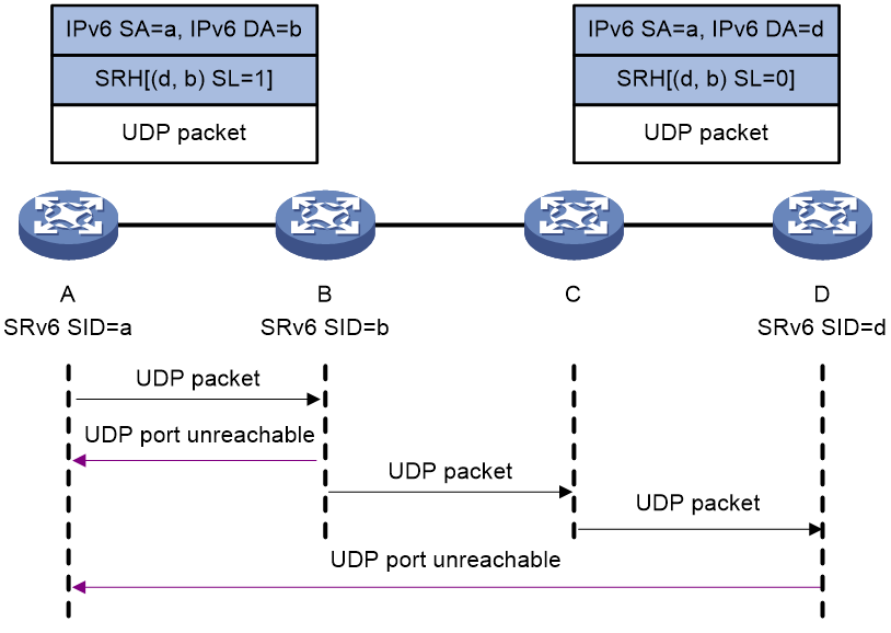

Overlay tracert
Use overlay tracert to display information about only SRv6 nodes in the SRv6 path.
The End.OP SID specified for an overlay tracert operation must be the SID of the last hop. If other SIDs are following the End.OP SID, make sure those following SIDs are not the local SRv6 SID of the destination node. If this requirement is not met, the overlay tracert operation might fail.

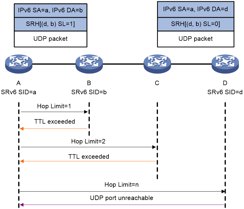

Figure 5 Overlay tracert
Figure 5 shows the overlay tracert process as follows:
1.     Device A initiates a tracert to Device D, with the SRv6 SIDs of Device B and Device D specified. It constructs a UDP packet encapsulated with an SRH and then sends the UDP packet (the Hop Limit value is 64 in the IPv6 packet header).
Make sure you specify a destination UDP port that is not used by any applications on the destination node.
2.     Upon receiving the UDP packet, the intermediate node performs relevant operations depending on whether it is SRv6 capable:
The node sends an ICMPv6 port unreachable message to Device A, and then forwards the UDP packet based on the SRH if the following conditions exist:
The node forwards the UDP packet according to routing table lookup without returning an ICMPv6 port unreachable message.
3.     Upon receiving the UDP packet with O-flag set and SL=0 in the SRH, Device D verifies the packet destination IPv6 address.
¡     If the IPv6 address is the local SRv6 SID, the verification succeeds, and Device D sends an ICMPv6 port unreachable message to Device A.
¡     If the IPv6 address is not the local SRv6 SID, the verification fails, and Device D discards the UDP packet.
4.     Device A determines whether the destination node is reachable based on reception of the ICMPv6 port unreachable message:
¡     If the ICMPv6 port unreachable message is received before the specified timeout timer expires, the destination node is reachable. The tracert result displays the SRv6 path from the source node to the destination node.
¡     If no ICMPv6 port unreachable message is received when the specified timeout timer expires, the destination node is unreachable. You can locate the faulty node based on the tracert result.
