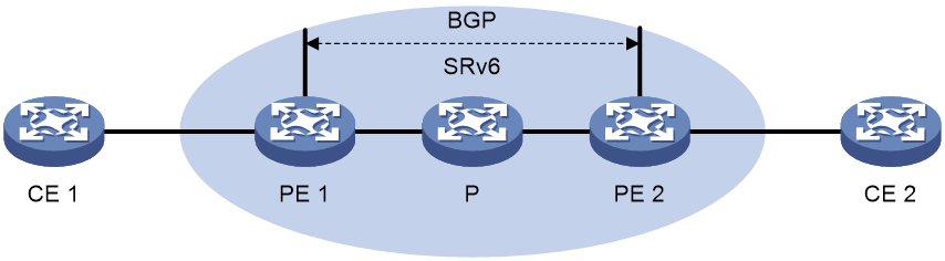

Basic principle
Figure 1 shows a typical public network IP over SRv6 network. PE 1 and PE 2 use BGP to advertise public network IPv6 routes to each other over the IPv6 backbone network. The PEs use an SRv6 tunnel between them to forward public network traffic across sites.
Public network IP over SRv6 connects geographically dispersed sites that belong to the public network over the IPv6 backbone network.
Figure 1 Network diagram
Route advertisement
Public network IPv4 over SRv6 and public network IPv6 over SRv6 use the same process to advertise routes. The following information uses public network IPv4 over SRv6 as an example to illustrate the process.
As shown in Figure 1, local routes of CE 1 are advertised to CE 2 by using the following process:
1.     CE 1 uses static routing, RIP, OSPF, IS-IS, EBGP, or IBGP to advertise routes of the local site to PE 1.
2.     After learning the route information of CE 1, PE 1 stores the routes of the local site to the routing table of the public network. At the same time, PE 1 converts the routes to BGP IPv4 unicast routes and adds the same End.DT4 or End.DT46 SID to the routes. Alternatively, PE 1 adds the same End.DX4 SID to the routes with the same next hop. Then, PE 1 advertises the BGP IPv4 unicast routes with the End.DT4, End.DT46, or End.DX4 SID to PE 2.
3.     When PE 2 receives the IPv4 unicast routes advertised by PE 1, it adds the routes to the routing table of the public network. PE 2 removes the End.DT4, End.DT46, or End.DX4 SID information from the routes, records the End.DT4, End.DT46, and End.DX4 information, and then advertises the routes to CE 2.
4.     By adding the received IPv4 unicast routes to the routing table, CE 2 learns the routes of CE 1.

This mode is also called SID-based forwarding mode. In this mode, a PE forwards an SRv6 packet by searching the IPv6 routing table based on the SRv6 SID encapsulated in the packet.
Public network IPv4 over SRv6 and public network IPv6 over SRv6 use the same process to forward packets. The following information uses public network IPv4 over SRv6 as an example to illustrate the process.
As shown in Figure 1, CE 2 forwards an IPv4 packet to CE 1 as follows:
1.     CE 2 sends the IPv4 packet to PE 2.
2.     After PE 2 receives the packet, it searches for a route that matches the destination IPv4 address of the packet in the routing table of the public network. The corresponding End.DT4, End.DT46, or End.DX4 SID is found. Then, PE 2 encapsulates an outer IPv6 header for the packet. The End.DT4, End.DT46, or End.DX4 SID is encapsulated in the outer IPv6 header as the destination address.
3.     PE 2 searches the IPv6 routing table based on the End.DT4, End.DT46, or End.DX4 SID for the optimal IGP route and forwards the packet to P through the route.
4.     P searches the IPv6 routing table based on the End.DT4, End.DT46, or End.DX4 SID for the optimal IGP route and forwards the packet to PE 1 through the route.
5.     When PE 1 receives the packet, it processes the packet as follows:
¡     If the packet header contains an End.DT4 or End.DT46 SID, PE 1 searches the local SID forwarding table for the SID and removes the outer IPv6 header. Then, PE 1 matches the packet to the public instance based on the SID, looks up the public network routing table, and forwards the packet to CE 1.
¡     If the packet header contains an End.DX4 SID, PE 1 searches the local SID forwarding table for the SID and removes the outer IPv6 header. Then, PE 1 forwards the packet to CE 1 according to the next hop and output interface bound to the SID.

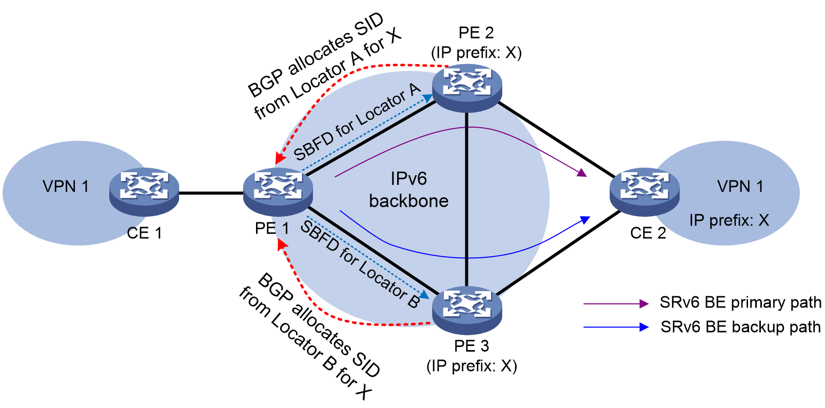

6.     (Optional.) Configuring SBFD for SRv6 locators
As shown in Figure 3, in the public network IP over SRv6 BE scenario, CE 2 is dual homed to PE 2 and PE 3. After you enable FRR on PE 1, a primary path and a backup path are generated on PE 1. When the primary path fails, you can configure this feature for fast traffic switchover to the backup path. Use SBFD to detect connectivity of SRv6 locators advertised by PE 2 (used as next hop addresses obtained through route recursion for public network routes) to fast locate primary path failures and switch traffic over to the backup path.
Figure 3 Using SBFD to detect SRv6 locators in a dual-homed network
SBFD detects the connectivity of SRv6 locators as follows:
1.     PE 1 sends SBFD packets as the initiator. The SRv6 locators are the destination addresses of the SBFD packets. The IP address specified in the sbfd source-ipv6 command is used as the source IP address of SBFD packets.
2.     When PE 2 and PE 3 receive the SBFD packets as reflectors, they compare the remote discriminators in the packets with the locally configured discriminators.
¡     If they are consistent, the reflectors send SBFD response packets to the initiator through IPv6 routes.
¡     If they are inconsistent, the reflectors drop the received SBFD packets.
3.     If the initiator can receive SBFD response packets before the detection timer expires, it determines that the SRv6 locators are reachable. If not, the initiator determines that the SRv6 locators are unreachable, and switches over to the backup path.
To have this feature take effect, execute the sbfd destination ipv6 remote-discriminator command on PE 1 to configure the mappings between the detected SRv6 locators and remote discriminators. In addition, execute the sbfd local-discriminator command on PE 2 and PE 3 to configure the local discriminators on the reflector end. Make sure PE 1 have consistent discriminator settings with PE 2 and PE 3. For more information about the sbfd destination ipv6 remote-discriminator and sbfd local-discriminator commands, see BFD commands in High Availability Command Reference.

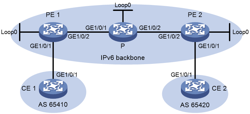

Example: Configuring public network IPv6 over SRv6 in SRv6 BE mode
As shown in Figure 4, the backbone network is an IPv6 network. Deploy public network IPv6 over SRv6 between PE 1 and PE 2 and use an SRv6 tunnel to transmit IPv4 traffic between the PEs.
·     Configure EBGP to exchange customer site routing information between the CEs and PEs.
·     Configure IPv6 IS-IS on the PEs in the same AS to realize IPv6 network connectivity.
·     Configure IBGP to exchange IPv4 routing information between the PEs.
Figure 4 Network diagram
Device
Interface
IP address
Device
Interface
IP address
CE 1
GE1/0/1
111::1/96
PE 2
Loop0
3::3/128
PE 1
Loop0
1::1/128
GE1/0/1
222::2/96
GE1/0/1
111::2/96
GE1/0/2
2002::1/96
GE1/0/2
2001::1/96
CE 2
GE1/0/1
222::1/96
P
Loop0
2::2/128
GE1/0/1
2001::2/96
GE1/0/2
2002::2/96
Configure IP addresses for the interfaces (including the Loopback interfaces), as shown in Figure 4.
