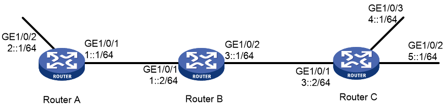

Example: Configuring basic RIPng
As shown in Figure 2, Router A, Router B, and Router C learn IPv6 routing information through RIPng. Configure route filtering on Router B to accept all received routes except the route 2::/64 and to advertise only the route 4::/64.
Figure 2 Network diagram
1.     Configure IPv6 addresses for the interfaces. (Details not shown.)
2.     Configure basic RIPng settings:

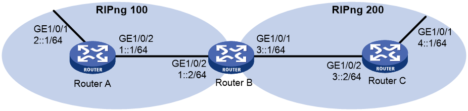

As shown in Figure 3, Router B communicates with Router A through RIPng 100 and with Router C through RIPng 200.
Configure route redistribution on Router B, so the two RIPng processes can redistribute routes from each other.
Figure 3 Network diagram
# Enable RIPng 100 on Router A.
<RouterA> system-view
[RouterA] ripng 100
[RouterA-ripng-100] quit
[RouterA] interface gigabitethernet 1/0/1
[RouterA-GigabitEthernet1/0/1] ripng 100 enable
[RouterA-GigabitEthernet1/0/1] quit
[RouterA] interface gigabitethernet 1/0/2
[RouterA-GigabitEthernet1/0/2] ripng 100 enable
# Enable RIPng 100 and RIPng 200 on Router B.
<RouterB> system-view
[RouterB] ripng 100
[RouterB-ripng-100] quit
[RouterB] interface gigabitethernet 1/0/2
[RouterB-GigabitEthernet1/0/2] ripng 100 enable
[RouterB-GigabitEthernet1/0/2] quit
[RouterB] ripng 200
[RouterB-ripng-200] quit
[RouterB-GigabitEthernet1/0/1] ripng 200 enable
#  Enable RIPng 200 on Router C.
<RouterC> system-view
[RouterC] ripng 200
[RouterC] interface gigabitethernet 1/0/1
[RouterC-GigabitEthernet1/0/1] ripng 200 enable
[RouterC-GigabitEthernet1/0/1] quit
[RouterC] interface gigabitethernet 1/0/2
[RouterC-GigabitEthernet1/0/2] ripng 200 enable
[RouterC-GigabitEthernet1/0/2] quit
# Display the routing table on Router A.
[RouterA] display ipv6 routing-table
Destinations : 7 Routes : 7
Destination: ::1/128                                     Protocol  : Direct
NextHop    : ::1                                         Preference: 0
Interface  : InLoop0                                     Cost      : 0
Destination: 1::/64                                      Protocol  : Direct
NextHop    : ::                                          Preference: 0
Interface  : GE1/0/2                                     Cost      : 0
Destination: 1::1/128                                    Protocol  : Direct
Destination: 2::/64                                      Protocol  : Direct
Interface  : GE1/0/1                                     Cost      : 0
Destination: 2::1/128                                    Protocol  : Direct
Destination: FE80::/10                                   Protocol  : Direct
Interface  : NULL0                                       Cost      : 0
Destination: FF00::/8                                    Protocol  : Direct
3.     Configure RIPng route redistribution:
# Configure route redistribution between the two RIPng processes on Router B.
[RouterB] ripng 100
[RouterB-ripng-100] import-route ripng 200
[RouterB] ripng 200
[RouterB-ripng-200] import-route ripng 100

Example: Configuring RIPng GR
As shown in Figure 4, Router A, Router B, and Router C learn IPv6 routing information through RIPng.
Configure Router A as the GR restarter. Configure Router B and Router C as the GR helpers to synchronize their routing tables with Router A by using GR.
Figure 4 Network diagram
2.     Configure RIPng on the routers to ensure the following: (Details not shown.)
¡     Router A, Router B, and Router C can communicate with each other at Layer 3.
¡     Dynamic route update can be implemented among them with RIPng.
3.     Enable RIPng GR on Router A.
[RouterA] ripng 1
[RouterA-ripng-1] graceful-restart
# Restart RIPng or trigger an active/standby process switchover, and then display GR status on Router A.
<RouterA> display ripng 1 graceful-restart
RIPng process: 1
 Graceful Restart capability    : Enabled
 Current GR state               : Normal
 Graceful Restart period        : 60  seconds
 Graceful Restart remaining time: 0   seconds
