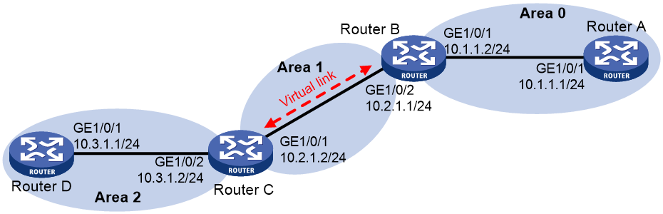

Virtual links
A virtual link is established between two ABRs through a non-backbone area. It must be configured on both ABRs to take effect. The non-backbone area is called a transit area.
As shown in Figure 2, Area 2 has no direct physical link to the backbone Area 0. You can configure a virtual link between the two ABRs to connect Area 2 to the backbone area.
Figure 2 Virtual link application 1
Virtual links can also be used as redundant links. If a physical link failure breaks the internal connectivity of the backbone area, you can configure a virtual link to replace the failed physical link, as shown in Figure 3.
Figure 3 Virtual link application 2
The virtual link between the two ABRs acts as a point-to-point connection. You can configure interface parameters, such as hello interval, on the virtual link as they are configured on a physical interface.
The two ABRs on the virtual link unicast OSPF packets to each other, and the OSPF routers in between convey these OSPF packets as normal IP packets.

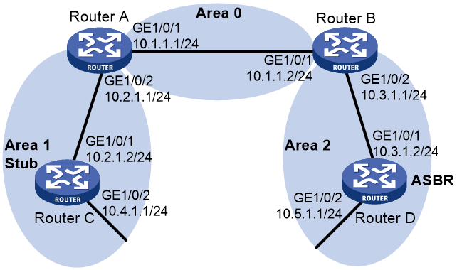

Stub area and totally stub area
A stub area does not distribute Type-5 LSAs to reduce the routing table size and LSAs advertised within the area. The ABR of the stub area advertises a default route in a Type-3 LSA so that the routers in the area can reach external networks through the default route.
To further reduce the routing table size and advertised LSAs, you can configure the stub area as a totally stub area. The ABR of a totally stub area does not advertise inter-area routes or external routes. It advertises a default route in a Type-3 LSA so that the routers in the area can reach external networks through the default route.

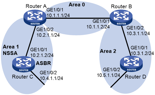

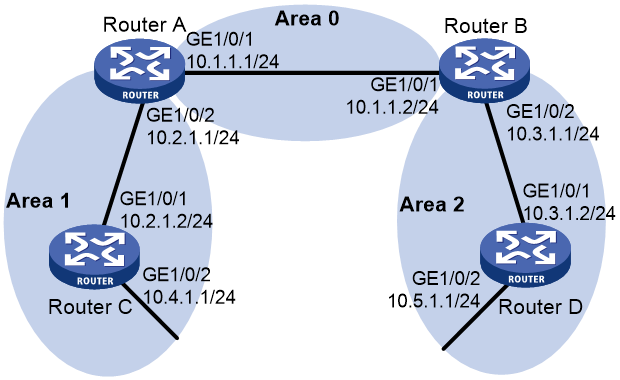

NSSA area and totally NSSA area
An NSSA area does not import AS external LSAs (Type-5 LSAs) but can import Type-7 LSAs generated by the NSSA ASBR. The NSSA ABR translates Type-7 LSAs into Type-5 LSAs and advertises the Type-5 LSAs to other areas.
As shown in Figure 4, the OSPF AS contains Area 1, Area 2, and Area 0. The other two ASs run RIP. Area 1 is an NSSA area where the ASBR redistributes RIP routes in Type-7 LSAs into Area 1. Upon receiving the Type-7 LSAs, the NSSA ABR translates them to Type-5 LSAs, and advertises the Type-5 LSAs to Area 0.
The ASBR of Area 2 redistributes RIP routes in Type-5 LSAs into the OSPF routing domain. However, Area 1 does not receive Type-5 LSAs because it is an NSSA area.
Figure 4 NSSA area

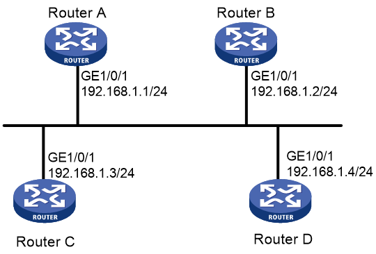

As shown in Figure 6, solid lines are Ethernet physical links, and dashed lines represent OSPF adjacencies. With the DR and BDR, only seven adjacencies are established.
Figure 6 DR and BDR in a network
In OSPF, neighbor and adjacency are different concepts. After startup, OSPF sends a hello packet on each OSPF interface. A receiving router checks parameters in the packet. If the parameters match its own, the receiving router considers the sending router an OSPF neighbor. Two OSPF neighbors establish an adjacency relationship after they synchronize their LSDBs through exchange of DD packets and LSAs.

Configuring a virtual link
You can configure a virtual link to maintain connectivity between a non-backbone area and the backbone, or in the backbone itself.
A virtual link cannot traverse a stub area, totally stub area, NSSA area, or totally NSSA area.
2.     Enter OSPF view.
ospf [ process-id | router-id { auto-select | router-id } | vpn-instance vpn-instance-name ] *
3.     Enter OSPF area view.
area area-id
4.     Configure a virtual link.
vlink-peer router-id [ dead seconds | hello seconds | { authentication-none | { hmac-md5 | hmac-sha-256 | hmac-sm3 | md5 } [ key-id { cipher | plain } string ] | keychain keychain-name | simple [ { cipher | plain } string ] } | retransmit seconds | trans-delay seconds ] *
Configure this command on both ends of a virtual link. The hello and dead intervals must be identical on both ends of the virtual link.

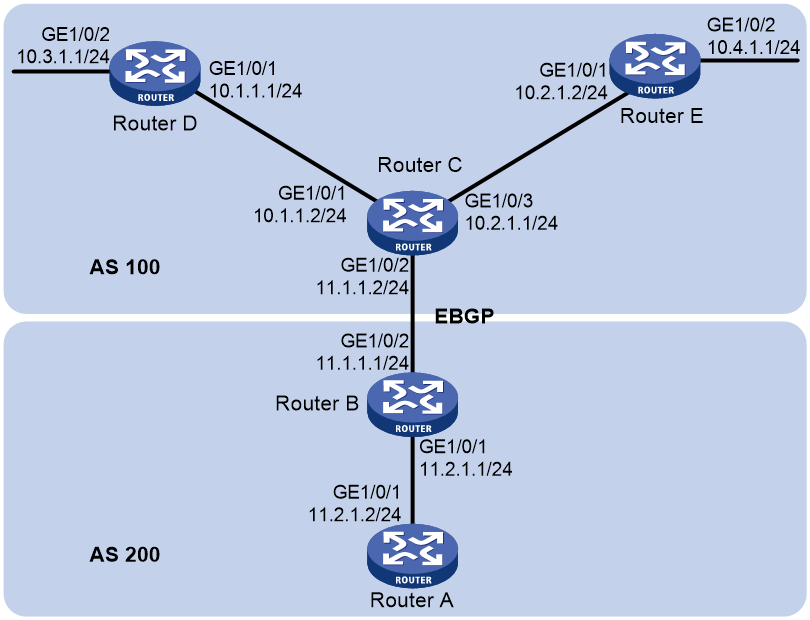

Configuring advanced OSPF features
Configuring stub routers
A stub router is used for traffic control. It reports its status as a stub router to neighboring OSPF routers. The neighboring routers can have a route to the stub router, but they do not use the stub router to forward data.
Router LSAs from the stub router might contain different link type values. A value of 3 means a link to a stub network, and the cost of the link will not be changed by default. To set the cost of the link to 65535, specify the include-stub keyword in the stub-router command. A value of 1, 2 or 4 means a point-to-point link, a link to a transit network, or a virtual link. On such links, a maximum cost value of 65535 is used. Neighbors do not send packets to the stub router as long as they have a route with a smaller cost.
As shown in Figure 10, Device A, Device B, Device C, and Device D run OSPF. Device C is the backup device for Device B. Device A and Device B, Device A and Device C, Device B and Device D, and Device C and Device D are IBGP peers.
When the network is stable, BGP and OSPF can finish route convergence completely. Device A forwards traffic destined for 10.3.1.0/30 to Device B. If Device B fails, Device C will take over to forward the traffic from Device A.
After Device B recovers, Device A immediately forwards the traffic to Device B. However, BGP might have not finished route convergence after OSPF has finished route convergence, because OSPF has a higher route convergence speed than BGP. In this situation, Device B does not have a route to 10.3.1.0/30 and will discard the traffic destined for 10.3.1.0/30. To resolve this issue, configure Device B to act as a stub router during BGP route convergence. Device A will forward traffic to Device C instead of Device B until Device B finishes BGP route convergence.
Figure 10 Network diagram
2.     Enter OSPF view.
3.     Configure the router as a stub router.
stub-router [ external-lsa [ max-metric-value ] | include-stub | on-startup { seconds | wait-for-bgp [ seconds ] } | summary-lsa [ max-metric-value ] ] *
By default, the router is not configured as a stub router.
A stub router is not related to a stub area.

Configuring OSPF FRR
About OSPF FRR
OSPF Fast Reroute (FRR) calculates a backup path based on the LSDB or specifies a backup path by using a routing policy. Then, it saves the backup path information to the FIB. When the primary path fails, the system immediately switches traffic to the backup path to prevent traffic loss and reduce the route convergence time.
OSPF supports Loop Free Alternate (LFA) FRR and remote LFA FRR.
The following OSPF FRR traffic protection types are available:
·     Link protection—Protects traffic that traverses a specific link.
·     Node protection—Protects traffic that traverses a specific node.
Node protection takes precedence over link protection
Restrictions and guidelines for OSPF FRR
When both OSPF PIC and OSPF FRR are configured, OSPF FRR takes effect.
OSPF FRR tasks at a glance
To configure OSPF FRR, perform the following tasks:
1.     Configuring an OSPF backup path
Perform a minimum of one task.
¡     Configuring OSPF LFA FRR
¡     Configuring OSPF remote LFA FRR
¡     Configuring OSPF FRR to use a backup next hop specified in a routing policy
2.      (Optional.) Setting the priority for FRR backup path selection policies
3.     (Optional.) Configuring BFD for OSPF FRR
¡     Configuring BFD control packet mode for OSPF FRR
¡     Configuring BFD echo packet mode for OSPF FRR
A link or router failure on a path can cause packet loss until OSPF completes routing convergence based on the new network topology. FRR enables fast rerouting to minimize the impact of link or node failures.
Figure 11 Network diagram for OSPF FRR
As shown in Figure 11, configure OSPF FRR on Router B to calculate a backup next hop by using the LFA algorithm. When the primary link fails, OSPF directs packets to the backup next hop. At the same time, OSPF calculates the shortest path based on the new network topology. It forwards packets over the path after network convergence.
2.     Enter interface view.
3.     (Optional.) Enable LFA on an interface.
ospf fast-reroute lfa-backup
By default, the interface is enabled with LFA and it can be selected as a backup interface.
4.     Return to system view.
5.     Enter OSPF view.
6.     Enable OSPF FRR to use the LFA algorithm to calculate a backup next hop.
fast-reroute lfa [ abr-only ]
By default, OSPF FRR is disabled.
If abr-only is specified, the route to the ABR is selected as the backup path.

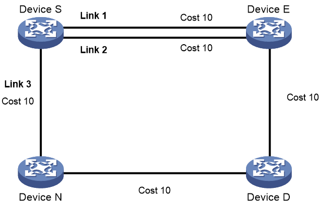

In a network topology where OSPF LFA FRR cannot calculate the backup path, configure remote LFA FRR to ensure network reliability.
Remote LFA uses the following concepts:
·     P space—Use the source node of the protected link as the root to establish a shortest path tree. All nodes that are reachable from the source node without passing the protected link form the P space. Nodes in the P space are called P nodes.
·     Extended P space—Use the source node of the protected link and its neighbors as the roots to establish shortest path trees. All nodes that are reachable from the source node or one of its neighbors without passing the protected link form the extended P space. The P space is a subset of the extended P space.
·     Q space—Use the destination node of the protected link as the root to establish a reverse shortest path tree. All nodes that are reachable from the root node without passing the protected link form the Q space. Nodes in the Q space are called Q nodes.
·     PQ node—A PQ node refers to a node that resides in both the extended P space and the Q space. Remote LFA uses a PQ node as the destination node of a protected link.
As shown in Figure 12, the traffic forwarding path is PE 1—P 1—P 2—PE 2. To avoid traffic loss caused by link failures between P 1 and P 2, the system establishes an LDP tunnel between P 1 and P 4, which is the PQ node. When the link between P 1 and P 2 fails, P 1 encapsulates IP packets in MPLS packets and sends the MPLS packets to P 4 through the LDP tunnel. After receiving the MPLS packets, P 4 removes the MPLS labels of the packets and then forwards the packets to the next hop based on the IP routing table.
The system determines P 4 as the PQ node as follows:
1.     Uses P 1 (source node of the protected link) and its neighbors except P 2 (which passes the protected link) as the roots to establish shortest path trees.
2.     Finds out all nodes that are reachable from P 1 or one of its neighbors without passing the protected link, which are PE 1, P 1, P 3, and P 4.
These nodes form the extended P space.
3.     Uses P 2 (destination node of the protected link) as the root to establish a reverse shortest path tree.
4.     Finds out all nodes that are reachable from P 2 without passing the protected link, which are PE 2 and P 4.
These nodes form the Q space.
5.     Finds out all nodes that reside in both the extended P space and the Q space.
Only P 4 resides in both the extended P space and the Q space, so P 4 is the PQ node of the protected link.
Figure 12 Network diagram for OSPF remote LFA FRR
Enable MPLS and MPLS LDP on all nodes and interfaces participating in MPLS forwarding. For more information, see basic MPLS configuration and LDP configuration in MPLS Configuration Guide.
2.     Enter OSPF view.
3.     Enable OSPF remote LFA FRR.
fast-reroute remote-lfa tunnel ldp
By default, OSPF remote LFA FRR is disabled.
4.     (Optional.) Set the maximum cost from the source node of a protected link to a PQ node.
fast-reroute remote-lfa maximum-cost cost
By default, the maximum cost from the source node of a protected link to a PQ node is 16777215.
5.     (Optional.) Specify a prefix list to filter PQ nodes.
fast-reroute remote-lfa prefix-list prefix-list-name
By default, no prefix list is specified to filter PQ nodes. Any PQ node can be selected as the backup next hop.
Multiple PQ nodes might reach the source node of a specific protected link. You can use this command to specify a prefix list to filter PQ nodes.
6.     (Optional.) Disable remote LFA calculation on an interface.
a.     Return to system view.
b.     Enter interface view.
c.     Disable remote LFA calculation on the interface.
ospf fast-reroute remote-lfa disable
By default, remote LFA calculation is enabled on the interface.

OSPF configuration examples
Example: Configuring basic OSPF
As shown in Figure 16:
·     Enable OSPF on all routers, and split the AS into three areas.
·     Configure Router A and Router B as ABRs.
Figure 16 Network diagram
1.     Configure IP addresses for interfaces. (Details not shown.)
2.     Enable OSPF:
# Configure Router A.
<RouterA> system-view
[RouterA] router id 10.2.1.1
[RouterA] ospf
[RouterA-ospf-1] area 0
[RouterA-ospf-1-area-0.0.0.0] network 10.1.1.0 0.0.0.255
[RouterA-ospf-1-area-0.0.0.0] quit
[RouterA-ospf-1] area 1
[RouterA-ospf-1-area-0.0.0.1] network 10.2.1.0 0.0.0.255
[RouterA-ospf-1-area-0.0.0.1] quit
[RouterA-ospf-1] quit
# Configure Router B.
<RouterB> system-view
[RouterB] router id 10.3.1.1
[RouterB] ospf
[RouterB-ospf-1] area 0
[RouterB-ospf-1-area-0.0.0.0] network 10.1.1.0 0.0.0.255
[RouterB-ospf-1-area-0.0.0.0] quit
[RouterB-ospf-1] area 2
[RouterB-ospf-1-area-0.0.0.2] network 10.3.1.0 0.0.0.255
[RouterB-ospf-1-area-0.0.0.2] quit
[RouterB-ospf-1] quit
# Configure Router C.
<RouterC> system-view
[RouterC] router id 10.4.1.1
[RouterC] ospf
[RouterC-ospf-1] area 1
[RouterC-ospf-1-area-0.0.0.1] network 10.2.1.0 0.0.0.255
[RouterC-ospf-1-area-0.0.0.1] network 10.4.1.0 0.0.0.255
[RouterC-ospf-1-area-0.0.0.1] quit
[RouterC-ospf-1] quit
# Configure Router D.
<RouterD> system-view
[RouterD] router id 10.5.1.1
[RouterD] ospf
[RouterD-ospf-1] area 2
[RouterD-ospf-1-area-0.0.0.2] network 10.3.1.0 0.0.0.255
[RouterD-ospf-1-area-0.0.0.2] network 10.5.1.0 0.0.0.255
[RouterD-ospf-1-area-0.0.0.2] quit
[RouterD-ospf-1] quit
# Display the OSPF neighbors of Router A.
[RouterA] display ospf peer verbose
          OSPF Process 1 with Router ID 10.2.1.1
                  Neighbors
 Area 0.0.0.0 interface 10.1.1.1(GigabitEthernet1/0/1)'s neighbors
 Router ID: 10.3.1.1         Address: 10.1.1.2         GR State: Normal
   State: Full  Mode: Nbr is master  Priority: 1
   DR: 10.1.1.1  BDR: 10.1.1.2  MTU: 0
   Options is 0x02 (-|-|-|-|-|-|E|-)
   Dead timer due in 37  sec
   Neighbor is up for 06:03:59
   Authentication Sequence: [ 0 ]
   Neighbor state change count: 5
   BFD status: Disabled
 Area 0.0.0.1 interface 10.2.1.1(GigabitEthernet1/0/2)'s neighbors
 Router ID: 10.4.1.1         Address: 10.2.1.2         GR State: Normal

Example: Configuring OSPF route redistribution
As shown in Figure 17:
·     Enable OSPF on all the routers.
·     Split the AS into three areas.
·     Configure Router C as an ASBR to redistribute external routes (static routes).
Figure 17 Network diagram
2.     Enable OSPF (see "Example: Configuring basic OSPF").
3.     Configure OSPF to redistribute routes:
# On Router C, configure a static route destined for network 3.1.2.0/24.
[RouterC] ip route-static 3.1.2.1 24 10.4.1.2
# On Router C, configure OSPF to redistribute the static route.
[RouterC] ospf 1
[RouterC-ospf-1] import-route static
# Display the ABR/ASBR information on Router D.
<RouterD> display ospf abr-asbr
          OSPF Process 1 with Router ID 10.5.1.1
                  Routing Table to ABR and ASBR
                Topology base (MTID 0)
 Type        Destination     Area            Cost  Nexthop         RtType
 Intra       10.3.1.1        0.0.0.2         10    10.3.1.1        ABR
 Inter       10.4.1.1        0.0.0.2         22    10.3.1.1        ASBR
# Display the OSPF routing information on Router D.
<RouterD> display ospf routing
                   Routing Table
 Routing for network
 Destination        Cost     Type    NextHop         AdvRouter       Area
 10.2.1.0/24        22       Inter   10.3.1.1        10.3.1.1        0.0.0.2
 10.3.1.0/24        10       Transit 10.3.1.2        10.3.1.1        0.0.0.2
 10.4.1.0/24        25       Inter   10.3.1.1        10.3.1.1        0.0.0.2
 10.5.1.0/24        10       Stub    10.5.1.1        10.5.1.1        0.0.0.2
 10.1.1.0/24        12       Inter   10.3.1.1        10.3.1.1        0.0.0.2
 Routing for ASEs
 Destination        Cost     Type    Tag         NextHop         AdvRouter
 3.1.2.0/24         1        Type2   1           10.3.1.1        10.4.1.1
 Total nets: 6
 Intra area: 2  Inter area: 3  ASE: 1  NSSA: 0
Example: Configuring OSPF route summarization
As shown in Figure 18:
·     Configure OSPF on Router A and Router B in AS 200.
·     Configure OSPF on Router C, Router D, and Router E in AS 100.
·     Configure an EBGP connection between Router B and Router C. Configure Router B and Router C to redistribute OSPF routes and direct routes into BGP and BGP routes into OSPF.
·     Configure Router B to advertise only summary route 10.0.0.0/8 to Router A.
Figure 18 Network diagram
2.     Enable OSPF:
[RouterA] router id 11.2.1.2
[RouterA] ospf
[RouterA-ospf-1-area-0.0.0.0] network 11.2.1.0 0.0.0.255
[RouterB] router id 11.2.1.1
[RouterB] ospf
[RouterB-ospf-1-area-0.0.0.0] network 11.2.1.0 0.0.0.255
[RouterC] router id 11.1.1.2
[RouterC] ospf
[RouterC-ospf-1] area 0
[RouterC-ospf-1-area-0.0.0.0] network 10.1.1.0 0.0.0.255
[RouterC-ospf-1-area-0.0.0.0] network 10.2.1.0 0.0.0.255
[RouterC-ospf-1-area-0.0.0.0] quit
[RouterD] router id 10.3.1.1
[RouterD] ospf
[RouterD-ospf-1] area 0
[RouterD-ospf-1-area-0.0.0.0] network 10.1.1.0 0.0.0.255
[RouterD-ospf-1-area-0.0.0.0] network 10.3.1.0 0.0.0.255
[RouterD-ospf-1-area-0.0.0.0] quit
# Configure Router E.
<RouterE> system-view
[RouterE] router id 10.4.1.1
[RouterE] ospf
[RouterE-ospf-1] area 0
[RouterE-ospf-1-area-0.0.0.0] network 10.2.1.0 0.0.0.255
[RouterE-ospf-1-area-0.0.0.0] network 10.4.1.0 0.0.0.255
[RouterE-ospf-1-area-0.0.0.0] quit
[RouterE-ospf-1] quit
3.     Configure BGP to redistribute OSPF routes and direct routes:
[RouterB] bgp 200
[RouterB-bgp-default] peer 11.1.1.2 as-number 100
[RouterB-bgp-default] address-family ipv4 unicast
[RouterB-bgp-default-ipv4] peer 11.1.1.2 enable
[RouterB-bgp-default-ipv4] import-route ospf
[RouterB-bgp-default-ipv4] import-route direct
[RouterB-bgp-default-ipv4] quit
[RouterB-bgp-default] quit
[RouterC] bgp 100
[RouterC-bgp-default] peer 11.1.1.1 as-number 200
[RouterC-bgp-default] address-family ipv4 unicast
[RouterC-bgp-default-ipv4] peer 11.1.1.1 enable
[RouterC-bgp-default-ipv4] import-route ospf
[RouterC-bgp-default-ipv4] import-route direct
[RouterC-bgp-default] quit
4.     Configure Router B and Router C to redistribute BGP routes into OSPF:
# Configure OSPF to redistribute routes from BGP on Router B.
[RouterB] ospf
[RouterB-ospf-1] import-route bgp
# Configure OSPF to redistribute routes from BGP on Router C.
[RouterC] ospf
[RouterC-ospf-1] import-route bgp
# Display the IP routing table on Router A.
[RouterA] display ip routing-table
         Destinations : 16        Routes : 16
0.0.0.0/32          Direct 0    0            127.0.0.1       InLoop0
10.1.1.0/24         O_ASE2 150  1            11.2.1.1        GE1/0/1
10.2.1.0/24         O_ASE2 150  1            11.2.1.1        GE1/0/1
10.3.1.0/24         O_ASE2 150  1            11.2.1.1        GE1/0/1
10.4.1.0/24         O_ASE2 150  1            11.2.1.1        GE1/0/1
11.2.1.0/24         Direct 0    0            11.2.1.2        GE1/0/1
11.2.1.0/32         Direct 0    0            11.2.1.2        GE1/0/1
11.2.1.2/32         Direct 0    0            127.0.0.1       InLoop0
11.2.1.255/32       Direct 0    0            11.2.1.2        GE1/0/1
127.0.0.0/8         Direct 0    0            127.0.0.1       InLoop0
127.0.0.0/32        Direct 0    0            127.0.0.1       InLoop0
127.0.0.1/32        Direct 0    0            127.0.0.1       InLoop0
127.255.255.255/32  Direct 0    0            127.0.0.1       InLoop0
224.0.0.0/4         Direct 0    0            0.0.0.0         NULL0
224.0.0.0/24        Direct 0    0            0.0.0.0         NULL0
255.255.255.255/32  Direct 0    0            127.0.0.1       InLoop0
5.     Configure route summarization:
# Configure route summarization on Router B to advertise a single route 10.0.0.0/8.
[RouterB-ospf-1] asbr-summary 10.0.0.0 8
         Destinations : 13        Routes : 13
10.0.0.0/8          O_ASE2 150  1            11.2.1.1        GE1/0/1
The output shows that routes 10.1.1.0/24, 10.2.1.0/24, 10.3.1.0/24 and 10.4.1.0/24 are summarized into a single route 10.0.0.0/8.
Example: Configuring OSPF stub area
As shown in Figure 19:
·     Configure Router A and Router B as ABRs to forward routing information between areas.
·     Configure Router D as the ASBR to redistribute static routes.
·     Configure Area 1 as a stub area to reduce advertised LSAs without influencing reachability.
Figure 19 Network diagram
3.     Configure route redistribution:
# Configure Router D to redistribute static routes.
[RouterD] ip route-static 3.1.2.1 24 10.5.1.2
[RouterD] ospf
[RouterD-ospf-1] import-route static
# Display ABR/ASBR information on Router C.
<RouterC> display ospf abr-asbr
          OSPF Process 1 with Router ID 10.4.1.1
 Intra       10.2.1.1        0.0.0.1         3     10.2.1.1        ABR
 Inter       10.5.1.1        0.0.0.1         7     10.2.1.1        ASBR
# Display OSPF routing information on Router C.
<RouterC> display ospf routing
                   Routing Table
 Routing for network
 10.2.1.0/24        3        Transit 0.0.0.0         10.2.1.1        0.0.0.1
 10.3.1.0/24        7        Inter   10.2.1.1        10.2.1.1        0.0.0.1
 10.4.1.0/24        3        Stub    10.4.1.1        10.4.1.1        0.0.0.1
 10.5.1.0/24        17       Inter   10.2.1.1        10.2.1.1        0.0.0.1
 10.1.1.0/24        5        Inter   10.2.1.1        10.2.1.1        0.0.0.1
 Routing for ASEs
 3.1.2.0/24         1        Type2   1           10.2.1.1        10.5.1.1
 Total nets: 6
The output shows that Router C's routing table contains an AS external route.
4.     Configure Area 1 as a stub area:
[RouterA] ospf
[RouterA-ospf-1-area-0.0.0.1] stub
[RouterC] ospf
[RouterC-ospf-1-area-0.0.0.1] stub
[RouterC] display ospf routing
                   Routing Table
 Routing for network
 0.0.0.0/0          4        Inter   10.2.1.1        10.2.1.1        0.0.0.1
 Total nets: 6
 Intra area: 2  Inter area: 4  ASE: 0  NSSA: 0

# Configure Area 1 as a totally stub area.
[RouterA] ospf
[RouterA-ospf-1-area-0.0.0.1] stub no-summary
                   Routing Table
 Routing for network
 10.2.1.0/24        3        Transit 0.0.0.0         10.4.1.1        0.0.0.1
 Total nets: 3
 Intra area: 2  Inter area: 1  ASE: 0  NSSA: 0
The output shows that inter-area routes are removed, and only one external route (a default route) exists on Router C.
Example: Configuring OSPF NSSA area
As shown in Figure 20:
·     Configure OSPF on all routers and split AS into three areas.
·     Configure Area 1 as an NSSA area and configure Router C as an ASBR to redistribute static routes into the AS.
Figure 20 Network diagram
3.     Configure Area 1 as an NSSA area:
[RouterA] ospf
[RouterA-ospf-1-area-0.0.0.1] nssa
[RouterC] ospf
[RouterC-ospf-1-area-0.0.0.1] nssa
# Display routing information on Router C.
                   Routing Table
 Routing for network
 10.2.1.0/24        3        Transit 10.2.1.2        10.4.1.1        0.0.0.1
 Total nets: 5
 Intra area: 2  Inter area: 3  ASE: 0  NSSA: 0
4.     Configure route redistribution:
# Configure OSPF to redistribute the static route on Router C.
[RouterC] ospf
# Display routing information on Router D.
                   Routing Table
 Routing for network
 Routing for ASEs
 3.1.2.0/24         1        Type2   1           10.3.1.1        10.2.1.1
 Total nets: 6
The output shows that an AS external route imported from the NSSA area exists on Router D.
Example: Configuring OSPF DR election
As shown in Figure 21:
·     Enable OSPF on Routers A, B, C, and D on the same network.
·     Configure Router D as the DR, and configure Router C as the BDR.
·     Change the router priorities on the interfaces to configure Router A as the DR and Router C as the BDR.
Figure 21 Network diagram
If the network already has a DR or BDR, the router priority settings configured on interfaces do not take effect immediately.
The Full neighbor state means an adjacency has been established. The 2-Way neighbor state means the two routers are not the DR or BDR, and they do not exchange LSAs.
The interface state DROther means the interface is not the DR or BDR.
2.     Configure basic OSPF settings on all routers (see "Example: Configuring basic OSPF").
3.     Display neighbor information on Router A.
          OSPF Process 1 with Router ID 1.1.1.1
                  Neighbors
 Area 0.0.0.0 interface 192.168.1.1(GigabitEthernet1/0/1)'s neighbors
 Router ID: 2.2.2.2          Address: 192.168.1.2      GR State: Normal
   State: 2-Way  Mode: None  Priority: 1
   DR: 192.168.1.4  BDR: 192.168.1.3  MTU: 0
   Dead timer due in 38  sec
   Neighbor is up for 00:01:31
   Neighbor state change count: 6
 Router ID: 3.3.3.3          Address: 192.168.1.3      GR State: Normal
   Dead timer due in 31  sec
   Neighbor is up for 00:01:28
 Router ID: 4.4.4.4          Address: 192.168.1.4      GR State: Normal
The output shows that Router D is the DR and Router C is the BDR.
4.     Configure router priorities on interfaces:
[RouterA] interface gigabitethernet 1/0/1
[RouterA-GigabitEthernet1/0/1] ospf dr-priority 100
[RouterA-GigabitEthernet1/0/1] quit
[RouterA] quit
[RouterB-GigabitEthernet1/0/1] ospf dr-priority 0
[RouterB-GigabitEthernet1/0/1] quit
[RouterB] quit
[RouterC] interface gigabitethernet 1/0/1
[RouterC-GigabitEthernet1/0/1] ospf dr-priority 2
[RouterC-GigabitEthernet1/0/1] quit
[RouterC] quit
# Display information about neighbors of Router D.
<RouterD> display ospf peer verbose
          OSPF Process 1 with Router ID 4.4.4.4
                  Neighbors
 Area 0.0.0.0 interface 192.168.1.4(GigabitEthernet1/0/1)'s neighbors
 Router ID: 1.1.1.1      Address: 192.168.1.1      GR State: Normal
   State: Full  Mode:Nbr is  slave  Priority: 100
   Neighbor is up for 00:11:17
   State: Full  Mode:Nbr is  slave  Priority: 0
   Dead timer due in 35  sec
   Neighbor is up for 00:11:19
   State: Full  Mode:Nbr is  slave  Priority: 2
   Dead timer due in 33  sec
   Neighbor is up for 00:11:15
The output shows that the DR and BDR are not changed.
5.     Restart OSPF processes:
# Restart the OSPF process on Router A.
<RouterA> reset ospf 1 process
Warning : Reset OSPF process? [Y/N]:y
# Restart the OSPF process on Router B.
<RouterB> reset ospf 1 process
# Restart the OSPF process on Router C.
<RouterC> reset ospf 1 process
# Restart the OSPF process on Router D.
<RouterD> reset ospf 1 process
# Display neighbor information on Router D.
                  Neighbors
   State: Full  Mode: Nbr is slave  Priority: 100
   DR: 192.168.1.1  BDR: 192.168.1.3  MTU: 0
   Dead timer due in 39  sec
   Neighbor is up for 00:01:40
   State: 2-Way  Mode: None  Priority: 0
   Neighbor is up for 00:01:44
   State: Full  Mode: Nbr is slave  Priority: 2
   Neighbor is up for 00:01:41
The output shows that Router A becomes the DR and Router C becomes the BDR.
# Display OSPF interface information.
<RouterA> display ospf interface
                  Interfaces
 Area: 0.0.0.0
 IP Address      Type      State   Cost  Pri   DR             BDR
 192.168.1.1     Broadcast DR      1     100   192.168.1.1    192.168.1.3
[RouterB] display ospf interface
          OSPF Process 1 with Router ID 2.2.2.2
                  Interfaces
 Area: 0.0.0.0
 192.168.1.2     Broadcast DROther  1     0     192.168.1.1    192.168.1.3
Example: Configuring OSPF virtual link
As shown in Figure 22, configure a virtual link between Router B and Router C to connect Area 2 to the backbone area. After configuration, Router B can learn routes to Area 2.
Figure 22 Network diagram
2.     Enable OSPF:
[RouterA] ospf 1 router-id 1.1.1.1
[RouterB] ospf 1 router-id 2.2.2.2
[RouterB-ospf-1] area 1
[RouterB–ospf-1-area-0.0.0.1] network 10.2.1.0 0.0.0.255
[RouterB–ospf-1-area-0.0.0.1] quit
[RouterC] ospf 1 router-id 3.3.3.3
[RouterC-ospf-1] area 2
[RouterC–ospf-1-area-0.0.0.2] network 10.3.1.0 0.0.0.255
[RouterC–ospf-1-area-0.0.0.2] quit
[RouterD] ospf 1 router-id 4.4.4.4
# Display OSPF routing information on Router B.
[RouterB] display ospf routing
                   Routing Table
 Routing for network
 10.2.1.0/24        2        Transit 10.2.1.1        3.3.3.3         0.0.0.1
 10.1.1.0/24        2        Transit 10.1.1.2        2.2.2.2         0.0.0.0
 Total nets: 2
 Intra area: 2  Inter area: 0  ASE: 0  NSSA: 0
The output shows that Router B does not have routes to Area 2 because Area 0 is not directly connected to Area 2.
3.     Configure a virtual link:
[RouterB] ospf
[RouterB-ospf-1-area-0.0.0.1] vlink-peer 3.3.3.3
[RouterB-ospf-1-area-0.0.0.1] quit
[RouterC] ospf
[RouterC-ospf-1-area-0.0.0.1] vlink-peer 2.2.2.2
                   Routing Table
 Routing for network
 10.3.1.0/24        5        Inter   10.2.1.2        3.3.3.3         0.0.0.0
 Total nets: 3
The output shows that Router B has learned the route 10.3.1.0/24 to Area 2.

·     Router A acts as the non-IETF GR restarter. Router B and Router C are the GR helpers, and synchronize their LSDBs with Router A through OOB communication of GR.
Figure 23 Network diagram
2.     Enable OSPF:
[RouterA] router id 1.1.1.1
[RouterA] ospf 100
[RouterA-ospf-100] area 0
[RouterA-ospf-100-area-0.0.0.0] network 192.1.1.0 0.0.0.255
[RouterA-ospf-100-area-0.0.0.0] quit
[RouterA-ospf-100] quit
[RouterB] router id 2.2.2.2
[RouterB] ospf 100
[RouterB-ospf-100] area 0
[RouterB-ospf-100-area-0.0.0.0] network 192.1.1.0 0.0.0.255
[RouterB-ospf-100-area-0.0.0.0] quit
[RouterB-ospf-100] quit
[RouterC] router id 3.3.3.3
[RouterC] ospf 100
[RouterC-ospf-100] area 0
[RouterC-ospf-100-area-0.0.0.0] network 192.1.1.0 0.0.0.255
[RouterC-ospf-100-area-0.0.0.0] quit
[RouterC-ospf-100] quit
3.     Configure OSPF GR:
# Configure Router A as the non-IETF OSPF GR restarter: enable the link-local signaling capability, the out-of-band re-synchronization capability, and non-IETF GR for OSPF process 100.
[RouterA-ospf-100] enable link-local-signaling
[RouterA-ospf-100] enable out-of-band-resynchronization
[RouterA-ospf-100] graceful-restart
# Configure Router B as the GR helper: enable the link-local signaling capability and the out-of-band re-synchronization capability for OSPF process 100.
[RouterB-ospf-100] enable link-local-signaling
[RouterB-ospf-100] enable out-of-band-resynchronization
# Configure Router C as the GR helper: enable the link-local signaling capability and the out-of-band re-synchronization capability for OSPF process 100.
[RouterC-ospf-100] enable link-local-signaling
[RouterC-ospf-100] enable out-of-band-resynchronization
# Enable OSPF GR event debugging and restart the OSPF process by using GR on Router A.
<RouterA> debugging ospf event graceful-restart
<RouterA> terminal monitor
<RouterA> terminal logging level 7
<RouterA> reset ospf 100 process graceful-restart
%Oct 21 15:29:28:727 2019 RouterA OSPF/5/OSPF_NBR_CHG: OSPF 100 Neighbor 192.1.1.2(GigabitEthernet1/0/1) from Full to Down.
%Oct 21 15:29:28:729 2019 RouterA OSPF/5/OSPF_NBR_CHG: OSPF 100 Neighbor 192.1.1.3(GigabitEthernet1/0/1) from Full to Down.
*Oct 21 15:29:28:735 2019 RouterA OSPF/7/DEBUG:
OSPF 100 nonstandard GR Started for OSPF Router
OSPF 100 created GR wait timer,timeout interval is 40(s).
OSPF 100 created GR Interval timer,timeout interval is 120(s).
*Oct 21 15:29:28:758 2019 RouterA OSPF/7/DEBUG:
OSPF 100 created OOB Progress timer for neighbor 192.1.1.3.
*Oct 21 15:29:28:766 2019 RouterA OSPF/7/DEBUG:
OSPF 100 created OOB Progress timer for neighbor 192.1.1.2.
%Oct 21 15:29:29:902 2019 RouterA OSPF/5/OSPF_NBR_CHG: OSPF 100 Neighbor 192.1.1.2(GigabitEthernet1/0/1) from Loading to Full.
*Oct 21 15:29:29:902 2019 RouterA OSPF/7/DEBUG:
OSPF 100 deleted OOB Progress timer for neighbor 192.1.1.2.
%Oct 21 15:29:30:897 2019 RouterA OSPF/5/OSPF_NBR_CHG: OSPF 100 Neighbor 192.1.1.3(GigabitEthernet1/0/1) from Loading to Full.
*Oct 21 15:29:30:897 2019 RouterA OSPF/7/DEBUG:
OSPF 100 deleted OOB Progress timer for neighbor 192.1.1.3.
*Oct 21 15:29:30:911 2019 RouterA OSPF/7/DEBUG:
OSPF GR: Process 100 Exit Restart,Reason : DR or BDR change,for neighbor : 192.1.1.3.
OSPF 100 deleted GR Interval timer.
*Oct 21 15:29:30:912 2019 RouterA OSPF/7/DEBUG:
OSPF 100 deleted GR wait timer.
%Oct 21 15:29:30:920 2019 RouterA OSPF/5/OSPF_NBR_CHG: OSPF 100 Neighbor 192.1.1.2(GigabitEthernet1/0/1) from Full to Down.
%Oct 21 15:29:30:921 2019 RouterA OSPF/5/OSPF_NBR_CHG: OSPF 100 Neighbor 192.1.1.3(GigabitEthernet1/0/1) from Full to Down.
%Oct 21 15:29:33:815 2019 RouterA OSPF/5/OSPF_NBR_CHG: OSPF 100 Neighbor 192.1.1.3(GigabitEthernet1/0/1) from Loading to Full.
%Oct 21 15:29:35:578 2019 RouterA OSPF/5/OSPF_NBR_CHG: OSPF 100 Neighbor 192.1.1.2(GigabitEthernet1/0/1) from Loading to Full.
The output shows that Router A completes GR.

Example: Configuring BFD for OSPF
As shown in Figure 25, run OSPF on Router A, Router B, and Router C so that they can reach each other at the network layer.
·     When the link over which Router A and Router B communicate through a Layer 2 switch fails, BFD can quickly detect the failure and notify OSPF of the failure.
·     Router A and Router B then communicate through Router C.
Figure 25 Network diagram
Table 4 Interface and IP address assignment
Device
Interface
IP address
Router A
GE1/0/1
192.168.0.102/24
Router A
GE1/0/2
10.1.1.102/24
Router A
Loop0
121.1.1.1/32
Router B
GE1/0/1
192.168.0.100/24
Router B
GE1/0/2
13.1.1.1/24
Router B
Loop0
120.1.1.1/32
Router C
GE1/0/1
10.1.1.100/24
Router C
GE1/0/2
13.1.1.2/24
2.     Enable OSPF:
[RouterA] ospf
[RouterA-ospf-1-area-0.0.0.0] network 192.168.0.0 0.0.0.255
[RouterA-ospf-1-area-0.0.0.0] network 121.1.1.1 0.0.0.0
[RouterB] ospf
[RouterB-ospf-1-area-0.0.0.0] network 192.168.0.0 0.0.0.255
[RouterB-ospf-1-area-0.0.0.0] network 13.1.1.0 0.0.0.255
[RouterB-ospf-1-area-0.0.0.0] network 120.1.1.1 0.0.0.0
[RouterC] ospf
[RouterC-ospf-1-area-0.0.0.0] network 13.1.1.0 0.0.0.255
3.     Configure BFD:
# Enable BFD on Router A and configure BFD parameters.
[RouterA] bfd session init-mode active
[RouterA-GigabitEthernet1/0/1] ospf bfd enable
[RouterA-GigabitEthernet1/0/1] bfd min-transmit-interval 500
[RouterA-GigabitEthernet1/0/1] bfd min-receive-interval 500
[RouterA-GigabitEthernet1/0/1] bfd detect-multiplier 7
# Enable BFD on Router B and configure BFD parameters.
[RouterB] bfd session init-mode active
[RouterB-GigabitEthernet1/0/1] ospf bfd enable
[RouterB-GigabitEthernet1/0/1] bfd min-transmit-interval 500
[RouterB-GigabitEthernet1/0/1] bfd min-receive-interval 500
[RouterB-GigabitEthernet1/0/1] bfd detect-multiplier 6
# Display the BFD information on Router A.
<RouterA> display bfd session
 Total sessions: 1     Up sessions: 1     Init mode: Active
 IPv4 session working in control mode:
 LD/RD            SourceAddr      DestAddr        State Running Up for Holdtime
   Interface
 3/1              192.168.0.102   192.168.0.100   Up    00:00:03       1700ms
   GE1/0/1
# Display routes destined for 120.1.1.1/32 on Router A.
<RouterA> display ip routing-table 120.1.1.1 verbose
Summary count : 1
Destination: 120.1.1.1/32
   Protocol: O_INTRA
 Process ID: 1
  SubProtID: 0x1                    Age: 04h20m37s
       Cost: 1               Preference: 10
      IpPre: N/A             QosLocalID: N/A
        Tag: 0                    State: Active Adv
  OrigTblID: 0x0                OrigVrf: default-vrf
    TableID: 0x2                 OrigAs: 0
      NibID: 0x26000002          LastAs: 0
     AttrID: 0xffffffff        Neighbor: 0.0.0.0
      Flags: 0x1008c        OrigNextHop: 192.168.0.100
      Label: NULL           RealNextHop: 192.168.0.100
    BkLabel: NULL             BkNextHop: N/A
    SRLabel: NULL                Interface: GigabitEthernet1/0/1
   BkSRLabel: NULL              BkInterface: N/A
   Tunnel ID: Invalid           IPInterface: GigabitEthernet1/0/1
 BkTunnel ID: Invalid         BkIPInterface: N/A
     InLabel: NULL           ColorInterface: N/A
    SIDIndex: NULL         BkColorInterface: N/A
    FtnIndex: 0x0           TunnelInterface: N/A
TrafficIndex: N/A         BkTunnelInterface: N/A
   Connector: N/A                    PathID: 0x0
  SRTunnelID: Invalid
    SID Type: N/A                       NID: Invalid
    FlushNID: Invalid                 BkNID: Invalid
  BkFlushNID: Invalid             StatFlags: 0x0
         Exp: N/A
   VpnPeerId: N/A                      Dscp: N/A
         SID: N/A                OrigLinkID: 0x0
       BkSID: N/A                RealLinkID: 0x0
CommBlockLen: 0
The output shows that Router A communicates with Router B through GigabitEthernet 1/0/1. Then the link over GigabitEthernet 1/0/1 fails.
