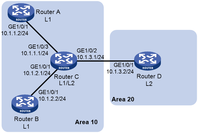

Figure 2 shows one IS-IS network topology. Area 1 is the backbone that comprises a set of Level-2 routers. The other four areas are non-backbone areas connected to the backbone through Level-1-2 routers.
Figure 2 IS-IS topology 1

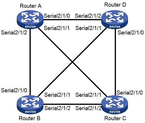

Figure 3 shows another IS-IS topology. No area is defined as the backbone in this topology. The backbone comprises all contiguous Level-2 and Level-1-2 routers in different areas. The IS-IS backbone does not need to be a specific area.
Figure 3 IS-IS topology 2

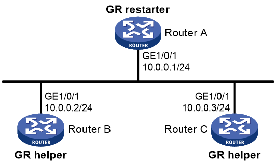

As shown in Figure 4, the same level routers on a network, including non-DIS routers, establish adjacency with each other.
Figure 4 DIS in the IS-IS broadcast network

Configuring IPv6 IS-IS MTR
On a network, IPv4 and IPv6 topologies must be consistent so that both IPv6 IS-IS and IPv4 IS-IS can use the SPF algorithm to perform route calculation. If they are different, routers supporting both IPv4 and IPv6 might send IPv6 packets to routers that do not support IPv6, resulting in packet loss.
To resolve this issue, configure IPv6 IS-IS MTR to perform route calculation separately in IPv4 and IPv6 topologies.
Figure 7 Network diagram
As shown in Figure 7, the numbers refer to the link costs. Router A, Router B, and Router D support both IPv4 and IPv6. Router C supports only IPv4 and cannot forward IPv6 packets.
Enable IPv6 IS-IS MTR on Router A, Router B, Router C, and Router D to make them perform route calculation separately in IPv4 and IPv6 topologies. With this configuration, Router A does not forward IPv6 packets destined to Router D through Router B, avoiding packet loss.

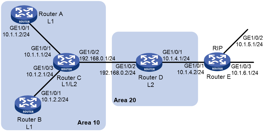

As shown in Figure 9, Device A needs to communicate with Device B, Device C, and Device D. For security purposes, other devices in areas 2, 3, and 5 should not receive the packets sent by Device A. To resolve this issue, perform the following task:
1.     Configure the same administrative tag value for the IS-IS interfaces on Device B, Device C, and Device D.
2.     Configure route leaking from Level-2 to Level-1 on the Level-1-2 device in Area 4 and specify the same tag value as the route filter.
As shown in Figure 10, the IS-IS network topology on Device A is updated after you perform the above task.
Figure 9 IS-IS network diagram without the administrative tag
Figure 10 IS-IS network diagram with the administrative tag

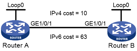

As shown in Figure 11, both Device A and Device B support LSP fragment extension. With LSP fragment extension enabled, Device A advertises some route information in the LSPs generated by Device A1 and Device A2. On receipt of these LSPs, Device B reads the IS Alias ID TLVs and determines that Device A is the originating system. The route information received from Device A1 and Device A2 is actually generated by Device A. In this situation, virtual systems do not participate in route calculation.
Figure 11 IS-IS LSP fragment extension

In NBMA networks, many P2P links exist. As shown in Figure 12, Routers A, B, C and D run IS-IS. When Router A generates an LSP, it floods the LSP out of Serial2/1/0, Serial2/1/1, and Serial2/1/2. After Router D receives the LSP from Serial2/1/2, it floods it out of Serial2/1/0 and Serial2/1/1 to Router B and Router C. However, Router B and Router C have already received the LSP from Router A. Repeated LSP flooding consumes extra bandwidth.
Figure 12 Network diagram of a fully meshed network
To avoid this problem, you can add interfaces to a mesh group or block some interfaces.
·     An interface in a mesh group floods a received LSP only to interfaces not in the mesh group.
·     A blocked interface sends LSPs only after receiving LSP requests.

As shown in Figure 13, the path from Device A to the IP network should be Device A > Device D > Device E > IP network. After you set the overload bit in the LSPs sent by Device D, the path from Device A to the IP network becomes Device A > Device B > Device C > Device E > IP network. If the packets from Device A are destined for Device D's directly-connected networks, the forwarding path does not change.
Figure 13 Overload bit

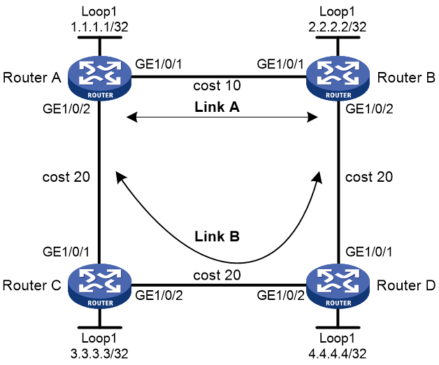

Figure 14 Network diagram for IS-IS LFA FRR
In Figure 14, after you enable LFA FRR on Router B, IS-IS automatically calculates or designates a backup next hop when a link failure is detected. In this way, packets are directed to the backup next hop to reduce traffic recovery time. Meanwhile, IS-IS calculates the shortest path based on the new network topology, and forwards packets over the path after network convergence.
When a primary link failure occurs, BFD can detect and report the link failure to IS-IS for a primary-backup path switchover. This can shorten the duration of service interruption.
You can assign a backup next hop for IS-IS FRR through the following ways:
·     Enable IS-IS LFA FRR to calculate a backup next hop through LFA calculation.
·     Designate a backup next hop with a routing policy for routes matching specific criteria.

IS-IS configuration examples
Example: Configuring basic IS-IS
As shown in Figure 16, Router A, Router B, Router C, and Router D reside in an AS.
Router A and Router B are Level-1 routers, Router D is a Level-2 router, and Router C is a Level-1-2 router connecting two areas. Router A, Router B, and Router C are in area 10, and Router D is in area 20.
Figure 16 Network diagram
1.     Configure IP addresses for interfaces. (Details not shown.)
2.     Configure IS-IS:
# Configure Router A
<RouterA> system-view
[RouterA] isis 1
[RouterA-isis-1] is-level level-1
[RouterA-isis-1] network-entity 10.0000.0000.0001.00
[RouterA-isis-1] quit
[RouterA] interface gigabitethernet 1/0/1
[RouterA-GigabitEthernet1/0/1] isis enable 1
[RouterA-GigabitEthernet1/0/1] quit
# Configure Router B.
<RouterB> system-view
[RouterB] isis 1
[RouterB-isis-1] is-level level-1
[RouterB-isis-1] network-entity 10.0000.0000.0002.00
[RouterB-isis-1] quit
[RouterB-GigabitEthernet1/0/1] isis enable 1
[RouterB-GigabitEthernet1/0/1] quit
# Configure Router C.
<RouterC> system-view
[RouterC] isis 1
[RouterC-isis-1] network-entity 10.0000.0000.0003.00
[RouterC-isis-1] quit
[RouterC] interface gigabitethernet 1/0/3
[RouterC-GigabitEthernet1/0/3] isis enable 1
[RouterC-GigabitEthernet1/0/3] quit
[RouterC] interface gigabitethernet 1/0/1
[RouterC-GigabitEthernet1/0/1] isis enable 1
[RouterC-GigabitEthernet1/0/1] quit
[RouterC] interface gigabitethernet 1/0/2
[RouterC-GigabitEthernet1/0/2] isis enable 1
[RouterC-GigabitEthernet1/0/2] quit
# Configure Router D
<RouterD> system-view
[RouterD] isis 1
[RouterD-isis-1] is-level level-2
[RouterD-isis-1] network-entity 20.0000.0000.0004.00
[RouterD-isis-1] quit
[RouterD] interface gigabitethernet 1/0/1
[RouterD-GigabitEthernet1/0/1] isis enable 1
[RouterD-GigabitEthernet1/0/1] quit
[RouterD] interface gigabitethernet 1/0/2
[RouterD-GigabitEthernet1/0/2] isis enable 1
[RouterD-GigabitEthernet1/0/2] quit
# Display the IS-IS LSDB information.
[RouterA] display isis lsdb
                        Database information for ISIS(1)
                          Level-1 Link State Database
LSPID                 Seq Num      Checksum      Holdtime      Length  ATT/P/OL
0000.0000.0001.00-00* 0x00000004   0xdf5e        1096          68      0/0/0
0000.0000.0002.00-00  0x00000004   0xee4d        1102          68      0/0/0
0000.0000.0002.01-00  0x00000001   0xdaaf        1102          55      0/0/0
0000.0000.0003.00-00  0x00000009   0xcaa3        1161          111     1/0/0
0000.0000.0003.01-00  0x00000001   0xadda        1112          55      0/0/0
    *-Self LSP, +-Self LSP(Extended), ATT-Attached, P-Partition, OL-Overload

# Display the IS-IS routing information on each router.
[RouterA] display isis route
                         Route information for IS-IS(1)
                         Level-1 IPv4 Forwarding Table
 IPv4 Destination     IntCost    ExtCost ExitInterface   NextHop         Flags
 10.1.1.0/24          10         NULL    GE1/0/1         Direct          D/L/-
 10.1.2.0/24          20         NULL    GE1/0/1         10.1.1.1        R/-/-
 192.168.0.0/24       20         NULL    GE1/0/1         10.1.1.1        R/-/-
 0.0.0.0/0            10         NULL    GE1/0/1         10.1.1.1        R/-/-
      Flags: D-Direct, R-Added to Rib, L-Advertised in LSPs, U-Up/Down Bit Set
[RouterC] display isis route
 10.1.2.0/24          10         NULL    GE1/0/3         Direct          D/L/-
 192.168.0.0/24       10         NULL    GE1/0/2         Direct          D/L/-
                         Level-2 IPv4 Forwarding Table
 10.1.1.0/24          10         NULL                                    D/L/-
 10.1.2.0/24          10         NULL                                    D/L/-
 192.168.0.0/24       10         NULL                                    D/L/-
 172.16.0.0/16        20         NULL    GE1/0/2         192.168.0.2     R/-/-
[RouterD] display isis route
 10.1.1.0/24          20         NULL    GE1/0/2         192.168.0.1     R/-/-
 10.1.2.0/24          20         NULL    GE1/0/2         192.168.0.1     R/-/-
 172.16.0.0/16        10         NULL    GE1/0/1         Direct          D/L/-
The output shows that the routing table of Level-1 routers contains a default route with the next hop as the Level-1-2 router. The routing table of Level-2 router contains all Level-1 and Level-2 routes.
Example: Configuring DIS election
As shown in Figure 17, on a broadcast network (Ethernet), Router A, Router B, Router C, and Router D reside in IS-IS Area 10. Router A and Router B are Level-1-2 routers, Router C is a Level-1 router, and Router D is a Level-2 router.
Change the DIS priority of Router A to make it elected as the Level-1-2 DIS router.
Figure 17 Network diagram
2.     Enable IS-IS:
# Configure Router A.
[RouterA] isis 1
[RouterB] isis 1
[RouterC] isis 1
[RouterC-isis-1] is-level level-1
# Configure Router D.
[RouterD] isis 1
[RouterD-isis-1] network-entity 10.0000.0000.0004.00
# Display information about IS-IS neighbors of Router A.
[RouterA] display isis peer
                          Peer information for IS-IS(1)
 System ID: 0000.0000.0002
 Interface: GE1/0/1                 Circuit Id:  0000.0000.0003.01
 State: Up     HoldTime: 21s        Type: L1(L1L2)     PRI: 64
 System ID: 0000.0000.0003
 State: Up     HoldTime: 6s         Type: L1           PRI: 64
 Interface: GE1/0/1                 Circuit Id:  0000.0000.0004.01
 State: Up     HoldTime: 23s        Type: L2(L1L2)     PRI: 64
 System ID: 0000.0000.0004
 State: Up     HoldTime: 23s        Type: L2           PRI: 64
# Display information about IS-IS interfaces of Router A.
[RouterA] display isis interface
                       Interface information for IS-IS(1)
  Interface:  GigabitEthernet1/0/1
  Index     IPv4 state      IPv6 state     Circuit ID   MTU   Type   DIS
  00001     Up              Down           1            1497  L1/L2  No/No
# Display IS-IS interfaces of Router C.
[RouterC] display isis interface
  00001     Up              Down           1            1497  L1/L2  Yes/No
# Display information about IS-IS interfaces of Router D.
[RouterD] display isis interface
  00001     Up              Down           1            1497  L1/L2  No/Yes
The output shows that when the default DIS priority is used, Router C is the DIS for Level-1, and Router D is the DIS for Level-2. The pseudonodes of Level-1 and Level-2 are 0000.0000.0003.01 and 0000.0000.0004.01.
# Configure the DIS priority of Router A.
[RouterA-GigabitEthernet1/0/1] isis dis-priority 100
 Interface: GE1/0/1                 Circuit Id:  0000.0000.0001.01
 State: Up     HoldTime: 29s        Type: L1(L1L2)     PRI: 64
 State: Up     HoldTime: 22s        Type: L1           PRI: 64
 State: Up     HoldTime: 22s        Type: L2(L1L2)     PRI: 64
 State: Up     HoldTime: 22s        Type: L2           PRI: 64
  00001     Up              Down           1            1497  L1/L2  Yes/Yes
The output shows that after the DIS priority configuration, Router A becomes the DIS for Level-1-2, and the pseudonode is 0000.0000.0001.01.
# Display information about IS-IS neighbors and interfaces of Router C.
[RouterC] display isis peer
 System ID: 0000.0000.0001
 State: Up     HoldTime: 7s         Type: L1           PRI: 100
 State: Up     HoldTime: 23s        Type: L1           PRI: 64
  00  1     Up              Down           1            1497  L1/L2  No/No
# Display information about IS-IS neighbors and interfaces of Router D.
[RouterD] display isis peer
 State: Up     HoldTime: 7s         Type: L2           PRI: 100
 State: Up     HoldTime: 26s        Type: L2           PRI: 64
Example: Configuring IS-IS route redistribution
As shown in Figure 18, Router A, Router B, Router C, and Router D reside in the same AS. They use IS-IS to interconnect. Router A and Router B are Level-1 routers, Router D is a Level-2 router, and Router C is a Level-1-2 router.
Redistribute RIP routes into IS-IS on Router D.
Figure 18 Network diagram
2.     Configure basic IS-IS:
[RouterA] isis 1
[RouterB] isis 1
[RouterC] isis 1
[RouterD] isis 1
# Display IS-IS routing information on each router.

3.     Configure RIPv2 on Router D and Router E, and configure IS-IS to redistribute RIP routes on Router D:
# Configure RIPv2 on Router D.
[RouterD] rip 1
[RouterD-rip-1] network 10.0.0.0
[RouterD-rip-1] version 2
[RouterD-rip-1] undo summary
# Configure RIPv2 on Router E.
[RouterE] rip 1
[RouterE-rip-1] network 10.0.0.0
[RouterE-rip-1] version 2
[RouterE-rip-1] undo summary
# On Router D, configure IS-IS to redistribute routes from RIP.
[RouterD-rip-1] quit
[RouterD] isis 1
[RouterD–isis-1] address-family ipv4
[RouterD–isis-1-ipv4] import-route rip level-2
# Display IS-IS routing information on Router C.
 10.1.4.0/24          20         NULL    GE1/0/2         192.168.0.2     R/L/-
 10.1.5.0/24          10         0       GE1/0/2         192.168.0.2     R/L/-
 10.1.6.0/24          10         0       GE1/0/2         192.168.0.2     R/L/-
Example: Configuring IS-IS authentication
As shown in Figure 19, Router A, Router B, Router C, and Router D reside in the same IS-IS routing domain.
Router A, Router B, and Router C belong to Area 10, and Router D belongs to Area 20.
·     Configure neighbor relationship authentication between neighbors.
·     Configure area authentication in Area 10 to prevent untrusted routes from entering into the area.
·     Configure routing domain authentication on Router C and Router D to prevent untrusted routes from entering the routing domain.
Figure 19 Network diagram
[RouterA] isis 1
[RouterB] isis 1
[RouterC] isis 1
[RouterD] isis 1
[RouterD-isis-1] network-entity 20.0000.0000.0001.00
3.     Configure neighbor relationship authentication between neighbors:
# Set the authentication mode to MD5 and set the plaintext key to eRq on GigabitEthernet 1/0/1 of Router A and on GigabitEthernet 1/0/3 of Router C.
[RouterA-GigabitEthernet1/0/1] isis authentication-mode md5 plain eRg
[RouterC-GigabitEthernet1/0/3] isis authentication-mode md5 plain eRg
# Set the authentication mode to MD5 and set the plaintext key to t5Hr on GigabitEthernet 1/0/1 of Router B and on GigabitEthernet 1/0/1 of Router C.
[RouterB-GigabitEthernet1/0/1] isis authentication-mode md5 plain t5Hr
[RouterC-GigabitEthernet1/0/1] isis authentication-mode md5 plain t5Hr
# Set the authentication mode to MD5 and set the plaintext key to hSec on GigabitEthernet 1/0/1 of Router D and on GigabitEthernet 1/0/2 of Router C.
[RouterC-GigabitEthernet1/0/2] isis authentication-mode md5 plain hSec
[RouterD-GigabitEthernet1/0/1] isis authentication-mode md5 plain hSec
4.     Set the area authentication mode to MD5 and set the plaintext key to 10Sec on Router A, Router B, and Router C.
[RouterA] isis 1
[RouterA-isis-1] area-authentication-mode md5 plain 10Sec
[RouterB] isis 1
[RouterB-isis-1] area-authentication-mode md5 plain 10Sec
[RouterC] isis 1
[RouterC-isis-1] area-authentication-mode md5 plain 10Sec
5.     Set routing domain authentication mode to MD5 and set the plaintext key to 1020Sec on Router C and Router D.
[RouterC] isis 1
[RouterC-isis-1] domain-authentication-mode md5 plain 1020Sec
[RouterD] isis 1
[RouterD-isis-1] domain-authentication-mode md5 plain 1020Sec

Loop0
120.1.1.1/32
Router C
GE1/0/1
10.1.1.100/24
GE1/0/2
13.1.1.2/24
[RouterA] isis
[RouterA] interface loopback 0
[RouterA-LoopBack0] isis enable
[RouterA-LoopBack0] quit
[RouterA] interface gigabitethernet 1/0/2
[RouterA-GigabitEthernet1/0/2] isis enable
[RouterA-GigabitEthernet1/0/2] quit
[RouterB] isis
[RouterB] interface loopback 0
[RouterB-LoopBack0] isis enable
[RouterB-LoopBack0] quit
[RouterB] interface gigabitethernet 1/0/2
[RouterB-GigabitEthernet1/0/2] isis enable
[RouterB-GigabitEthernet1/0/2] quit
[RouterC] isis
3.     Configure BFD functions:
# Enable BFD and configure BFD parameters on Router A.
[RouterA] bfd session init-mode active
[RouterA-GigabitEthernet1/0/1] isis bfd enable
[RouterA-GigabitEthernet1/0/1] bfd min-receive-interval 500
[RouterA-GigabitEthernet1/0/1] bfd min-transmit-interval 500
[RouterA-GigabitEthernet1/0/1] bfd detect-multiplier 7
# Enable BFD and configure BFD parameters on Router B.
[RouterB] bfd session init-mode active
[RouterB-GigabitEthernet1/0/1] isis bfd enable
[RouterB-GigabitEthernet1/0/1] bfd min-receive-interval 500
[RouterB-GigabitEthernet1/0/1] bfd min-transmit-interval 500
[RouterB-GigabitEthernet1/0/1] bfd detect-multiplier 8
# Display the BFD session information on Router A.
<RouterA> display bfd session
 Total sessions: 1     Up sessions: 1     Init mode: Active
 IPv4 session working in control mode:
 LD/RD            SourceAddr      DestAddr        State Running Up for Holdtime
   Interface
 3/1              192.168.0.102   192.168.0.100   Up    00:06:23       1700ms
   GE1/0/1

Example: Configuring IS-IS FRR
As shown in Figure 23, Router A, Router B, and Router C reside in the same IS-IS routing domain.
·     Run IS-IS on all the routers to interconnect them with each other.
·     Configure IS-IS FRR so that when Link A fails, traffic can be switched to Link B immediately.
Figure 23 Network diagram
Table 6 Interface and IP address assignment
Device
Interface
IP address
Device
Interface
IP address
Router A
GE1/0/1
12.12.12.1/24
Router B
GE1/0/1
24.24.24.4/24
GE1/0/2
13.13.13.1/24
GE1/0/2
13.13.13.2/24
Loop0
1.1.1.1/32
Loop0
4.4.4.4/32
Router C
GE1/0/1
12.12.12.2/24
GE1/0/2
24.24.24.2/24
1.     Configure IP addresses and subnet masks for interfaces on the routers. (Details not shown.)
2.     Configure IS-IS on the routers to make sure Router A, Router B, and Router C can communicate with each other at the network layer. (Details not shown.)
3.     Configure IS-IS FRR:
Enable IS-IS FRR to calculate a backup next hop through LFA calculation, or designate a backup next hop by using a routing policy.
¡     (Method 1.) Enable IS-IS FRR to calculate a backup next hop through LFA calculation:
[RouterA] isis 1
[RouterA-isis-1] address-family ipv4
[RouterA-isis-1-ipv4] fast-reroute lfa
[RouterA-isis-1-ipv4] quit
[RouterB] isis 1
[RouterB-isis-1] address-family ipv4
[RouterB-isis-1-ipv4] fast-reroute lfa
[RouterB-isis-1-ipv4] quit
¡     (Method 2.) Enable IS-IS FRR to designate a backup next hop by using a routing policy:
[RouterA] ip prefix-list abc index 10 permit 4.4.4.4 32
[RouterA] route-policy frr permit node 10
[RouterA-route-policy-frr-10] if-match ip address prefix-list abc
[RouterA-route-policy-frr-10] apply fast-reroute backup-interface gigabitethernet 1/0/1 backup-nexthop 12.12.12.2
[RouterA-route-policy-frr-10] quit
[RouterA] isis 1
[RouterA-isis-1-ipv4] fast-reroute route-policy frr
[RouterB] ip prefix-list abc index 10 permit 1.1.1.1 32
[RouterB] route-policy frr permit node 10
[RouterB-route-policy-frr-10] if-match ip address prefix-list abc
[RouterB-route-policy-frr-10] apply fast-reroute backup-interface gigabitethernet 1/0/1 backup-nexthop 24.24.24.2
[RouterB-route-policy-frr-10] quit
[RouterB] isis 1
[RouterB-isis-1-ipv4] fast-reroute route-policy frr

Example: Configuring IS-IS remote LFA FRR
As shown in Figure 23, Router A, Router B, Router C, and Router D reside in the same IS-IS routing domain.
·     Configure MPLS LDP on all the routers.
·     Configure IS-IS remote LFA FRR so that when Link A fails, traffic can be switched to Link B immediately.
Figure 24 Network diagram
Table 7 Interface and IP address assignment
Device
Interface
IP address
Device
Interface
IP address
Router A
GE1/0/1
12.12.12.1/24
Router B
GE1/0/1
12.12.12.2/24
GE1/0/2
13.13.13.1/24
GE1/0/2
15.15.15.1/24
Loop1
1.1.1.1/32
Loop1
2.2.2.2/32
Router C
GE1/0/1
13.13.13.2/24
Router D
GE1/0/1
15.15.15.2/24
GE1/0/2
14.14.14.1/24
GE1/0/2
14.14.14.2/24
Loop1
3.3.3.3/32
Loop1
4.4.4.4/32
2.     Configure IS-IS and MPLS LDP on all the routers:
[RouterA] mpls lsr-id 1.1.1.1
[RouterA] mpls ldp
[RouterA-ldp] accept target-hello all
[RouterA-ldp] quit
[RouterA] isis 1
[RouterA-isis-1] network-entity 00.0000.0000.0001.00
[RouterA-GigabitEthernet1/0/1] isis cost 10
[RouterA-GigabitEthernet1/0/1] mpls enable
[RouterA-GigabitEthernet1/0/1] mpls ldp enable
[RouterA-GigabitEthernet1/0/2] isis enable 1
[RouterA-GigabitEthernet1/0/2] isis cost 20
[RouterA-GigabitEthernet1/0/2] mpls enable
[RouterA-GigabitEthernet1/0/2] mpls ldp enable
[RouterA] interface loopback 1
[RouterA-LoopBack1] isis enable 1
[RouterA-LoopBack1] quit
[RouterB] mpls lsr-id 2.2.2.2
[RouterB] mpls ldp
[RouterB-ldp] accept target-hello all
[RouterB-ldp] quit
[RouterB] isis 1
[RouterB-isis-1] network-entity 00.0000.0000.0002.00
[RouterB-GigabitEthernet1/0/1] isis cost 10
[RouterB-GigabitEthernet1/0/1] mpls enable
[RouterB-GigabitEthernet1/0/1] mpls ldp enable
[RouterB-GigabitEthernet1/0/2] isis enable 1
[RouterB-GigabitEthernet1/0/2] isis cost 20
[RouterB-GigabitEthernet1/0/2] mpls enable
[RouterB-GigabitEthernet1/0/2] mpls ldp enable
[RouterB] interface loopback 1
[RouterB-LoopBack1] isis enable 1
[RouterB-LoopBack1] quit
[RouterC] mpls lsr-id 3.3.3.3
[RouterC] mpls ldp
[RouterC-ldp] accept target-hello all
[RouterC-ldp] quit
[RouterC] isis 1
[RouterC-isis-1] network-entity 00.0000.0000.0003.00
[RouterC-GigabitEthernet1/0/1] isis cost 20
[RouterC-GigabitEthernet1/0/1] mpls enable
[RouterC-GigabitEthernet1/0/1] mpls ldp enable
[RouterC-GigabitEthernet1/0/2] isis cost 20
[RouterC-GigabitEthernet1/0/2] mpls enable
[RouterC-GigabitEthernet1/0/2] mpls ldp enable
[RouterC] interface loopback 1
[RouterC-LoopBack1] isis enable 1
[RouterC-LoopBack1] quit
[RouterD] mpls lsr-id 4.4.4.4
[RouterD] mpls ldp
[RouterD-ldp] accept target-hello all
[RouterD-ldp] quit
[RouterD] isis 1
[RouterD-isis-1] network-entity 00.0000.0000.0004.00
[RouterD-GigabitEthernet1/0/1] isis cost 20
[RouterD-GigabitEthernet1/0/1] mpls enable
[RouterD-GigabitEthernet1/0/1] mpls ldp enable
[RouterD-GigabitEthernet1/0/2] isis cost 20
[RouterD-GigabitEthernet1/0/2] mpls enable
[RouterD-GigabitEthernet1/0/2] mpls ldp enable
[RouterD] interface loopback 1
[RouterD-LoopBack1] isis enable 1
[RouterD-LoopBack1] quit
3.     Configure IS-IS remote LFA FRR.
[RouterA] isis 1
[RouterA-isis-1-ipv4] fast-reroute remote-lfa tunnel ldp
# Display route 2.2.2.2/32 on Router A to view the backup next hop information.
[RouterA] display isis route ipv4 2.2.2.2 32 verbose
 IPv4 Dest : 2.2.2.2/32          Int. Cost  : 10               Ext. Cost  : NULL
 Admin Tag : -                   Src Count  : 1                Flag       : R/L/-
 InLabel   : 4294967295          InLabel Flag: -/-/-/-/-/-
 NextHop   :                     Interface  :                  ExitIndex  :
    12.12.12.2                         GE1/0/1                    0x00000002
 Nib ID    : 0x14000008          OutLabel   : 4294967295       OutLabelFlag: -
 LabelSrc  : N/A                 Delay Flag : N/A
 Remote-LFA:
  Interface : GE1/0/2
  BkNextHop : 13.13.13.2         LsIndex    : 0x01000002
  Tunnel destination address: 4.4.4.4
  Backup label: {1149}
      InLabel flags: R-Readvertisement, N-Node SID, P-no PHP
                     E-Explicit null, V-Value, L-Local
      OutLabelFlags: E-Explicit null, I-Implicit null, N-Nomal, P-SR label prefer
 Admin Tag : -                   Src Count  : 3                Flag       : -/-/-
Example: Configuring IS-IS multi-instance processes
As shown in Figure 25, the IPv4 and IPv6 costs are different on an interface. Configure IS-IS multi-instance processes to isolate the IPv4 and IPv6 network and avoid IPv6 route calculation errors.
Figure 25 Network diagram
Table 8 Interface and IP address assignment
Device
Interface
IPv4 address
IPv6 address
Router A
GE1/0/1
10.1.1.1/24
2001::1/64
Loop0
1.1.1.1/32
10::1/128
Router B
GE1/0/1
10.1.1.2/24
2001::2/64
Loop0
2.2.2.2/32
20::1/128
Configure IPv4 and IPv6 addresses for the interfaces. (Details not shown.)
1.     Configure traditional IPv4 IS-IS processes:
[RouterA] isis 1
[RouterA-LoopBack0] isis enable 1
[RouterB] isis 1
[RouterB-LoopBack0] isis enable 1
2.     Configure IPv6 IS-IS multi-instance processes:
[RouterA] isis 2
[RouterA-isis-2] network-entity 20.0000.0000.0010.00
[RouterA-isis-2] multi-instance enable iid 1
[RouterA-isis-2] address-family ipv6
[RouterA-isis-2-ipv6] quit
[RouterA-isis-2] quit
[RouterA-LoopBack0] isis ipv6 enable 2
[RouterA-GigabitEthernet1/0/1] isis ipv6 enable 2
[RouterA-GigabitEthernet1/0/1] isis process-id 2 cost 63
[RouterB] isis 2
[RouterB-isis-2] network-entity 20.0000.0000.0020.00
[RouterB-isis-2] multi-instance enable iid 1
[RouterB-isis-2] address-family ipv6
[RouterB-isis-2-ipv6] quit
[RouterB-isis-2] quit
[RouterB-LoopBack0] isis ipv6 enable 2
[RouterB-GigabitEthernet1/0/1] isis ipv6 enable 2
[RouterB-GigabitEthernet1/0/1] isis process-id 2 cost 63
# View information about the IPv4 IS-IS routing table of Router A.
 1.1.1.1/32           0          NULL    Loop0           Direct          D/L/-
 2.2.2.2/32           10         NULL    GE1/0/1         10.1.1.2        R/L/-
 10.1.1.0/24          10         NULL    ULL             Direct          D/L/-
 2.2.2.2/32           10         NULL
The output shows that route calculation results are correct.
# View information about the IPv4 IS-IS routing table of Router B.
[RouterB] display isis route ipv4
 1.1.1.1/32           10         NULL    GE1/0/1         10.1.1.1        R/L/-
 2.2.2.2/32           0          NULL    Loop0           Direct          D/L/-
 1.1.1.1/32           10         NULL

IPv6 IS-IS configuration examples
Example: Configuring IPv6 IS-IS basics
As shown in Figure 26, Router A, Router B, Router C, and Router D, all enabled with IPv6, reside in the same AS. Configure IPv6 IS-IS on the routers so that they can reach each other.
Figure 26 Network diagram
1.     Configure IPv6 addresses for interfaces. (Details not shown.)
2.     Configure IPv6 IS-IS:
[RouterA] isis 1
