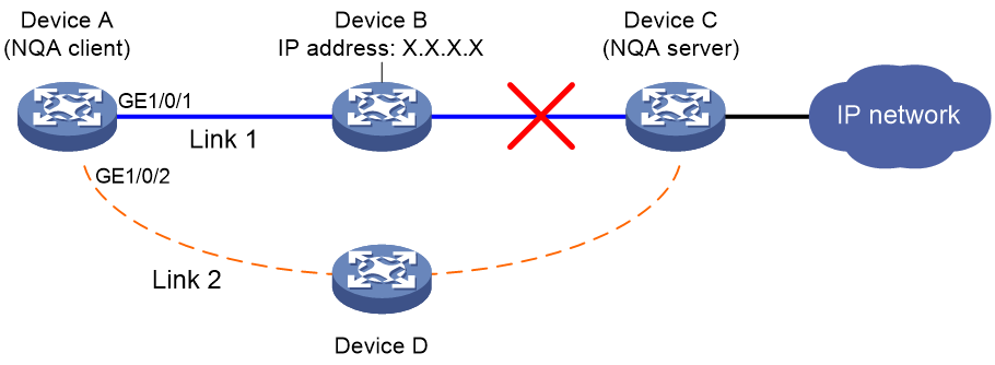

Usage guidelines
Application scenarios
As shown in Figure 1, Device A has no routes to Device C or the available route is Link 2. To detect the connectivity of Link 1, use the next-hop command to specify the next hop IP address for probe packets:
· If the IPv4 address of Device B is known, specify the IPv4 address of Device B for the ipv4-address argument in the next-hop ip ipv4-address command.
· If the IPv6 address of Device B is known, specify the IPv6 address of Device B for the ipv6-address argument in the next-hop ip ipv6-address command.
· If Device B is the gateway with a changing IP address, configure the next-hop dhcp and out interface commands. Device A determines whether to use the IPv4 or IPv6 address of the gateway as the next hop IP address for probe packets based on the destination IP address type of the probe packets.
Operating mechanism
If you configure the next-hop ip ipv4-address or next-hop ipv6 ipv6-address command, the device does not search the routing table to select the next hop IP address for the probe packets. It uses the specified IP address as the next hop IP address.
If you configure the next-hop dhcp and out interface commands, the device does not search the routing table to select the next hop IP address for the probe packets. It selects the next hop IP address as follows:
· In an IPv4 network, the device obtains the gateway IP address from the DHCP server through the interface specified by the out interface command and uses the IP address as the next hop IP address for probe packets.
· In an IPv6 network, the device obtains the gateway IP address from the ND neighbor through the interface specified by the out interface command and uses the IPv6 address as the next hop IP address for probe packets.
If you configure both the next-hop ip, next-hop ipv6, and out interface commands for an NQA operation, only the next-hop ip and next-hop ipv6 commands take effect.
The next-hop dhcp command is supported only in ICMP echo operation view.
If you execute this command multiple times, the most recent configuration takes effect.
