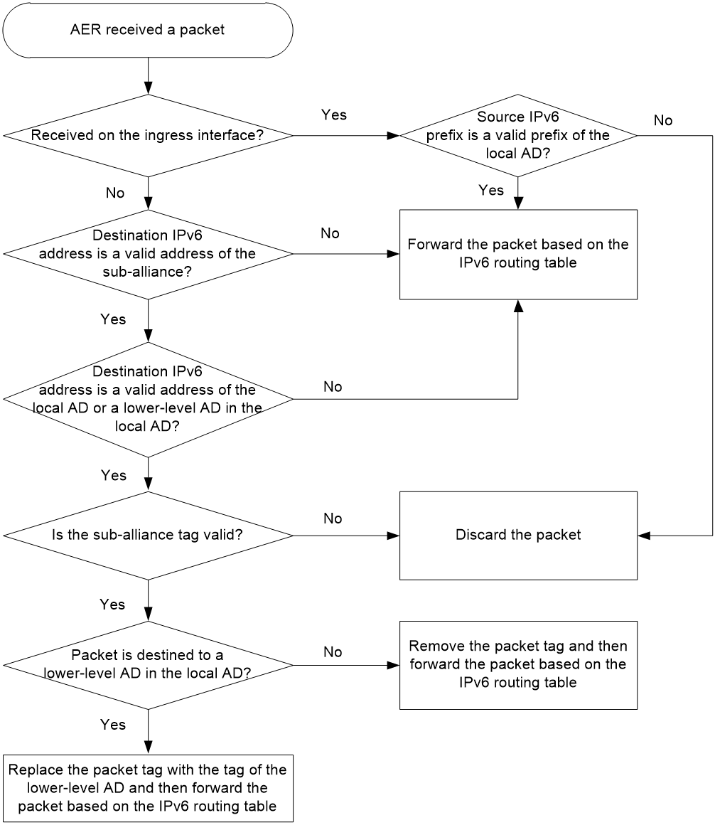

For incoming packets from other ADs to the local AD
An AER processes a received packet as follows:
1.     Examine the interface type.
¡     If the interface is the ingress interface, the AER proceeds to step 2.
¡     If the interface is the egress interface, the AER proceeds to step 3.
2.     Examine whether the source IPv6 prefix is a valid IPv6 prefix of the local AD.
¡     If yes, the AER forwards the packet based on the IPv6 routing table.
¡     If no, the AER discards the packet.
3.     Examine whether the destination IPv6 prefix is a valid IPv6 prefix of the sub-alliance.
¡     If yes, the AER proceeds to the next step.
¡     If no, the AER forwards the packet based on the IPv6 routing table.
4.     Examine whether the destination IPv6 address is a valid address of the local AD or an AD at a lower level in the local AD.
5.     Examine the validity of the sub-alliance tag.
¡     If the tag is valid, the AER proceeds to the next step.
¡     If the tag is invalid, the AER discards the packet.
6.     Examine whether the packet is destined to an AD at a lower level in the local AD.
¡     If yes, the AER replaces the packet tag with the tag of the lower-level AD, and then forwards the packet based on the IPv6 routing table.
The lower-level AER processes the packet in the same way.
¡     If no, the AER removes the packet tag, and then forwards the packet based on the IPv6 routing table.
Figure 2 Incoming packet processing workflow

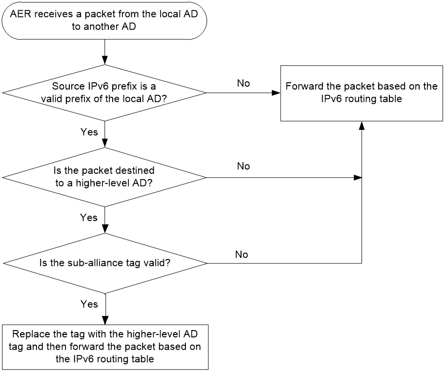

For outgoing packets from the local AD to another AD
An AER processes an outgoing packet as follows:
1.     Examine whether the source IPv6 prefix is a valid prefix of the local AD.
¡     If yes, the AER adds a tag to the packet and then forwards the packet based on the IPv6 routing table.
¡     If no, the AER proceeds to the next step.
2.     Examine whether the packet is destined to a higher-level AD of the local AD.
3.     Examine the validity of the sub-alliance tag.
¡     If yes, the AER replaces the tag with the higher-level AD tag and then forwards the packet based on the IPv6 routing table.
Figure 3 Outgoing packet processing workflow

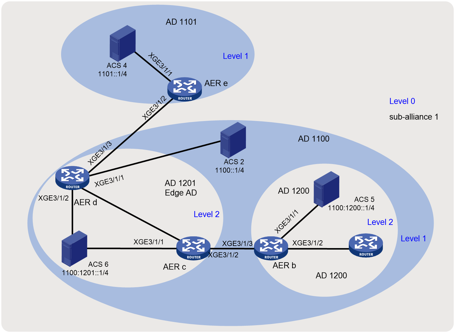

Example: Configuring SMA using SSL links
Network requirements
As shown in Figure 4, configure ACSs and AERs to use SMA with SSL links to prevent IPv6 source address spoofing.
Figure 4 Network diagram
Device
Interface
IP address
Device
Interface
IP address
AER e
XGE3/1/1
1101::2/4
AER c
XGE3/1/1
1100:1201::3/4
AER d
XGE3/1/1
1100::2/4
AER b
XGE3/1/3
1100:1200::2/4
XGE3/1/2
1100:1201::2/4
Synchronize clocks for all devices in the alliance.
1.     Configure ACSs. (Details not shown.)
2.     Configure AER b.
# Configure an IPv6 address for AER b. (Details not shown.)
# Create SSL client policy sma on AER b.
<AERb> system-view
[AERb] ssl client-policy sma
# Disable the SSL client from authenticating SSL servers through digital certificates if SSL server authentication is not required. Server authentication is enabled by default.
[AERb-ssl-client-policy-sma] undo server-verify enable
[AERb-ssl-client-policy-sma] quit
# Enable SMA on AER b and configure an SSL link between AER b and ACS 5.
[AERb] sma-anti-spoof ipv6 enable
[AERb] sma-anti-spoof ipv6 server 1100:1200::1 client 1100:1200::2 ssl-client-policy sma address-domain-level 2
# Specify AD 1200 for AER b.
[AERb] sma-anti-spoof ipv6 address-domain 1200
# Specify sub-alliance 1 for AER b.
[AERb] sma-anti-spoof ipv6 sub-alliance 1

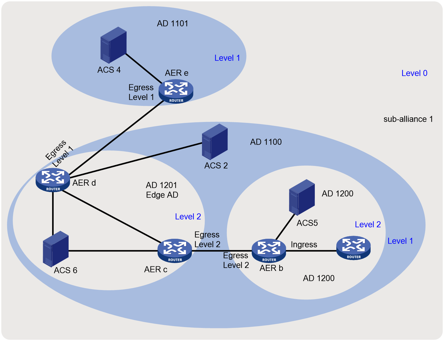

# Configure SMA interfaces for AER b.
[AERb] interface ten-gigabitethernet 3/1/2
[AERb-Ten-GigabitEthernet3/1/2] sma-anti-spoof ipv6 port-type ingress
[AERb-Ten-GigabitEthernet3/1/2] quit
[AERb] interface Ten-GigabitEthernet 3/1/3
[AERb-Ten-GigabitEthernet3/1/3] sma-anti-spoof ipv6 port-type egress level 2
[AERb-Ten-GigabitEthernet3/1/3] quit

# Configure the SMA interface for AER c.
[AERc] interface ten-gigabitethernet 3/1/2
[AERc-Ten-GigabitEthernet3/1/2] sma-anti-spoof ipv6 port-type egress level 2
[AERc-Ten-GigabitEthernet3/1/2] quit

# Configure the SMA interface for AER d.
[AERd] interface ten-gigabitethernet 3/1/3
[AERd-Ten-GigabitEthernet3/1/3] sma-anti-spoof ipv6 port-type egress level 1
[AERd-Ten-GigabitEthernet3/1/3] quit

Example: Configuring SMA using TCP links
As shown in Figure 5, configure ACSs and AERs to use SMA with TCP links to prevent IPv6 source address spoofing.
Figure 5 Network diagram
Device
Interface
IP address
Device
Interface
IP address
AER e
XGE3/1/1
1101::2/4
AER c
XGE3/1/1
1100:1201::3/4
AER d
XGE3/1/1
1100::2/4
AER b
XGE3/1/3
1100:1200::2/4
XGE3/1/2
1100:1201::2/4
