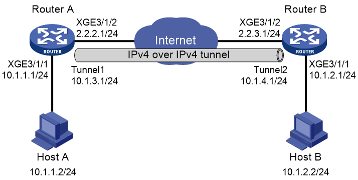

Tunnel interface-based IPsec
To implement tunnel interface-based IPsec, configure an IPsec profile and apply the IPsec profile to a tunnel interface. All traffic routed to the tunnel interface is protected by IPsec. Tunnel interface-based IPsec supports only the tunnel encapsulation mode.
For tunnel interface-based IPsec, packet encapsulation and decapsulation are performed on the tunnel interfaces.
Figure 4 Tunnel interface encapsulation
As shown in Figure 4, a tunnel interface encapsulates an IP packet as follows:
1.     Upon receiving a clear text packet, the inbound interface sends the packet to the forwarding module for routing.
2.     If the packet requires IPsec protection, the forwarding module sends the packet to the tunnel interface.
3.     The tunnel interface encapsulates the packet into a new IP packet. The source and destination IP addresses in the new IP header are the source and destination IP addresses of the tunnel interface. Then, the tunnel interface sends the packet back to the forwarding module.
4.     The forwarding module looks up the routing table again and sends the packet out of the physical output interface of the tunnel interface.
Figure 5 Tunnel interface de-encapsulation
As shown in Figure 5, a tunnel interface de-encapsulates an IP packet as follows:
1.     Upon receiving an encrypted packet, the inbound interface sends the packet to the forwarding module for routing.
2.     Because the packet is destined for the tunnel interface' source address and the payload protocol is AH or ESP, the forwarding module sends the packet to the tunnel interface.
3.     The tunnel interface de-encapsulates the packet (removes the outer IP header) and sends the de-encapsulated packet back to the forwarding module.

Example: Configuring a manual mode IPsec tunnel for IPv4 packets
As shown in Figure 10, establish an IPsec tunnel between Router A and Router B to protect data flows between subnet 10.1.1.0/24 and subnet 10.1.2.0/24. Configure the tunnel as follows:
·     Specify the encapsulation mode as tunnel, the security protocol as ESP, the encryption algorithm as 128-bit AES, and the authentication algorithm as HMAC-SHA1.
·     Manually set up IPsec SAs.
Figure 10 Network diagram

Example: Configuring an IKE-based IPsec tunnel for IPv4 packets
As shown in Figure 11, establish an IPsec tunnel between Router A and Router B to protect data flows between subnet 10.1.1.0/24 and subnet 10.1.2.0/24. Configure the IPsec tunnel as follows:
·     Set up SAs through IKE negotiation.
·     Specify the slot installed with an IM-SFMX card as the primary slot for IPsec traffic processing.
Figure 11 Network diagram

Example: Establishing an IPsec tunnel to protect traffic on a tunnel interface based on an IPsec profile
As shown in Figure 14, configure an IPsec tunnel between Device A and Device B to protect data flows between subnet 10.1.1.0/24 and subnet 10.1.2.0/24. This example uses the following settings:
·     Use tunnel-mode encapsulation.
·     Use ESP as the security protocol.
·     Use the 128-bit AES and HMAC-SHA1 algorithms for encryption and authentication, respectively.
·     Use IKE to establish IPsec SAs.
Figure 14 Network diagram

# Assign an IP address to each interface. (Details not shown.)
# Create a tunnel interface in IPsec/IPv4 tunnel mode. Specify the slot installed with a IM-SFMX card as the primary slot to process traffic for the interface.
<RouterA> system-view
[RouterA] interface tunnel 1 mode ipsec
[RouterA-Tunnel1] service slot 1
[RouterA-Tunnel1] source ten-gigabitethernet 3/1/2
[RouterA-Tunnel1] destination 2.2.3.1
[RouterA-Tunnel1] ip address 10.1.3.1 24
# Apply IPsec profile 1 to the tunnel interface.
[RouterA-Tunnel1] tunnel protection ipsec profile 1
[RouterA-Tunnel1] quit
# Create an IPsec transform set named tran1.
[RouterA] ipsec transform-set tran1
# Set the packet encapsulation mode to tunnel mode.
[RouterA-ipsec-transform-set-tran1] encapsulation-mode tunnel
# Use ESP as the security protocol.
[RouterA-ipsec-transform-set-tran1] protocol esp
# Configure ESP to use the 128-bit AES and HMAC-SHA1 algorithms for encryption and authentication, respectively.
[RouterA-ipsec-transform-set-tran1] esp encryption-algorithm aes-cbc-128
[RouterA-ipsec-transform-set-tran1] esp authentication-algorithm sha1
[RouterA-ipsec-transform-set-tran1] quit
# Create and configure an IKE keychain named keychain1.
[RouterA] ike keychain keychain1
# Set the pre-shared key for IKE negotiation with the peer at 2.2.3.1 to 123456TESTplat&! in plain text.
[RouterA-ike-keychain-keychain1] pre-shared-key address 2.2.3.1 255.255.255.0 key simple 123456TESTplat&!
[RouterA-ike-keychain-keychain1] quit
# Create an IKE profile named profile1.
[RouterA] ike profile profile1
[RouterA-ike-profile-profile1] keychain keychain1
[RouterA-ike-profile-profile1] match remote identity address 2.2.3.1 255.255.255.0
[RouterA-ike-profile-profile1] quit
# Create an IKE-based IPsec profile.
[RouterA] ipsec profile 1 isakmp
# Specify IPsec transform set tran1 for protection of data flows.
[RouterA-ipsec-profile-isakmp-1] transform-set tran1
# Specify IKE profile profile1 for IKE negotiation.
[RouterA-ipsec-profile-isakmp-1] ike-profile profile1
[RouterA-ipsec-profile-isakmp-1] quit
# Configure a static route from Router A to Router B.
[RouterA] ip route-static 10.1.2.0 24 Tunnel 1
2.     Configure Router B:
<RouterB> system-view
[RouterB] interface tunnel 1 mode ipsec
[RouterB-Tunnel1] service slot 1
[RouterB-Tunnel1] source ten-gigabitethernet 3/1/2
[RouterB-Tunnel1] destination 2.2.2.1
[RouterB-Tunnel1] ip address 10.1.4.1 24
[RouterB-Tunnel1] tunnel protection ipsec profile 1
[RouterB-Tunnel1] quit
[RouterB] ipsec transform-set tran1
[RouterB-ipsec-transform-set-tran1] encapsulation-mode tunnel
[RouterB-ipsec-transform-set-tran1] protocol esp
[RouterB-ipsec-transform-set-tran1] esp encryption-algorithm aes-cbc-128
[RouterB-ipsec-transform-set-tran1] esp authentication-algorithm sha1
[RouterB-ipsec-transform-set-tran1] quit
[RouterB] ike keychain keychain1
[RouterB-ike-keychain-keychain1] pre-shared-key address 2.2.2.1 255.255.255.0 key simple 123456TESTplat&!
[RouterB-ike-keychain-keychain1] quit
[RouterB] ike profile profile1
[RouterB-ike-profile-profile1] keychain keychain1
[RouterB-ike-profile-profile1] match remote identity address 2.2.2.1 255.255.255.0
[RouterB-ike-profile-profile1] quit
[RouterB] ipsec profile 1 isakmp
[RouterB-ipsec-profile-isakmp-1] transform-set tran1
[RouterB-ipsec-profile-isakmp-1] ike-profile profile1
[RouterB-ipsec-profile-isakmp-1] quit
# Configure a static route from Router B to Router A.
[RouterA] ip route-static 10.1.1.0 24 Tunnel 1
# Send packets between subnet 10.1.1.0/24 and subnet 10.1.2.0/24 to trigger IKE negotiation. After IPsec SAs are successfully negotiated by IKE, the traffic between the two subnets is IPsec-protected.
# Execute the following command to verify that IPsec SAs have been successfully established.
[RouterA] display ipsec sa
Interface: Tunnel1
  IPsec profile: 1
  Mode: ISAKMP
    Tunnel id: 0
    Encapsulation mode: tunnel
    Perfect Forward Secrecy:
    Inside VPN:
    Extended Sequence Numbers enable: N
    Traffic Flow Confidentiality enable: N
    Path MTU: 1443
    Transmitting entity: Initiator
    Tunnel:
        local  address: 2.2.2.1
        remote address: 2.2.3.1
    Flow:
        sour addr: 0.0.0.0/0.0.0.0  port: 0  protocol: ip
        dest addr: 0.0.0.0/0.0.0.0  port: 0  protocol: ip
    [Inbound ESP SAs]
      SPI: 3769702703 (0xe0b1192f)
      Connection ID: 90194313219
      Transform set: ESP-ENCRYPT-AES-CBC-128 ESP-AUTH-SHA1
      SA duration (kilobytes/sec): 3000/28800
      SA remaining duration (kilobytes/sec): 2300/797
      Max received sequence-number: 1
      Anti-replay check enable: N
      Anti-replay window size:
      UDP encapsulation used for NAT traversal: N
      Status: Active
    [Outbound ESP SAs]
      SPI: 3840956402 (0xe4f057f2)
      Connection ID: 64424509441
      SA remaining duration (kilobytes/sec): 2312/797
      Max sent sequence-number: 1
      Status: Active
# Repeat the previous steps on Router B to verify that it has established IPsec SAs successfully to protect the IPv4 packets of interest. (Details not shown.)

IKE configuration examples
Example: Main mode IKE with pre-shared key authentication configuration example
As shown in Figure 19, configure an IKE-based IPsec tunnel between Device A and Device B to secure the communication between subnet 10.1.1.0/24 and subnet 10.1.2.0/24.
·     Configure Device A and Device B to use the default IKE proposal for the IKE negotiation to set up the IPsec SAs.
·     Configure the two devices to use the pre-shared key authentication method for the IKE negotiation phase 1.
Figure 19 Network diagram
1.     Configure Device A:
# Configure IPv4 advanced ACL 3101 to identify traffic from subnet 10.1.1.0/24 to subnet 10.1.2.0/24.
<DeviceA> system-view
[DeviceA] acl advanced 3101
[DeviceA-acl-ipv4-adv-3101] rule permit ip source 10.1.1.0 0.0.0.255 destination 10.1.2.0 0.0.0.255
[DeviceA-acl-ipv4-adv-3101] quit
[DeviceA] ipsec transform-set tran1
# Set the packet encapsulation mode to tunnel.
[DeviceA-ipsec-transform-set-tran1] encapsulation-mode tunnel
# Use the ESP protocol for the IPsec transform set.
[DeviceA-ipsec-transform-set-tran1] protocol esp
# Specify the encryption and authentication algorithms.
[DeviceA-ipsec-transform-set-tran1] esp encryption-algorithm aes-cbc-128
[DeviceA-ipsec-transform-set-tran1] esp authentication-algorithm sha1
[DeviceA-ipsec-transform-set-tran1] quit
# Create an IKE keychain named keychain1.
[DeviceA] ike keychain keychain1
# Specify 123456TESTplat&! in plain text as the pre-shared key to be used with the remote peer at 2.2.2.2.
[DeviceA-ike-keychain-keychain1] pre-shared-key address 2.2.2.2 255.255.0.0 key simple 123456TESTplat&!
[DeviceA-ike-keychain-keychain1] quit
[DeviceA] ike profile profile1
# Specify IKE keychain keychain1.
[DeviceA-ike-profile-profile1] keychain keychain1
# Configure the local ID with the identity type as IP address and the value as 1.1.1.1.
[DeviceA-ike-profile-profile1] local-identity address 1.1.1.1
# Configure a peer ID with the identity type as IP address and the value as 2.2.2.2/16.
[DeviceA-ike-profile-profile1] match remote identity address 2.2.2.2 255.255.0.0
[DeviceA-ike-profile-profile1] quit
# Create an IKE-based IPsec policy entry. Specify the policy name as map1 and set the sequence number to 10.
[DeviceA] ipsec policy map1 10 isakmp
# Specify the remote IP address 2.2.2.2 for the IPsec tunnel.
[DeviceA-ipsec-policy-isakmp-map1-10] remote-address 2.2.2.2
# Specify ACL 3101 to identify the traffic to be protected.
[DeviceA-ipsec-policy-isakmp-map1-10] security acl 3101
# Specify IPsec transform set tran1 for the IPsec policy.
[DeviceA-ipsec-policy-isakmp-map1-10] transform-set tran1
# Specify IKE profile profile1 for the IPsec policy.
[DeviceA-ipsec-policy-isakmp-map1-10] ike-profile profile1
# Specify the slot installed with an IM-SFMX card as the primary slot for IPsec traffic processing.
[DeviceA-ipsec-policy-isakmp-map1-10] service slot 1
[DeviceA-ipsec-policy-isakmp-map1-10] quit
# Apply IPsec policy map1 to Ten-GigabitEthernet 3/1/1.
[DeviceA] interface ten-gigabitethernet 3/1/1
[DeviceA-Ten-GigabitEthernet3/1/1] ipsec apply policy map1
[DeviceA-Ten-GigabitEthernet3/1/1] quit
# Configure a static route to the subnet where Host B resides. This example uses 2.2.2.1 as the next hop IP address.
[DeviceA] ip route-static 10.1.2.0 255.255.255.0 2.2.2.1
2.     Configure Device B:
# Configure IPv4 advanced ACL 3101 to identify traffic from subnet 10.1.2.0/24 to subnet 10.1.1.0/24.
<DeviceB> system-view
[DeviceB] acl advanced 3101
[DeviceB-acl-ipv4-adv-3101] rule permit ip source 10.1.2.0 0.0.0.255 destination 10.1.1.0 0.0.0.255
[DeviceB-acl-ipv4-adv-3101] quit
[DeviceB] ipsec transform-set tran1
[DeviceB-ipsec-transform-set-tran1] encapsulation-mode tunnel
[DeviceB-ipsec-transform-set-tran1] protocol esp
[DeviceB-ipsec-transform-set-tran1] esp encryption-algorithm aes-cbc-128
[DeviceB-ipsec-transform-set-tran1] esp authentication-algorithm sha1
[DeviceB-ipsec-transform-set-tran1] quit
[DeviceB]ike keychain keychain1
# Specify 123456TESTplat&! in plain text as the pre-shared key to be used with the remote peer at 1.1.1.1.
[DeviceB-ike-keychain-keychain1] pre-shared-key address 1.1.1.1 255.255.0.0 key simple 123456TESTplat&!
[DeviceB-ike-keychain-keychain1] quit
[DeviceB] ike profile profile1
[DeviceB-ike-profile-profile1] keychain keychain1
# Configure the local ID with the identity type as IP address and the value as 2.2.2.2.
[DeviceB-ike-profile-profile1] local-identity address 2.2.2.2
# Configure a peer ID with the identity type as IP address and the value as 1.1.1.1/16.
[DeviceB-ike-profile-profile1] match remote identity address 1.1.1.1 255.255.0.0
[DeviceB-ike-profile-profile1] quit
# Create an IKE-based IPsec policy entry. Specify the policy name as use1 and set the sequence number to 10.
[DeviceB] ipsec policy use1 10 isakmp
# Specify the remote IP address 1.1.1.1 for the IPsec tunnel.
[DeviceB-ipsec-policy-isakmp-use1-10] remote-address 1.1.1.1
[DeviceB-ipsec-policy-isakmp-use1-10] security acl 3101
[DeviceB-ipsec-policy-isakmp-use1-10] transform-set tran1
[DeviceB-ipsec-policy-isakmp-use1-10] ike-profile profile1
[DeviceB-ipsec-policy-isakmp-use1-10] service slot 1
[DeviceB-ipsec-policy-isakmp-use1-10] quit
# Apply IPsec policy use1 to Ten-GigabitEthernet 3/1/1.
[DeviceB] interface ten-gigabitethernet 3/1/1
[DeviceB-Ten-GigabitEthernet3/1/1] ipsec apply policy use1
# Configure a static route to the subnet where Host A resides. This example uses 1.1.1.2 as the next hop IP address.
[DeviceB] ip route-static 10.1.1.0 255.255.255.0 1.1.1.2
# Initiate a connection from subnet 10.1.1.0/24 to subnet 10.1.2.0/24 to trigger IKE negotiation. After IPsec SAs are successfully negotiated by IKE, traffic between the two subnets is IPsec-protected.
# Display the IKE proposal configuration on Device A and Device B. Because no IKE proposal is configured, the command displays the default IKE proposal.
[DeviceA] display ike proposal
 Priority Authentication Authentication Encryption  Diffie-Hellman Duration
              method       algorithm    algorithm       group      (seconds)
default  PRE-SHARED-KEY     SHA1         DES-CBC        Group 1      86400
[DeviceB] display ike proposal
# Display the IKE SA on Device A.
[DeviceA] display ike sa
    Connection-ID   Remote                Flag         DOI
    1               2.2.2.2/500           RD           IPsec
Flags:
RD--READY RL--REPLACED FD-FADING RK-REKEY
# Display the IPsec SAs generated on Device A.
[DeviceA] display ipsec sa
Interface: Ten-GigabitEthernet3/1/1
  IPsec policy: map1
  Sequence number: 10
  Mode: ISAKMP
    Tunnel id: 0
    Inside VPN:
    Path MTU: 1456
    Tunnel:
        local  address: 1.1.1.1
        remote address: 2.2.2.2
    Flow:
        sour addr: 10.1.1.0/255.255.255.0  port: 0  protocol: ip
        dest addr: 10.1.2.0/255.255.255.0  port: 0  protocol: ip
    [Inbound ESP SAs]
      SPI: 3264152513 (0xc28f03c1)
      SA duration (kilobytes/sec): 1843200/3600
      SA remaining duration (kilobytes/sec): 1843200/3484
      Anti-replay check enable: Y
      Anti-replay window size: 64
      Status: Active
    [Outbound ESP SAs]
      SPI: 738451674 (0x2c03e0da)
      Status: Active
# Display the IKE SA and IPsec SAs on Device B.

Example: Aggressive mode with RSA signature authentication configuration example
As shown in Figure 20, configure an IKE-based IPsec tunnel between Device A and Device B to secure the communication between subnet 10.1.1.0/24 and subnet 10.1.2.0/24.
Configure Device A and Device B to use aggressive mode for IKE negotiation phase 1 and to use RSA signature authentication. Device A acts as the initiator, and the subnet where Device A resides uses IP addresses dynamically allocated.
Figure 20 Network diagram

IKEv2 configuration examples
Example: IKEv2 with pre-shared key authentication configuration example
As shown in Figure 22, configure an IKE-based IPsec tunnel between Device A and Device B to secure the communication between subnet 10.1.1.0/24 and subnet 10.1.2.0/24.
·     Configure Device A and Device B to use the default IKEv2 proposal and the default IKEv2 policy in IKEv2 negotiation to set up IPsec SAs.
·     Configure the two devices to use the pre-shared key authentication method in IKEv2 negotiation.
Figure 22 Network diagram

Example: IKEv2 with RSA signature authentication configuration example
As shown in Figure 23, configure an IKE-based IPsec tunnel between Device A and Device B to secure the communication between subnet 10.1.1.0/24 and subnet 10.1.2.0/24.
Configure Device A and Device B to use IKEv2 negotiation and RSA signature authentication. Device A acts as the initiator, and the subnet where Device A resides uses IP addresses dynamically allocated.
Figure 23 Network diagram

[DeviceB] ipsec policy use1 1 isakmp
[DeviceB-ipsec-policy-isakmp-use1-1] remote-address 1.1.1.1
[DeviceB-ipsec-policy-isakmp-use1-1] security acl 3101
[DeviceB-ipsec-policy-isakmp-use1-1] transform-set tran1
# Specify IKEv2 profile profile2 for the IPsec policy.
[DeviceB-ipsec-policy-isakmp-use1-1] ikev2-profile profile2
[DeviceB-ipsec-policy-isakmp-use1-1] quit
[DeviceB-Ten-GigabitEthernet3/1/1] quit
# Initiate a connection from subnet 10.1.1.0/24 to subnet 10.1.2.0/24 to trigger IKEv2 negotiation. After IPsec SAs are successfully negotiated by IKEv2, traffic between the two subnets is IPsec-protected.
