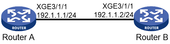

As shown in Figure 1, establish an OSPF neighbor relationship between Router A and Router B, and use a keychain to authenticate packets between the routers. Configure key 1 and key 2 for the keychain and make sure key 2 is used immediately when key 1 expires.
Figure 1 Network diagram
1.     Configure Router A:
# Configure IP addresses for interfaces. (Details not shown.)
# Configure OSPF.
<RouterA> system-view
[RouterA] ospf 1 router-id 1.1.1.1
[RouterA-ospf-1] area 0
[RouterA-ospf-1-area-0.0.0.0] network 192.1.1.0 0.0.0.255
[RouterA-ospf-1-area-0.0.0.0] quit
[RouterA-ospf-1] quit
# Create a keychain named abc, and specify the absolute time mode for it.
[RouterA] keychain abc mode absolute
# Create key 1 for keychain abc, specify an authentication algorithm, and configure a key string and the sending and receiving lifetimes for the key.
[RouterA-keychain-abc] key 1
[RouterA-keychain-abc-key-1] authentication-algorithm md5
[RouterA-keychain-abc-key-1] key-string plain 123456
[RouterA-keychain-abc-key-1] send-lifetime utc 10:00:00 2015/02/06 to 11:00:00 2015/02/06
[RouterA-keychain-abc-key-1] accept-lifetime utc 10:00:00 2015/02/06 to 11:00:00 2015/02/06
[RouterA-keychain-abc-key-1] quit
# Create key 2 for keychain abc, specify an authentication algorithm, and configure a key string and the sending and receiving lifetimes for the key.
[RouterA-keychain-abc] key 2
[RouterA-keychain-abc-key-2] authentication-algorithm hmac-md5
[RouterA-keychain-abc-key-2] key-string plain pwd123
[RouterA-keychain-abc-key-2] send-lifetime utc 11:00:00 2015/02/06 to 12:00:00 2015/02/06
[RouterA-keychain-abc-key-2] accept-lifetime utc 11:00:00 2015/02/06 to 12:00:00 2015/02/06
[RouterA-keychain-abc-key-2] quit
[RouterA-keychain-abc] quit
# Configure Ten-GigabitEthernet 3/1/1 to use keychain abc for authentication.
[RouterA] interface Ten-GigabitEthernet3/1/1
[RouterA-Ten-GigabitEthernet3/1/1] ospf authentication-mode keychain abc
[RouterA-Ten-GigabitEthernet3/1/1] quit
2.     Configure Router B:
# Configure OSPF.
<RouterB> system-view
[RouterB] ospf 1 router-id 2.2.2.2
[RouterB-ospf-1] area 0
[RouterB-ospf-1-area-0.0.0.0] network 192.1.1.0 0.0.0.255
[RouterB-ospf-1-area-0.0.0.0] quit
[RouterB-ospf-1] quit
[RouterB] keychain abc mode absolute
[RouterB-keychain-abc] key 1
[RouterB-keychain-abc-key-1] authentication-algorithm md5
[RouterB-keychain-abc-key-1] key-string plain 123456
[RouterB-keychain-abc-key-1] send-lifetime utc 10:00:00 2015/02/06 to 11:00:00 2015/02/06
[RouterB-keychain-abc-key-1] accept-lifetime utc 10:00:00 2015/02/06 to 11:10:00 2015/02/06
[RouterB-keychain-abc-key-1] quit
[RouterB-keychain-abc] key 2
[RouterB-keychain-abc-key-2] key-string plain pwd123
[RouterB-keychain-abc-key-2] authentication-algorithm hmac-md5
[RouterB-keychain-abc-key-2] send-lifetime utc 11:00:00 2015/02/06 to 12:00:00 2015/02/06
[RouterB-keychain-abc-key-2] accept-lifetime utc 11:00:00 2015/02/06 to 12:00:00 2015/02/06
[RouterB-keychain-abc-key-2] quit
[RouterB-keychain-abc] quit
[RouterB] interface Ten-GigabitEthernet3/1/1
[RouterB-Ten-GigabitEthernet3/1/1] ospf authentication-mode keychain abc
[RouterB-Ten-GigabitEthernet3/1/1] quit
1.     When the system time is within the lifetime from 10:00:00 to 11:00:00 on the day 2015/02/06, verify the status of the keys in keychain abc.
# Display keychain information on Router A. The output shows that key 1 is the valid key.
[RouterA] display keychain
 Keychain name          : abc
   Mode                 : absolute
   Accept tolerance     : 0
   TCP kind value       : 254
   TCP algorithm value
     HMAC-MD5           : 5
     HMAC-SHA-256       : 7
     MD5                : 3
     HMAC-SM3           : 52
     SM3                : 51
   Default send key ID  : None
   Active send key ID   : 1
   Active accept key IDs: 1
   Key ID               : 1
     Key string         : $c$3$dYTC8QeOKJkwFwP2k/rWL+1p6uMTw3MqNg==
     Algorithm          : md5
     Send lifetime      : 10:00:00 2015/02/06 to 11:00:00 2015/02/06
     Send status        : Active
     Accept lifetime    : 10:00:00 2015/02/06 to 11:00:00 2015/02/06
     Accept status      : Active
   Key ID               : 2
     Key string         : $c$3$7TSPbUxoP1ytOqkdcJ3K3x0BnXEWl4mOEw==
     Algorithm          : hmac-md5
     Send lifetime      : 11:00:00 2015/02/06 to 12:00:00 2015/02/06
     Send status        : Inactive
     Accept lifetime    : 11:00:00 2015/02/06 to 12:00:00 2015/02/06
     Accept status      : Inactive
# Display keychain information on Router B. The output shows that key 1 is the valid key.

As shown in Figure 2, establish an OSPF neighbor relationship between Switch A and Switch B, and use a keychain to authenticate packets between the switches. Configure key 1 and key 2 for the keychain and make sure key 2 is used immediately when key 1 expires.
Figure 2 Network diagram
