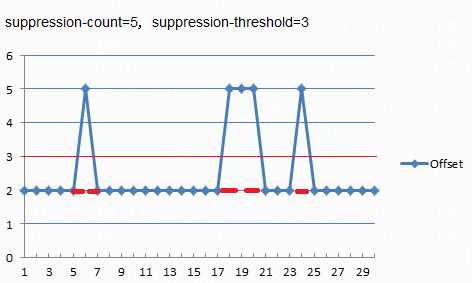

Usage guidelines
Application scenarios
This command prevents clock source jumps, meaning when the clock source jumps, the altered clock is not synchronized. This reduces instances where the master clock's PTP time instability causes the device to sync to the wrong PTP time in the short term. As shown in Figure 1, assuming the suppression count is 5 and the suppression threshold is 3, normal synchronization occurs when Offset is less than or equal to 3. When a clock change causes Offset to exceed 3, synchronization of that clock signal is paused. The system can pause the synchronization of up to suppression-count clock signals at one time.
Figure 1 Clock jumping prevention of PTP
Operating mechanism
After master-member relationships are established between the clock nodes, the master and member clock nodes exchange PTP messages and record the message transmit and receive time. Based on the timestamps, each member clock calculates the path delay and then gets the time offset between them and the master clock and adjusts their time accordingly for time synchronization with the master clock.
After you execute this command, if the Offset value remains less than or equal to the threshold value for suppression-count consecutive times, and the current Offset value exceeds the threshold value, the device determines a clock source jump has occurred and pauses PTP time synchronization. Whether subsequent clock signal synchronization is required is determined based on the following rules:
·     If the subsequent Offset value is less than or equal to the threshold value, PTP continues to synchronize PTP time.
·     If the subsequent Offset value still exceeds the threshold value, PTP will not synchronize PTP time until the suppression count is reached, indicating the master clock has stabilized. When the device receives the next PTP clock signal, it will synchronize regardless of the Offset value.
You can configure this command only when the PTP profile, PTP clock node type, and PTP domain are all specified.
If you execute this command multiple times, the most recent configuration takes effect.
