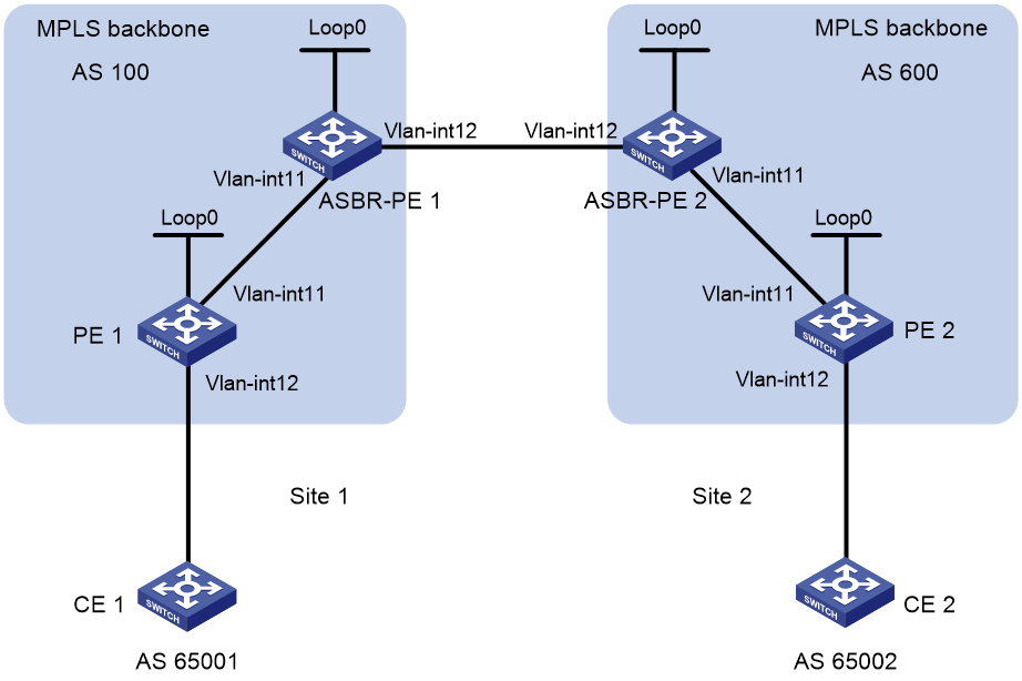

As shown in Figure 1, PE 1 and PE 2 have multiple tunnels in between and they are connected to multiple MPLS VPNs. You can control the paths for VPN traffic by using one of the following methods:
·     Preferred tunnel—Configure multiple tunnel policies, and specify a preferred tunnel for each policy. Apply these policies to different MPLS VPNs to forward the traffic of each VPN over a specific tunnel.
·     Load sharing—Configure one tunnel policy, and specify the tunnel selection order and the number of tunnels for load sharing. Apply the tunnel policy to MPLS VPNs to forward the traffic of every VPN over multiple tunnels.
Figure 1 Tunnel policy application scenario

Tunnel selector configuration examples (on switches)
Example: Configuring tunnel selectors for MPLS L3VPN inter-AS option B
As shown in Figure 2, site 1 and site 2 belong to the same VPN. CE 1 in site 1 accesses the MPLS network from PE 1 in AS 100. CE 2 in site 2 accesses the MPLS network from PE 2 in AS 600. IS-IS is running within the ASs.
PE 1 and ASBR-PE 1 exchange VPNv4 routes through MP-IBGP. PE 2 and ASBR-PE 2 exchange VPNv4 routes through MP-IBGP. ASBR-PE 1 and ASBR-PE 2 exchange VPNv4 routes through MP-EBGP.
A tunnel policy is applied on the PEs and a tunnel selector is applied on the ASBRs so the devices can select an MPLS TE tunnel to forward traffic between the sites.
The ASBRs do not perform route target filtering of received VPNv4 routes.
Figure 2 Network diagram
Device
Interface
IP address
Device
Interface
IP address
PE 1
Loop0
2.2.2.9/32
PE 2
Loop0
5.5.5.9/32
Vlan-int12
30.0.0.1/8
Vlan-int12
20.0.0.1/8
Vlan-int11
1.1.1.2/8
Vlan-int11
9.1.1.2/8
ASBR-PE 1
Loop0
3.3.3.9/32
ASBR-PE 2
Loop0
4.4.4.9/32
Vlan-int11
1.1.1.1/8
Vlan-int11
9.1.1.1/8
Vlan-int12
11.0.0.2/8
Vlan-int12
11.0.0.1/8

Example: Configuring tunnel selectors for IPv6 MPLS L3VPN inter-AS option B
As shown in Figure 3, site 1 and site 2 belong to the same VPN. CE 1 in site 1 accesses the MPLS network from PE 1 in AS 100. CE 2 in site 2 accesses the MPLS network from PE 2 in AS 600. IS-IS is running within the ASs.
PE 1 and ASBR-PE 1 exchange VPNv6 routes through MP-IBGP. PE 2 and ASBR-PE 2 exchange VPNv6 routes through MP-IBGP. ASBR-PE 1 and ASBR-PE 2 exchange VPNv6 routes through MP-EBGP.
The ASBRs do not perform route target filtering of received VPNv6 routes.
Figure 3 Network diagram
Table 3 Interface and IP address assignment

1.     Configure PE 1:

[ASBR-PE2-bgp-default] peer 11.0.0.2 as-number 100
[ASBR-PE2-bgp-default] peer 11.0.0.2 connect-interface vlan-interface 12
[ASBR-PE2-bgp-default] peer 5.5.5.9 as-number 600
[ASBR-PE2-bgp-default] peer 5.5.5.9 connect-interface loopback 0
# Disable route target based filtering of received VPNv6 routes.
[ASBR-PE2-bgp-default] address-family vpnv6
[ASBR-PE2-bgp-default-vpnv6] undo policy vpn-target
# Configure IBGP peer 5.5.5.9 and EBGP peer 11.0.0.2 as VPNv6 peers.
[ASBR-PE2-bgp-default-vpnv6] peer 11.0.0.2 enable
[ASBR-PE2-bgp-default-vpnv6] peer 5.5.5.9 enable
[ASBR-PE2-bgp-default-vpnv6] quit
[ASBR-PE2-bgp-default] quit
# Enable MPLS TE, RSVP-TE, and IS-IS TE. Configure MPLS TE attributes. Use RSVP-TE to establish MPLS TE tunnel 1. Set the tunnel destination address as the LSR ID of PE 2 (5.5.5.9). Assign 2000 kbps bandwidth to the tunnel.
[ASBR-PE2] mpls te
[ASBR-PE2-te] quit
[ASBR-PE2] rsvp
[ASBR-PE2-rsvp] quit
[ASBR-PE2] interface vlan-interface 11
[ASBR-PE2-Vlan-interface11] mpls enable
[ASBR-PE2-Vlan-interface11] mpls te enable
[ASBR-PE2-Vlan-interface11] mpls te max-link-bandwidth 10000
[ASBR-PE2-Vlan-interface11] rsvp enable
[ASBR-PE2-Vlan-interface11] quit
[ASBR-PE2] isis 1
[ASBR-PE2-isis-1] cost-style wide
[ASBR-PE2-isis-1] mpls te enable level-2
[ASBR-PE2-isis-1] quit
[ASBR-PE2] interface tunnel 1 mode mpls-te
[ASBR-PE2-Tunnel1] ip address unnumbered interface LoopBack0
[ASBR-PE2-Tunnel1] destination 5.5.5.9
[ASBR-PE2-Tunnel1] mpls te signaling rsvp-te
[ASBR-PE2-Tunnel1] mpls te bandwidth 2000
[ASBR-PE2-Tunnel1] quit
# Configure tunnel policy tpolicy1 and tunnel selector ts1, specify the tunnel policy for the tunnel selector, and then apply the tunnel selector in BGP VPNv6 view.
[ASBR-PE2] tunnel-policy tpolicy1
[ASBR-PE2-tunnel-policy-tpolicy1] preferred-path tunnel 1
[ASBR-PE2-tunnel-policy-tpolicy1] quit
[ASBR-PE2] tunnel-selector ts1 permit node 1
[ASBR-PE2-tunnel-selector-ts1-1] apply tunnel-policy tpolicy1
[ASBR-PE2-tunnel-selector-ts1-1] quit
[ASBR-PE2] bgp 600
[ASBR-PE2-bgp-default-vpnv6] apply tunnel-selector ts1
4.     Configure PE 2:
# Configure IS-IS on PE 2.
<PE2> system-view
[PE2] isis 1
[PE2-isis-1] network-entity 10.111.111.111.111.00
[PE2-isis-1] quit
# Configure LSR ID, and enable MPLS and LDP.
[PE2] mpls lsr-id 5.5.5.9
[PE2] mpls ldp
[PE2-ldp] quit
# Configure VLAN-interface 11, and enable IS-IS, MPLS, and LDP on the interface.
[PE2] interface vlan-interface 11
[PE2-Vlan-interface11] ip address 9.1.1.2 255.0.0.0
[PE2-Vlan-interface11] isis enable 1
[PE2-Vlan-interface11] mpls enable
[PE2-Vlan-interface11] mpls ldp enable
[PE2-Vlan-interface11] quit
# Configure interface Loopback 0, and enable IS-IS on it.
[PE2] interface loopback 0
[PE2-LoopBack0] ip address 5.5.5.9 32
[PE2-LoopBack0] isis enable 1
[PE2-LoopBack0] quit
# Create VPN instance vpn1, and configure the RD and route target attributes.
[PE2] ip vpn-instance vpn1
[PE2-vpn-instance-vpn1] route-distinguisher 12:12
[PE2-vpn-instance-vpn1] vpn-target 1:1 2:2 3:3 import-extcommunity
[PE2-vpn-instance-vpn1] vpn-target 3:3 export-extcommunity
[PE2-vpn-instance-vpn1] quit
# Bind the interface connected to CE 1 to the created VPN instance.
[PE2] interface vlan-interface 12
[PE2-Vlan-interface12] ip binding vpn-instance vpn1
[PE2-Vlan-interface12] ip address 20::1 64
[PE2-Vlan-interface12] quit
# Enable BGP on PE 2.
[PE2] bgp 600
# Configure IBGP peer 4.4.4.9 as a VPNv6 peer.
[PE2-bgp-default] peer 4.4.4.9 as-number 600
[PE2-bgp-default] peer 4.4.4.9 connect-interface loopback 0
[PE2-bgp-default] address-family vpnv6
[PE2-bgp-default-vpnv6] peer 4.4.4.9 enable
[PE2-bgp-default-vpnv6] quit
# Redistribute direct routes to the routing table of VPN instance vpn1.
[PE2-bgp-default] ip vpn-instance vpn1
[PE2-bgp-default-vpn1] address-family ipv6 unicast
[PE2-bgp-default-ipv6-vpn1] import-route direct
[PE2-bgp-default-ipv6-vpn1] quit
[PE2-bgp-default-vpn1] quit
[PE2-bgp-default] quit
# Enable MPLS TE, RSVP-TE, and IS-IS TE. Configure MPLS TE attributes. Use RSVP-TE to establish MPLS TE tunnel 1. Set the tunnel destination address as the LSR ID of ASBR-PE 2 (4.4.4.9). Assign 2000 kbps bandwidth to the tunnel.
[PE2] mpls te
[PE2-te] quit
[PE2] rsvp
[PE2-rsvp] quit
[PE2-Vlan-interface11] mpls te enable
[PE2-Vlan-interface11] mpls te max-link-bandwidth 10000
[PE2-Vlan-interface11] rsvp enable
[PE2] isis 1
[PE2-isis-1] cost-style wide
[PE2-isis-1] mpls te enable level-2
[PE2-isis-1] quit
[PE2] interface tunnel 1 mode mpls-te
[PE2-Tunnel1] ip address unnumbered interface LoopBack0
[PE2-Tunnel1] destination 4.4.4.9
[PE2-Tunnel1] mpls te signaling rsvp-te
[PE2-Tunnel1] mpls te bandwidth 2000
[PE2-Tunnel1] quit
# Create a tunnel policy named tpolicy1, and apply the tunnel policy to VPN instance vpn1.
[PE2] tunnel-policy tpolicy1
[PE2-tunnel-policy-tpolicy1] preferred-path tunnel 1
[PE2-tunnel-policy-tpolicy1] quit
[PE2-vpn-instance-vpn1] tnl-policy tpolicy1
# Verify that the CE-facing interfaces (VLAN-interface 12) on PE 1 and PE 2 can ping each other.
# Verify that tunnel policy tpolicy1 has been successfully applied between PE 1 and ASBR-PE 1 and between PE 2 and ASBR-PE 2. The devices select MPLS TE tunnel 1 as instructed by the tunnel policy.
