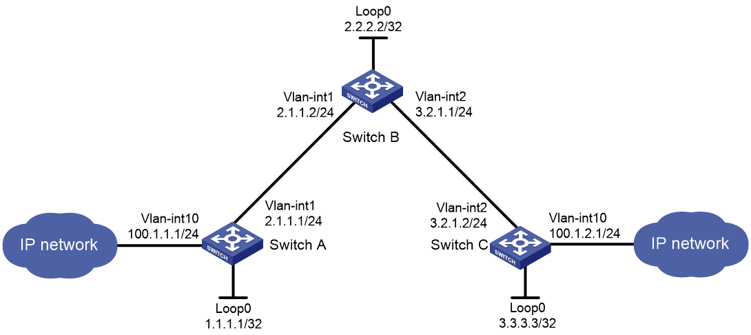

Example: Configuring a static CRLSP
Switch A, Switch B, and Switch C run IS-IS.
Establish an MPLS TE tunnel over a static CRLSP from Switch A to Switch C to transmit data between the two IP networks. The required bandwidth for the tunnel is 2000 kbps.
The maximum bandwidth for MPLS TE traffic is 10000 kbps.
Figure 1 Network diagram

6.     Create a static CRLSP:
# Configure Switch A as the ingress node of the static CRLSP, and specify the next hop address as 2.1.1.2, outgoing label as 20, and required bandwidth as 2000 kbps.
[SwitchA] static-cr-lsp ingress static-cr-lsp-1 nexthop 2.1.1.2 out-label 20 bandwidth 2000
# On Switch A, configure tunnel 1 to use the static CRLSP static-cr-lsp-1.
[SwitchA] interface tunnel 1
[SwitchA-Tunnel1] mpls te static-cr-lsp static-cr-lsp-1
[SwitchA-Tunnel1] quit
# Configure Switch B as the transit node of the static CRLSP, and specify the incoming label as 20, next hop address as 3.2.1.2, outgoing label as 30, and required bandwidth as 2000 kbps.
[SwitchB] static-cr-lsp transit static-cr-lsp-1 in-label 20 nexthop 3.2.1.2 out-label 30 bandwidth 2000
# Configure Switch C as the egress node of the static CRLSP, and specify the incoming label as 30.
[SwitchC] static-cr-lsp egress static-cr-lsp-1 in-label 30
7.     Configure a static route on Switch A to direct traffic destined for subnet 100.1.2.0/24 to MPLS TE tunnel 1.
[SwitchA] ip route-static 100.1.2.0 24 tunnel 1 preference 1

[SwitchB] display mpls static-cr-lsp
Name            LSR Type    In/Out Label   Out Interface        State
static-cr-lsp-1 Transit     20/30          Vlan2                Up
[SwitchC] display mpls static-cr-lsp
static-cr-lsp1  Egress      30/Null        -                    Up
# Verify that Switch A has a static route entry with interface Tunnel 1 as the output interface.
[SwitchA] display ip routing-table
Destinations : 12        Routes : 12
Destination/Mask   Proto   Pre Cost        NextHop         Interface
0.0.0.0/32         Direct  0   0           127.0.0.1       InLoop0
1.1.1.1/32         Direct  0   0           127.0.0.1       InLoop0
2.1.1.0/24         Direct  0   0           2.1.1.1         Vlan1
2.1.1.0/32         Direct  0   0           2.1.1.1         Vlan1
2.1.1.1/32         Direct  0   0           127.0.0.1       InLoop0
2.1.1.255/32       Direct  0   0           2.1.1.1         Vlan1
2.2.2.2/32         IS_L1   15  10          2.1.1.2         Vlan1
100.1.2.0/24       Static  1   0           0.0.0.0         Tun1
3.3.3.3/32         IS_L1   15  20          2.1.1.2         Vlan1
6.1.1.0/24         Direct  0   0           6.1.1.1         Tun1
6.1.1.0/32         Direct  0   0           6.1.1.1         Tun1
6.1.1.1/32         Direct  0   0           127.0.0.1       InLoop0
6.1.1.255/32       Direct  0   0           6.1.1.1         Tun1
