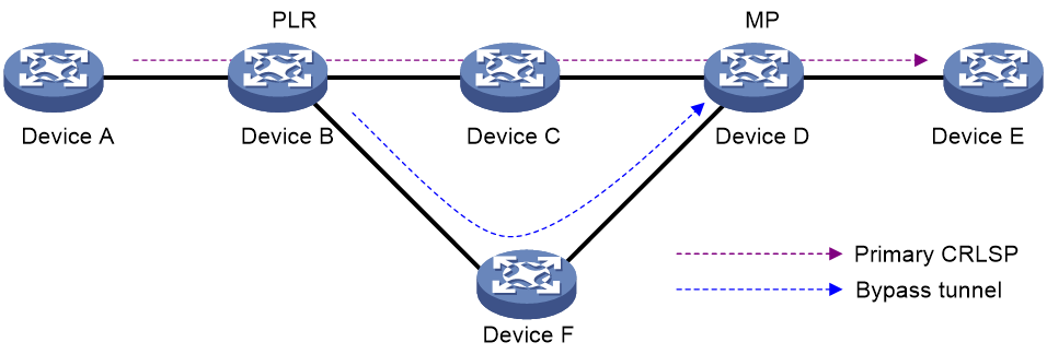

Make-before-break
Make-before-break is a mechanism to change an MPLS TE tunnel with minimum data loss and without using extra bandwidth.
In the case of tunnel reoptimization, traffic forwarding is interrupted if the existing CRLSP is removed before a new CRLSP is established. The make-before-break mechanism ensures that the existing CRLSP is removed after the new CRLSP is established and the traffic is switched to the new CRLSP. However, this wastes bandwidth resources if some links on the old and new CRLSPs are the same. This is because you need to reserve bandwidth on these links for the old and new CRLSPs separately. The make-before-break mechanism uses the SE resource reservation style to address this problem.
The resource reservation style refers to the style in which RSVP-TE reserves bandwidth resources during CRLSP establishment. The resource reservation style used by an MPLS TE tunnel is determined by the ingress node, and is advertised to other nodes through RSVP.
The device supports the following resource reservation styles:
·     FF—Fixed-filter, where resources are reserved for individual senders and cannot be shared among senders on the same session.
·     SE—Shared-explicit, where resources are reserved for senders on the same session and shared among them. SE is mainly used for make-before-break.
As shown in Figure 3, a CRLSP with 30 M reserved bandwidth has been set up from Device A to Device D through the path Device A—Device B—Device C—Device D.
To increase the reserved bandwidth to 40 M, a new CRLSP must be set up through the path Device A—Device E—Device C—Device D. To achieve this purpose, RSVP-TE needs to reserve 30 M bandwidth for the old CRLSP and 40 M bandwidth for the new CRLSP on the link Device C—Device D. However, there is not enough bandwidth.
After the make-before-break mechanism is used, the new CRLSP can share the bandwidth reserved for the old CRLSP. After the new CRLSP is set up, traffic is switched to the new CRLSP without service interruption, and then the old CRLSP is removed.

FRR
Fast reroute (FRR) protects CRLSPs from link and node failures. FRR can implement 50-millisecond CRLSP failover.
After FRR is enabled for an MPLS TE tunnel, once a link or node fails on the primary CRLSP, FRR reroutes the traffic to a bypass tunnel. The ingress node attempts to set up a new CRLSP. After the new CRLSP is set up, traffic is forwarded on the new CRLSP.
CRLSP backup provides end-to-end path protection for a CRLSP without time limitation. FRR provides quick but temporary protection for a link or node on a CRLSP.
Basic concepts
·     Primary CRLSP—Protected CRLSP.
·     Bypass tunnel—An MPLS TE tunnel used to protect a link or node of the primary CRLSP.
·     Point of local repair—A PLR is the ingress node of the bypass tunnel. It must be located on the primary CRLSP but must not be the egress node of the primary CRLSP.
·     Merge point—An MP is the egress node of the bypass tunnel. It must be located on the primary CRLSP but must not be the ingress node of the primary CRLSP.
Protection modes
FRR provides the following protection modes:
·     Link protection—The PLR and the MP are connected through a direct link and the primary CRLSP traverses this link. When the link fails, traffic is switched to the bypass tunnel. As shown in Figure 4, the primary CRLSP is Device A—Device B—Device C—Device D, and the bypass tunnel is Device B—Device F—Device C. This mode is also called next-hop (NHOP) protection.
Figure 4 FRR link protection
·     Node protection—The PLR and the MP are connected through a device and the primary CRLSP traverses this device. When the device fails, traffic is switched to the bypass tunnel. As shown in Figure 5, the primary CRLSP is Device A—Device B—Device C—Device D—Device E, and the bypass tunnel is Device B—Device F—Device D. Device C is the protected device. This mode is also called next-next-hop (NNHOP) protection.
Figure 5 FRR node protection

MPLS TE configuration examples
Example: Establishing an MPLS TE tunnel over a static CRLSP
Switch A, Switch B, and Switch C run IS-IS.
Establish an MPLS TE tunnel over a static CRLSP from Switch A to Switch C to transmit data between the two IP networks.
The MPLS TE tunnel requires a bandwidth of 2000 kbps. The maximum bandwidth of the link that the tunnel traverses is 10000 kbps.
Figure 6 Network diagram

Example: Establishing an inter-area MPLS TE tunnel over a CRLSP calculated by PCEs
Switch A, Switch B, Switch C, and Switch D support MPLS TE and run OSPF.
Configure Switch A and Switch B as PCEs, and configure Switch C as a PCC to automatically discover the PCEs.
Establish an MPLS TE tunnel over a CRLSP from Switch C to Switch D that uses the inter-area path calculated by PCEs.
Figure 9 Network diagram

Example: Configuring CRLSP backup
Switch A, Switch B, Switch C, and Switch D run IS-IS and IS-IS TE.
Use RSVP-TE to establish an MPLS TE tunnel from Switch A to Switch C to transmit data between the two IP networks. Enable CRLSP hot backup for the tunnel to simultaneously establish a primary CRLSP and a backup CRLSP. When the primary CRLSP fails, traffic is switched to the backup CRLSP.
Figure 11 Network diagram
Table 4 Interface and IP address assignment
Device
Interface
IP address
Device
Interface
IP address
Switch A
Loop0
1.1.1.9/32
Switch D
Loop0
4.4.4.9/32
Vlan-int1
10.1.1.1/24
Vlan-int4
30.1.1.2/24
Vlan-int4
30.1.1.1/24
Vlan-int3
40.1.1.1/24
Vlan-int10
100.1.1.1/24
Switch C
Loop0
3.3.3.9/32
Switch B
Loop0
2.2.2.9/32
Vlan-int2
20.1.1.2/24
Vlan-int1
10.1.1.2/24
Vlan-int3
40.1.1.2/24
Vlan-int2
20.1.1.1/24
Vlan-int10
100.1.2.1/24
Before configuration, disable the spanning tree feature globally or map each VLAN to an MSTI. For more information, see Layer 2—LAN Switching Configuration Guide.
1.     Configure IP addresses and masks for interfaces. (Details not shown.)

Example: Configuring manual bypass tunnel for FRR
On the primary CRLSP Switch A—Switch B—Switch C—Switch D, use FRR to protect the link Switch B—Switch C.
Use RSVP-TE to establish the primary CRLSP and bypass tunnel based on the constraints of the explicit paths to transmit data between the two IP networks. The bypass tunnel uses path Switch B—Switch E—Switch C. Switch B is the PLR and Switch C is the MP.
Configure BFD for RSVP-TE between Switch B and Switch C. When the link between Switch B and Switch C fails, BFD can detect the failure quickly and notify RSVP-TE of the failure, so RSVP-TE can switch traffic to the bypass tunnel.
Figure 12 Network diagram
Table 5 Interface and IP address assignment

Example: Configuring auto FRR
Use RSVP-TE to set up a primary CRLSP that explicitly uses path Switch A—Switch B—Switch C—Switch D.
Configure auto FRR on Switch B to automatically set up bypass tunnels for the primary CRLSP.
Figure 13 Network diagram
Table 6 Interface and IP address assignment
Device
Interface
IP address
2.     Configure IS-IS to advertise interface addresses, including the loopback interface address. (Details not shown.)
3.     Configure an LSR ID, and enable MPLS, MPLS TE, and RSVP-TE on each switch. Enable BFD for RSVP-TE on Switch B and Switch C:

4.     Configure an MPLS TE tunnel on Switch A, the ingress node of the primary CRLSP:
# Configure an explicit path named pri-path for the primary CRLSP.
[SwitchA] explicit-path pri-path
[SwitchA-explicit-path-pri-path] nexthop 2.1.1.2
[SwitchA-explicit-path-pri-path] nexthop 3.1.1.2
[SwitchA-explicit-path-pri-path] nexthop 4.1.1.2
[SwitchA-explicit-path-pri-path] nexthop 4.4.4.4
[SwitchA-explicit-path-pri-path] quit
# Configure an MPLS TE tunnel.
[SwitchA] interface tunnel 1 mode mpls-te
[SwitchA-Tunnel1] ip address 10.1.1.1 255.255.255.0
# Specify the tunnel destination address as the LSR ID of Switch D.
[SwitchA-Tunnel1] destination 4.4.4.4
# Specify the tunnel signaling protocol as RSVP-TE.
[SwitchA-Tunnel1] mpls te signaling rsvp-te
# Specify the explicit path as pri-path.
[SwitchA-Tunnel1] mpls te path preference 1 explicit-path pri-path
# Enable FRR for the MPLS TE tunnel.
[SwitchA-Tunnel1] mpls te fast-reroute
[SwitchA-Tunnel1] quit
