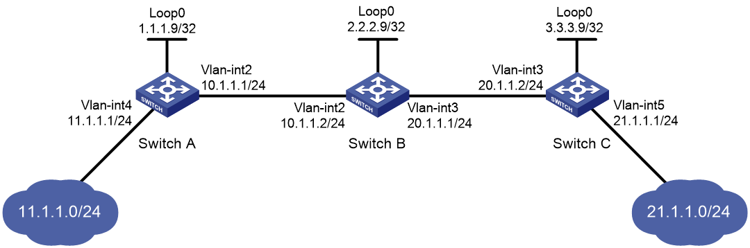

Example: Configuring static LSPs
Switch A, Switch B, and Switch C all support MPLS.
Establish static LSPs between Switch A and Switch C, so that subnets 11.1.1.0/24 and 21.1.1.0/24 can access each other over MPLS.
Figure 1 Network diagram
1.     Create VLANs and configure IP addresses for all interfaces, including the loopback interfaces, as shown in Figure 1. (Details not shown.)

4.     Configure a static LSP from Switch A to Switch C:
# Configure the LSP ingress node, Switch A.
[SwitchA] static-lsp ingress AtoC destination 21.1.1.0 24 nexthop 10.1.1.2 out-label 30
# Configure the LSP transit node, Switch B.
[SwitchB] static-lsp transit AtoC in-label 30 nexthop 20.1.1.2 out-label 50
# Configure the LSP egress node, Switch C.
[SwitchC] static-lsp egress AtoC in-label 50
5.     Configure a static LSP from Switch C to Switch A:
# Configure the LSP ingress node, Switch C.
[SwitchC] static-lsp ingress CtoA destination 11.1.1.0 24 nexthop 20.1.1.1 out-label 40
[SwitchB] static-lsp transit CtoA in-label 40 nexthop 10.1.1.1 out-label 70
# Configure the LSP egress node, Switch A.
[SwitchA] static-lsp egress CtoA in-label 70
# Display static LSP information on switches, for example, on Switch A.
[SwitchA] display mpls static-lsp
Total: 2
Name            FEC                In/Out Label Nexthop/Out Interface    State
AtoC            21.1.1.0/24        NULL/30      10.1.1.2                 Up
CtoA            -/-                70/NULL      -                        Up
