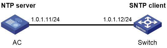

Figure 1 shows how NTP synchronizes the system time between two devices (Device A and Device B, in this example). Assume that:
·     Prior to the time synchronization, the time is set to 10:00:00 am for Device A and 11:00:00 am for Device B.
·     Device B is used as the NTP server. Device A is to be synchronized to Device B.
·     It takes 1 second for an NTP message to travel from Device A to Device B, and from Device B to Device A.
·     It takes 1 second for Device B to process the NTP message.
Figure 1 Basic work flow
The synchronization process is as follows:
1.     Device A sends Device B an NTP message, which is timestamped when it leaves Device A. The time stamp is 10:00:00 am (T1).
2.     When this NTP message arrives at Device B, Device B adds a timestamp showing the time when the message arrived at Device B. The timestamp is 11:00:01 am (T2).
3.     When the NTP message leaves Device B, Device B adds a timestamp showing the time when the message left Device B. The timestamp is 11:00:02 am (T3).
4.     When Device A receives the NTP message, the local time of Device A is 10:00:03 am (T4).
Up to now, Device A can calculate the following parameters based on the timestamps:
·     The roundtrip delay of the NTP message: Delay = (T4 – T1) – (T3 – T2) = 2 seconds.
·     Time difference between Device A and Device B: Offset = [ (T2 – T1) + (T3 – T4) ] /2 = 1 hour.
Based on these parameters, Device A can be synchronized to Device B.

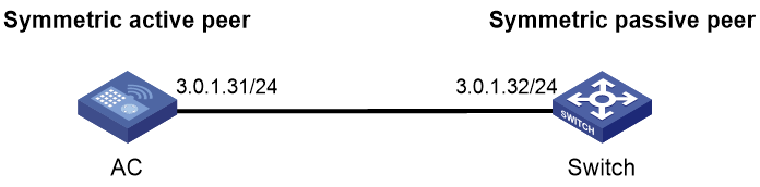

NTP uses stratums 0 to 16 to define clock accuracy, as shown in Figure 2. A lower stratum value represents higher accuracy.
Figure 2 NTP architecture
A stratum 1 NTP server gets its time from an authoritative time source, such as an atomic clock. It provides time for other devices as the primary NTP server. A stratum 2 time server receives its time from a stratum 1 time server, and so on.
To ensure time accuracy and availability, you can specify multiple NTP servers for a device. The device selects an optimal NTP server as the clock source based on parameters such as stratum. The clock that the device selects is called the reference source. For more information about clock selection, see the related protocols and standards.
If the devices in a network cannot synchronize to an authoritative time source, you can perform the following tasks:
·     Select a device that has a relatively accurate clock from the network.
·     Use the local clock of the device as the reference clock to synchronize other devices in the network.

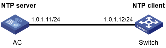

Figure 3 NTP authentication
As shown in Figure 3, NTP authentication is performed as follows:
1.     The sender uses the key identified by the key ID to calculate a digest for the NTP message through the MD5/HMAC authentication algorithm. Then it sends the calculated digest together with the NTP message and key ID to the receiver.
2.     Upon receiving the message, the receiver performs the following actions:
a.     Finds the key according to the key ID in the message.
b.     Uses the key and the MD5/HMAC authentication algorithm to calculate the digest for the message.
c.     Compares the digest with the digest contained in the NTP message.
-     If they are different, the receiver discards the message.
-     If they are the same and an NTP association is not required to be established, the receiver provides a response packet. For information about NTP associations, see "Configuring the maximum number of dynamic associations."
-     If they are the same and an NTP association is required to be established or has existed, the local device determines whether the sender is allowed to use the authentication ID. If the sender is allowed to use the authentication ID, the receiver accepts the message. If the sender is not allowed to use the authentication ID, the receiver discards the message.

NTP configuration examples (on ACs)
Example: Configuring NTP client/server association mode
As shown in Figure 4, perform the following tasks:
·     Configure the AC's local clock as its reference source, with stratum level 2.
·     Configure the switch to operate in client mode and specify the AC as the NTP server of the switch.
Figure 4 Network diagram
1.     Assign an IP address to each interface, and make sure the AC and the switch can reach each other, as shown in Figure 4. (Details not shown.)
2.     Configure the AC:
# Enable the NTP service.
<AC> system-view
[AC] ntp-service enable
# Specify the local clock as the reference source, with stratum level 2.
[AC] ntp-service refclock-master 2
3.     Configure the switch:
<Switch> system-view
[Switch] ntp-service enable
# Specify NTP for obtaining the system time.
[Switch] clock protocol ntp
# Specify the AC as the NTP server of the switch.
[Switch] ntp-service unicast-server 1.0.1.11
4.     Verify the configuration:
# Verify that the switch has synchronized its time with the AC, and the clock stratum level of the switch is 3.
[Switch] display ntp-service status
 Clock status: synchronized
 Clock stratum: 3
 System peer: 1.0.1.11
 Local mode: client
 Reference clock ID: 1.0.1.11
 Leap indicator: 00
 Clock jitter: 0.000977 s
 Stability: 0.000 pps
 Clock precision: 2^-23
 Root delay: 0.00383 ms
 Root dispersion: 16.26572 ms
 Reference time: d0c6033f.b9923965  Wed, Dec 29 2010 18:58:07.724
# Verify that an IPv4 NTP association has been established between the switch and the AC.
[Switch] display ntp-service sessions
       source          reference       stra reach poll  now offset  delay disper
[12345]1.0.1.11        127.127.1.0        2     1   64   15   -4.0 0.0038 16.262
Notes: 1 source(master), 2 source(peer), 3 selected, 4 candidate, 5 configured.
 Total sessions: 1
Example: Configuring IPv6 NTP client/server association mode
As shown in Figure 5, perform the following tasks:
·     Configure the switch to operate in client mode and specify the AC as the IPv6 NTP server of the switch.
Figure 5 Network diagram
1.     Assign an IP address to each interface, and make sure the AC and the switch can reach each other, as shown in Figure 5. (Details not shown.)
<AC> system-view
# Specify the AC as the IPv6 NTP server of the switch.
[Switch] ntp-service ipv6 unicast-server 3000::34
 Clock stratum: 3
 System peer: 3000::34
 Local mode: client
 Reference clock ID: 163.29.247.19
 Leap indicator: 00
 Root delay: 0.02649 ms
 Root dispersion: 12.24641 ms
 Reference time: d0c60419.9952fb3e  Wed, Dec 29 2010 19:01:45.598
# Verify that an IPv6 NTP association has been established between the switch and the AC.
[Switch] display ntp-service ipv6 sessions
 Source: [12345]3000::34
 Reference: 127.127.1.0          Clock stratum: 2
 Reachabilities: 15              Poll interval: 64
 Last receive time: 19           Offset: 0.0
 Roundtrip delay: 0.0            Dispersion: 0.0
 Total sessions: 1
Example: Configuring NTP symmetric active/passive association mode
As shown in Figure 6, perform the following tasks:
·     Configure the AC to operate in symmetric-active mode and specify the switch as the passive peer of the AC.
Figure 6 Network diagram
1.     Assign an IP address to each interface, and make sure the AC and the switch can reach each other, as shown in Figure 6. (Details not shown.)
2.     Configure the switch:
3.     Configure the AC:
<AC> system-view
[AC] clock protocol ntp
# Configure the switch as the symmetric passive peer.
[AC] ntp-service unicast-peer 3.0.1.32
# Verify that the switch has synchronized its time with the AC and the clock stratum level of the switch is 3.
 Clock stratum: 3
 System peer: 3.0.1.31
 Local mode: sym_passive
 Reference clock ID: 3.0.1.31

Example: Configuring IPv6 NTP symmetric active/passive association mode
As shown in Figure 7:
·     Configure AC's local clock as its reference source, with stratum level 2.
·     Configure the AC to operate in symmetric-active mode and specify the switch as the IPv6 passive peer of the AC.
Figure 7 Network diagram
1.     Assign an IP address to each interface, and make sure the AC and the switch can reach each other, as shown in Figure 7. (Details not shown.)
<AC> system-view
# Configure the switch as the IPv6 symmetric passive peer.
[AC] ntp-service ipv6 unicast-peer 3000::36
 Clock stratum: 3
 System peer: 3000::35
 Reference clock ID: 251.73.79.32
 Leap indicator: 11
 Root delay: 0.01855 ms
 Root dispersion: 9.23483 ms
 Reference time: d0c6047c.97199f9f  Wed, Dec 29 2010 19:03:24.590
 Source:  [1234]3000::35
 Total sessions: 1
Example: Configuring authenticated NTP in client/server association mode
As shown in Figure 8, perform the following tasks:
·     Configure NTP authentication on both the AC and the switch.
Figure 8 Network diagram
1.     Assign an IP address to each interface, and make sure the AC and the switch can reach each other, as shown in Figure 8. (Details not shown.)
<AC> system-view
# Enable NTP authentication on the switch.
[Switch] ntp-service authentication enable
# Create authentication key 42 and set the key value to aNiceKey in plain text.
[Switch] ntp-service authentication-keyid 42 authentication-mode md5 simple aNiceKey
# Specify key 42 as a trusted key.
[Switch] ntp-service reliable authentication-keyid 42
# Specify the AC as the NTP server of the switch, and associate the server with key 42.
[Switch] ntp-service unicast-server 1.0.1.11 authentication-keyid 42
To enable the switch to synchronize its clock with the AC, enable NTP authentication on the AC.
4.     Configure NTP authentication on the AC:
# Enable NTP authentication.
[AC] ntp-service authentication enable
[AC] ntp-service authentication-keyid 42 authentication-mode md5 simple aNiceKey
[AC] ntp-service reliable authentication-keyid 42
5.     Verify the configuration:
 Clock stratum: 3
 Local mode: client
 Leap indicator: 00
 Clock jitter: 0.005096 s
 Root delay: 0.00655 ms
 Root dispersion: 1.15869 ms
 Reference time: d0c62687.ab1bba7d  Wed, Dec 29 2010 21:28:39.668
 [1245]1.0.1.11        127.127.1.0        2     1   64  519   -0.0 0.0065    0.0
Notes: 1 source(master),2 source(peer),3 selected,4 candidate,5 configured.
 Total sessions: 1

Example: Configuring SNTP
As shown in Figure 9:
·     Configure AC's local clock of the AC as its reference source, with stratum level 2.
·     Configure the switch to operate in SNTP client mode, and specify the AC as the NTP server.
·     Configure NTP authentication on the AC and SNTP authentication on the switch.
Figure 9 Network diagram
1.     Assign an IP address to each interface, and make sure the AC and the switch can reach each other, as shown in Figure 9. (Details not shown.)
<AC> system-view
# Configure the local clock as the reference source, with stratum level 2.
# Enable NTP authentication on the AC.
# Create authentication key 10 and set the key value to aNiceKey, in plain text.
[AC] ntp-service authentication-keyid 10 authentication-mode md5 simple aNiceKey
# Specify key 10 as a trusted key.
[AC] ntp-service reliable authentication-keyid 10
# Enable the SNTP service.
[Switch] sntp enable
# Enable SNTP authentication on the switch.
[Switch] sntp authentication enable
[Switch] sntp authentication-keyid 10 authentication-mode md5 simple aNiceKey
[Switch] sntp reliable authentication-keyid 10
# Specify the AC as the NTP server of the switch, and associate the server with key 10.
[Switch] sntp unicast-server 1.0.1.11 authentication-keyid 10
# Verify that an SNTP association has been established between the switch and the AC, and the switch has synchronized to the AC.
[Switch] display sntp sessions
NTP server     Stratum   Version    Last receive time
1.0.1.11        2         4          Tue, May 17 2011  9:11:20.833 (Synced)
