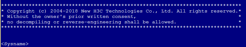

Displaying copyright information
Enabling copyright statement display
This feature enables the device to display the copyright statement in the following situations:
·     When a Telnet or SSH user logs in.
·     When a console dial-in user quits user view. This is because the device automatically tries to restart the user session.
Figure 1 shows the copyright statement.
If you disable displaying the copyright statement, the device does not display the copyright statement in any situations.
Figure 1 Copyright statement at the login page
2.     Enable copyright statement display.
copyright-info enable
By default, copyright statement display is enabled.

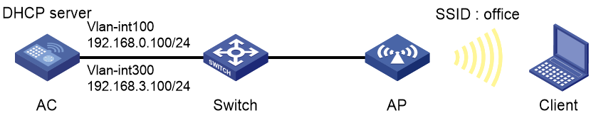

Example: Scheduling a task
As shown in Figure 2, the client needs to access the AC. The AP is connected to the AC through the switch. The AC acts as the DHCP server to assign IP addresses to the AP and client.
To save energy, configure the AC to perform the following operations:
·     Enable the interface connected to the AP (Radio 1) at 8:00 a.m. every day.
·     Disable the interface connected to the AP (Radio 1) at 20:00 every day.
Figure 2 Network diagram
# Configure wireless access on the AC. For more information, see WLAN Access Configuration Guide.
# Enter system view.
<AC> system-view
# Configure a job for disabling the interface.
[AC] scheduler job radio_disable
[AC-job-radio_disable] command 1 system-view
[AC-job-radio_disable] command 2 wlan ap ap1 model WA6320
[AC-job-radio_disable] command 3 radio 1
[AC-job-radio_disable] command 4 radio disable
[AC-job-radio_disable] quit
# Configure a periodic schedule for disabling the interface at 20:00 every day.
[AC] scheduler schedule stop_radio
[AC-schedule-stop_radio] job radio_disable
