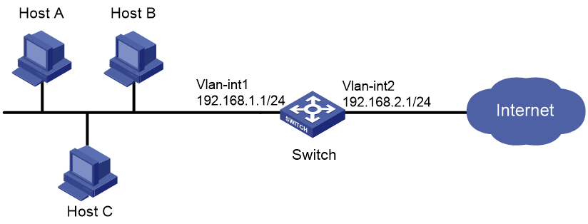

Attack detection and prevention configuration examples
Example: Configuring attack detection and prevention on the device
Configure attack detection and prevention on the switch (the gateway) to protect against network attacks from the user side or the network side.
·     To prevent TCP flag attacks and low level scanning attacks that aim at the switch, enable TCP flag attack prevention and scanning attack prevention. Configure the device to output logs if it detects such attacks.
·     To prevent the SYN flood attacks that aim at the external interface of the switch, enable IP address-specific SYN flood attack detection for 192.168.2.1/24. When the device receives 5000 or more SYN packets sent to the protected IP address per second, it outputs logs and drops the packets.
·     To prevent the SYN flood attacks that aim at the internal interface of the switch, enable global SYN flood attack detection. When the device receives 2000 or more SYN packets that are destined to the switch but not to the protected IP address per second, it outputs logs.
Figure 1 Network diagram
# Create attack defense policy a1.
[Switch] attack-defense policy a1
# Enable signature detection for TCP single packet attacks and specify logging as the attack prevention action. A TCP packet is identified as an attack packet if it has all flags set, only FIN flag set, invalid flags, no TCP flags set, or both SYN and FIN flags set.
[Switch-attack-defense-policy-a1] signature detect tcp-all-flags action logging
[Switch-attack-defense-policy-a1] signature detect tcp-fin-only action logging
[Switch-attack-defense-policy-a1] signature detect tcp-invalid-flags action logging
[Switch-attack-defense-policy-a1] signature detect tcp-null-flag action logging
[Switch-attack-defense-policy-a1] signature detect tcp-syn-fin action logging
# Enable low level scanning attack detection and specify logging as the attack prevention action.
[Switch-attack-defense-policy-a1] scan detect level low action logging
# Enable SYN flood attack detection for 192.168.2.1. Set the threshold for triggering SYN flood attack prevention to 5000 and specify logging and drop as the attack prevention actions.
[Switch-attack-defense-policy-a1] syn-flood detect ip 192.168.2.1 threshold 5000 action logging drop
# Enable global SYN flood attack detection, set the global threshold for triggering SYN flood attack prevention to 2000, and specify logging as the global attack prevention action.
[Switch-attack-defense-policy-a1] syn-flood detect non-specific
[Switch-attack-defense-policy-a1] syn-flood threshold 2000
[Switch-attack-defense-policy-a1] syn-flood action logging
[Switch-attack-defense-policy-a1] quit

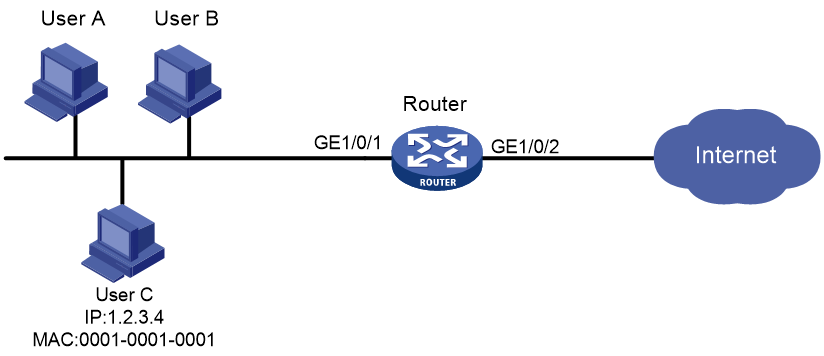

Example: Configuring IP blacklist
As shown in Figure 2, configure the IP blacklist feature on the router to block packets from the attacker Host D permanently and from Host C for 50 minutes.
Figure 2 Network diagram
The S5130S-EI-G switch series does not support the blacklist feature.
# Configure IP addresses for the interfaces on the router. (Details not shown.)
# Enable the global blacklist feature.
<Router> system-view
[Router] blacklist global enable
# Add an IPv4 blacklist entry for Host D.
[Router] blacklist ip 5.5.5.5
# Add an IPv4 blacklist entry for Host C and set the blacklist entry aging time to 50 minutes.
[Router] blacklist ip 192.168.1.4 timeout 50
# Verify that the IPv4 blacklist entries are successfully added.
<Router> display blacklist ip

Example: Configuring user blacklist
As shown in Figure 3, configure the user blacklist feature on the router to block packets from User C for 50 minutes. The IP address of User C is 1.2.3.4 and the MAC address of User C is 0001-0001-0001.
Figure 3 Network diagram
1.     Configure IP addresses for the interfaces on the router. (Details not shown.)
2.     Configure user identification:
# Add a network access user named userc.
[Router] local-user userc class network
[Router-luser-network-userc] quit
# Configure a static identity user with username userc, IP address 1.2.3.4, and MAC address 0001-0001-0001.
[Router] user-identity static-user userc bind ipv4 1.2.3.4 mac 0001-0001-0001
# Enable user identification.
[Router] user-identity enable
3.     Configure the user blacklist feature:
# Add a user blacklist entry for user userc and set the blacklist entry aging time to 50 minutes.
[Router] blacklist user userc timeout 50
# Verify that the user blacklist entry is successfully added.
[Router] display blacklist user
User name      Type    TTL(sec) Dropped
userc          Manual  2987     0
# Verify that the router drops packets from User C for 50 minutes and forwards packets from User C after 50 minutes. (Details not shown.)
