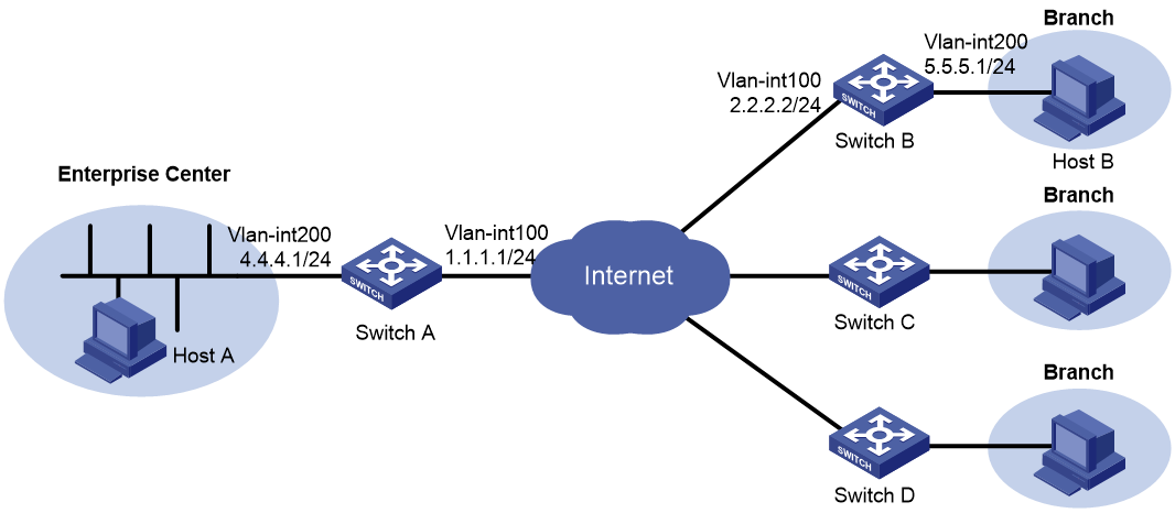

Mirror image ACLs
To make sure SAs can be set up and the traffic protected by IPsec can be processed correctly between two IPsec peers, create mirror image ACLs on the IPsec peers. As shown in Figure 4, ACL rules on Device B are mirror images of the rules on Device A. In this way, SAs can be created successfully for the traffic between Host A and Host C and for the traffic between Network 1 and Network 2.
Figure 4 Mirror image ACLs
If the ACL rules on IPsec peers do not form mirror images of each other, SAs can be set up only when both of the following requirements are met:
·     The range specified by an ACL rule on one peer is covered by its counterpart ACL rule on the other peer. As shown in Figure 5, the range specified by the ACL rule configured on Device A is covered by its counterpart on Device B.
·     The peer with the narrower rule initiates SA negotiation. If a wider ACL rule is used by the SA initiator, the negotiation request might be rejected because the matching traffic is beyond the scope of the responder. As shown in Figure 5, the SA negotiation initiated by Host A to Host C is accepted but the SA negotiations from Host C to Host A, from Host C to Host B, and from Host D to Host A are rejected.
Figure 5 Non-mirror image ACLs

Example: Configuring an IKE-based IPsec tunnel for IPv4 packets
As shown in Figure 7, establish an IPsec tunnel between Switch A and Switch B to protect data flows between them. Configure the IPsec tunnel as follows:
·     Specify the encapsulation mode as tunnel, the security protocol as ESP, the encryption algorithm as AES-CBC-192, and the authentication algorithm as HMAC-SHA1.
·     Set up SAs through IKE negotiation.
Figure 7 Network diagram

Example: Configuring IPsec RRI
As shown in Figure 9, branches access the enterprise center through an IPsec VPN.
Configure the IPsec VPN as follows:
·     Configure an IPsec tunnel between Switch A and each branch gateway (Switch B, Switch C, and Switch D) to protect traffic between subnets 4.4.4.0/24 and 5.5.5.0/24.
·     Configure the tunnels to use security protocol ESP, encryption algorithm DES, and authentication algorithm SHA1-HMAC-96. Use IKE for IPsec SA negotiation.
·     Configure IKE proposal to use the preshared key authentication method, encryption algorithm 3DES, and authentication algorithm HMAC-SHA1.
·     Configure IPsec RRI on Switch A to automatically create static routes to the branches based on the established IPsec SAs.
Figure 9 Network diagram
1.     Assign IPv4 addresses to the interfaces on the switches according to Figure 9. (Details not shown.)

1.     Verify that IPsec RRI can automatically create a static route from Switch A to Switch B:
# Initiate a connection from subnet 5.5.5.0/24 to subnet 4.4.4.0/24. IKE negotiation is triggered to establish IPsec SAs between Switch A and Switch B. (Details not shown.)
# Verify that IPsec SAs are established on Switch A.

IKE configuration examples
Example: Configuring main-mode IKE with preshared key authentication
As shown in Figure 13, configure an IKE-based IPsec tunnel between Switch A and Switch B to secure the communication between the switches.
·     Configure the two switches to use the default IKE proposal for the IKE negotiation.
·     Configure the two switches to use the preshared key authentication method for the IKE negotiation.
Figure 13 Network diagram
1.     Make sure Switch A and Switch B can reach each other.
2.     Configure Switch A:
# Configure an IP address for VLAN-interface 1.
<SwitchA> system-view
[SwitchA] interface vlan-interface 1
[SwitchA-vlan-interface1] ip address 1.1.1.1 255.255.0.0
[SwitchA-vlan-interface1] quit
# Configure IPv4 advanced ACL 3101 to identify the traffic from Switch A to Switch B.
[SwitchA] acl advanced 3101
[SwitchA-acl-ipv4-adv-3101] rule 0 permit ip source 1.1.1.1 0 destination 2.2.2.2 0
[SwitchA-acl-ipv4-adv-3101] quit
# Create an IPsec transform set named tran1.
[SwitchA] ipsec transform-set tran1
# Set the packet encapsulation mode to tunnel.
[SwitchA-ipsec-transform-set-tran1] encapsulation-mode tunnel
# Use the ESP protocol for the IPsec transform set.
[SwitchA-ipsec-transform-set-tran1] protocol esp
# Specify the encryption and authentication algorithms.
[SwitchA-ipsec-transform-set-tran1] esp encryption-algorithm aes-cbc-192
[SwitchA-ipsec-transform-set-tran1] esp authentication-algorithm sha1
[SwitchA-ipsec-transform-set-tran1] quit
# Create an IKE keychain named keychain1.
[SwitchA] ike keychain keychain1
# Specify 12345zxcvb!@#$%ZXCVB in plain text as the preshared key to be used with the remote peer at 2.2.2.2.
[SwitchA-ike-keychain-keychain1] pre-shared-key address 2.2.2.2 255.255.0.0 key simple 12345zxcvb!@#$%ZXCVB
[SwitchA-ike-keychain-keychain1] quit
# Create an IKE profile named profile1.
[SwitchA] ike profile profile1
# Specify IKE keychain keychain1.
[SwitchA-ike-profile-profile1] keychain keychain1
# Configure a peer ID with the identity type as IP address and the value as 2.2.2.2/16.
[SwitchA-ike-profile-profile1] match remote identity address 2.2.2.2 255.255.0.0
[SwitchA-ike-profile-profile1] quit
# Create an IKE-based IPsec policy entry. Specify the policy name as map1 and set the sequence number to 10.
[SwitchA] ipsec policy map1 10 isakmp
# Specify the remote IP address 2.2.2.2 for the IPsec tunnel.
[SwitchA-ipsec-policy-isakmp-map1-10] remote-address 2.2.2.2
# Specify ACL 3101 to identify the traffic to be protected.
[SwitchA-ipsec-policy-isakmp-map1-10] security acl 3101
# Specify IPsec transform set tran1 for the IPsec policy.
[SwitchA-ipsec-policy-isakmp-map1-10] transform-set tran1
# Specify IKE profile profile1 for the IPsec policy.
[SwitchA-ipsec-policy-isakmp-map1-10] ike-profile profile1
[SwitchA-ipsec-policy-isakmp-map1-10] quit
# Apply IPsec policy map1 to VLAN-interface 1.
[SwitchA-Vlan-interface1] ipsec apply policy map1
3.     Configure Switch B:
<SwitchB> system-view
[SwitchB] interface Vlan-interface1
[SwitchB-Vlan-interface1] ip address 2.2.2.2 255.255.0.0
[SwitchB-Vlan-interface1] quit
# Configure IPv4 advanced ACL 3101 to identify the traffic from Switch B to Switch A.
[SwitchB] acl number 3101
[SwitchB-acl-adv-3101] rule 0 permit ip source 2.2.2.2 0 destination 1.1.1.1 0
[SwitchB-acl-adv-3101] quit
[SwitchB] ipsec transform-set tran1
[SwitchB-ipsec-transform-set-tran1] encapsulation-mode tunnel
[SwitchB-ipsec-transform-set-tran1] protocol esp
[SwitchB-ipsec-transform-set-tran1] esp encryption-algorithm aes-cbc-192
[SwitchB-ipsec-transform-set-tran1] esp authentication-algorithm sha1
[SwitchB-ipsec-transform-set-tran1] quit
[SwitchB]ike keychain keychain1
# Specify 12345zxcvb!@#$%ZXCVB in plain text as the preshared key to be used with the remote peer at 1.1.1.1.
[SwitchB-ike-keychain-keychain1] pre-shared-key address 1.1.1.1 255.255.0.0 key simple 12345zxcvb!@#$%ZXCVB
[SwitchB-ike-keychain-keychain1] quit
[SwitchB] ike profile profile1
[SwitchB-ike-profile-profile1] keychain keychain1
# Configure a peer ID with the identity type as IP address and the value as 1.1.1.1/16.
[SwitchB-ike-profile-profile1] match remote identity address 1.1.1.1 255.255.0.0
[SwitchB-ike-profile-profile1] quit
# Create an IKE-based IPsec policy entry. Specify the policy name as use1 and set the sequence number to 10.
[SwitchB] ipsec policy use1 10 isakmp
# Specify the remote IP address 1.1.1.1 for the IPsec tunnel.
[SwitchB-ipsec-policy-isakmp-use1-10] remote-address 1.1.1.1
[SwitchB-ipsec-policy-isakmp-use1-10] security acl 3101
[SwitchB-ipsec-policy-isakmp-use1-10] transform-set tran1
[SwitchB-ipsec-policy-isakmp-use1-10] ike-profile profile1
[SwitchB-ipsec-policy-isakmp-use1-10] quit
# Apply IPsec policy use1 to VLAN-interface 1.
[SwitchB] interface vlan-interface 1
[SwitchB-Vlan-interface1] ipsec apply policy use1
# Initiate a connection between Switch A and Switch B to trigger IKE negotiation. After IPsec SAs are successfully negotiated by IKE, the traffic between the two switches is IPsec-protected.
As shown in Figure 14, establish an IPsec tunnel between Switch A and Switch B to protect data flows between the switches. Configure the IPsec tunnel as follows:
Figure 14 Network diagram
1.     Configure Switch A:

This feature applies to scenarios where the headquarters and branches communicate through virtual tunnels. It enables exchanges of IP address request and set messages between the IPsec gateway at a branch and the IPsec gateway at the headquarters.
Table 2 Parameter descriptions
Parameter
Description
request
Enables the IPsec gateway at a branch to submit IP address request messages to the IPsec gateway at the headquarters.
set accept
Enables the IPsec gateway at a branch to accept the IP addresses pushed by the IPsec gateway at the headquarters.
set send
Enables the IPsec gateway at the headquarters to push IP addresses to IPsec gateways at branches.
