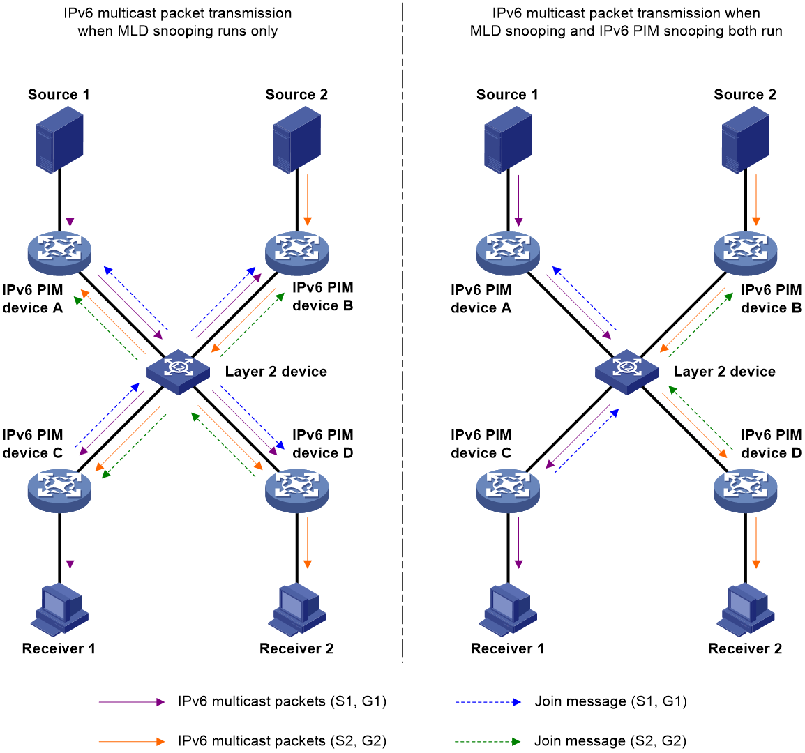

Figure 1 Multicast packet transmission without or with IPv6 PIM snooping
As shown in Figure 1, Source 1 sends multicast data to multicast group G1, and Source 2 sends multicast data to multicast group G2. Receiver 1 belongs to G1, and Receiver 2 belongs to G2. The Layer 2 switch's interfaces that connect to the IPv6 PIM-capable routers are in the same VLAN.
·     When the Layer 2 switch only runs MLD snooping, it performs the following actions:
a.     Maintains the router ports according to the received IPv6 PIM hello messages that IPv6 PIM-capable routers send.
b.     Floods all other types of received IPv6 PIM messages except PIM hello messages in the VLAN.
c.     Forwards all multicast data to all router ports in the VLAN.
Each IPv6 PIM-capable router in the VLAN, whether interested in the multicast data or not, can receive all multicast data and all IPv6 PIM messages except IPv6 PIM hello messages.
·     When the Layer 2 switch runs both MLD snooping and IPv6 PIM snooping, it performs the following actions:
a.     Examines whether an IPv6 PIM router is interested in the multicast data destined for a multicast group according to the received IPv6 PIM messages that the router sends.
b.     Adds only the ports that connect to the router and are interested in the data to an IPv6 PIM snooping routing entry.
c.     Forwards IPv6 PIM messages and the multicast data only to the router according to the multicast forwarding entry, which saves network bandwidth.

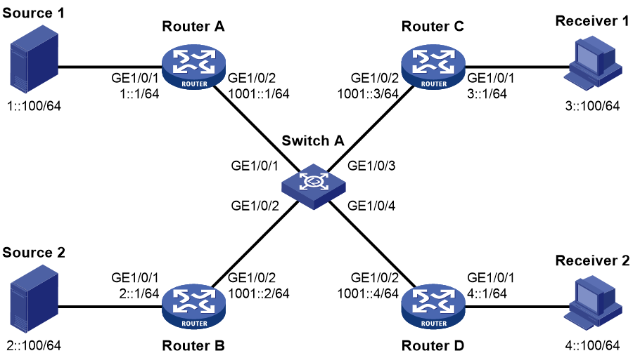

As shown in Figure 2:
·     OSPFv3 runs on the network.
·     Source 1 and Source 2 send IPv6 multicast data to IPv6 multicast groups FF1E::101 and FF2E::101, respectively.
·     Receiver 1 and Receiver 2 belong to IPv6 multicast groups FF1E::101 and FF2E::101, respectively.
·     Router C and Router D run MLD on GigabitEthernet 1/0/1.
·     Router A, Router B, Router C, and Router D run IPv6 PIM-SM. GigabitEthernet 1/0/2 on Router A acts as a C-BSR and a C-RP.
Configure MLD snooping and IPv6 PIM snooping on Switch A. Then, Switch A forwards IPv6 PIM protocol packets and IPv6 multicast data packets only to routers that are connected to receivers.
Figure 2 Network diagram
Assign an IPv6 address and prefix length to each interface as shown in Figure 2, and then configure OSPFv3 on the routers.
