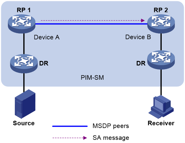

As shown in Figure 1, an MSDP peer can be created on any PIM-SM device. MSDP peers created on PIM-SM devices that assume different roles function differently.
·     MSDP peers created on RPs:
¡     Source-side MSDP peer—MSDP peer closest to the multicast source, such as RP 1. The source-side RP creates and sends SA messages to its remote MSDP peer to notify the MSDP peer of the locally registered multicast source information.
A source-side MSDP peer must be created on the source-side RP. Otherwise, it cannot advertise the multicast source information out of the PIM-SM domain.
¡     Receiver-side MSDP peer—MSDP peer closest to the receivers, typically the receiver-side RP, such as RP 3. After receiving an SA message, the receiver-side MSDP peer resolves the multicast source information carried in the message. Then, it joins the SPT rooted at the multicast source across the PIM-SM domains. When multicast data from the multicast source arrives, the receiver-side MSDP peer forwards the data to the receivers along the RPT.
¡     Intermediate MSDP peer—MSDP peer with multiple remote MSDP peers, such as RP 2. An intermediate MSDP peer forwards SA messages received from one remote MSDP peer to other remote MSDP peers. It acts as a relay for forwarding multicast source information.
·     MSDP peers created on PIM-SM devices that are not RPs:
Device A and Device B are MSDP peers on multicast devices that are not RPs. Such MSDP peers only forward SA messages.
In a PIM-SM network using the BSR mechanism, the RP is dynamically elected from C-RPs. A PIM-SM network typically has multiple C-RPs to ensure network robustness. Because the RP election result is unpredictable, MSDP peering relationships must be built between all C-RPs to always keep the winning C-RP on the MSDP interconnection map. Losing C-RPs assume the role of common PIM-SM devices on this map.

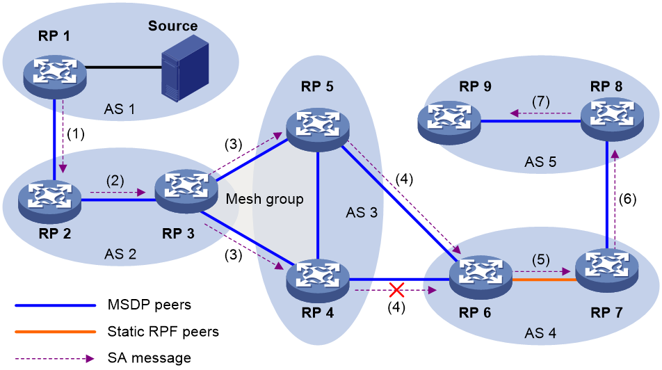

MSDP peer-RPF forwarding
The MSDP peer-RPF check is used for forwarding SA messages on a network that runs MSDP. If the peer-RPF check succeeds, the SA message is accepted and forwarded. Otherwise, the SA message is discarded.
As shown in Figure 3:
·     There are five ASs on the network. IGP runs within each AS, and BGP or MBGP runs between these ASs.
·     Each AS contains a minimum of one PIM-SM domain, and each PIM-SM domain contains a minimum of one RP.
·     MSDP peering relationship has been established among these RPs.
RP 3, RP 4, and RP 5 are in the same MSDP mesh group.
RP 6 is configured as the static RPF peer of RP 7.
Figure 3 MSDP peer-RPF forwarding
The process of peer-RPF forwarding is as follows:
1.     RP 1 creates an SA message and forwards it to its peer RP 2.
2.     RP 2 determines that RP 1 is the RP that creates the SA message because the RP address in the SA message is the same as that of RP 1. Then, RP 2 accepts and forwards the SA message.
3.     RP 3 accepts and forwards the SA message, because RP 2 and RP 3 reside in the same AS and RP 2 is the next hop of RP 3 to RP 1.
4.     RP 4 and RP 5 accept the SA message, because RP 3 is in the same mesh group with them. Then, RP 4 and RP 5 forward the SA message to their peer RP 6 rather than other members of the mesh group.
5.     RP 4 and RP 5 reside in the closest AS in the route to RP 1. However, RP 6 accepts and forwards only the SA message from RP 5, because the IP address of RP 5 is higher than that of RP 4.
6.     RP 7 accepts and forwards the SA message, because RP 6 is its static RPF peer.
7.     RP 8 accepts and forwards the SA message, because RP 7 is the EBGP or MBGP next hop of the peer-RPF route to RP 1.
8.     RP 9 accepts the SA message, because RP 8 is the only RP of RP 9.

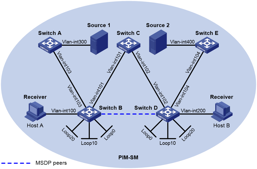

Anycast RP through MSDP
PIM-SM requires only one active RP to serve each multicast group. If the active RP fails, the multicast traffic might be interrupted. The Anycast RP mechanism enables redundancy backup between two or more RPs by configuring multiple RPs with the same IP address for one multicast group. A multicast source registers with the closest RP or a receiver joins the closest RP to implement source information synchronization.
For Anycast RP implemented through MSDP, all member RPs in the Anycast RP set have the same IP address, and MSDP peering connections are established between the RPs.
As shown in Figure 4, within a PIM-SM domain, a multicast source sends multicast data to multicast group G, and the receiver joins the multicast group. To implement Anycast RP through MSDP, complete the following tasks:
1.     Assign the same IP address (known as Anycast RP address, typically a private address) to an interface on Device A and Device B.
2.     Configure the interfaces as C-RPs.
3.     Establish an MSDP peering relationship between Device A and Device B.
Figure 4 Anycast RP through MSDP
The following describes how Anycast RP through MSDP is implemented:
1.     After receiving the multicast data from Source, the source-side DR registers with the closest RP (RP 1 in this example).
2.     After receiving the IGMP report message from the receiver, the receiver-side DR sends a join message toward the closest RP (RP 2 in this example). An RPT rooted at this RP is established.
3.     The RPs share the registered multicast source information through SA messages. After obtaining the multicast source information, RP 2 sends an (S, G) source-specific join message toward the source to create an SPT.
4.     When the multicast data reaches RP 2 along the SPT, the RP forwards the data along the RPT to the receiver. After receiving the multicast data, the receiver-side DR determines whether to initiate an RPT-to-SPT switchover process based on its configuration.

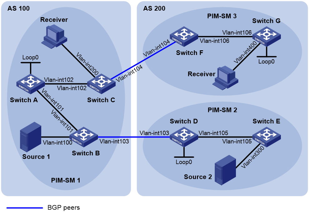

Example: Configuring PIM-SM inter-domain multicast
As shown in Figure 5:
·     OSPF runs within AS 100 and AS 200 and BGP runs between them.
·     Each PIM-SM domain has a minimum of one multicast source or receiver.
Set up MSDP peering relationships between the RPs in the PIM-SM domains to share multicast source information among the PIM-SM domains.
Figure 5 Network diagram

Configure inter-AS multicast as follows:
·     Configure Loopback 0 as the C-BSR and C-RP of the related PIM-SM domain on Switch A, Switch D and Switch G.
·     According to the peer-RPF forwarding rule, the switches accept SA messages that pass the filtering policy from its static RPF peers. To share multicast source information among PIM-SM domains without changing the unicast topology structure, configure MSDP peering relationships for the RPs of the PIM-SM domains and configure the static RPF peering relationships.
Figure 6 Network diagram
Device
Interface
IP address
Device
Interface
IP address
Source 1
192.168.1.100/24
Switch D
Vlan-int105
10.110.5.1/24
Source 2
192.168.3.100/24
Switch D
Vlan-int103
10.110.3.2/24
Switch A
Vlan-int101
10.110.1.1/24
Switch D
Loop0
2.2.2.2/32
Switch A
Vlan-int102
10.110.2.1/24
Switch E
Vlan-int105
10.110.5.2/24
Switch A
Loop0
1.1.1.1/32
Switch E
Vlan-int300
192.168.3.1/24
Switch B
Vlan-int101
10.110.1.2/24
Switch F
Vlan-int106
10.110.6.1/24
Switch B
Vlan-int100
192.168.1.1/24
Switch F
Vlan-int104
10.110.4.2/24
Switch B
Vlan-int103
10.110.3.1/24
Switch G
Vlan-int106
10.110.6.2/24
Switch C
Vlan-int102
10.110.2.2/24
Switch G
Vlan-int400
192.168.4.1/24
Switch C
Vlan-int200
192.168.2.1/24
Switch G
Loop0
3.3.3.3/32
Switch C
Vlan-int104
10.110.4.1/24
Assign an IP address and subnet mask to each interface as shown in Table 2, and configure OSPF on the switches in the ASs.
1.     Enable IP multicast routing, PIM-SM, and IGMP, and configure PIM-SM domain borders:
# On Switch C, enable IP multicast routing.
<SwitchC> system-view
[SwitchC] multicast routing
[SwitchC-mrib] quit
# Enable PIM-SM on each interface, and enable IGMP on the receiver-side interface (VLAN-interface 200).
[SwitchC] interface vlan-interface 102
[SwitchC-Vlan-interface102] pim sm
[SwitchC-Vlan-interface102] quit
[SwitchC] interface vlan-interface 200
[SwitchC-Vlan-interface200] igmp enable
[SwitchC-Vlan-interface200] quit
[SwitchC] interface vlan-interface 104
[SwitchC-Vlan-interface104] pim sm
[SwitchC-Vlan-interface104] quit
# Configure Switch A, Switch B, Switch D, Switch E, Switch F, and Switch G in the same way Switch C is configured. (Details not shown.)
# On Switch B, configure the PIM domain borders.
[SwitchB] interface vlan-interface 103
[SwitchB-Vlan-interface103] pim bsr-boundary
[SwitchB-Vlan-interface103] quit
# Configure the PIM domain borders on Switch C, Switch D, and Switch F in the same way Switch B is configured. (Details not shown.)
2.     Configure C-BSRs and C-RPs:
# On Switch A, configure Loopback 0 as a C-BSR and a C-RP.
[SwitchA] pim
[SwitchA-pim] c-bsr 1.1.1.1
[SwitchA-pim] c-rp 1.1.1.1
[SwitchA-pim] quit
# Configure C-BSRs and C-RPs on Switch D and Switch G in the same way Switch A is configured. (Details not shown.)
3.     Configure BGP, and redistribute BGP routing information into OSPF and OSPF routing information into BGP:
# On Switch B, configure an EBGP peer, and redistribute OSPF routing information.
[SwitchB] bgp 100
[SwitchB-bgp] router-id 1.1.1.2
[SwitchB-bgp] peer 10.110.3.2 as-number 200
[SwitchB-bgp] address-family ipv4 unicast
[SwitchB-bgp-ipv4] peer 10.110.3.2 enable
[SwitchB-bgp-ipv4] import-route ospf 1
[SwitchB-bgp-ipv4]quit
[SwitchB-bgp] quit
# On Switch D, configure an EBGP peer, and redistribute OSPF routing information.
[SwitchD] bgp 200
[SwitchD-bgp] router-id 2.2.2.2
[SwitchD-bgp] peer 10.110.3.1 as-number 100
[SwitchD-bgp] address-family ipv4 unicast
[SwitchD-bgp-ipv4] peer 10.110.3.1 enable
[SwitchD-bgp-ipv4] import-route ospf 1
[SwitchD-bgp-ipv4]quit
[SwitchD-bgp] quit
# On Switch C, configure an EBGP peer, and redistribute OSPF routing information.
[SwitchC] bgp 100
[SwitchC-bgp] router-id 1.1.1.3
[SwitchC-bgp] peer 10.110.4.2 as-number 200
[SwitchC-bgp] address-family ipv4 unicast
[SwitchC-bgp-ipv4] peer 10.110.4.2 enable
[SwitchC-bgp-ipv4] import-route ospf 1
[SwitchC-bgp-ipv4]quit
[SwitchC-bgp] quit
# On Switch F, configure an EBGP peer, and redistribute OSPF routing information.
[SwitchF] bgp 200
[SwitchF-bgp] router-id 3.3.3.1
[SwitchF-bgp] peer 10.110.4.1 as-number 100
[SwitchF-bgp] address-family ipv4 unicast
[SwitchF-bgp-ipv4] peer 10.110.4.1 enable
[SwitchF-bgp-ipv4] import-route ospf 1
[SwitchF-bgp-ipv4]quit
[SwitchF-bgp] quit
# On Switch B, redistribute BGP routing information into OSPF.
[SwitchB] ospf 1
[SwitchB-ospf-1] import-route bgp
[SwitchB-ospf-1] quit
# On Switch D, redistribute BGP routing information into OSPF.
[SwitchD] ospf 1
[SwitchD-ospf-1] import-route bgp
[SwitchD-ospf-1] quit
# On Switch C, redistribute BGP routing information into OSPF.
[SwitchC] ospf 1
[SwitchC-ospf-1] import-route bgp
[SwitchC-ospf-1] quit
# On Switch F, redistribute BGP routing information into OSPF.
[SwitchF] ospf 1
[SwitchF-ospf-1] import-route bgp
[SwitchF-ospf-1] quit
4.     Configure MSDP peers and static RPF peers:
# On Switch A, configure Switch D and Switch G as the MSDP peers and static RPF peers.
[SwitchA] ip prefix-list list-dg permit 10.110.0.0 16 greater-equal 16 less-equal 32
[SwitchA] msdp
[SwitchA-msdp] peer 10.110.3.2 connect-interface vlan-interface 101
[SwitchA-msdp] peer 10.110.6.2 connect-interface vlan-interface 102
[SwitchA-msdp] static-rpf-peer 10.110.3.2 rp-policy list-dg
[SwitchA-msdp] static-rpf-peer 10.110.6.2 rp-policy list-dg
[SwitchA-msdp] quit
# On Switch D, configure Switch A as the MSDP peer and static RPF peer.
[SwitchD] ip prefix-list list-a permit 10.110.0.0 16 greater-equal 16 less-equal 32
[SwitchD] msdp
[SwitchD-msdp] peer 10.110.1.1 connect-interface vlan-interface 103
[SwitchD-msdp] static-rpf-peer 10.110.1.1 rp-policy list-a
[SwitchD-msdp] quit
# On Switch G, configure Switch A as the MSDP peer and static RPF peer.
[SwitchG] ip prefix-list list-a permit 10.110.0.0 16 greater-equal 16 less-equal 32
[SwitchG] msdp
[SwitchG-msdp] peer 10.110.2.1 connect-interface vlan-interface 106
[SwitchG-msdp] static-rpf-peer 10.110.2.1 rp-policy list-a
[SwitchG-msdp] quit
# Display the BGP peering relationships on Switch A.
[SwitchA] display bgp peer
No information is output, because no BGP peering relationship has been established between Switch A and Switch D, or between Switch A and Switch G. This means that the unicast topology is not changed.
# Display brief information about MSDP peers on Switch A.
[SwitchA] display msdp brief
Configured   Established  Listen       Connect      Shutdown     Disabled
2            2            0            0            0            0
Peer address    State       Up/Down time    AS         SA count   Reset count
10.110.3.2      Established 01:07:08        ?          8          0
10.110.6.2      Established 00:16:39        ?          13         0
# Display brief information about MSDP peers on Switch D.
[SwitchD] display msdp brief
1            1            0            0            0            0
10.110.1.1      Established 01:07:09        ?          8          0
# Display brief information about MSDP peers on Switch G.
[SwitchG] display msdp brief
1            1            0            0            0            0
10.110.2.1      Established 00:16:40        ?          13         0
# Verify that receivers in PIM-SM 1 and PIM-SM 3 can receive the multicast data from Source 1 and Source 2 to a multicast group. (Details not shown.)
Example: Configuring Anycast RP
As shown in Figure 7, OSPF runs within the domain to provide unicast routes.
Configure the Anycast RP application so that the receiver-side DRs and the source-side DRs can initiate a join process to their respective RPs that are topologically closest to them.
Configure the router IDs of Switch B and Switch D as 1.1.1.1 and 2.2.2.2, respectively. Set up an MSDP peering relationship between Switch B and Switch D.
Figure 7 Network diagram
Table 3 Interface and IP address assignment
Device
Interface
IP address
Device
Interface
IP address
Source 1
10.110.5.100/24
Switch C
Vlan-int101
192.168.1.2/24
Source 2
10.110.6.100/24
Switch C
Vlan-int102
192.168.2.2/24
Switch A
Vlan-int300
10.110.5.1/24
Switch D
Vlan-int200
10.110.3.1/24
Switch A
Vlan-int103
10.110.2.2/24
Switch D
Vlan-int104
10.110.4.1/24
Switch B
Vlan-int100
10.110.1.1/24
Switch D
Vlan-int102
192.168.2.1/24
Switch B
Vlan-int103
10.110.2.1/24
Switch D
Loop0
2.2.2.2/32
Switch B
Vlan-int101
192.168.1.1/24
Switch D
Loop10
4.4.4.4/32
Switch B
Loop0
1.1.1.1/32
Switch D
Loop20
10.1.1.1/32
Switch B
Loop10
3.3.3.3/32
Switch E
Vlan-int400
10.110.6.1/24
Switch B
Loop20
10.1.1.1/32
Switch E
Vlan-int104
10.110.4.2/24
Assign an IP address and subnet mask to each interface as shown in Figure 7, and configure OSPF on the switches.
1.     Enable IP multicast routing, IGMP, and PIM-SM:
# On Switch B, enable IP multicast routing.
<SwitchB> system-view
[SwitchB] multicast routing
[SwitchB-mrib] quit
# Enable IGMP on the receiver-side interface (VLAN-interface 100).
[SwitchB-Vlan-interface100] igmp enable
# Enable PIM-SM on the other interfaces.
[SwitchB-Vlan-interface103] pim sm
[SwitchB] interface Vlan-interface 101
[SwitchB-Vlan-interface101] pim sm
[SwitchB-Vlan-interface101] quit
[SwitchB] interface loopback 0
[SwitchB-LoopBack0] pim sm
[SwitchB-LoopBack0] quit
[SwitchB] interface loopback 10
[SwitchB-LoopBack10] pim sm
[SwitchB-LoopBack10] quit
[SwitchB] interface loopback 20
[SwitchB-LoopBack20] pim sm
[SwitchB-LoopBack20] quit
# Enable IP multicast routing, IGMP, and PIM-SM on Switch A, Switch C, Switch D, and Switch E in the same way Switch B is configured. (Details not shown.)
# Configure Loopback 10 as a C-BSR and Loopback 20 as a C-RP on Switch B.
[SwitchB] pim
[SwitchB-pim] c-bsr 3.3.3.3
[SwitchB-pim] c-rp 10.1.1.1
[SwitchB-pim] quit
# Configure a C-BSR and a C-RP on Switch D in the same way Switch B is configured. (Details not shown.)
3.     Configure MSDP peers:
# Configure an MSDP peer on Loopback 0 of Switch B.
[SwitchB] msdp
[SwitchB-msdp] originating-rp loopback 0
[SwitchB-msdp] peer 2.2.2.2 connect-interface loopback 0
[SwitchB-msdp] quit
# Configure an MSDP peer on Loopback 0 of Switch D.
[SwitchD] msdp
[SwitchD-msdp] originating-rp loopback 0
[SwitchD-msdp] peer 1.1.1.1 connect-interface loopback 0
[SwitchD-msdp] quit
# Display brief information about MSDP peers on Switch B.
[SwitchB] display msdp brief
1            1            0            0            0            0
2.2.2.2         Established 00:10:57        ?          0          0
1            1            0            0            0            0
1.1.1.1         Established 00:10:57        ?          0          0
# Send an IGMP report from Host A to join multicast group 225.1.1.1. (Details not shown.)
# Send multicast data from Source 1 to multicast group 225.1.1.1. (Details not shown.)
# Display the PIM routing table on Switch D.
[SwitchD] display pim routing-table
No information is output on Switch D.
# Display the PIM routing table on Switch B.
[SwitchB] display pim routing-table
 Total 1 (*, G) entry; 1 (S, G) entry
 (*, 225.1.1.1)
     RP: 10.1.1.1 (local)
     Protocol: pim-sm, Flag: WC
     UpTime: 00:15:04
     Upstream interface: Register-Tunnel0
         Upstream neighbor: NULL
         RPF prime neighbor: NULL
     Downstream interface(s) information:
     Total number of downstream interfaces: 1
         1: Vlan-interface100
             Protocol: igmp, UpTime: 00:15:04, Expires: -
 (10.110.5.100, 225.1.1.1)
     Protocol: pim-sm, Flag: SPT 2MSDP ACT
     UpTime: 00:46:28
     Upstream interface: Vlan-interface103
         Upstream neighbor: 10.110.2.2
         RPF prime neighbor: 10.110.2.2
             Protocol: pim-sm, UpTime:  - , Expires:  -
The output shows that Switch B now acts as the RP for Source 1 and Host A.
# Send an IGMP leave message from Host A to leave multicast group 225.1.1.1. (Details not shown.),
# Send an IGMP report from Host B to join multicast group 225.1.1.1. (Details not shown.)
# Send multicast data from Source 2 to multicast group 225.1.1.1. (Details not shown.)
No information is output on Switch B.
 (*, 225.1.1.1)
     UpTime: 00:12:07
         1: Vlan-interface200
             Protocol: igmp, UpTime: 00:12:07, Expires: -
 (10.110.6.100, 225.1.1.1)
     UpTime: 00:40:22
     Upstream interface: Vlan-interface104
         Upstream neighbor: 10.110.4.2

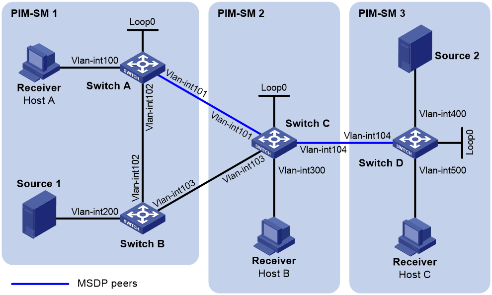

Example: Configuring SA message filtering
As shown in Figure 8:
·     OSPF runs within and among the PIM-SM domains to provide unicast routing.
·     Set up an MSDP peering relationship between Switch A and Switch C and between Switch C and Switch D.
·     Source 1 sends multicast data to multicast groups 225.1.1.0/30 and 226.1.1.0/30, and Source 2 sends multicast data to the multicast group 227.1.1.0/30.
Configure SA message policies so that:
·     Host A and Host B receive the multicast data only addressed to multicast groups 225.1.1.0/30 and 226.1.1.0/30.
·     Host C receives the multicast data only addressed to multicast groups 226.1.1.0/30 and 227.1.1.0/30.
Figure 8 Network diagram
Table 4 Interface and IP address assignment
Device
Interface
IP address
Device
Interface
IP address
Source 1
10.110.3.100/24
Switch C
Vlan-int300
10.110.4.1/24
Source 2
10.110.6.100/24
Switch C
Vlan-int104
10.110.5.1/24
Switch A
Vlan-int100
10.110.1.1/24
Switch C
Vlan-int101
192.168.1.2/24
Switch A
Vlan-int102
10.110.2.1/24
Switch C
Vlan-int103
192.168.2.2/24
Switch A
Vlan-int101
192.168.1.1/24
Switch C
Loop0
2.2.2.2/32
Switch A
Loop0
1.1.1.1/32
Switch D
Vlan-int400
10.110.6.1/24
Switch B
Vlan-int200
10.110.3.1/24
Switch D
Vlan-int500
10.110.7.1/24
Switch B
Vlan-int102
10.110.2.2/24
Switch D
Vlan-int104
10.110.5.2/24
Switch B
Vlan-int103
192.168.2.1/24
Switch D
Loop0
3.3.3.3/32
Assign an IP address and subnet mask to each interface as shown in Figure 8, and configure OSPF on the switches in the PIM-SM domains.
1.     Enable IP multicast routing, IGMP, and PIM-SM, and configure PIM domain borders:
# On Switch A, enable IP multicast routing.
<SwitchA> system-view
[SwitchA] multicast routing
[SwitchA-mrib] quit
[SwitchA-Vlan-interface100] igmp enable
[SwitchA] interface vlan-interface 101
[SwitchA-Vlan-interface101] pim sm
[SwitchA-Vlan-interface101] quit
[SwitchA] interface vlan-interface 102
[SwitchA-Vlan-interface102] pim sm
[SwitchA-Vlan-interface102] quit
[SwitchA] interface loopback 0
[SwitchA-LoopBack0] pim sm
[SwitchA-LoopBack0] quit
# Enable IP multicast routing, IGMP, and PIM-SM on Switch B, Switch C, and Switch D in the same way Switch A is configured. (Details not shown.)
# Configure a PIM domain border on Switch C.
[SwitchC] interface vlan-interface 101
[SwitchC-Vlan-interface101] pim bsr-boundary
[SwitchC-Vlan-interface101] quit
[SwitchC] interface vlan-interface 103
[SwitchC-Vlan-interface103] pim bsr-boundary
[SwitchC-Vlan-interface103] quit
[SwitchC-Vlan-interface104] pim bsr-boundary
# Configure PIM domain borders on Switch A, Switch B, and Switch D in the same way Switch C is configured. (Details not shown.)
# Configure Loopback 0 as a C-BSR and a C-RP on Switch A.
[SwitchA] pim
[SwitchA-pim] quit
# Configure C-BSRs and C-RPs on Switch C and Switch D in the same way Switch A is configured. (Details not shown.)
# Configure an MSDP peer on Switch A.
[SwitchA] msdp
[SwitchA-msdp] peer 192.168.1.2 connect-interface vlan-interface 101
[SwitchA-msdp] quit
# Configure MSDP peers on Switch C.
[SwitchC] msdp
[SwitchC-msdp] peer 192.168.1.1 connect-interface vlan-interface 101
[SwitchC-msdp] peer 10.110.5.2 connect-interface vlan-interface 104
[SwitchC-msdp] quit
# Configure an MSDP peer on Switch D.
[SwitchD] msdp
[SwitchD-msdp] peer 10.110.5.1 connect-interface vlan-interface 104
[SwitchD-msdp] quit
4.     Configure SA message policies:
# Configure an SA accepting and forwarding policy on Switch C so that Switch C will not forward SA messages for (Source 1, 225.1.1.0/30) to Switch D.
[SwitchC] acl advanced 3001
[SwitchC-acl-ipv4-adv-3001] rule deny ip source 10.110.3.100 0 destination 225.1.1.0 0.0.0.3
[SwitchC-acl-ipv4-adv-3001] rule permit ip source any destination any
[SwitchC-acl-ipv4-adv-3001] quit
[SwitchC] msdp
[SwitchC-msdp] peer 10.110.5.2 sa-policy export acl 3001
[SwitchC-msdp] quit
# Configure an SA creation policy on Switch D so that Switch D will not create SA messages for Source 2.
[SwitchD] acl basic 2001
[SwitchD-acl-ipv4-basic-2001] rule deny source 10.110.6.100 0
[SwitchD-acl-ipv4-basic-2001] quit
[SwitchD] msdp
[SwitchD-msdp] import-source acl 2001
[SwitchD-msdp] quit
# Display the (S, G) entries in the SA message cache on Switch C.
[SwitchC] display msdp sa-cache
 MSDP Total Source-Active Cache - 8 entries
 Matched 8 entries
Source        Group          Origin RP       Pro  AS     Uptime   Expires
10.110.3.100  225.1.1.0      1.1.1.1         ?    ?      02:03:30 00:05:31
10.110.3.100  225.1.1.1      1.1.1.1         ?    ?      02:03:30 00:05:31
10.110.3.100  225.1.1.2      1.1.1.1         ?    ?      02:03:30 00:05:31
10.110.3.100  225.1.1.3      1.1.1.1         ?    ?      02:03:30 00:05:31
10.110.3.100  226.1.1.0      1.1.1.1         ?    ?      02:03:30 00:05:31
10.110.3.100  226.1.1.1      1.1.1.1         ?    ?      02:03:30 00:05:31
10.110.3.100  226.1.1.2      1.1.1.1         ?    ?      02:03:30 00:05:31
10.110.3.100  226.1.1.3      1.1.1.1         ?    ?      02:03:30 00:05:31
# Display the (S, G) entries in the SA message cache on Switch D.
[SwitchD] display msdp sa-cache
 MSDP Total Source-Active Cache - 4 entries
 Matched  4 entries
10.110.3.100  226.1.1.0      1.1.1.1         ?    ?      00:32:53 00:05:07
10.110.3.100  226.1.1.1      1.1.1.1         ?    ?      00:32:53 00:05:07
10.110.3.100  226.1.1.2      1.1.1.1         ?    ?      00:32:53 00:05:07
10.110.3.100  226.1.1.3      1.1.1.1         ?    ?      00:32:53 00:05:07
