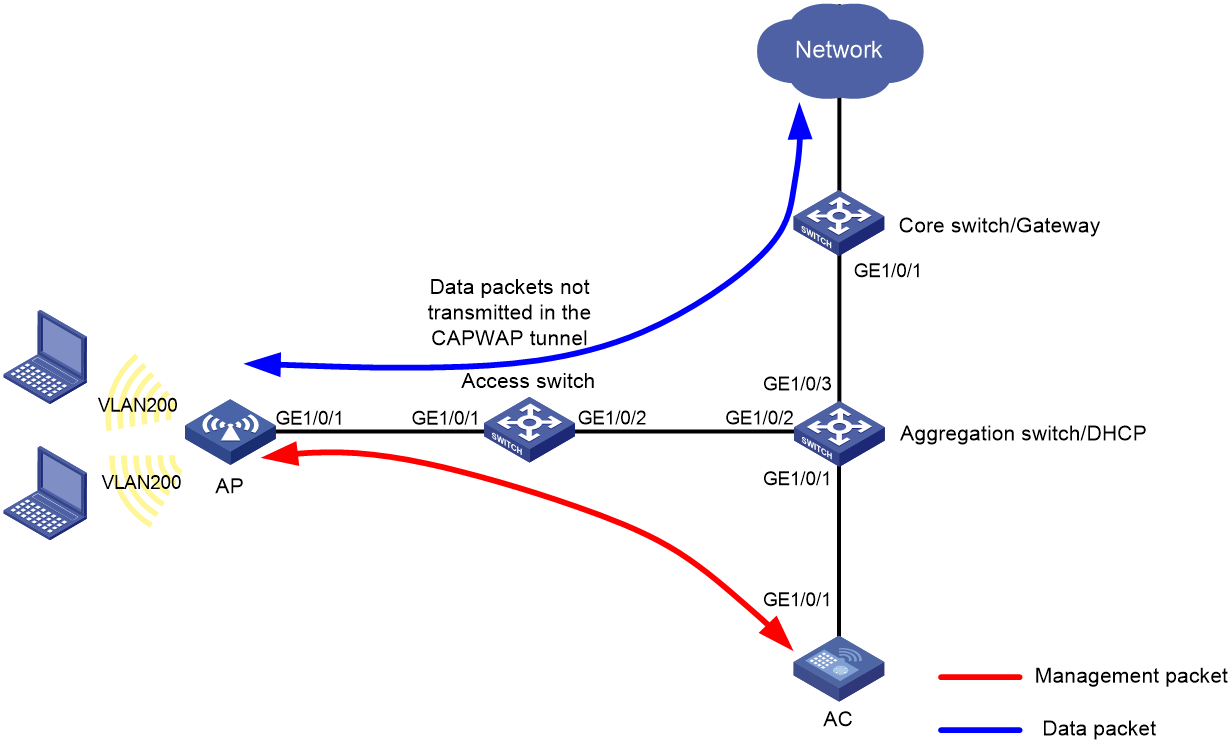

Configuring VLANs for one-arm AC WLAN deployment in centralized forwarding mode
Figure 1 shows a one-arm AC WLAN deployment in centralized forwarding mode.
In this scenario, you must perform the following tasks:
·     Create the management VLAN and service VLANs on the AC.
·     Configure the network devices between the AC and APs to allow packets from the management VLAN to pass through.
·     Configure the network devices between the AC and upper-layer network to allow packets from the service VLANs to pass through.
This example uses VLAN 100 as the management VLAN and uses VLAN 200 as a service VLAN.
Figure 1 Network diagram

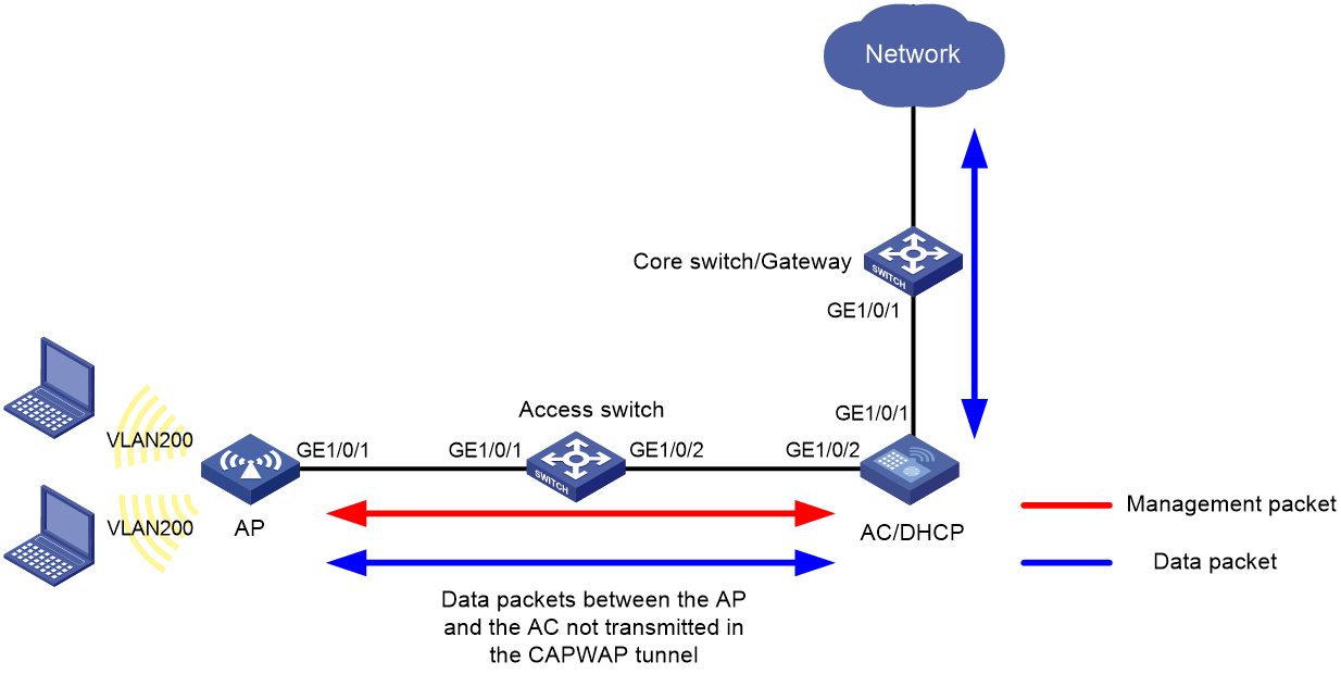

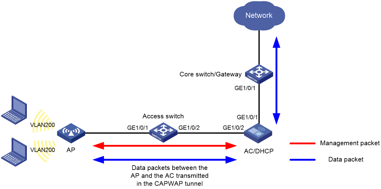

Configuring VLANs for inline-AC WLAN deployment in centralized forwarding mode
Figure 2 shows an inline-AC WLAN deployment in centralized forwarding mode.
Figure 2 Network diagram

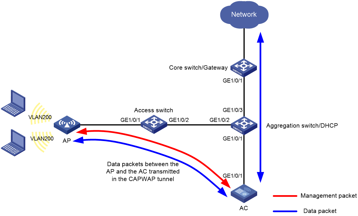

Configuring VLANs for one-arm AC WLAN deployment in local forwarding mode
Figure 3 shows a one-arm AC WLAN deployment in local forwarding mode.
In this scenario, perform the following tasks:
·     Configure the AP management VLAN on the AC.
·     Configure service VLANs on the AC if the AC must process service packets from WLAN clients, typically in either of the following situations:
¡     The gateway for the WLAN clients is placed on the AC.
¡     802.1X authentication is used. In this situation, authentication packets are CAPWAP tunneled. The AC must have the service VLANs.
If no service traffic traverses the AC, you do not need to configure service VLANs on the AC.
·     Configure the network devices between the APs and upper-layer network to allow packets from the service VLANs to pass through.
Figure 3 Network diagram

# Configure the service VLAN settings for APs in a .txt AP configuration file:
System-view
vlan 200
interface gigabitethernet1/0/1
port link-type trunk
port trunk permit vlan 200
# Store the file in the root directory of the storage medium on the AC. (Details not shown.)
2.     Configure the access switch:
# Create VLAN 100 (the VLAN for AP management).
<Access Switch> system-view
[Access Switch] vlan 100
[Access Switch-vlan100] quit
# Create VLAN 200 (the service VLAN for WLAN clients).
[Access Switch] vlan 200
[Access Switch-vlan200] quit
# Configure GigabitEthernet 1/0/1 (port towards the AP) as a trunk port, and remove it from VLAN 1.
[Access Switch] interface gigabitethernet 1/0/1
[Access Switch-GigabitEthernet1/0/1] port link-type trunk
[Access Switch-GigabitEthernet1/0/1] undo port trunk permit vlan 1
# Set the PVID of GigabitEthernet 1/0/1 to VLAN 100, and assign it to VLAN 100 and VLAN 200.
[Access Switch-GigabitEthernet1/0/1] port trunk pvid vlan 100
[Access Switch-GigabitEthernet1/0/1] port trunk permit vlan 100 200
[Access Switch-GigabitEthernet1/0/1] quit
# Configure GigabitEthernet 1/0/2 (port towards the aggregation switch) as a trunk port, remove it from VLAN 1, and assign it to VLAN 100 and VLAN 200.
[Access Switch] interface gigabitEthernet 1/0/2
[Access Switch-GigabitEthernet1/0/2] port link-type trunk
[Access Switch-GigabitEthernet1/0/2] undo port trunk permit vlan 1
[Access Switch-GigabitEthernet1/0/2] port trunk permit vlan 100 200
[Access Switch-GigabitEthernet1/0/2] quit
3.     Configure the aggregation switch:
<Aggregation Switch> system-view
[Aggregation Switch] vlan 100
[Aggregation Switch-vlan100] quit
[Aggregation Switch] vlan 200
[Aggregation Switch-vlan200] quit
# Configure GigabitEthernet 1/0/2 (port towards the access switch) as a trunk port, remove it from VLAN 1, and assign it to VLAN 100 and VLAN 200.
[Aggregation Switch] interface gigabitEthernet 1/0/2
[Aggregation Switch-GigabitEthernet1/0/2] port link-type trunk
[Aggregation Switch-GigabitEthernet1/0/2] undo port trunk permit vlan 1
[Aggregation Switch-GigabitEthernet1/0/2] port trunk permit vlan 100 200
[Aggregation Switch-GigabitEthernet1/0/2] quit
# Configure GigabitEthernet 1/0/1 (port towards the AC) as a trunk port, remove it from VLAN 1, and assign it to VLAN 100.
[Aggregation Switch] interface gigabitEthernet 1/0/1
[Aggregation Switch-GigabitEthernet1/0/1] port link-type trunk
[Aggregation Switch-GigabitEthernet1/0/1] undo port trunk permit vlan 1
[Aggregation Switch-GigabitEthernet1/0/1] port trunk permit vlan 100
[Aggregation Switch-GigabitEthernet1/0/1] quit
# Configure GigabitEthernet 1/0/3 (port towards the core switch) as a trunk port, remove it from VLAN 1, and assign it to VLAN 200.
[Aggregation Switch] interface gigabitEthernet 1/0/3
[Aggregation Switch-GigabitEthernet1/0/3] port link-type trunk
[Aggregation Switch-GigabitEthernet1/0/3] undo port trunk permit vlan 1
[Aggregation Switch-GigabitEthernet1/0/3] port trunk permit vlan 200
[Aggregation Switch-GigabitEthernet1/0/3] quit
4.     Configure the AC:
<AC> system-view
[AC] vlan 100
[AC-vlan100] quit
# Configure GigabitEthernet 1/0/1 (port towards the aggregation switch) as a trunk port, remove it from VLAN 1, and assign it to VLAN 100.
[AC] interface gigabitethernet 1/0/1
[AC-GigabitEthernet1/0/1] port link-type trunk
[AC-GigabitEthernet1/0/1] undo port trunk permit vlan 1
[AC-GigabitEthernet1/0/1] port trunk permit vlan 100
[AC-GigabitEthernet1/0/1] quit
5.     Configure the core switch:
<Core Switch> system-view
[Core Switch] vlan 200
[Core Switch-vlan200] quit
# Configure GigabitEthernet 1/0/1 (port towards the aggregation switch) as a trunk port, remove it from VLAN 1, and assign it to VLAN 200.
[Core Switch] interface gigabitEthernet 1/0/1
[Core Switch-GigabitEthernet1/0/1] port link-type trunk
[Core Switch-GigabitEthernet1/0/1] undo port trunk permit vlan 1
[Core Switch-GigabitEthernet1/0/1] port trunk permit vlan 200
[Core Switch-GigabitEthernet1/0/1] quit
Configuring VLANs for inline AC WLAN deployment in local forwarding mode
Figure 4 shows an inline-AC WLAN deployment in local forwarding mode.
Figure 4 Network diagram
1.     Configure the service VLAN settings for APs in an .txt AP configuration file:
# Configure the service VLAN settings for APs in an .txt AP configuration file:
System-view
vlan 200
# Configure GigabitEthernet 1/0/2 (port towards the AC) as a trunk port, remove it from VLAN 1, and assign it to VLAN 100 and VLAN 200.
3.     Configure the AC:
<AC> system-view
[AC] vlan 100
[AC-vlan100] quit
[AC] vlan 200
[AC-vlan200] quit
[AC] interface gigabitethernet 1/0/2
[AC-GigabitEthernet1/0/2] port link-type trunk
[AC-GigabitEthernet1/0/2] undo port trunk permit vlan 1
[AC-GigabitEthernet1/0/2] port trunk permit vlan 100 200
[AC-GigabitEthernet1/0/2] quit
# Configure GigabitEthernet 1/0/1 (port towards the core switch) as a trunk port, remove it from VLAN 1, and assign it to VLAN 200.
[AC-GigabitEthernet1/0/1] port trunk permit vlan 200
4.     Configure the core switch:
# Configure GigabitEthernet 1/0/1 (port towards the AC) as a trunk port, remove it from VLAN 1, and assign it to VLAN 200.
