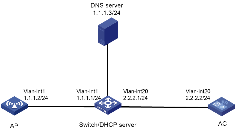

As shown in Figure 1, the switch acts as a DHCP server to assign the AC's domain name and AP's IP address to the AP. Configure the AP to obtain the AC's IP address from the DNS server.
Figure 1 Network diagram

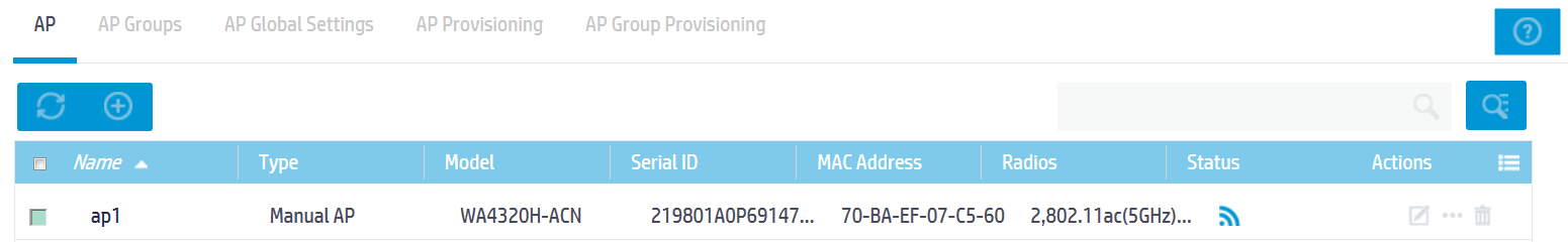

1.     Click the Network View tab at the bottom of the page.
2.     From the navigation pane, select Wireless Configuration > AP Management.
a.     Click the Add button  to create an AP and specify its name as ap1.
b.     Specify the AP model and serial ID.
Figure 2 Configuring an AP
3.     On the AP tab, verify that the AP has come online.
Figure 4 Verifying AP configuration

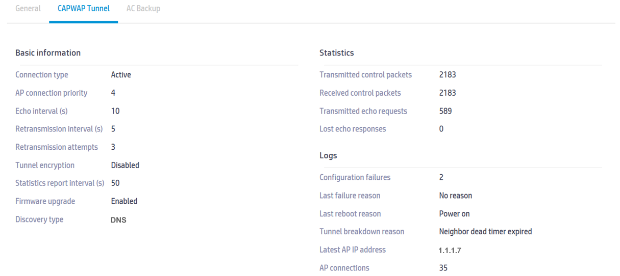

4.     Click the Details button .
5.     On the CAPWAP Tunnel tab, verify that the AP uses DNS to discovery the AC.
Figure 5 Verifying the AC discovery method
