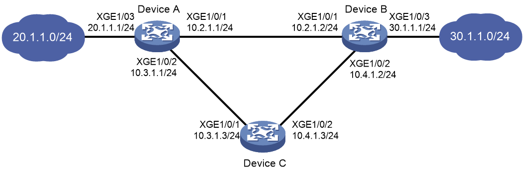

Collaboration application example
The following is an example of collaboration between NQA, Track, and static routing.
Configure a static route with next hop 192.168.0.88 on the device. If the next hop is reachable, the static route is valid. If the next hop becomes unreachable, the static route is invalid. For this purpose, configure NQA-Track-static routing collaboration as follows:
1.     Create an NQA operation to monitor the accessibility of IP address 192.168.0.88.
2.     Create a track entry and associate it with the NQA operation.
¡     When next hop 192.168.0.88 is reachable, NQA sends the result to the Track module. The Track module sets the track entry to Positive state.
¡     When the next hop becomes unreachable, NQA sends the result to the Track module. The Track module sets the track entry to Negative state.
3.     Associate the track entry with the static route.
¡     When the track entry is in Positive state, the static routing module considers the static route to be valid.
¡     When the track entry is in Negative state, the static routing module considers the static route to be invalid.

Associating Track with static routing
A static route is a manually configured route to route packets. For more information about static route configuration, see Layer 3—IP Routing Configuration Guide.
Static routes cannot adapt to network topology changes. Link failures or network topological changes can make the routes unreachable and cause communication interruption.
To resolve this problem, configure another route to back up the static route. When the static route is reachable, packets are forwarded through the static route. When the static route is unreachable, packets are forwarded through the backup route.
To check the accessibility of a static route in real time, associate the Track module with the static route.
If you specify the next hop but not the output interface when configuring a static route, you can configure the static routing-Track-detection module collaboration. This collaboration enables you to verify the accessibility of the static route based on the track entry state.
·     If the track entry is in Positive state, the following conditions exist:
¡     The next hop of the static route is reachable.
¡     The configured static route is valid.
·     If the track entry is in Negative state, the following conditions exist:
¡     The next hop of the static route is not reachable.
¡     The configured static route is invalid.
·     If the track entry is in NotReady state, the following conditions exist:
¡     The accessibility of the next hop of the static route is unknown.
¡     The static route is valid.
In static routing-Track-NQA collaboration, you must configure the same VPN instance name for the NQA operation and the next hop of the static route. Otherwise, the accessibility detection cannot operate correctly.
If a static route needs route recursion, the associated track entry must monitor the next hop of the recursive route. The next hop of the static route cannot be monitored. Otherwise, a valid route might be considered invalid.

Example: Configuring VRRP-Track-NQA collaboration
As shown in Figure 2:
·     Host A requires access to Host B. The default gateway of Host A is 10.1.1.10/24.
·     Switch A and Switch B belong to VRRP group 1. The virtual IP address of VRRP group 1 is 10.1.1.10.
Configure VRRP-Track-NQA collaboration to monitor the uplink on the master and meet the following requirements:
·     When Switch A operates correctly, Switch A forwards packets from Host A to Host B.
·     When NQA detects a fault on the uplink of Switch A, Switch B forwards packets from Host A to Host B.
Figure 2 Network diagram
1.     Create VLANs and assign ports to them. Configure the IP address of each VLAN interface, as shown in Figure 2. (Details not shown.)

The output shows that in VRRP group 1, Switch A is the master, and Switch B is a backup. Switch A forwards packets from Host A to Host B.
# Disconnect the link between Switch A and Switch C, and verify that Host A can still ping Host B. (Details not shown.)

The output shows that Switch A becomes the backup, and Switch B becomes the master. Switch B forwards packets from Host A to Host B.

Example: Configuring a control-mode BFD session for a VRRP backup to monitor the master
As shown in Figure 4:
·     Switch A and Switch B belong to VRRP group 1. The virtual IP address of VRRP group 1 is 192.168.0.10.
·     The default gateway of the hosts in the LAN is 192.168.0.10.
Configure VRRP-Track-BFD (control mode) collaboration to monitor the master on the backup and meet the following requirements:
·     When Switch A operates correctly, the hosts in the LAN access the Internet through Switch A.
·     When Switch A fails, the backup (Switch B) can detect the state change of the master through the control-mode BFD session and become the new master. The hosts in the LAN access the Internet through Switch B.
Figure 4 Network diagram
1.     Create VLANs and assign ports to them. Configure the IP address of each VLAN interface, as shown in Figure 4. (Details not shown.)
2.     Configure Switch A:
# Create VRRP group 1, and configure virtual IP address 192.168.0.10 for the group.
<SwitchA> system-view

Example: Configuring static routing-Track-NQA collaboration
As shown in Figure 7:
·     Switch A is the default gateway of the hosts in network 20.1.1.0/24.
·     Switch D is the default gateway of the hosts in network 30.1.1.0/24.
·     Hosts in the two networks communicate with each other through static routes.
To ensure network availability, configure route backup and static routing-Track-NQA collaboration on Switch A and Switch D as follows:
·     On Switch A, assign a higher priority to the static route to 30.1.1.0/24 with next hop Switch B. This route is the master route. The static route to 30.1.1.0/24 with next hop Switch C acts as the backup route. When the master route is unavailable, the backup route takes effect. Switch A forwards packets to 30.1.1.0/24 through Switch C.
·     On Switch D, assign a higher priority to the static route to 20.1.1.0/24 with next hop Switch B. This route is the master route. The static route to 20.1.1.0/24 with next hop Switch C acts as the backup route. When the master route is unavailable, the backup route takes effect. Switch D forwards packets to 20.1.1.0/24 through Switch C.
Figure 7 Network diagram

# Display information about the track entry on Switch A.
[SwitchA] display track all
Track ID: 1
  State: Positive
  Duration: 0 days 0 hours 0 minutes 32 seconds
  Tracked object type: NQA
  Notification delay: Positive 0, Negative 0 (in seconds)
  Tracked object:
    NQA entry: admin test
    Reaction: 1
    Remote IP/URL: 10.2.1.4
    Local IP:--
    Interface:--
The output shows that the status of the track entry is Positive, indicating that the NQA operation has succeeded and the master route is available.
# Display the routing table of Switch A.
[SwitchA] display ip routing-table
Destinations : 10       Routes : 10
10.1.1.0/24         Direct 0    0            10.1.1.1        Vlan2
10.1.1.1/32         Direct 0    0            127.0.0.1       InLoop0
10.2.1.0/24         Static 60   0            10.1.1.2        Vlan2
10.3.1.0/24         Direct 0    0            10.3.1.1        Vlan3
10.3.1.1/32         Direct 0    0            127.0.0.1       InLoop0
20.1.1.0/24         Direct 0    0            20.1.1.1        Vlan6
20.1.1.1/32         Direct 0    0            127.0.0.1       InLoop0
30.1.1.0/24         Static 60   0            10.1.1.2        Vlan2
127.0.0.0/8         Direct 0    0            127.0.0.1       InLoop0
127.0.0.1/32        Direct 0    0            127.0.0.1       InLoop0
The output shows that Switch A forwards packets to 30.1.1.0/24 through Switch B.
# Remove the IP address of interface VLAN-interface 2 on Switch B.
<SwitchB> system-view
[SwitchB-Vlan-interface2] undo ip address
Track ID: 1
  State: Negative
  Tracked object:
    Reaction: 1
    Local IP:--
    Interface:--
The output shows that the status of the track entry is Negative, indicating that the NQA operation has failed and the master route is unavailable.
30.1.1.0/24         Static 80   0            10.3.1.3        Vlan3

Example: Configuring static routing-Track-BFD (echo mode) collaboration
As shown in Figure 8:
·     Switch B is the default gateway of the hosts in network 30.1.1.0/24.
To ensure network availability, configure route backup and static routing-Track-BFD (echo mode) collaboration on Switch A and Switch B as follows:
·     On Switch A, assign a higher priority to the static route to 30.1.1.0/24 with next hop Switch B. This route is the master route. The static route to 30.1.1.0/24 with next hop Switch C acts as the backup route. When the master route is unavailable, the echo-mode BFD session can quickly detect the route failure to make the backup route take effect.
·     On Switch B, assign a higher priority to the static route to 20.1.1.0/24 with next hop Switch A. This route is the master route. The static route to 20.1.1.0/24 with next hop Switch C acts as the backup route. When the master route is unavailable, the echo-mode BFD session can quickly detect the route failure to make the backup route take effect.
Figure 8 Network diagram
1.     Create VLANs and assign ports to them. Configure the IP address of each VLAN interface, as shown in Figure 8. (Details not shown.)
# Configure a static route to 30.1.1.0/24 with next hop 10.2.1.2 and the default priority (60). Associate this static route with track entry 1.
[SwitchA] ip route-static 30.1.1.0 24 10.2.1.2 track 1
# Configure a static route to 30.1.1.0/24 with next hop 10.3.1.3 and priority 80.
[SwitchA] ip route-static 30.1.1.0 24 10.3.1.3 preference 80
# Specify 10.10.10.10 as the source address of BFD echo packets.
[SwitchA] bfd echo-source-ip 10.10.10.10
# Configure track entry 1, and associate it with the echo-mode BFD session to verify the connectivity between Switch A and Switch B.
[SwitchA] track 1 bfd echo interface vlan-interface 2 remote ip 10.2.1.2 local ip 10.2.1.1
[SwitchA-track-1] quit
3.     Configure Switch B:
# Configure a static route to 20.1.1.0/24 with next hop 10.2.1.1 and the default priority (60). Associate this static route with track entry 1.
[SwitchB] ip route-static 20.1.1.0 24 10.2.1.1 track 1
# Configure a static route to 20.1.1.0/24 with next hop 10.4.1.3 and priority 80.
[SwitchB] ip route-static 20.1.1.0 24 10.4.1.3 preference 80
# Specify 1.1.1.1 as the source address of BFD echo packets.
[SwitchB] bfd echo-source-ip 1.1.1.1
# Configure track entry 1, and associate it with the echo-mode BFD session to verify the connectivity between Switch B and Switch A.
[SwitchB] track 1 bfd echo interface vlan-interface 2 remote ip 10.2.1.1 local ip 10.2.1.2
[SwitchB-track-1] quit
4.     Configure Switch C:
# Configure a static route to 30.1.1.0/24 with next hop 10.4.1.2.
<SwitchC> system-view
[SwitchC] ip route-static 30.1.1.0 24 10.4.1.2
# Configure a static route to 20.1.1.0/24 with next hop 10.3.1.1.
[SwitchC] ip route-static 20.1.1.0 24 10.3.1.1
Track ID: 1
  State: Positive
  Tracked object type: BFD echo
  Tracked object:
    BFD session mode: Echo
    Outgoing interface: Vlan-interface2
    Remote IP: 10.2.1.2
    Local IP: 10.2.1.1
The output shows that the status of the track entry is Positive, indicating that next hop 10.2.1.2 is reachable.
Destinations : 9        Routes : 9
Destination/Mask    Proto  Pre  Cost         NextHop         Interface
10.2.1.0/24         Direct 0    0            10.2.1.1        Vlan2
10.2.1.1/32         Direct 0    0            127.0.0.1       InLoop0
20.1.1.0/24         Direct 0    0            20.1.1.1        Vlan5
30.1.1.0/24         Static 60   0            10.2.1.2        Vlan2
The output shows that Switch A forwards packets to 30.1.1.0/24 through Switch B. The master static route has taken effect.

Example: Configuring static routing-Track-BFD (control mode) collaboration
As shown in Figure 9:
To ensure network availability, configure route backup and static routing-Track-BFD (control mode) collaboration on Switch A and Switch B as follows:
·     On Switch A, assign a higher priority to the static route to 30.1.1.0/24 with next hop Switch B. This route is the master route. The static route to 30.1.1.0/24 with next hop Switch C acts as the backup route. When the master route is unavailable, the control-mode BFD session can quickly detect the route failure to make the backup route take effect.
·     On Switch B, assign a higher priority to the static route to 20.1.1.0/24 with next hop Switch A. This route is the master route. The static route to 20.1.1.0/24 with next hop Switch C acts as the backup route. When the master route is unavailable, the control-mode BFD session can quickly detect the route failure to make the backup route take effect.
Figure 9 Network diagram
1.     Create VLANs and assign ports to them. Configure the IP address of each VLAN interface, as shown in Figure 9. (Details not shown.)
# Configure track entry 1, and associate it with the control-mode BFD session to verify the connectivity between Switch A and Switch B.
[SwitchA] track 1 bfd ctrl interface vlan-interface 2 remote ip 10.2.1.2 local ip 10.2.1.1
# Configure track entry 1, and associate it with the control-mode BFD session to verify the connectivity between Switch B and Switch A.
[SwitchB] track 1 bfd ctrl interface vlan-interface 2 remote ip 10.2.1.1 local ip 10.2.1.2
Track ID: 1
  State: Positive
  Tracked object type: BFD ctrl
  Tracked object:
    BFD session mode: Ctrl
    VPN instance name: --
    Remote IP: 10.2.1.2
    Local IP: 10.2.1.1

Example: Configuring static routing-Track-LLDP collaboration
Network requirements
As shown in Figure 12:
·     Device A is the default gateway of the hosts in network 20.1.1.0/24.
·     Device B is the default gateway of the hosts in network 30.1.1.0/24.
To ensure network availability, configure route backup and static routing-Track-LLDP collaboration on Device A and Device B as follows:
·     On Device A, assign a higher priority to the static route to 30.1.1.0/24 with next hop Device B. This route is the master route. The static route to 30.1.1.0/24 with next hop Device C acts as the backup route. When the master route is unavailable, the backup route takes effect. Device A forwards packets destined for 30.1.1.0/24 to Device C.
·     On Device B, assign a higher priority to the static route to 20.1.1.0/24 with next hop Device A. This route is the master route. The static route to 20.1.1.0/24 with next hop Device C acts as the backup route. When the master route is unavailable, the backup route takes effect. Device B forwards packets destined for 20.1.1.0/24 to Device C.
Figure 12 Network diagram
1.     Configure the IP address of each interface, as shown in Figure 12. (Details not shown.)
2.     Configure Device A:
# Configure a static route to 30.1.1.0/24 with next hop 10.1.1.2 and the default priority (60). Associate this static route with track entry 1.
<DeviceA> system-view
[DeviceA] ip route-static 30.1.1.0 24 10.2.1.2 track 1
[DeviceA] ip route-static 30.1.1.0 24 10.3.1.3 preference 80
# Enable LLDP globally.
[DeviceA] lldp global enable
# Enable LLDP on Ten-GigabitEthernet 1/0/1. (This step is optional because LLDP is enabled on the port by default.)
[DeviceA] interface ten-gigabitethernet 1/0/1
[DeviceA-Ten-GigabitEthernet1/0/1] lldp enable
# Configure track entry 1 and associate it with the availability of the neighbor for LLDP interface Gigabitethernet 1/0/1.
[DeviceA] track 1 lldp neighbor interface ten-gigabitethernet 1/0/1
[DeviceA-track-1] quit
3.     Configure Device B:
<DeviceB> system-view
[DeviceB] ip route-static 20.1.1.0 24 10.2.1.1 track 1
[DeviceB] ip route-static 20.1.1.0 24 10.4.1.3 preference 80
[DeviceB] lldp global enable
[DeviceB] interface ten-gigabitethernet 1/0/1
[DeviceB-Ten-GigabitEthernet1/0/1] lldp enable
# Configure track entry 1 and associate it with the availability of the neighbor for LLDP interface Ten-GigabitEthernet 1/0/1.
[DeviceB] track 1 lldp neighbor interface ten-gigabitethernet 1/0/1
[DeviceB-track-1] quit
4.     Configure Device C:
<DeviceC> system-view
[DeviceC] ip route-static 30.1.1.0 24 10.4.1.2
[DeviceC] ip route-static 20.1.1.0 24 10.3.1.1
# Display track entry information on Device A.
[DeviceA] display track all
Track ID: 1
  State: Positive
  Tracked object type: LLDP
  Tracked object:
    LLDP interface: Ten-GigabitEthernet1/0/1
The output shows that the status of track entry 1 is Positive, indicating that the neighbor of LLDP interface Ten-GigabitEthernet 1/0/1 is available. The master route takes effect.
# Display the routing table of Device A.
[DeviceA] display ip routing-table
10.2.1.0/24         Direct 0    0            10.2.1.1        XGE1/0/1
10.3.1.0/24         Direct 0    0            10.3.1.1        XGE1/0/2
20.1.1.0/24         Direct 0    0            20.1.1.1        XGE1/0/3
30.1.1.0/24         Static 60   0            10.2.1.2        XGE1/0/1
The output shows that Device A forwards packets to 30.1.1.0/24 through Device B.
# On Device B, disable LLDP on Ten-GigabitEthernet 1/0/1.
[DeviceB-Ten-GigabitEthernet1/0/1] undo lldp enable
Track ID: 1
  State: Negative
  Tracked object:
The output shows that the status of track entry 1 is Negative, indicating that the neighbor of LLDP interface Ten-GigabitEthernet 1/0/1 is unavailable. The master route fails.
30.1.1.0/24         Static 80   0            10.3.1.3        XGE1/0/2
The output shows that Device A forwards packets destined for 30.1.1.0/24 to Device C. The backup static route has taken effect.
# Verify that hosts in 20.1.1.0/24 can communicate with the hosts in 30.1.1.0/24 when the master route fails.
[DeviceA] ping -a 20.1.1.1 30.1.1.1
Ping 30.1.1.1: 56  data bytes, press CTRL_C to break
Reply from 30.1.1.1: bytes=56 Sequence=1 ttl=254 time=2 ms
Reply from 30.1.1.1: bytes=56 Sequence=2 ttl=254 time=1 ms
Reply from 30.1.1.1: bytes=56 Sequence=3 ttl=254 time=1 ms
Reply from 30.1.1.1: bytes=56 Sequence=4 ttl=254 time=2 ms
Reply from 30.1.1.1: bytes=56 Sequence=5 ttl=254 time=1 ms
--- Ping statistics for 30.1.1.1 ---
5 packet(s) transmitted, 5 packet(s) received, 0.00% packet loss
round-trip min/avg/max/std-dev = 1/1/2/1 ms
# Verify that the hosts in 30.1.1.0/24 can communicate with the hosts in 20.1.1.0/24 when the master route fails.
[DeviceB] ping -a 30.1.1.1 20.1.1.1
Ping 20.1.1.1: 56  data bytes, press CTRL_C to break
Reply from 20.1.1.1: bytes=56 Sequence=1 ttl=254 time=2 ms
Reply from 20.1.1.1: bytes=56 Sequence=2 ttl=254 time=1 ms
Reply from 20.1.1.1: bytes=56 Sequence=3 ttl=254 time=1 ms
Reply from 20.1.1.1: bytes=56 Sequence=4 ttl=254 time=1 ms
Reply from 20.1.1.1: bytes=56 Sequence=5 ttl=254 time=1 ms
--- Ping statistics for 20.1.1.1 ---
Example: Configuring Smart Link-Track-CFD collaboration
For information about the Smart Link-Track-CFD collaboration configuration example, see "Configuring Smart Link."
