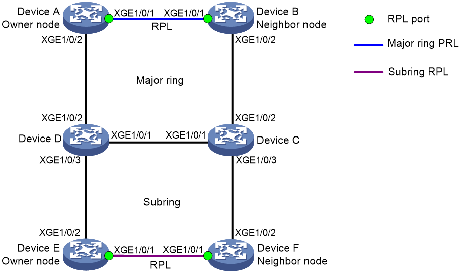

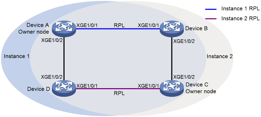

Multi-instance load balancing mechanism
Figure 4 Multi-instance load balancing mechanism
An ERPS ring topology might carry traffic from multiple VLANs. Traffic from different VLANs can be load balanced among different ERPS instances.
ERPS uses the following types of VLANs:
·     Control VLAN—Carries ERPS protocol packets. Each ERPS instance has its own control VLAN.
·     Protected VLAN—Carries data packets. Each ERPS instance has its own protected VLAN. Protected VLANs are configured by using the mappings between VLANs and MSTIs.
As shown in Figure 4, the ERPS ring is configured with instance 1 and instance 2. For instance 1, the owner node is Device A, and the RPL is the link between Device A and Device B. For instance 2, the owner node is Device C, and the RPL is the link between Device C and Device D. Traffic from different VLANs can be load balanced among different links.

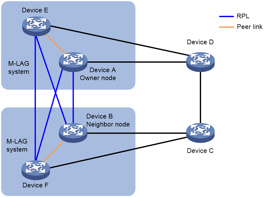

ERPS with M-LAG
M-LAG allows you to virtualize the devices in an ERPS ring into one system through multichassis link, thereby achieving device-level redundancy and load balancing.
You can use the display erps detail ring command to determine whether ERPS works correctly in an M-LAG network. For more information about M-LAG, see Layer 2—LAN Switching Configuration Guide.
Figure 11 ERPS with M-LAG

Example: Configuring one subring
As shown in Figure 13, perform the following tasks to eliminate loops on the network:
·     Configure VLAN 100 and VLAN 110 as the control VLANs for the major ring and the subring, respectively.
·     Configure VLANs 1 to 30 as the protected VLANs for the major ring and subring.
·     Configure Device A as the owner node for the major ring, Ten-GigabitEthernet 1/0/1 as ERPS ring member port 0 and the RPL port, and Ten-GigabitEthernet 1/0/2 as ERPS ring member port 1.
·     Configure Device B as the neighbor node for the major ring, Ten-GigabitEthernet 1/0/1 as ERPS ring member port 0 and the RPL port, and Ten-GigabitEthernet 1/0/2 as ERPS ring member port 1.
·     Configure Devices C and D as interconnection nodes, Ten-GigabitEthernet 1/0/1 as ERPS ring member port 0, Ten-GigabitEthernet 1/0/2 as ERPS ring member port 1, and GigabitEthernet 1/0/3 as the interconnection port.
·     Configure Device E as the owner node for the subring, Ten-GigabitEthernet 1/0/1 as ERPS ring member port 0 and the RPL port, and Ten-GigabitEthernet 1/0/2 as ERPS ring member port 1.
·     Configure Device F as the neighbor node for the subring, Ten-GigabitEthernet 1/0/1 as ERPS ring member port 0 and the RPL port, and Ten-GigabitEthernet 1/0/2 as ERPS ring member port 1.
Figure 13 Network diagram

Example: Configuring one-ring multi-instance load balancing
As shown in Figure 14, perform the following tasks to improve network resource utilization and implement load balancing among links:
·     Configure ERPS instances 1 and 2 on the ERPS ring.
·     For ERPS instance 1, configure the following items:
¡     Configure Device A as the owner node.
¡     Configure the link between Devices A and Device B as the RPL.
¡     Configure VLAN 100 as the control VLAN.
¡     Configure VLANs 1 to 30 as the protected VLANs.
·     For ERPS instance 2, configure the following items:
¡     Configure the link between Devices C and Device D as the RPL.
¡     Configure VLANs 31 to 60 as the protected VLANs.
Figure 14 Network diagram

[DeviceB] interface ten-gigabitethernet 1/0/2
[DeviceB-Ten-GigabitEthernet1/0/2] cfd mep 3002 service-instance 3 outbound
[DeviceB-Ten-GigabitEthernet1/0/2] cfd cc service-instance 3 mep 3002 enable
[DeviceB-Ten-GigabitEthernet1/0/2] quit
# Create track entry 1 and associate it with the CC function of CFD for MEP 1002 in service instance 1.
[DeviceB] track 1 cfd cc service-instance 1 mep 1002
# Associate Ten-GigabitEthernet 1/0/1 with track entry 1 and bring up the port for ERPS instances 1 and 2.
[DeviceB] interface ten-gigabitethernet 1/0/1
[DeviceB-Ten-GigabitEthernet1/0/1] port erps ring 1 instance 1 track 1
[DeviceB-Ten-GigabitEthernet1/0/1] port erps ring 1 instance 2 track 1
[DeviceB-Ten-GigabitEthernet1/0/1] undo shutdown
[DeviceB-Ten-GigabitEthernet1/0/1] quit
# Create track entry 2 and associate it with the CC function of CFD for MEP 3002 in service instance 3.
[DeviceB] track 2 cfd cc service-instance 3 mep 3002
# Associate Ten-GigabitEthernet 1/0/2 with track entry 2 and bring up the port for ERPS instances 1 and 2.
[DeviceB-Ten-GigabitEthernet1/0/2] port erps ring 1 instance 1 track 2
[DeviceB-Ten-GigabitEthernet1/0/2] port erps ring 1 instance 2 track 2
[DeviceB-Ten-GigabitEthernet1/0/2] undo shutdown
# Enable ERPS.
[DeviceB] erps enable
3.     Configure Device C.
# Create VLANs 1 to 60, map VLANs 1 to 30 to MSTI 1, map VLANs 31 to 60 to MSTI 2, and activate the MST region configuration.
<DeviceC> system-view
[DeviceC] vlan 1 to 60
[DeviceC] stp region-configuration
[DeviceC-mst-region] instance 1 vlan 1 to 30
[DeviceC-mst-region] instance 2 vlan 31 to 60
[DeviceC-mst-region] active region-configuration
[DeviceC-mst-region] quit
# Set the link state change suppression interval to 0 seconds on Ten-GigabitEthernet 1/0/1.
[DeviceC] interface ten-gigabitethernet 1/0/1
[DeviceC-Ten-GigabitEthernet1/0/1] link-delay up 0
[DeviceC-Ten-GigabitEthernet1/0/1] link-delay down 0
# Disable the spanning tree feature on the port.
[DeviceC-Ten-GigabitEthernet1/0/1] undo stp enable
# Configure the port as a trunk port and assign it to VLANs 1 to 60.
[DeviceC-Ten-GigabitEthernet1/0/1] port link-type trunk
[DeviceC-Ten-GigabitEthernet1/0/1] port trunk permit vlan 1 to 60
[DeviceC-Ten-GigabitEthernet1/0/1] quit
# Configure Ten-GigabitEthernet 1/0/2 in the same way Ten-GigabitEthernet 1/0/1 is configured.
[DeviceC] interface ten-gigabitethernet 1/0/2
[DeviceC-Ten-GigabitEthernet1/0/2] link-delay up 0
[DeviceC-Ten-GigabitEthernet1/0/2] link-delay down 0
[DeviceC-Ten-GigabitEthernet1/0/2] undo stp enable
[DeviceC-Ten-GigabitEthernet1/0/2] port link-type trunk
[DeviceC-Ten-GigabitEthernet1/0/2] port trunk permit vlan 1 to 60
[DeviceC-Ten-GigabitEthernet1/0/2] quit
# Create ERPS ring 1.
[DeviceC] erps ring 1
# Configure ERPS ring member ports.
[DeviceC-erps-ring1] port0 interface ten-gigabitethernet 1/0/1
[DeviceC-erps-ring1] port1 interface ten-gigabitethernet 1/0/2
# Create ERPS instance 1.
[DeviceC-erps-ring1] instance 1
# Configure the control VLAN.
[DeviceC-erps-ring1-inst1] control-vlan 100
# Configure the protected VLANs.
[DeviceC-erps-ring1-inst1] protected-vlan reference-instance 1
# Enable ERPS for instance 1.
[DeviceC-erps-ring1-inst1] instance enable
[DeviceC-erps-ring1-inst1] quit
[DeviceC-erps-ring1] quit
# Create ERPS instance 2.
[DeviceC-erps-ring1] instance 2
# Configure the node role.
[DeviceC-erps-ring1-inst2] node-role owner rpl port0
[DeviceC-erps-ring1-inst2] control-vlan 110
[DeviceC-erps-ring1-inst2] protected-vlan reference-instance 2
# Enable ERPS for instance 2.
[DeviceC-erps-ring1-inst2] instance enable
[DeviceC-erps-ring1-inst2] quit
# Enable CFD, and create a level-5 MD named MD_A.
[DeviceC] cfd enable
[DeviceC] cfd md MD_A level 5
# Create service instance 3, in which the MA is identified by a VLAN and serves VLAN 3.
[DeviceC] cfd service-instance 3 ma-id vlan-based md MD_A vlan 3
# Configure a MEP list in service instance 3, create outward-facing MEP 3001 in service instance 3, and enable CCM sending on Ten-GigabitEthernet 1/0/2.
[DeviceC] cfd meplist 3001 3002 service-instance 3
[DeviceC-Ten-GigabitEthernet1/0/2] cfd mep 3001 service-instance 3 outbound
[DeviceC-Ten-GigabitEthernet1/0/2] cfd cc service-instance 3 mep 3001 enable
# Create service instance 4, in which the MA is identified by a VLAN and serves VLAN 4.
[DeviceC] cfd service-instance 4 ma-id vlan-based md MD_A vlan 4
# Configure a MEP list in service instance 4, create outward-facing MEP 4001 in service instance 4, and enable CCM sending on Ten-GigabitEthernet 1/0/1.
[DeviceC] cfd meplist 4001 4002 service-instance 4
[DeviceC-Ten-GigabitEthernet1/0/1] cfd mep 4001 service-instance 4 outbound
[DeviceC-Ten-GigabitEthernet1/0/1] cfd cc service-instance 4 mep 4001 enable
# Create track entry 1 and associate it with the CC function of CFD for MEP 3001 in service instance 3.
[DeviceC] track 1 cfd cc service-instance 3 mep 3001
# Associate Ten-GigabitEthernet 1/0/2 with track entry 1 and bring up the port for ERPS instances 1 and 2.
[DeviceC-Ten-GigabitEthernet1/0/2] port erps ring 1 instance 1 track 1
[DeviceC-Ten-GigabitEthernet1/0/2] port erps ring 1 instance 2 track 1
[DeviceC-Ten-GigabitEthernet1/0/2] undo shutdown
# Create track entry 2 and associate it with the CC function of CFD for MEP 4001 in service instance 4.
[DeviceC] track 2 cfd cc service-instance 4 mep 4001
# Associate Ten-GigabitEthernet 1/0/1 with track entry 2 and bring up the port for ERPS instances 1 and 2.
[DeviceC-Ten-GigabitEthernet1/0/1] port erps ring 1 instance 1 track 2
[DeviceC-Ten-GigabitEthernet1/0/1] port erps ring 1 instance 2 track 2
[DeviceC-Ten-GigabitEthernet1/0/1] undo shutdown
# Enable ERPS.
[DeviceC] erps enable
4.     Configure Device D.
<DeviceD> system-view
[DeviceD] vlan 1 to 60
[DeviceD] stp region-configuration
[DeviceD-mst-region] instance 1 vlan 1 to 30
[DeviceD-mst-region] instance 2 vlan 31 to 60
[DeviceD-mst-region] active region-configuration
[DeviceD-mst-region] quit
[DeviceD] interface ten-gigabitethernet 1/0/1
[DeviceD-Ten-GigabitEthernet1/0/1] link-delay up 0
[DeviceD-Ten-GigabitEthernet1/0/1] link-delay down 0
[DeviceD-Ten-GigabitEthernet1/0/1] undo stp enable
[DeviceD-Ten-GigabitEthernet1/0/1] port link-type trunk
[DeviceD-Ten-GigabitEthernet1/0/1] port trunk permit vlan 1 to 60
[DeviceD-Ten-GigabitEthernet1/0/1] quit
[DeviceD] interface ten-gigabitethernet 1/0/2
[DeviceD-Ten-GigabitEthernet1/0/2] link-delay up 0
[DeviceD-Ten-GigabitEthernet1/0/2] link-delay down 0
[DeviceD-Ten-GigabitEthernet1/0/2] undo stp enable
[DeviceD-Ten-GigabitEthernet1/0/2] port link-type trunk
[DeviceD-Ten-GigabitEthernet1/0/2] port trunk permit vlan 1 to 60
[DeviceD-Ten-GigabitEthernet1/0/2] quit
[DeviceD] erps ring 1
[DeviceD-erps-ring1] port0 interface ten-gigabitethernet 1/0/1
[DeviceD-erps-ring1] port1 interface ten-gigabitethernet 1/0/2
[DeviceD-erps-ring1] instance 1
[DeviceD-erps-ring1-inst1] control-vlan 100
[DeviceD-erps-ring1-inst1] protected-vlan reference-instance 1
[DeviceD-erps-ring1-inst1] instance enable
[DeviceD-erps-ring1-inst1] quit
[DeviceD-erps-ring1] instance 2
[DeviceD-erps-ring1-inst2] node-role neighbor rpl port0
[DeviceD-erps-ring1-inst2] control-vlan 110
[DeviceD-erps-ring1-inst2] protected-vlan reference-instance 2
[DeviceD-erps-ring1-inst2] instance enable
[DeviceD-erps-ring1-inst2] quit
[DeviceD-erps-ring1] quit
[DeviceD] cfd enable
[DeviceD] cfd md MD_A level 5
# Create service instance 2, in which the MA is identified by a VLAN and serves VLAN 2.
[DeviceD] cfd service-instance 2 ma-id vlan-based md MD_A vlan 2
# Configure a MEP list in service instance 2, create outward-facing MEP 2002 in service instance 2, and enable CCM sending on Ten-GigabitEthernet 1/0/2.
[DeviceD] cfd meplist 2001 2002 service-instance 2
[DeviceD-Ten-GigabitEthernet1/0/2] cfd mep 2002 service-instance 2 outbound
[DeviceD-Ten-GigabitEthernet1/0/2] cfd cc service-instance 2 mep 2002 enable
[DeviceD] cfd service-instance 4 ma-id vlan-based md MD_A vlan 4
# Configure a MEP list in service instance 4, create outward-facing MEP 4002 in service instance 4, and enable CCM sending on Ten-GigabitEthernet 1/0/1.
[DeviceD] cfd meplist 4001 4002 service-instance 4
[DeviceD-Ten-GigabitEthernet1/0/1] cfd mep 4002 service-instance 4 outbound
[DeviceD-Ten-GigabitEthernet1/0/1] cfd cc service-instance 4 mep 4002 enable
# Create track entry 1 and associate it with the CC function of CFD for MEP 2002 in service instance 2.
[DeviceD] track 1 cfd cc service-instance 2 mep 2002
[DeviceD-Ten-GigabitEthernet1/0/2] port erps ring 1 instance 1 track 1
[DeviceD-Ten-GigabitEthernet1/0/2] port erps ring 1 instance 2 track 1
[DeviceD-Ten-GigabitEthernet1/0/2] undo shutdown
# Create track entry 2 and associate it with the CC function of CFD for MEP 4002 in service instance 4.
[DeviceD] track 2 cfd cc service-instance 4 mep 4002
[DeviceD-Ten-GigabitEthernet1/0/1] port erps ring 1 instance 1 track 2
[DeviceD-Ten-GigabitEthernet1/0/1] port erps ring 1 instance 2 track 2
[DeviceD-Ten-GigabitEthernet1/0/1] undo shutdown
# Enable ERPS.
[DeviceD] erps enable
# Display information about ERPS instance 1 for Device A.
[Device A] display erps detail ring 1
 Ring ID               : 1
 Port0                 : Ten-GigabitEthernet1/0/1
 Port1                 : Ten-GigabitEthernet1/0/2
 Subring               : No
 Default MAC           : No
 Instance ID           : 1
 Node role             : Owner
 Node state            : Idle
 Connect(ring/instance): -
 Control VLAN          : 100
 Protected VLAN        : Reference-instance 1
 Guard timer           : 500 ms
 Hold-off timer        : 0 ms
 WTR timer             : 5 min
 Revertive operation   : Revertive
 Enable status         : Yes, Active status : Yes
 R-APS level           : 7
 Port                  PortRole                PortStatus
 Port0                 RPL                     Block
 Port1                 Non-RPL                 Up
 Instance ID           : 2
 Node role             : Normal
 Node state            : Idle
 Control VLAN          : 100
 Protected VLAN        : Reference-instance 2
 WTR timer             : 5 min
 R-APS level           : 7
 Port0                 Non-RPL                 Up
 Port1                 Non-RPL                 Up
