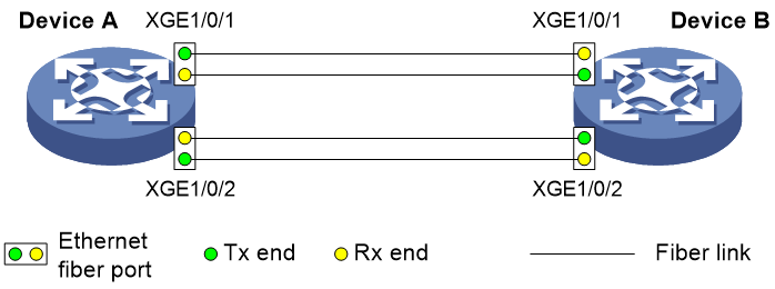

A link becomes unidirectional when only one end of the link can receive packets from the other end.
Unidirectional fiber links occur in the following cases:
·     Fibers are cross-connected.
·     A fiber is not connected at one end or one fiber of a fiber pair is broken.
Figure 1 shows a correct fiber connection and two types of unidirectional fiber connections.
When DLDP detects unidirectional links, it can automatically shut down the faulty port to avoid network problems. Alternatively, a user can manually shut down the faulty port.
Figure 1 Correct and incorrect fiber connections

Example: Configuring the manual port shutdown mode
As shown in Figure 6, Device A and Device B are connected through two fiber pairs.
Configure DLDP to detect unidirectional links. When a unidirectional link is detected, the administrator must manually shut down the port.
Figure 6 Network diagram

Example: Configuring the hybrid port shutdown mode
As shown in Figure 7Figure 6, Device A and Device B are connected through two fiber pairs.
Configure DLDP to detect unidirectional links. When a unidirectional link is detected, DLDP automatically shuts down the unidirectional port. The administrator needs to bring up the port after clearing the fault.
Figure 7 Network diagram

2.     Configure Device B:
# Enable DLDP globally.
<DeviceB> system-view
[DeviceB] dldp global enable
# Configure Ten-GigabitEthernet 1/0/1 to operate in full duplex mode and at 10000 Mbps, and enable DLDP on it.
[DeviceB] interface ten-gigabitethernet 1/0/1
[DeviceB-Ten-GigabitEthernet1/0/1] duplex full
[DeviceB-Ten-GigabitEthernet1/0/1] speed 10000
[DeviceB-Ten-GigabitEthernet1/0/1] dldp enable
[DeviceB-Ten-GigabitEthernet1/0/1] quit
# Configure Ten-GigabitEthernet 1/0/2 to operate in full duplex mode and at 10000 Mbps, and enable DLDP on it.
[DeviceB] interface ten-gigabitethernet 1/0/2
[DeviceB-Ten-GigabitEthernet1/0/2] duplex full
[DeviceB-Ten-GigabitEthernet1/0/2] speed 10000
[DeviceB-Ten-GigabitEthernet1/0/2] dldp enable
[DeviceB-Ten-GigabitEthernet1/0/2] quit
# Set the global port shutdown mode to hybrid.
[DeviceB] dldp unidirectional-shutdown hybrid
# Display the DLDP configuration globally and on all the DLDP-enabled ports of Device A.
[DeviceA] display dldp
 DLDP global status: Enabled
 DLDP advertisement interval: 5s
 DLDP authentication-mode: None
 DLDP unidirectional-shutdown mode: Hybrid
 DLDP delaydown-timer value: 1s
 Number of enabled ports: 2
Interface Ten-GigabitEthernet1/0/1
 DLDP port state: Bidirectional
 DLDP port unidirectional-shutdown mode: None
 DLDP initial-unidirectional-delay: 0s
 Number of the port’s neighbors: 1
  Neighbor MAC address: 0023-8956-3600
  Neighbor port index: 1
  Neighbor state: Confirmed
  Neighbor aged time: 11s
  Neighbor echo time: -
Interface Ten-GigabitEthernet1/0/2
  Neighbor port index: 2
  Neighbor aged time: 12s
The output shows that both Ten-GigabitEthernet 1/0/1 and Ten-GigabitEthernet 1/0/2 are in bidirectional state, which means both links are bidirectional.
# Enable the monitoring of logs on the current terminal on Device A. Set the lowest level of the logs that can be output to the current terminal to 6.
[DeviceA] quit
<DeviceA> terminal monitor
The current terminal is enabled to display logs.
<DeviceA> terminal logging level 6
The following log information is displayed on Device A:
<DeviceA>%Jan  4 07:16:06:556 2011 DeviceA DLDP/5/DLDP_NEIGHBOR_AGED: A neighbor on interface
Ten-GigabitEthernet1/0/1 was deleted because the neighbor was aged. The neighbor's system MAC is 0023-8956-3600, and the port index is 162.
%Jan  4 07:16:06:560 2011 DeviceA DLDP/5/DLDP_NEIGHBOR_AGED: A neighbor on interface
Ten-GigabitEthernet1/0/2 was deleted because the neighbor was aged. The neighbor's system MAC is 0023-8956-3600, and the port index is 165.
%Jan  4 07:16:06:724 2011 DeviceA IFNET/3/PHY_UPDOWN: Physical state on the interface Ten-GigabitEthernet1/0/1 changed to down.
%Jan  4 07:16:06:730 2011 DeviceA IFNET/3/PHY_UPDOWN: Physical state on the interface Ten-GigabitEthernet1/0/2 changed to down.
%Jan  4 07:16:06:736 2011 DeviceA IFNET/5/LINK_UPDOWN: Line protocol state on the interface Ten-GigabitEthernet1/0/1 changed to down.
%Jan  4 07:16:06:738 2011 DeviceA IFNET/5/LINK_UPDOWN: Line protocol state on the interface Ten-GigabitEthernet1/0/2 changed to down.
%Jan  4 07:16:07:152 2011 DeviceA DLDP/3/DLDP_LINK_UNIDIRECTIONAL: DLDP detected a unidirectional link on interface Ten-GigabitEthernet1/0/1. DLDP automatically shut down the interface. Please manually bring up the interface.
%Jan  4 07:16:07:156 2011 DeviceA DLDP/3/DLDP_LINK_UNIDIRECTIONAL: DLDP detected a unidirectional link on interface Ten-GigabitEthernet1/0/2. DLDP automatically shut down the interface. Please manually bring up the interface.
The output shows that the port status and link status of both Ten-GigabitEthernet 1/0/1 and Ten-GigabitEthernet 1/0/2 are down.
# Display the DLDP configuration globally and of all the DLDP-enabled ports.
<DeviceA> display dldp
 DLDP port state: Inactive
 Number of the port's neighbors: 0 (Maximum number ever detected: 1)
The output shows that DLDP detects a unidirectional link and shuts down Ten-GigabitEthernet 1/0/1 and Ten-GigabitEthernet 1/0/2.
The unidirectional links are caused by cross-connected fibers. Bring up the two ports after correcting the fiber connection:
# Bring up Ten-GigabitEthernet 1/0/1.
<DeviceA> system-view
[DeviceA] interface ten-gigabitethernet 1/0/1
[DeviceA-Ten-GigabitEthernet1/0/1] undo shutdown
[DeviceA-Ten-GigabitEthernet1/0/1]%Jan  4 07:33:26:574 2011 DeviceA IFNET/3/PHY_UPDOWN: Physical state on the interface Ten-GigabitEthernet1/0/1 changed to up.
%Jan  4 07:33:57:562 2011 DeviceA DLDP/6/DLDP_NEIGHBOR_CONFIRMED: A neighbor was confirmed on interface Ten-GigabitEthernet1/0/1. The neighbor's system MAC is 0023-8956-3600, and the port index is 162.
%Jan  4 07:33:57:563 2011 DeviceA DLDP/6/DLDP_LINK_BIDIRECTIONAL: DLDP detected a bidirectional link on interface Ten-GigabitEthernet1/0/1.
%Jan  4 07:33:57:590 2011 DeviceA IFNET/5/LINK_UPDOWN: Line protocol state on the interface Ten-GigabitEthernet1/0/1 changed to up.
%Jan  4 07:33:57:609 2011 DeviceA STP/6/STP_DETECTED_TC: Instance 0's port Ten-GigabitEthernet1/0/1 detected a topology change.
The output shows that the port status and link status of Ten-GigabitEthernet 1/0/1 are now up and its DLDP neighbors are determined.
# Bring up Ten-GigabitEthernet 1/0/2.
[DeviceA-Ten-GigabitEthernet1/0/1] quit
[DeviceA] interface ten-gigabitethernet 1/0/2
[DeviceA-Ten-GigabitEthernet1/0/2] undo shutdown
[DeviceA-Ten-GigabitEthernet1/0/2]%Jan  4 07:35:26:574 2011 DeviceA IFNET/3/PHY_UPDOWN: Physical state on the interface Ten-GigabitEthernet1/0/2 changed to up.
%Jan  4 07:35:57:562 2011 DeviceA DLDP/6/DLDP_NEIGHBOR_CONFIRMED: A neighbor was confirmed on interface Ten-GigabitEthernet1/0/2. The neighbor's system MAC is 0023-8956-3600, and the port index is 162.
%Jan  4 07:35:57:563 2011 DeviceA DLDP/6/DLDP_LINK_BIDIRECTIONAL: DLDP detected a bidirectional link on interface Ten-GigabitEthernet1/0/2.
%Jan  4 07:35:57:590 2011 DeviceA IFNET/5/LINK_UPDOWN: Line protocol state on the interface Ten-GigabitEthernet1/0/2 changed to up.
%Jan  4 07:35:57:609 2011 DeviceA STP/6/STP_DETECTED_TC: Instance 0's port Ten-GigabitEthernet1/0/2 detected a topology change.
The output shows that the port status and link status of Ten-GigabitEthernet 1/0/2 are now up and its DLDP neighbors are determined.
