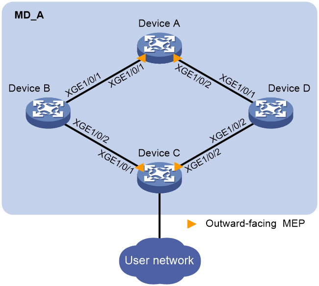

Example: Configuring a single smart link group
As shown in Figure 2:
·     Device C and Device D are Smart Link devices. Device A, Device B, and Device E are associated devices. Traffic of VLANs 1 through 30 on Device C and Device D is dually uplinked to Device A.
·     Configure Smart Link on Device C and Device D for dual uplink backup.
Figure 2 Network diagram

Example: Configuring multiple smart link groups load sharing
As shown in Figure 3:
·     Device C is a Smart Link device. Device A, Device B, and Device D are associated devices. Traffic of VLANs 1 through 200 on Device C is dually uplinked to Device A by Device B and Device D.
·     Implement dual uplink backup and load sharing on Device C. Traffic of VLANs 1 through 100 is uplinked to Device A by Device B. Traffic of VLANs 101 through 200 is uplinked to Device A by Device D.
Figure 3 Network diagram
1.     Configure Device C:

Example: Configuring Smart Link and Track collaboration
As shown in Figure 4:
·     Device A, Device B, Device C, and Device D form maintenance domain (MD) MD_A of level 5. Device C is a Smart Link device, and Device A, Device B, and Device D are associated devices. Traffic of VLANs 1 through 200 on Device C is dually uplinked to Device A by Device B and Device D.
·     Configure collaboration between Smart Link and the CC function of CFD through track entries to meet the following requirements:
¡     Traffic of VLANs 1 through 100 is uplinked to Device A by Device C through Ten-GigabitEthernet 1/0/1 (primary port of smart link group 1).
¡     Traffic of VLANs 101 through 200 is uplinked to Device A by Device C through Ten-GigabitEthernet 1/0/2 (primary port of smart link group 2).
¡     When the link between Device C and Device A fails, traffic is quickly switched to the secondary port of each smart link group. After the fault is cleared, traffic is switched back to the primary ports.
For more information about CFD, see "Configuring CFD."
Figure 4 Network diagram
