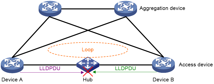

lldp blackhole-detection enable
Use lldp blackhole-detection enable to enable LLDP black hole detection for a port.
Use undo lldp blackhole-detection enable to disable LLDP black hole detection for a port.
Syntax
Default
LLDP black hole detection is enabled for a port.
Views
Layer 2 Ethernet interface view
Predefined user roles
network-admin
mdc-admin
Usage guidelines
The LLDP black hole detection feature takes effect only if the following conditions are met:
·     On both ends of the LLDP connection, both global and port-level LLDP black hole detection functions are enabled.
·     On the ports with LLDP black hole detection enabled, the link status is UP, LLDP is enabled, and the operating mode is TxRx.
Operating mechanism
1.     Triggering the sending of black hole detection packets
The ports enabled with LLDP black hole detection will carry black hole detection TLVs in the transmitted LLDP packets. The black hole detection TLV is a type of TLV defined by H3C. If an LLDP packet carrying the black hole detection TLV is received, it indicates that there is no LLDP black hole between the device and its neighbor, and LLDP packets can be sent and received smoothly. Only H3C devices can send and recognize the black hole detection TLV carried in LLDP packets.
After LLDP black hole detection is enabled on a port, the port will activate the LLDP packet receiving timer for black hole detection. If no LLDP packets are received on the port until the timer expires, it indicates a potential LLDP packet black hole in the network, causing the device to not receive LLDP packets. The port then starts sending continuous LLDP black hole detection packets. If the port receives an LLDP packet carrying the black hole detection TLV before the timer expires, the port terminates the timer and takes no further action.
After LLDP black hole detection is enabled, if a port receives an LLDP packet without the black hole detection TLV, the port will start sending LLDP black hole detection packets continuously.
LLDP black hole detection packet is an H3C proprietary Layer 2 packet type. Unlike LLDP packets, LLDP black hole detection packets can be transparently transmitted by a hub and are continuously sent at fixed intervals after being triggered.
The timeout period for receiving LLDP packets is configured by using the lldp global blackhole-detection rx-lldpdu timeout command. The interval for sending LLDP black hole detection packets is configured through the lldp timer blackhole-detection-interval command or the lldp global timer blackhole-detection-interval command.
2.     Black hole confirmation
After a port starts to send LLDP black hole detection packets, if it receives an LLDP packet carrying the black hole detection TLV, it determines that no LLDP black hole exists between the port and its neighbor, stops sending LLDP black hole detection packets, and resets the LLDP packet receiving timer.
If a port enabled with LLDP black hole detection receives an LLDP black hole detection packet and the LLDP packet receiving timer on this port has timed out, it indicates that the local device and the peer device are connected with a link and both devices have the ability to send LLDP packets. However, neither of the devices has received LLDP packets, and therefore the local device concludes that there is an LLDP black hole between the two ends of the link.
3.     Black hole processing
After detecting an LLDP black hole, the device blocks the ports receiving LLDP black hole detection packets to eliminate network loops and prevent the transmission of user data packets. If the blocked port receives no LLDP black hole detection packets within the timeout period specified by the lldp timer rx-blackhole-timeout or lldp global timer rx-blackhole-timeout command, it means that the LLDP black hole is eliminated and the port resumes normal forwarding. Otherwise, it remains blocked.
If LLDP black hole detection is not enabled on a port or the LLDP packet receiving timer of the port has not timed out, the port will not process any LLDP black hole detection packets received.
For LLDP black hole detection to take effect on a port, you must enable LLDP black hole detection globally and for that port.
Examples
# Enable LLDP black hole detection on port Ten-GigabitEthernet 3/0/1.
<Sysname> system-view
[Sysname] interface ten-gigabitethernet 3/0/1
[Sysname-Ten-GigabitEthernet3/0/1] lldp blackhole-detection enable
Related commands

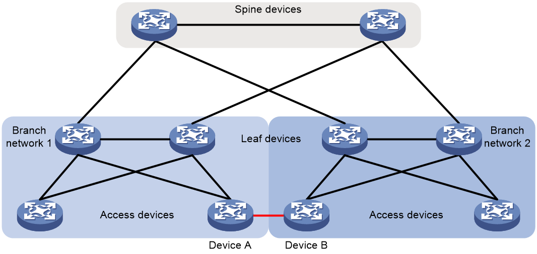

lldp cross-domain-detection
Use lldp cross-domain-detection to enable or disable LLDP cross-domain detection for the port.
Use undo cross-domain-detection to restore the default.
Syntax
lldp cross-domain-detection { enable | disable }
undo lldp cross-domain-detection
Default
The global setting (configured with the lldp global cross-domain-detection enable command) applies.
Views
network-admin
mdc-admin
Parameters
enable: Enables LLDP cross-domain detection for the port.

Application scenarios
As shown in Figure 1, Device A and Device B belongs to different branch networks. If a link exists between Device A and Device B, a loop might occur in the network. After configuring LLDP cross-domain detection, you can manually assign the devices to different domains, and use LLDP to detect whether the specified LLDP neighbor is in the local domain. In addition, you can block the link to neighbors in other domains to eliminate the potential loop risk.
Figure 1 LLDP cross-domain detection application scenario
Operating mechanism
The LLDP cross-domain detection feature defines a private type of TLV for LLDP, that is, the cross-domain detection TLV. This TLV is used to advertise the local domain to the LLDP neighbor at the peer end. The LLDP cross-domain detection feature takes effect on a port only after you execute the lldp global cross-domain-detection enable or lldp cross-domain-detection command to enable LLDP cross-domain detection. Then, LLDP packets sent by the device will carry cross-domain detection TLVs.
The domain ID in a cross-domain detection TLV is key information, because it indicates the domain to which the port that sends the cross-domain detection TLV belongs. If you execute the lldp cross-domain-detection domain-id command to specify a domain ID for a port, the cross-domain detection TLVs sent by this port must carry the specified domain ID. If you do not specify a domain ID for a port, the cross-domain detection TLVs sent by this port carry a domain ID in the cross-domain detection TLVs received by the device. If the device has received multiple cross-domain detection TLVs with different domain IDs, it will compare the priorities of these TLVs. When sending a cross-domain detection TLV, the device will carry only the domain ID of the optimal TLV it received, and block ports that receive non-optimal TLVs with different domain IDs. This will help eliminating potential loops in the network.
A blocked port can restore normal forwarding status when LLDP cross-domain detection is disabled or it does not receive any cross-domain detection TLV that carries a different domain ID.
If the domain ID is not configured for LLDP cross-domain detection, or the port is not enabled with the cross-domain detection TLV advertisement capability, the cross-domain detection feature cannot take effect on the port. In this case, the device cannot identify cross-domain detection TLVs carried in LLDP packets or add cross-domain detection TLVs to LLDP packets.
Figure 2 LLDP black hole detection application scenario
As shown in Figure 2, Device A and Device B are connected through a hub, causing a loop in the network. However, since LLDP packets are point-to-point packets, they are terminated at the next node after being sent from the device. Therefore, the HUB acts as a black hole for LLDP packets. LLDP packets cannot be transmitted between Device A and Device B through the HUB. As a result, Device A and Device B cannot use LLDP to learn about the physical link between them and the formed loop, and therefore the loop cannot be eliminated in time. In order to eliminate potential loop risks, it required to detect LLDP black holes and block the links leading to the black holes.
Operating mechanism
1.     Black hole detection
