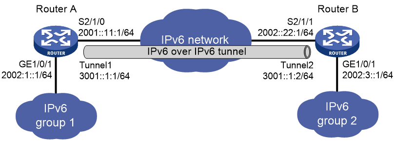

IPv6 over IPv6 tunneling (RFC 2473) enables isolated IPv6 networks to communicate with each other over another IPv6 network. For example, two isolated IPv6 networks that do not want to show their addresses to the Internet can use an IPv6 over IPv6 tunnel to communicate with each other.
Figure 1 Principle of IPv6 over IPv6 tunneling
Figure 1 shows the encapsulation and de-encapsulation processes.
