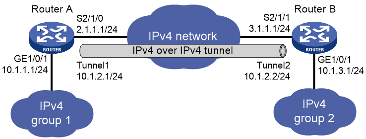

IPv4 over IPv4 tunneling
About IPv4 over IPv4 tunneling
IPv4 over IPv4 tunneling (RFC 1853) enables isolated IPv4 networks to communicate. For example, an IPv4 over IPv4 tunnel can connect isolated private IPv4 networks over a public IPv4 network.
Figure 1 IPv4 over IPv4 tunnel
Figure 1 shows the encapsulation and de-encapsulation processes.
·     Encapsulation:
a.     Device A receives an IP packet from an IPv4 host and submits it to the IP protocol stack.
b.     The IPv4 protocol stack determines how to forward the packet according to the destination address in the IP header. If the packet is destined for the IPv4 host connected to Device B, Device A delivers the packet to the tunnel interface.
c.     The tunnel interface adds a new IPv4 header to the IPv4 packet and submits it to the IP protocol stack.
In the new header, the source IP address specifies the tunnel source, and the destination IP address specifies the tunnel destination.
d.     The IP protocol stack uses the destination IP address of the new IP header to look up the routing table, and then sends the packet out.
·     De-encapsulation:
a.     After receiving the packet, Device B delivers it to the IP protocol stack.
b.     If the protocol number is 4 (indicating an IPv4 packet is encapsulated within the packet), the IP protocol stack delivers the packet to the tunnel module for de-encapsulation.
c.     The tunnel module de-encapsulates the IP packet and sends it back to the IP protocol stack.
d.     The protocol stack forwards the de-encapsulated packet.

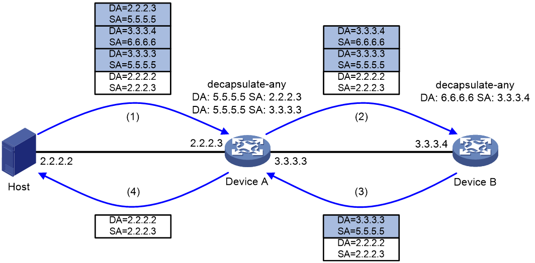

Configuring an address pair for IPv4-in-IPv4 packet decapsulation to test the reachability of a path
In some scenarios, a host needs to construct multi-layer encapsulated IPv4-in-IPv4 packets to detect whether a transmission path is reachable. Use this feature on each node along the transmission path to configure a source-destination address pair used to decapsulate the IPv4-in-IPv4 packets.
Configuring a source-destination address pair for IPv4-in-IPv4 packet decapsulation
A source-destination address pair contains a destination address and multiple source IP addresses. The destination address is optional. If you do not specify a destination address, the default setting is 0.0.0.0. You can use one of the following methods to specify multiple source IP addresses:
·     Use the source ip-address option to specify a local IP address that is reachable as the source IP address.
·     Use the source interface-type interface-number option to specify a source interface. The primary IP address of the interface is used as the source IP address.
·     Use the source direct keyword to specify a group of source IP addresses. With this keyword, the system traverses all local Layer 3 interfaces, VLAN interfaces, and loopback interfaces in up state. The source IP addresses used for packet decapsulation are the primary IP addresses of the first 1000 interfaces (except subinterfaces, interfaces in VPN instances, and inloopback interfaces).
Configure a source-destination address pair on each node along the path to be detected. On the end node, you can specify a source IP address, a source interface, or a group of source IP addresses. On the other nodes, you must use the source direct keyword to specify a group of source IP addresses.
2.     Configure a source-destination address pair for IPv4-in-IPv4 packet decapsulation.
tunnel ip-in-ip decapsulate-any [ destination ip-address ] source { ip-address | interface-type interface-number | direct }
By default, no source-destination address pair is configured for IPv4-in-IPv4 packet decapsulation.
Constructing multi-layer encapsulated IPv4-in-IPv4 packets on a host
Set the destination address of a packet as the IP address of the host, and then encapsulate IP headers layer by layer to the packet.
The encapsulation order of IP headers in the IPv4-in-IPv4 packet must be opposite to the order of nodes along the path that the packet traverses. The number of encapsulated IP headers is the number of link node devices × 2 - 1.
In the IPv4-in-IPv4 packet, the source and destination addresses in an IP header must be consistent with the source-destination address pair on the node that decapsulates that IP header.
·     The source address in the IP header must be the same as the destination address in the source-destination address pair.
·     The destination address in the IP header must be one of the source IP addresses in the source-destination address pair.
Testing the reachability of a path
When a multi-layer encapsulated IPv4-in-IPv4 packet passes through a node, the node matches the outmost source and destination addresses of the packet with the local source-destination address pair.
·     If the addresses match, the node decapsulates the outmost IP header from the packet.
·     If the addresses do not match, the node does not decapsulate the outmost IP header from the packet.
After the node decapsulates the IP header, it forwards the packet to the next node according to the forwarding table. The subsequent nodes along the path successively perform the same matching and decapsulation operations as this node until the end node completes the decapsulation. Because the destination address of the original packet is the host's IP address, the end node forwards the packet back to the host.
·     If the packet can return to the host, the path is reachable.
·     If the packet cannot return to the host, the path is not reachable.
For example, test the reachability of a path that has two nodes. The test order is Host>A>B.
Figure 2 IPv4-in-IPv4 packet decapsulation workflow
The workflow is as follows:
1.     The host constructs a multi-layer decapsulated IPv4-in-IPv4 packet and sends it to Device A.
2.     After receiving the packet, Device A finds that the outmost IP header of the packet matches the local source-destination address pair for IPv4-in-IPv4 packet decapsulation. Then, Device A decapsulates the outmost IP header from the packet and forwards the packet to Device B according to the forwarding table.
3.     After receiving the packet, Device B finds that the outmost IP header of the packet matches the local source-destination address pair for IPv4-in-IPv4 packet decapsulation. Then, Device B decapsulates the outmost IP header from the packet and forwards the packet to the next node (Device A) according to the forwarding table.
4.     Device A repeats the matching and decapsulation operations the same as Device B to decapsulate the last layer of IP header from the packet. Then, Device A forwards the packet to the host according to the forwarding table.
5.     The host receives the packet or not. If the host receives the packet, the path is reachable. If the host does not receive the packet, the path is not reachable.

IPv4 over IPv4 tunnel configuration examples
Example: Configuring an IPv4 over IPv4 tunnel
As shown in Figure 3, the two subnets IPv4 group 1 and IPv4 group 2 use private IPv4 addresses. Configure an IPv4 over IPv4 tunnel between Router A and Router B to make the two subnets reachable to each other.
Figure 3 Network diagram
Make sure Router A and Router B can reach each other through IPv4.
