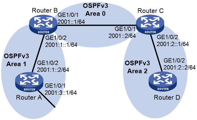

Example: Configuring OSPFv3 stub area
As shown in Figure 5:
· Enable OSPFv3 on all routers.
· Split the AS into three areas.
· Configure Router B and Router C as ABRs to forward routing information between areas.
· Configure Area 2 as a stub area to reduce LSAs in the area without affecting route reachability.
1. Configure IPv6 addresses for interfaces. (Details not shown.)
2. Configure basic OSPFv3:
# On Router A, enable OSPFv3 and specify the router ID as 1.1.1.1.
<RouterA> system-view
[RouterA] ospfv3 1
[RouterA-ospfv3-1] router-id 1.1.1.1
[RouterA-ospfv3-1] quit
[RouterA] interface gigabitethernet 1/0/1
[RouterA-GigabitEthernet1/0/1] ospfv3 1 area 1
[RouterA-GigabitEthernet1/0/1] quit
[RouterA] interface gigabitethernet 1/0/2
[RouterA-GigabitEthernet1/0/2] ospfv3 1 area 1
[RouterA-GigabitEthernet1/0/2] quit
# On Router B, enable OSPFv3 and specify the router ID as 2.2.2.2.
<RouterB> system-view
[RouterB] ospfv3 1
[RouterB-ospfv3-1] router-id 2.2.2.2
[RouterB-ospfv3-1] quit
[RouterB-GigabitEthernet1/0/1] ospfv3 1 area 0
[RouterB-GigabitEthernet1/0/1] quit
[RouterB] interface gigabitethernet 1/0/2
[RouterB-GigabitEthernet1/0/2] ospfv3 1 area 1
[RouterB-GigabitEthernet1/0/2] quit
# On Router C, enable OSPFv3 and specify the router ID as 3.3.3.3.
<RouterC> system-view
[RouterC] ospfv3 1
[RouterC-ospfv3-1] router-id 3.3.3.3
[RouterC-ospfv3-1] quit
[RouterC] interface gigabitethernet 1/0/1
[RouterC-GigabitEthernet1/0/1] ospfv3 1 area 0
[RouterC-GigabitEthernet1/0/1] quit
[RouterC] interface gigabitethernet 1/0/2
[RouterC-GigabitEthernet1/0/2] ospfv3 1 area 2
[RouterC-GigabitEthernet1/0/2] quit
# On Router D, enable OSPFv3 and specify the router ID as 4.4.4.4.
<RouterD> system-view
[RouterD] ospfv3 1
[RouterD-ospfv3-1] router-id 4.4.4.4
[RouterD-ospfv3-1] quit
[RouterD] interface gigabitethernet 1/0/2
[RouterD-GigabitEthernet1/0/2] ospfv3 1 area 2
[RouterD-GigabitEthernet1/0/2] quit
# Display OSPFv3 neighbors on Router B.
[RouterB] display ospfv3 peer
OSPFv3 Process 1 with Router ID 2.2.2.2
Area: 0.0.0.0
Router ID Pri State Dead-Time InstID Interface
3.3.3.3 1 Full/BDR 00:00:40 0 GE1/0/1
Area: 0.0.0.1
1.1.1.1 1 Full/DR 00:00:40 0 GE1/0/2
# Display OSPFv3 neighbors on Router C.
[RouterC] display ospfv3 peer
OSPFv3 Process 1 with Router ID 3.3.3.3
Area: 0.0.0.0
2.2.2.2 1 Full/DR 00:00:40 0 GE1/0/1
Area: 0.0.0.2
4.4.4.4 1 Full/BDR 00:00:40 0 GE1/0/2
# Display OSPFv3 neighbors on Router D.
[RouterD] display ospfv3 routing
OSPFv3 Process 1 with Router ID 4.4.4.4
I - Intra area route, E1 - Type 1 external route, N1 - Type 1 NSSA route
IA - Inter area route, E2 - Type 2 external route, N2 - Type 2 NSSA route
* - Selected route
*Destination: 2001::/64
Type : IA Area : 0.0.0.2
AdvRouter : 3.3.3.3 Preference : 10
NibID : 0x23000004 Cost : 2
Interface : GE1/0/2 BkInterface: N/A
Nexthop : FE80::48C0:26FF:FEDA:305
BkNexthop : N/A
Status : Rely
*Destination: 2001:1::/64
NibID : 0x23000004 Cost : 3
BkNexthop : N/A
Status : Rely
*Destination: 2001:2::/64
Type : I Area : 0.0.0.2
AdvRouter : 4.4.4.4 Preference : 10
NibID : 0x23000002 Cost : 1
Nexthop : ::
BkNexthop : N/A
Status : Direct
*Destination: 2001:3::1/128
BkNexthop : N/A
Status : Rely
Total: 4
Intra area: 1 Inter area: 3 ASE: 0 NSSA: 0
3. Configure Area 2 as a stub area:

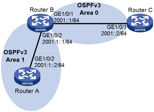

Example: Configuring OSPFv3 NSSA area
As shown in Figure 6:
· Configure OSPFv3 on all routers and split the AS into three areas.
· Configure Area 1 as an NSSA area and configure Router A as an ASBR to redistribute static routes into the AS.
2. Configure basic OSPFv3 (see "Example: Configuring OSPFv3 stub area").
3. Configure Area 1 as an NSSA area:

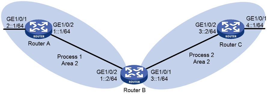

Example: Configuring OSPFv3 route redistribution
As shown in Figure 8:
· Router A, Router B, and Router C are in Area 2.
· OSPFv3 process 1 and OSPFv3 process 2 run on Router B. Router B communicates with Router A and Router C through OSPFv3 process 1 and OSPFv3 process 2.
· Configure OSPFv3 process 2 to redistribute direct routes and the routes from OSPFv3 process 1 on Router B, and set the metric for redistributed routes to 3. Router C can then learn the routes destined for 1::0/64 and 2::0/64, and Router A cannot learn the routes destined for 3::0/64 or 4::0/64.
# Enable OSPFv3 process 1 on Router A.
[RouterA] ospfv3 1

# Enable OSPFv3 process 1 and OSPFv3 process 2 on Router B.
[RouterB] ospfv3 1
[RouterB-GigabitEthernet1/0/2] ospfv3 1 area 2
[RouterB] ospfv3 2
[RouterB-ospfv3-2] router-id 3.3.3.3
[RouterB-ospfv3-2] quit
[RouterB-GigabitEthernet1/0/1] ospfv3 2 area 2
# Enable OSPFv3 process 2 on Router C.
[RouterC] ospfv3 2
[RouterC-ospfv3-2] router-id 4.4.4.4
[RouterC-ospfv3-2] quit
[RouterC-GigabitEthernet1/0/2] ospfv3 2 area 2
[RouterC-GigabitEthernet1/0/1] ospfv3 2 area 2

3. Configure OSPFv3 route redistribution:
# Configure OSPFv3 process 2 to redistribute direct routes and the routes from OSPFv3 process 1 on Router B, and set the metric for redistributed routes to 3.
[RouterB] ospfv3 2
[RouterB-ospfv3-2] import-route ospfv3 1 cost 3
[RouterB-ospfv3-2] import-route direct cost 3
