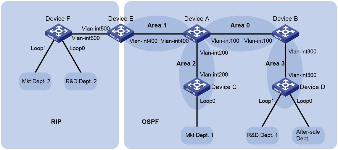

As shown in Figure 1, the devices of an enterprise reside in OSPF and RIP domains.
Configure route redistribution between OSPF and RIP to interconnect the devices.
Configure route filtering on Device E, Device C, and Device D to meet the following requirements:
·     The route destined for R&D department 2 is not redistributed to OSPF.
·     Marketing department 1 cannot reach R&D department 1.
·     R&D department 1 and the After-sale service department cannot reach Marketing department 2.
Figure 1 Network diagram
Device
Interface
IP address
Device
Interface
IP address
Device A
Vlan-int100
10.1.1.1/24
Device B
Vlan-int100
10.1.1.2/24
Vlan-int200
10.2.1.1/24
Vlan-int300
10.3.1.1/24
Vlan-int400
10.4.1.1/24
Device C
Vlan-int200
10.2.1.2/24
Device D
Vlan-int300
10.3.1.2/24
Loop0
192.168.3.1/24
Loop0
192.168.1.1/24
Loop1
192.168.2.1/24
Device E
Vlan-int400
10.4.1.2/24
Device F
Vlan-int500
10.5.1.2/24
Vlan-int500
10.5.1.1/24
Loop0
192.168.4.1/24
Loop1
192.168.5.1/24

5 packet(s) transmitted, 0 packet(s) received, 100.0% packet loss
# Verify that Device D does not have a route to 192.168.5.0/24.
[DeviceD] display ip routing-table
Destinations : 25        Routes : 25
Destination/Mask   Proto   Pre Cost        NextHop         Interface
0.0.0.0/32         Direct  0   0           127.0.0.1       InLoop0
10.1.1.0/24        O_INTER 10  2           10.3.1.1        Vlan300
10.2.1.0/24        O_INTER 10  3           10.3.1.1        Vlan300
10.3.1.0/24        Direct  0   0           10.3.1.2        Vlan300
10.3.1.0/32        Direct  0   0           10.3.1.2        Vlan300
10.3.1.2/32        Direct  0   0           127.0.0.1       InLoop0
10.3.1.255/32      Direct  0   0           10.3.1.2        Vlan300
10.4.1.0/24        O_INTER 10  3           10.3.1.1        Vlan300
10.5.1.0/24        O_ASE2  150 1           10.3.1.1        Vlan300
127.0.0.0/8        Direct  0   0           127.0.0.1       InLoop0
127.0.0.0/32       Direct  0   0           127.0.0.1       InLoop0
127.0.0.1/32       Direct  0   0           127.0.0.1       InLoop0
127.255.255.255/32 Direct  0   0           127.0.0.1       InLoop0
192.168.1.0/24     Direct  0   0           192.168.1.1     Loop0
192.168.1.0/32     Direct  0   0           192.168.1.1     Loop0
192.168.1.1/32     Direct  0   0           127.0.0.1       InLoop0
192.168.1.255/32   Direct  0   0           192.168.1.1     Loop0
192.168.2.0/24     Direct  0   0           192.168.2.1     Loop1
192.168.2.0/32     Direct  0   0           192.168.2.1     Loop1
192.168.2.1/32     Direct  0   0           127.0.0.1       InLoop0
192.168.2.255/32   Direct  0   0           192.168.2.1     Loop1
192.168.3.1/32     O_INTER 10  3           10.3.1.1        Vlan300
224.0.0.0/4        Direct  0   0           0.0.0.0         NULL0
224.0.0.0/24       Direct  0   0           0.0.0.0         NULL0
255.255.255.255/32 Direct  0   0           127.0.0.1       InLoop0
# Verify that the After-sale service department cannot reach Marketing department 2.
[DeviceD] ping -a 192.168.1.1 192.168.5.1
Ping 192.168.5.1 (192.168.5.1) from 192.168.1.1: 56 data bytes, press CTRL_C to
break
Request time out
Request time out
Request time out
Request time out
Request time out
--- Ping statistics for 192.168.5.1 ---
# Verify that R&D department 1 cannot reach Marketing department 2.
[DeviceD] ping -a 192.168.2.1 192.168.5.1
Ping 192.168.5.1 (192.168.5.1) from 192.168.2.1: 56 data bytes, press CTRL_C to
break
Request time out
Request time out
Request time out
Request time out
Request time out
The output on Device C and Device D shows that Device E has filtered out the route destined for R&D development 2.
Configuration files
·     Device A:
ospf 1
 area 0.0.0.0
  network 10.1.1.0 0.0.0.255
 area 0.0.0.1
network 10.4.1.0 0.0.0.255
area 0.0.0.2
  network 10.2.1.0 0.0.0.255
vlan 100
vlan 200
vlan 400
interface Vlan-interface100
interface Vlan-interface200
 ip address 10.2.1.1 255.255.255.0
interface Vlan-interface400
 ip address 10.4.1.1 255.255.255.0
·     Device B:
ospf 1
 area 0.0.0.0
 area 0.0.0.3
  network 10.3.1.0 0.0.0.255
vlan 100
vlan 300
 ip address 10.1.1.2 255.255.255.0
interface Vlan-interface300
 ip address 10.3.1.1 255.255.255.0
·     Device C:
ospf 1
 filter-policy 2000 import
 area 0.0.0.2
  network 192.168.3.0 0.0.0.255
vlan 200
interface LoopBack0
 ip address 192.168.3.1 255.255.255.0
 ip address 10.2.1.2 255.255.255.0
acl basic 2000
 rule 0 deny source 192.168.2.0 0.0.0.255
rule 5 permit
·     Device D:
ospf 1
 area 0.0.0.3
  network 192.168.1.0 0.0.0.255
  network 192.168.2.0 0.0.0.255
vlan 300
interface LoopBack0
interface LoopBack1
 ip address 192.168.2.1 255.255.255.0
 ip address 10.3.1.2 255.255.255.0
acl basic 2000
 rule 0 deny source 192.168.5.0 0.0.0.255
rule 5 permit
·     Device E:
ospf 1
 import-route direct
 import-route rip 1
 filter-policy 2000 export rip 1
 area 0.0.0.1
rip 1
 undo summary
 version 2
 network 10.5.1.0 0.0.0.255
 import-route direct
 import-route ospf 1
vlan 400
vlan 500
 ip address 10.4.1.2 255.255.255.0
interface Vlan-interface500
 ip address 10.5.1.1 255.255.255.0
acl basic 2000
 rule 0 deny source 192.168.4.0 0.0.0.255
rule 5 permit
·     Device F:
rip 1
 undo summary
 version 2
 network 192.168.4.0
 network 192.168.5.0
vlan 500
interface LoopBack0
 ip address 192.168.4.1 255.255.255.0
interface LoopBack1
 ip address 192.168.5.1 255.255.255.0
 ip address 10.5.1.2 255.255.255.0

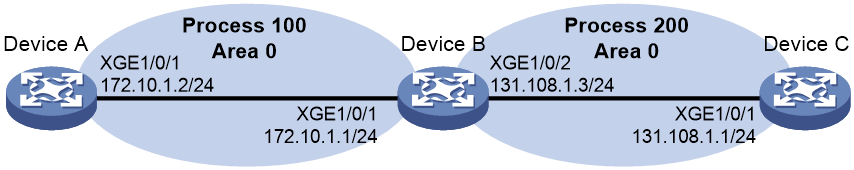

Example: Configuring the OSPF multi-process feature
As shown in Figure 2, Device A and Device B establish a neighbor relationship in OSPF process 100, and Device B and Device C establish a neighbor relationship in OSPF process 200. Device A and Device C cannot learn routes from each other through OSPF.
Figure 2 Network diagram
Hardware
Software version
S12500G-AF switch series
Release 7639P01 and later
S10500X switch series
S10500 switch series
S7500E-X switch series
S7500E switch series
S7500X switch series
Procedures
Configuring Device A
# Specify DeviceA as the device name.
<Sysname> system-view
[Sysname] sysname DeviceA
# Enable OSPF process 100 and specify the interface whose primary IP address is on network 172.10.1.0/24 to run OSPF.
[DeviceA] ospf 100 router-id 1.1.1.9
[DeviceA-ospf-100] area 0.0.0.0
[DeviceA-ospf-100-area-0.0.0.0] network 172.10.1.0 0.0.0.255
[DeviceA-ospf-100-area-0.0.0.0] quit
[DeviceA-ospf-100] quit
Configuring Device B
# Specify DeviceB as the device name.
[Sysname] sysname DeviceB
[DeviceB] ospf 100 router-id 2.2.2.9
[DeviceB-ospf-100] area 0.0.0.0
[DeviceB-ospf-100-area-0.0.0.0] network 172.10.1.0 0.0.0.255
[DeviceB-ospf-100-area-0.0.0.0] quit
[DeviceB-ospf-100] quit
# Enable OSPF process 200 and specify the interface whose primary IP address is on network 131.108.1.0/24 to run OSPF.
[DeviceB] ospf 200 router-id 2.2.2.9
[DeviceB-ospf-200] area 0.0.0.0
[DeviceB-ospf-200-area-0.0.0.0] network 131.108.1.0 0.0.0.255
[DeviceB-ospf-200-area-0.0.0.0] quit
[DeviceB-ospf-200] quit
Configuring Device C
# Specify DeviceC as the device name.
[Sysname] sysname DeviceC
[DeviceC] ospf 200 router-id 3.3.3.9
[DeviceC-ospf-200] area 0.0.0.0
[DeviceC-ospf-200-area-0.0.0.0] network 131.108.1.0 0.0.0.255
[DeviceC-ospf-200-area-0.0.0.0] quit
[DeviceC-ospf-200] quit
# Execute the display ospf peer command on Device B to verify that Device A and Device C have already established a neighbor relationship.
[DeviceB] display ospf peer
         OSPF Process 100 with Router ID 2.2.2.9
               Neighbor Brief Information
 Area: 0.0.0.0
 Router ID       Address         Pri Dead-Time  State             Interface
 1.1.1.9         172.10.1.1      1   30         Full/DR           XGE1/0/1
         OSPF Process 200 with Router ID 2.2.2.9
 Area: 0.0.0.0
 3.3.3.9         131.108.1.1     1   39         Full/BDR          XGE1/0/2
# Execute the display ip routing-table command on Device A to verify that Device A does not have a route to 131.108.1.0/24.
[DeviceA] display ip routing-table
Destinations : 11       Routes : 11
1.1.1.9/32         Direct  0   0           127.0.0.1       InLoop0
172.10.1.0/24      Direct  0   0           172.10.1.1      XGE1/0/1
172.10.1.0/32      Direct  0   0           172.10.1.1      XGE1/0/1
172.10.1.1/32      Direct  0   0           127.0.0.1       InLoop0
172.10.1.255/32    Direct  0   0           172.10.1.1      XGE1/0/1
# Execute the display ip routing-table command on Device C to verify that Device C does not have a route to 172.10.1.0/24.
# Execute the display ip routing-table command on Device C.
3.3.3.9/32         Direct  0   0           127.0.0.1       InLoop0
131.108.1.0/24     Direct  0   0           131.108.1.1     XGE1/0/2
131.108.1.0/32     Direct  0   0           131.108.1.1     XGE1/0/2
131.108.1.1/32     Direct  0   0           127.0.0.1       InLoop0
131.108.1.255/32   Direct  0   0           131.108.1.1     XGE1/0/2
Configuration files
·     Device A:
 sysname DeviceA
 area 0.0.0.0
 ip address 172.10.1.2 255.255.255.0
·     Device B:
 sysname DeviceB
 area 0.0.0.0
 area 0.0.0.0
 ip address 172.10.1.1 255.255.255.0
 ip address 131.108.1.3 255.255.255.0
·     Device C:
 sysname DeviceC
 area 0.0.0.0
 ip address 131.108.1.1 255.255.255.0
