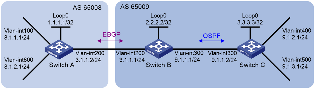

As shown in Figure 1, all switches run BGP. Run EBGP between Switch A and Switch B, and run IBGP between Switch B and Switch C so that Switch C can access the network 8.1.1.0/24 connected to Switch A.
Figure 1 Network diagram
Analysis
To enable Switch B to communicate with Switch C through loopback interfaces, enable OSPF in AS 65009.
By default, BGP does not advertise local networks. To enable Switch C to access the network 8.1.1.0/24 connected directly to Switch A, perform the following tasks:
·     Inject network 8.1.1.0/24 to the BGP routing table of Switch A.
·     Inject networks 3.1.1.0/24 and 9.1.1.0/24 to the BGP routing table of Switch B.

When you configure basic BGP, follow these restrictions and guidelines:
·     Use loopback interfaces to establish IBGP connections to prevent route flapping caused by port state changes.
·     Loopback interfaces are virtual interfaces. Use the peer connect-interface command to specify the loopback interface as the source interface for establishing BGP connections.
·     The EBGP peers, Switch A and Switch B, are located in different ASs. Typically, their loopback interfaces are not reachable to each other, so the switches use directly connected interfaces to establish EBGP sessions.

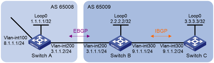

As shown in Figure 2, all devices of company A belong to AS 65008 and all devices of company B belong to AS 65009. Run EBGP between Switch A and Switch B, and run OSPF between Switch B and Switch C to allow communication only between networks 9.1.2.0/24 and 8.1.1.0/24.
Figure 2 Network diagram
Analysis
To enable Switch A to obtain the route to 9.1.2.0/24, configure BGP to redistribute routes from OSPF on Switch B. To enable Switch C to obtain the route to 8.1.1.0/24, configure OSPF to redistribute routes from BGP on Switch B.

When you configure BGP and IGP route redistribution, follow these restrictions and guidelines:
·     The EBGP peers, Switch A and Switch B, are located in different ASs. Typically, their loopback interfaces are not reachable to each other, so the switches directly connected interfaces to establish EBGP sessions.
Procedures
Configuring IP addresses for interfaces
# Configure an IP address for VLAN-interface 100.
<SwitchA> system-view
[SwitchA] interface Vlan-interface 100
[SwitchA-Vlan-interface100] ip address 8.1.1.1 24
# Configure IP addresses for other interfaces in the same way that VLAN-interface 100 is configured. (Details not shown.)
Enabling OSPF
Enable OSPF in AS 65009.
Configuring Switch B
<SwitchB> system-view
[SwitchB] ospf 1
[SwitchB-ospf-1] area 0
[SwitchB-ospf-1-area-0.0.0.0] network 2.2.2.2 0.0.0.0
[SwitchB-ospf-1-area-0.0.0.0] network 9.1.1.0 0.0.0.255
[SwitchB-ospf-1-area-0.0.0.0] quit
[SwitchB-ospf-1] quit
Configuring Switch C
<SwitchC> system-view
[SwitchC] ospf 1
[SwitchC-ospf-1] area 0
[SwitchC-ospf-1-area-0.0.0.0] network 9.1.1.0 0.0.0.255
[SwitchC-ospf-1-area-0.0.0.0] network 9.1.2.0 0.0.0.255
[SwitchC-ospf-1-area-0.0.0.0] quit
[SwitchC-ospf-1] quit
Configuring EBGP connection
Configure the EBGP connection and inject network 8.1.1.0/24 to the BGP routing table of Switch A.
Configuring Switch A
[SwitchA] bgp 65008
[SwitchA-bgp-default] router-id 1.1.1.1
[SwitchA-bgp-default] peer 3.1.1.1 as-number 65009
[SwitchA-bgp-default] address-family ipv4 unicast
[SwitchA-bgp-default-ipv4] peer 3.1.1.1 enable
[SwitchA-bgp-default-ipv4] network 8.1.1.0 24
[SwitchA-bgp-default-ipv4] quit
[SwitchA-bgp-default] quit
[SwitchB] bgp 65009
[SwitchB-bgp-default] router-id 2.2.2.2
[SwitchB-bgp-default] peer 3.1.1.2 as-number 65008
[SwitchB-bgp-default] address-family ipv4 unicast
[SwitchB-bgp-default-ipv4] peer 3.1.1.2 enable
Configuring BGP and IGP route redistribution
# Configure route redistribution between BGP and OSPF on Switch B.
[SwitchB-bgp-default-ipv4] import-route ospf 1
[SwitchB-bgp-default-ipv4] quit
[SwitchB-bgp-default] quit
[SwitchB] ospf 1
[SwitchB-ospf-1] import-route bgp
# Display the BGP routing table on Switch A.
[SwitchA] display bgp routing-table ipv4
 Total number of routes: 3
 BGP local router ID is 1.1.1.1
 Status codes: * - valid, > - best, d - dampened, h - history
               s - suppressed, S - stale, i - internal, e - external
               a - additional-path
       Origin: i - IGP, e - EGP, ? - incomplete
     Network            NextHop         MED        LocPrf     PrefVal Path/Ogn
* >  8.1.1.0/24         8.1.1.1         0                     32768   i
* >e 9.1.2.0/24         3.1.1.1         1                     0       65009?
The output shows that Switch A has obtained the route to 9.1.2.0/24.
# Display the OSPF routing table on Switch C.
[SwitchC] display ospf routing
          OSPF Process 1 with Router ID 3.3.3.3
                   Routing Table
                Topology base (MTID 0)
 Routing for network
 Destination        Cost     Type    NextHop         AdvRouter       Area
 9.1.1.0/24         1        Transit 9.1.1.2         3.3.3.3         0.0.0.0
9.1.2.0/24         1        Stub    9.1.2.1         192.168.0.63    0.0.0.0
 2.2.2.2/32         1        Stub    9.1.1.1         2.2.2.2         0.0.0.0
 Routing for ASEs
 Destination        Cost     Type    Tag         NextHop         AdvRouter
 8.1.1.0/24         1        Type2   1           9.1.1.1         2.2.2.2
 Total nets: 3
 Intra area: 2  Inter area: 0  ASE: 1  NSSA: 0
The output shows that Switch C has obtained the route to 8.1.1.0/24.
# Ping 9.1.2.1 from 8.1.1.1 on Switch A. The ping operation succeeds.
[SwitchA] ping -a 8.1.1.1 9.1.2.1
Ping 9.1.2.1 (9.1.2.1) from 8.1.1.1: 56 data bytes, press CTRL_C to break
56 bytes from 9.1.2.1: icmp_seq=0 ttl=254 time=10.000 ms
56 bytes from 9.1.2.1: icmp_seq=1 ttl=254 time=12.000 ms
56 bytes from 9.1.2.1: icmp_seq=2 ttl=254 time=2.000 ms
56 bytes from 9.1.2.1: icmp_seq=3 ttl=254 time=7.000 ms
56 bytes from 9.1.2.1: icmp_seq=4 ttl=254 time=9.000 ms
--- Ping statistics for 9.1.2.1 ---
round-trip min/avg/max/std-dev = 2.000/8.000/12.000/3.406 ms
# Ping 8.1.1.1 from 9.1.2.1 on Switch C. The ping operation succeeds.
[SwitchC] ping -a 9.1.2.1 8.1.1.1
Ping 8.1.1.1 (8.1.1.1) from 9.1.2.1: 56 data bytes, press CTRL_C to break
56 bytes from 8.1.1.1: icmp_seq=0 ttl=254 time=9.000 ms
56 bytes from 8.1.1.1: icmp_seq=1 ttl=254 time=4.000 ms
56 bytes from 8.1.1.1: icmp_seq=2 ttl=254 time=3.000 ms
56 bytes from 8.1.1.1: icmp_seq=3 ttl=254 time=3.000 ms
56 bytes from 8.1.1.1: icmp_seq=4 ttl=254 time=3.000 ms
--- Ping statistics for 8.1.1.1 ---
round-trip min/avg/max/std-dev = 3.000/4.400/9.000/2.332 ms
# Ping 9.1.2.1 and 9.1.3.1 from 8.1.2.1 on Switch A. The ping operations fail.
[SwitchA] ping –a 8.1.2.1 9.1.2.1
Ping 9.1.2.1 (9.1.2.1) from 8.1.2.1: 56 data bytes, press CTRL_C to break
Request time out
Request time out
Request time out
Request time out
Request time out
5 packet(s) transmitted, 0 packet(s) received, 100.0% packet loss
[SwitchA] ping –a 8.1.2.1 9.1.3.1
Ping 9.1.3.1 (9.1.3.1) from 8.1.2.1: 56 data bytes, press CTRL_C to break
Request time out
Request time out
Request time out
Request time out
Request time out
--- Ping statistics for 9.1.3.1 ---
# Ping 8.1.1.1 and 8.1.2.1 from 9.1.3.1 on Switch C. The ping operations fail.
[SwitchC] ping –a 9.1.3.1 8.1.1.1
Ping 8.1.1.1 (8.1.1.1) from 9.1.3.1: 56 data bytes, press CTRL_C to break
Request time out
Request time out
Request time out
Request time out
Request time out
[SwitchC] ping –a 9.1.3.1 8.1.2.1
Ping 8.1.2.1 (8.1.2.1) from 9.1.3.1: 56 data bytes, press CTRL_C to break
Request time out
Request time out
Request time out
Request time out
Request time out
--- Ping statistics for 8.1.2.1 ---
Configuration files
