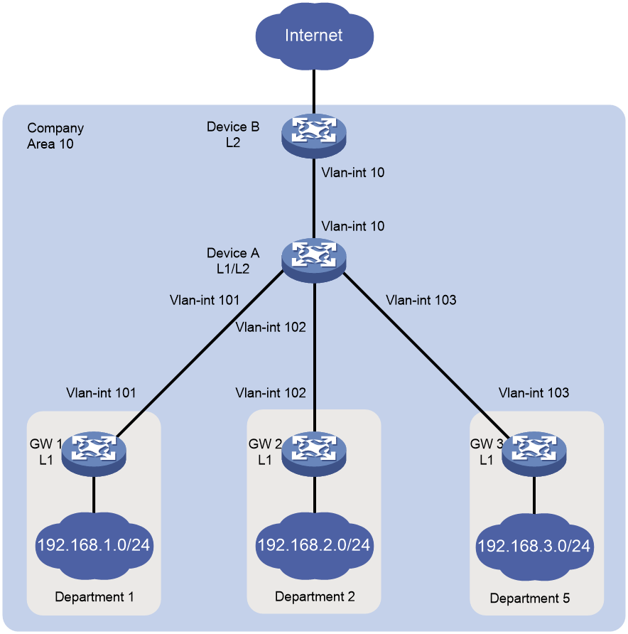

As shown in Figure 1, the five departments of a company use IS-IS to connect to the backbone network. The five departments are assigned the networks 192.168.1.0/24, 192.168.2.0/24, 192.168.3.0/24, 192.168.4.0/24, and 192.168.5.0/24. Configure IS-IS route summarization to reduce routing entries and save system resources for Device B.
Figure 1 Network diagram

Analysis
Configure route summarization on Device A because route summarization applies only to locally generated LSPs.
To avoid blackhole routes, set the summary route to 192.168.0.0/22.

Displaying IS-IS routing information on Device B
# Display IS-IS routing information on Device B to view the network address of each department.
[DeviceB] display isis route
Route information for IS-IS(1)
                         Level-2 IPv4 Forwarding Table
 IPv4 Destination     IntCost    ExtCost ExitInterface   NextHop         Flags
 192.168.1.0/24       30         NULL    Vlan10          172.16.1.1      R/-/-
 10.1.1.0/24          20         NULL    Vlan10          172.16.1.1      R/-/-
 192.168.2.0/24       30         NULL    Vlan10          172.16.1.1      R/-/-
 10.1.2.0/24          20         NULL    Vlan10          172.16.1.1      R/-/-
 192.168.3.0/24       30         NULL    Vlan10          172.16.1.1      R/-/-
 10.1.3.0/24          20         NULL    Vlan10          172.16.1.1      R/-/-
 172.16.1.0/24        10         NULL    Vlan10          Direct          D/L/-
      Flags: D-Direct, R-Added to Rib, L-Advertised in LSPs, U-Up/Down Bit Set
Configuring IS-IS route summarization
# Configure IS-IS route summarization on Device A.
[DeviceA] isis 1
[DeviceA] address-family ipv4
[DeviceA-isis-1-ipv4] summary 192.168.0.0 22
# Display IS-IS routing information on Device B.
 192.168.0.0/22       30         NULL    Vlan10          172.16.1.1      R/-/-
The output shows that the networks have been summarized into a single network 192.168.0.0/22.
