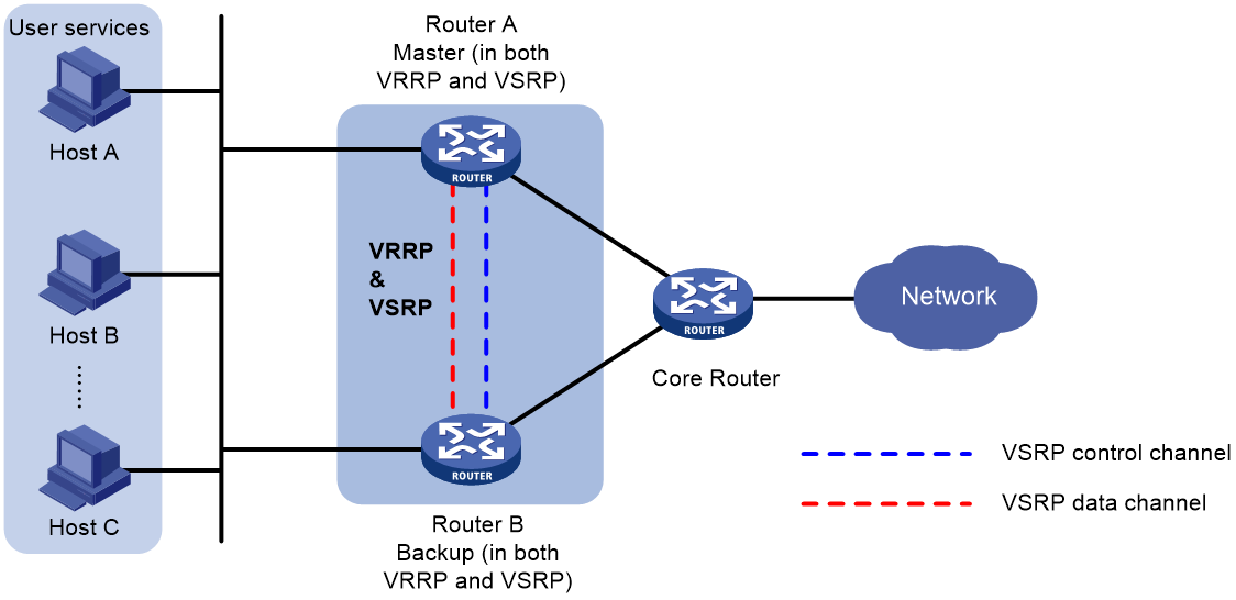

VSRP operating mechanism
VSRP takes advantage of VRRP to determine the role of each peer device in a VSRP group as master or backup.
As shown in Figure 1, a VSRP group contains two peer devices, which must be assigned to the same VRRP group.
VSRP determines the roles of the peer devices in the VSRP group in consistent with their roles in the VRRP group.
The master forwards traffic and backs up the services to the backup device either at a regular interval or when traffic reaches the specified threshold.
When the master in the VSRP group fails, the backup takes over to ensure service continuity. For more information about VRRP, see "Configuring VRRP."
VSRP is typically used on a network that contains broadband remote access servers (BRASs). To ensure service continuity, the master BRAS backs up authentication, accounting, and management information to the backup BRAS in real time.
