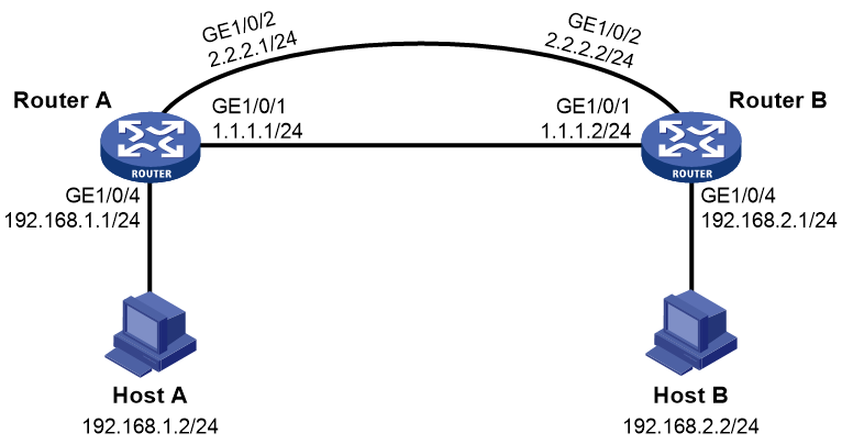

As shown in Figure 1, Port A on Router A is the primary interface. Port B (with a priority of 30) and Port C (with a priority of 20) are its backup interfaces.
· When Port A is operating correctly, all traffic is transmitted through Port A.
· When Port A fails, Port B takes over because it has higher priority than Port C. If Port B also fails, Port C takes over.
· When Port A is recovered, it preempts the active backup interface because it is the primary interface. If Port B is recovered while Port A is still down, Port B cannot preempt Port C to forward traffic.
Figure 1 Strict active/backup mode

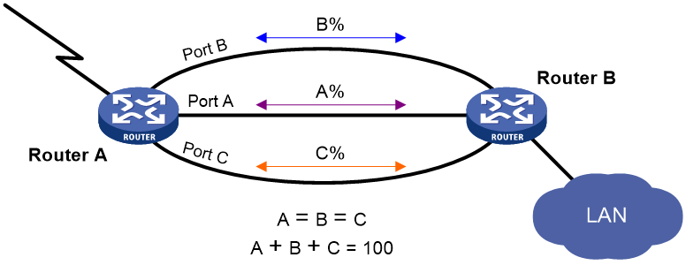

As shown in Figure 2, Port A on Router A is the primary interface. Port B (with a priority of 30) and Port C (with a priority of 20) are its backup interfaces.
· When the amount of traffic on Port A exceeds the upper threshold, Port B is activated, because it has higher priority than Port C. If the amount of traffic on Port A still exceeds the upper threshold, Port C is activated.
· When the total amount of traffic on all load-shared interfaces decreases below the lower threshold, Port C is first deactivated, because its priority is lower than Port B. If the total amount of traffic on Port A and Port B is still below the lower threshold, Port B is deactivated.

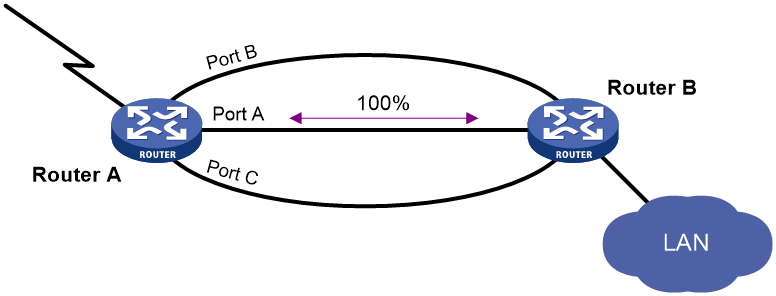

As shown in Figure 3:
· Specify GigabitEthernet 1/0/2 and GigabitEthernet 1/0/3 on Router A to back up GigabitEthernet 1/0/1.
· Assign GigabitEthernet 1/0/2 a higher priority than GigabitEthernet 1/0/3.
· Set the up and down delay timers to 10 seconds for the backup interfaces.
1. Assign IP addresses to the interfaces, as shown in Figure 3. (Details not shown.)
2. Configure static routes:
# On Router A, configure static routes to 192.168.2.0/24 through the primary and backup interfaces.
<RouterA> system-view
[RouterA] ip route-static 192.168.2.0 24 gigabitethernet 1/0/1 1.1.1.2
[RouterA] ip route-static 192.168.2.0 24 gigabitethernet 1/0/2 2.2.2.2
[RouterA] ip route-static 192.168.2.0 24 gigabitethernet 1/0/3 3.3.3.2
# On Router B, configure static routes to 192.168.1.0/24.
<RouterB> system-view
[RouterB] ip route-static 192.168.1.0 24 gigabitethernet 1/0/1 1.1.1.1
[RouterB] ip route-static 192.168.1.0 24 gigabitethernet 1/0/2 2.2.2.1
[RouterB] ip route-static 192.168.1.0 24 gigabitethernet 1/0/3 3.3.3.1
3. On Router A, configure backup interfaces and switchover delays:
# Specify GigabitEthernet 1/0/2 and GigabitEthernet 1/0/3 to back up GigabitEthernet 1/0/1, and assign them a priority of 30 and 20, respectively.
[RouterA] interface gigabitethernet 1/0/1
[RouterA-GigabitEthernet1/0/1] backup interface gigabitethernet 1/0/2 30
[RouterA-GigabitEthernet1/0/1] backup interface gigabitethernet 1/0/3 20

Example: Configuring strict active/standby interface backup with the Track module
As shown in Figure 4, configure a track entry to monitor the link state of GigabitEthernet 1/0/1. When the link of GigabitEthernet 1/0/1 fails, the backup interface GigabitEthernet 1/0/2 comes up to take over.
1. Assign IP addresses to the interfaces, as shown in Figure 4. (Details not shown.)
3. On Router A, configure Track settings:
# Configure track entry 1 to monitor the link state of GigabitEthernet 1/0/1.
[RouterA] track 1 interface gigabitethernet 1/0/1
# Associate track entry 1 with the backup interface GigabitEthernet 1/0/2.
[RouterA] interface gigabitethernet 1/0/2
[RouterA-GigabitEthernet1/0/2] backup track 1
[RouterA-GigabitEthernet1/0/2] quit
# Verify that the backup interface GigabitEthernet 1/0/2 is in STANDBY state while the primary link is operating correctly.
[RouterA] display interface-backup state
IB Track Information:
GE1/0/2 Track: 1 State: STANDBY
# Shut down the primary interface GigabitEthernet 1/0/1.
[RouterA-GigabitEthernet1/0/1] shutdown
# Verify that the backup interface GigabitEthernet 1/0/2 comes up after the primary link goes down.
[RouterA-GigabitEthernet1/0/1] display interface-backup state
GE1/0/2 Track: 1 State: UP
Example: Configuring load-shared interface backup
As shown in Figure 5:
· Configure GigabitEthernet 1/0/2 and GigabitEthernet 1/0/3 on Router A to back up the primary interface GigabitEthernet 1/0/1.
· Assign GigabitEthernet 1/0/2 higher priority than GigabitEthernet 1/0/3.
· On the primary interface:
¡ Specify the interface bandwidth used for traffic load calculation.
¡ Set the upper and lower thresholds to 80 and 20, respectively.
1. Assign IP addresses to the interfaces, as shown in Figure 5. (Details not shown.)
3. On Router A, configure backup interfaces and traffic thresholds:
# Specify GigabitEthernet 1/0/2 and GigabitEthernet 1/0/3 to back up GigabitEthernet 1/0/1, and assign them with a priority of 30 and 20, respectively.
# Set the expected bandwidth to 10000 kbps on the primary interface.
[RouterA-GigabitEthernet1/0/1] bandwidth 10000
# Set the upper and lower thresholds to 80 and 20, respectively.
[RouterA-GigabitEthernet1/0/1] backup threshold 80 20
# Display traffic statistics for load-shared interfaces.
[RouterA-GigabitEthernet1/0/1] display interface-backup statistics
Interface: GigabitEthernet1/0/1
Statistics interval: 30 s
Bandwidth: 10000000 bps
PrimaryTotalIn: 102 bytes
PrimaryTotalOut: 108 bytes
PrimaryIntervalIn: 102 bytes
PrimaryIntervalOut: 108 bytes
Primary used bandwidth: 28 bps
TotalIn: 102 bytes
TotalOut: 108 bytes
TotalIntervalIn: 102 bytes
TotalIntervalOut: 108 bytes
Total used bandwidth: 28 bps
The output shows that the upper traffic threshold has not been exceeded. All traffic is transmitted through the primary interface GigabitEthernet 1/0/1.
# Verify that both backup interfaces are in STANDBY state because the upper threshold has not been exceeded.
Interface: GE1/0/1
UpDelay: 5 s
DownDelay: 5 s
Upper threshold: 80
Lower threshold: 20
State: UP
Backup interfaces:
GE1/0/2 Priority: 30 State: STANDBY
GE1/0/3 Priority: 20 State: STANDBY
# Increase the incoming or outgoing traffic rate to be higher than 8000 kbps (80% of the specified bandwidth) on the primary interface. (Details not shown.)
# Verify that the backup interface GigabitEthernet 1/0/2 comes up to participate in traffic forwarding, because it has higher priority than GigabitEthernet 1/0/3.
Interface: GE1/0/1
UpDelay: 5 s
DownDelay: 5 s
Upper threshold: 80
Lower threshold: 20
State: UP
Backup interfaces:
GE1/0/2 Priority: 30 State: UP
