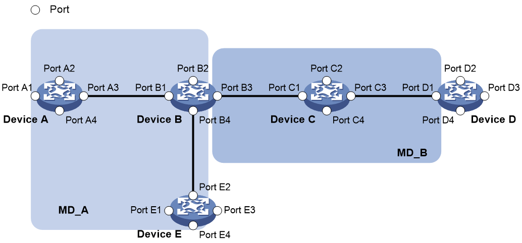

To accurately locate faults, CFD introduces eight levels (from 0 to 7) to MDs. The bigger the number, the higher the level and the larger the area covered. Domains can touch but cannot intersect or nest.
MD levels facilitate fault location and make fault location more accurate. As shown in Figure 1, MD_A in light blue touches MD_B in dark blue. If a connectivity fault is detected on the link between Device A and Device D, any of these four devices might fail. If a connectivity fault is also detected at the boundary of MD_B, the failure points can be any of Device B through Device D. If the devices in MD_B can operate correctly, at least Device C is operational.
Figure 1 Two touched MDs
CFD exchanges messages and performs operations on a per-domain basis. By planning MDs correctly in a network, you can use CFD to rapidly locate failure points.

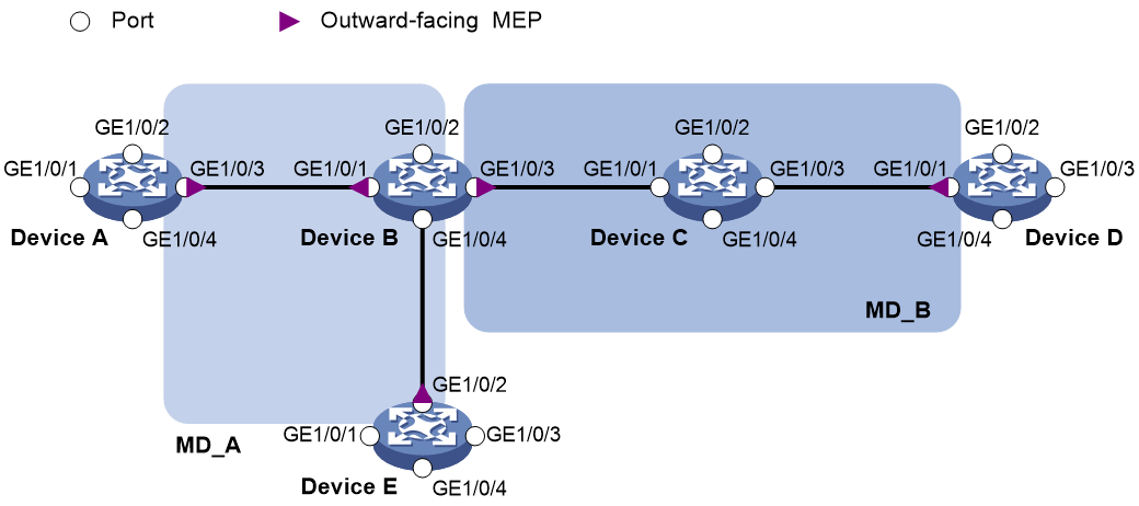

Example: Configuring CFD in an Ethernet network
As shown in Figure 2:
·     The network comprises five devices and is divided into two MDs: MD_A (level 5) and MD_B (level 3). The MAs in the two MDs all serve VLAN 100. Assume that the MAC addresses of Device A through Device E are 0010-FC01-6511, 0010-FC02-6512, 0010-FC03-6513, 0010-FC04-6514, and 0010-FC05-6515, respectively.
·     MD_A has three edge ports: GigabitEthernet 1/0/3 on Device A, GigabitEthernet 1/0/1 on Device B, and GigabitEthernet 1/0/2 on Device E. MD_B has two edge ports: GigabitEthernet 1/0/3 on Device B and GigabitEthernet 1/0/1 on Device D. They are both outward-facing MEPs.
·     Configure CC to monitor the connectivity among all the MEPs in MD_A and MD_B. Configure LB to locate link faults
·     Configure port collaboration on GigabitEthernet 1/0/3 of Device B. After the outward-facing MEP on the interface detects a link fault, the interface is shut down or blocked.
·     After the status information of the entire network is obtained, use LT, LM, one-way DM, two-way DM, and TST to detect link faults.
Figure 2 Network diagram

[DeviceB-GigabitEthernet1/0/3] quit
# Configure VLAN termination on GigabitEthernet 1/0/1.100 and GigabitEthernet 1/0/3.100.
[DeviceB] interface GigabitEthernet1/0/1.100
[DeviceB-GigabitEthernet1/0/1.100] vlan-type dot1q vid 100
[DeviceB-GigabitEthernet1/0/1.100] quit
[DeviceB] interface GigabitEthernet1/0/3.100
[DeviceB-GigabitEthernet1/0/3.100] vlan-type dot1q vid 100
[DeviceB-GigabitEthernet1/0/3.100] quit
# On Device D, configure a MEP list in service instance 2.
[DeviceD] cfd meplist 2001 4001 service-instance 2
# Create outward-facing MEP 4001 in service instance 2 on GigabitEthernet 1/0/1.
[DeviceD] interface gigabitethernet 1/0/1
[DeviceD-GigabitEthernet1/0/1] cfd mep 4001 service-instance 2 outbound
[DeviceD-GigabitEthernet1/0/1] quit
# Configure VLAN termination on GigabitEthernet1/0/1.100.
[DeviceD] interface gigabitethernet 1/0/1.100
[DeviceD-GigabitEthernet1/0/1.100] vlan-type dot1q vid 100
[DeviceD-GigabitEthernet1/0/1.100] quit
# On Device E, configure a MEP list in service instance 1.
[DeviceE] cfd meplist 1001 4002 5001 service-instance 1
# Create outward-facing MEP 4002 in service instance 1 on GigabitEthernet 1/0/1.
[DeviceE] interface gigabitethernet 1/0/1
[DeviceE-GigabitEthernet1/0/1] cfd mep 4002 service-instance 1 outbound
[DeviceE-GigabitEthernet1/0/1] quit
[DeviceE] interface GigabitEthernet1/0/1.100
[DeviceE-GigabitEthernet1/0/1.100] vlan-type dot1q vid 100
[DeviceE-GigabitEthernet1/0/1.100] quit
5.     Configure CC:
# On Device A, enable the sending of CCM frames for MEP 1001 in service instance 1 on GigabitEthernet 1/0/3.
[DeviceA] interface gigabitethernet 1/0/3
[DeviceA-GigabitEthernet 1/0/3] cfd cc service-instance 1 mep 1001 enable
[DeviceA-GigabitEthernet 1/0/3] quit
# On Device B, enable the sending of CCM frames for MEP 5001 in service instance 1 on GigabitEthernet 1/0/1, and enable the sending of CCM frames for MEP 2001 in service instance 2 on GigabitEthernet 1/0/3.
[DeviceB-GigabitEthernet1/0/1] cfd cc service-instance 1 mep 5001 enable
[DeviceB-GigabitEthernet1/0/1] quit
[DeviceB] interface gigabitethernet 1/0/3
[DeviceB-GigabitEthernet1/0/3] cfd cc service-instance 2 mep 2001 enable
# On Device D, enable the sending of CCM frames for MEP 4001 in service instance 2 on GigabitEthernet 1/0/1.
[DeviceD-GigabitEthernet1/0/1] cfd cc service-instance 2 mep 4001 enable
# On Device E, enable the sending of CCM frames for MEP 4002 in service instance 1 on GigabitEthernet 1/0/1.
[DeviceE-GigabitEthernet1/0/1] cfd cc service-instance 1 mep 4002 enable
6.     Configure port collaboration on GigabitEthernet 1/0/3:
# Specify the triggering event as cc-expire and triggered action as shutdown for port collaboration on the interface.
[DeviceB-GigabitEthernet1/0/3] cfd port-trigger cc-expire action shutdown
# Specify the triggering event as rdi and triggered action as block for port collaboration on the interface.
[DeviceB-GigabitEthernet1/0/3] cfd port-trigger rdi action block
# Specify the triggering event as dm and triggered action as shutdown for port collaboration on the interface.
[DeviceB-GigabitEthernet1/0/3] cfd port-trigger dm action shutdown
# Specify the triggering event as slm and triggered action as block for port collaboration on the interface.
[DeviceB-GigabitEthernet1/0/3] cfd port-trigger slm action block
# Specify the triggering event as tst and triggered action as shutdown for port collaboration on the interface.
[DeviceB-GigabitEthernet1/0/3] cfd port-trigger tst action shutdown
