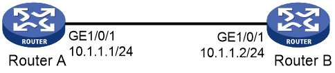

As shown in Figure 1, configure the Layer 3 connection keepalive feature on Router A to meet the following requirements:
· Router A sends Layer 3 packets to Router B when Router B works correctly.
· Router A stops sending Layer 3 packets to Router B when Router B becomes abnormal.

4. Enable the Layer 3 connection keepalive feature and associate track entry 1 with the feature on GigabitEthernet 1/0/1.
[RouterA] interface gigabitethernet 1/0/1
[RouterA-GigabitEthernet1/0/1] l3-keepalive track 1
[RouterA-GigabitEthernet1/0/1] quit
# Verify the Layer 3 connection keepalive feature.
[RouterA] display l3-keepalive
Interface Track ID State
GE1/0/1 1 Positive
The output shows that the track entry associated with the feature is in Positive state, which means that Router B works correctly.
# Delete the IP address of GigabitEthernet 1/0/1 on Router B, and execute the display l3-keepalive command after a period of time.
GE1/0/1 1 Negative
The output shows that the track entry associated with the feature is in Negative state, which means that Router B becomes abnormal. In this case, GigabitEthernet 1/0/1 on Switch A stops sending Layer 3 packets to the peer interface.
