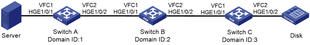

As shown in Figure 1, configure FCoE to meet the following requirements:
·     Any two FCF switches can communicate with each other.
·     SAN traffic can be transmitted on lossless Ethernet.
·     The server can access the disk device through the fabric.
Figure 1 Network diagram
Analysis
To meet the network requirements, you must perform the following tasks:
·     To transmit SAN traffic over lossless Ethernet links, you must perform the following tasks:
¡     Configure DCBX, PFC in auto mode, and ETS on the Ethernet interface connecting a switch to a server.
¡     Configure DCBX and PFC in auto mode on the Ethernet interface connecting a switch to a disk device.
¡     Forcibly enable PFC on the Ethernet interfaces interconnecting switches.
·     For the server to access the resources in the disk device, configure the members in the default zone to access each other.
·     To adapt to the simple and stable network topology, use the static method to build the fabric and configure FC static routes.

Example: Configuring FSPF
As shown in Figure 2, configure FCoE to meet the following requirements:
·     Any FCF switch can forward FC packets to the destination along the shortest path and automatically adapt to network topology changes.
Figure 2 Network diagram

Example: Configuring FIP snooping
As shown in Figure 4, configure FCoE to meet the following requirements:
·     Only successfully registered servers can access the fabric.
·     Server A and Server B cannot access each other.
Figure 4 Network diagram
Analysis
·     To allow SAN traffic to be transmitted on lossless Ethernet, perform the following tasks:
¡     Configure DCBX and PFC in auto mode on the Ethernet interface connecting a switch to a disk.
·     To allow servers to access the fabric, configure the members in the default zone to access each other.
·     To allow only successfully registered servers to access the fabric and to deny access between Server A and Server B, configure FIP snooping on Switch B.
