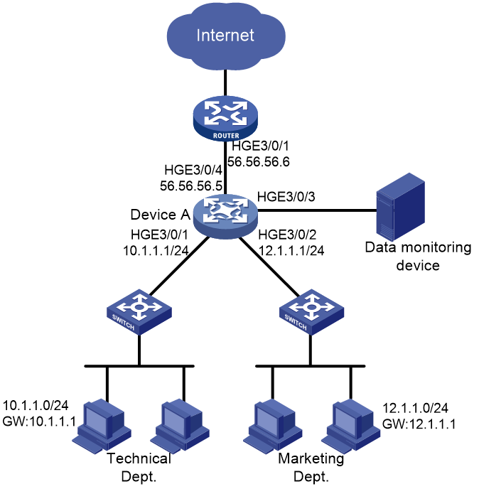

As shown in Figure 1, configure local port mirroring to monitor the Internet traffic and bidirectional traffic of the Marketing department and the Technical department.
Figure 1 Network diagram

# Assign IP address 10.1.1.1 to HundredGigE 3/0/1.
<DeviceA> system-view
[DeviceA] interface hundredgige 3/0/1
[DeviceA-HundredGigE3/0/1] port link-mode route
[DeviceA-HundredGigE3/0/1] ip address 10.1.1.1 24
[DeviceA-HundredGigE3/0/1] quit
# Assign IP addresses to HundredGigE 3/0/2 and HundredGigE 3/0/4 in the same way 10.1.1.1 is assigned to HundredGigE 3/0/1. (Details not shown.)
# Create local mirroring group 1.
[DeviceA] mirroring-group 1 local
# Configure HundredGigE 3/0/1 and HundredGigE 3/0/2 as the source ports of the mirroring group.
[DeviceA] mirroring-group 1 mirroring-port hundredgige 3/0/1 hundredgige 3/0/2 inbound
# Configure HundredGigE 3/0/3 as the monitor port of the mirroring group.
[DeviceA] mirroring-group 1 monitor-port hundredgige 3/0/3
# Disable the spanning tree feature on HundredGigE 3/0/3.
[DeviceA] interface hundredgige 3/0/3
[DeviceA-HundredGigE3/0/3] undo stp enable
[DeviceA-HundredGigE3/0/3] quit

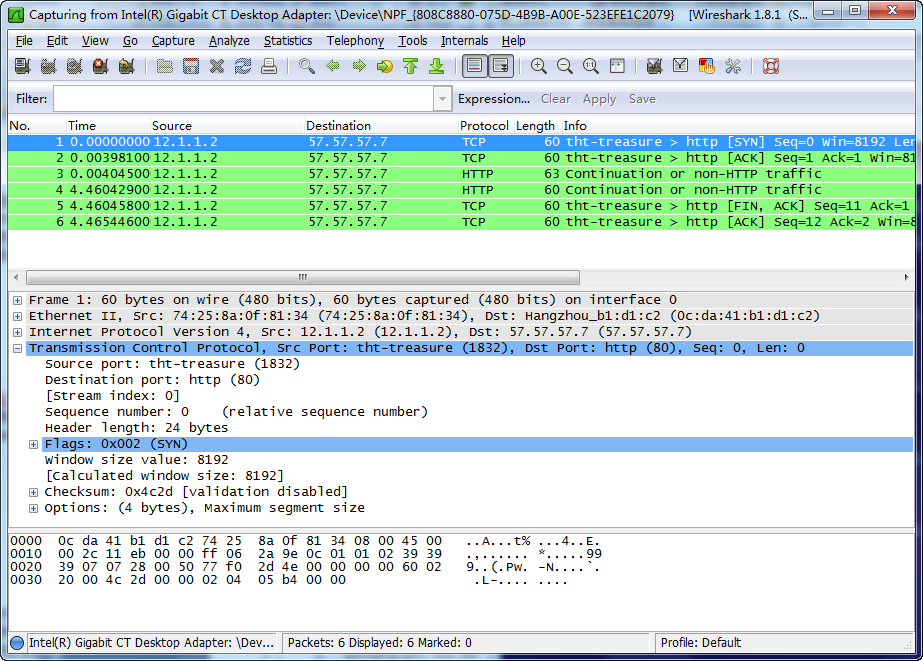

2.     Use Wireshark for packet analysis:
# Ping 56.56.56.6 from a Technical department host (10.1.1.2). (Details not shown.)
# Use Wireshark on the data monitoring device to capture the ping packets.
Figure 2 Ping packet analysis in Wireshark
The analysis shows that the data monitoring device can monitor the packets sent from the Technical department.

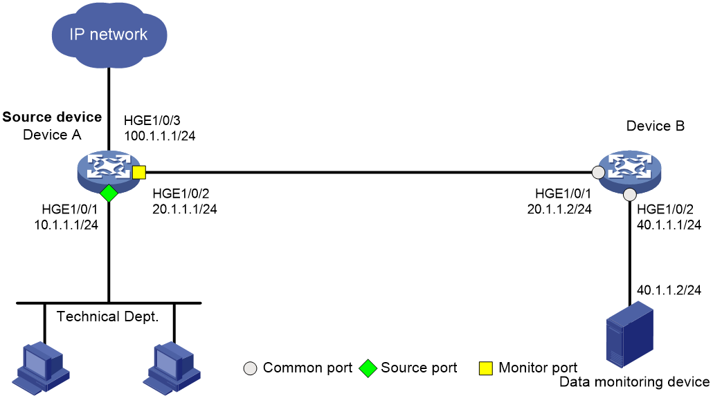

As shown in Figure 3, configure Layer 2 remote port mirroring to monitor the outgoing traffic from the Technical department.
Figure 3 Network diagram
Analysis
To ensure correct forwarding of mirrored packets, assign the ports that connect intermediate devices to the source and destination devices to the remote probe VLAN.
# Ping a Marketing department host (12.1.1.2) from a Technical department host (10.1.1.2). (Details not shown.)
Figure 4 Ping packet analysis in Wireshark
The analysis shows that the data monitoring device can monitor the outgoing traffic from the Technical department.

Example: Configuring Layer 3 remote port mirroring (ERSPAN)
As shown in Figure 5, configure Layer 3 remote port mirroring to monitor the technical department's traffic accessing the Internet on the data monitoring device.
Figure 5 Network diagram
Analysis
To configure Layer 3 remote port mirroring, first create a mirroring group, and then specify the source ports and monitor port for the mirroring group. To meet the network requirements, specify encapsulation parameters for mirrored packets when specifying the monitor port for the mirroring group.

Example: Configuring local flow mirroring
As shown in Figure 6, configure local flow mirroring to mirror the following traffic:
·     HTTP traffic from the Technical department.
·     Packets that the Marketing department hosts receive from the public server cluster during non-working hours from 18:00 to 08:30 (the next day) on working days.
Figure 6 Network diagram
Analysis
To configure local flow mirroring, you must perform the following tasks on Device A:
·     Define traffic classes and configure match criteria to classify packets to be mirrored.
·     Configure traffic behaviors to mirror the matching packets to the port that connects to the data monitoring device.
# Use a Technical department host (10.1.1.2) to access the IP address 46.46.46.4 and port 80 through Telnet. (Details not shown.)
# Use Wireshark on the data monitoring device to capture the packets.
Figure 7 HTTP traffic analysis in Wireshark
The analysis shows that the data monitoring device can monitor the HTTP traffic from the Technical department.
# On a non-working hour of a working day, ping a public server (14.1.1.2) from a Marketing department host (12.1.1.2). (Details not shown.)
Figure 8 Ping packet analysis in Wireshark
The analysis shows that the data monitoring device can monitor the traffic that the public server cluster send to the Marketing department during non-working hours on working days.

As shown in Figure 9, configure remote flow mirroring to monitor the technical department's HTTP with destination IP address 100.1.1.1 for accessing the Internet on the data monitoring device.
Figure 9 Network diagram
Analysis
To configure remote flow mirroring, follow these steps:
1.     Configure match criteria for the traffic to be mirrored according to the traffic characteristics.
2.     Configure the action of mirroring matching traffic to the specified interface and encapsulating the packets with the specified parameters.

Example: Configuring flow mirroring in a flexible way
As shown in Figure 11, configure flow mirroring to monitor the network traffic by using the data monitoring devices as follows:
·     On the data monitoring device connected to Device A:
¡     Monitor the traffic from public servers.
¡     Monitor the traffic from the file server only in the non-working hours (18:00 to 8:30 of the next day) on working days.
¡     Monitor the traffic from the Marketing department to the Internet, except the traffic from the Marketing department manager office to the Internet.
·     On the data monitoring device connected to Device B:
¡     Monitor the traffic from the Technical department hosts and the server for external access.
¡     Monitor the outgoing traffic from the server in non-working hours (18:00 to 8:30 of the next day) on working days.
Figure 11 Network diagram
Analysis
To filter data from a specific source, use one of the following methods:
·     Apply a QoS policy of denying traffic to the outgoing interface of the mirrored data. The data from the specified source is not received by the data monitoring device.
·     Configure a class-behavior association to permit the data from the specified source, and then issue the class-behavior association before the class-behavior association for mirroring. Data from the specified source is not mirrored.
·     Use the packet-filter command on the outgoing interface of the mirrored data. The data from the specified source is not received by the data monitoring device.
# Use a Marketing department host (12.1.1.2) and the manager's host (12.1.1.100) to access the IP address 57.57.57.7 and port 80 through Telnet. (Details not shown.)
# Use Wireshark on the data monitoring device connected to Device A to capture the packets.
Figure 12 HTTP traffic analysis in Wireshark
The analysis shows that the data monitoring device monitors the traffic only from the Marketing department host (12.1.1.2). The traffic from the manager office is not monitored.
